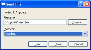

6. Select Transfer > Send File in the HyperTerminal window. In the dialog box that appears, click Browse to select the source file, and select Xmodem from the Protocol list. In this example, the file D:\update\main.bin is selected.
Figure 1 File transmission dialog box
7. Click Send.

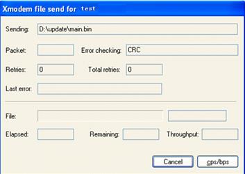

The following dialog box appears:
Figure 2 File transfer progress
After the file transfer is complete, the system displays the file attribute setting prompt.
