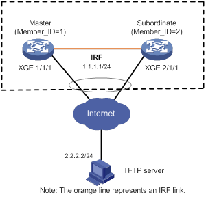

Examples of using issu commands for ISSU on a dual-member IRF fabric
Feature upgrade to a compatible version
Upgrade requirements
As shown in Figure 1, the IRF fabric has two members.
Upgrade the feature1 feature from R0201 to R0202. The two versions are compatible.
Figure 1 Network diagram
Upgrade procedure
# Download the image file that contains the R0202 feature from the TFTP server.
<Sysname> tftp 2.2.2.2 get feature1-r0202.bin
  % Total    % Received % Xferd  Average Speed   Time    Time     Time  Current
                                 Dload  Upload   Total   Spent    Left  Speed
100   256  100  256     0     0    764      0 --:--:-- --:--:-- --:--:--   810
# Display active software images.
<Sysname> display install active
Active packages on slot 1:
  flash:/boot-r0201.bin
  flash:/system-r0201.bin
  flash:/feature1-r0201.bin
Active packages on slot 2:
# Identify the ISSU method and possible impact of the upgrade.
<Sysname> display version comp-matrix file feature flash:/feature1-r0202.bin
Verifying the file flash:/feature1-r0202.bin on slot 1...Done.
Feature image: flash:/feature1-r0202.bin
  Version:
  V700R001B45D002
  Version Compatibility List:
  V700R001B45D001
  V700R001B45D002
  Version Dependency System List:
  V700R001B45D001
  V700R001B45D002
  Slot              Upgrade Way
  1                 Service Upgrade
  2                 Service Upgrade
Influenced service according to following table on slot 1:
         feature1      CFA
Influenced service according to following table on slot 27:
         feature1      CFA
The output shows that service upgrade is recommended. The feature and its related modules might reboot during the upgrade.
# Disable automatic rollback.
<Sysname> system-view
[Sysname] issu rollback-timer 0
# Enable link-aggregation traffic redirection.
[Sysname] link-aggregation lacp traffic-redirect-notification enable
# Enable the IRF bridge MAC address to be permanent.
[Sysname] irf mac-address persistent always
# Set the physical state change suppression interval to 0 on the interfaces.
[Sysname] interface ten-gigabitethernet1/1/1
[Sysname-Ten-GigabitEthernet1/1/1] link-delay 0 mode updown
[Sysname-Ten-GigabitEthernet1/1/1] quit
[Sysname] interface ten-gigabitethernet2/1/1
[Sysname-Ten-GigabitEthernet2/1/1] link-delay 0 mode updown
[Sysname-Ten-GigabitEthernet2/1/1] quit
[Sysname] quit
# Upgrade the feature on the subordinate member.
<Sysname> issu load file feature flash:/feature1-r0202.bin slot 2
This operation will delete the rollback point information for the previous upgrade and maybe get unsaved configuration lost. Continue? [Y/N]:y
Copying file flash:/feature1-r0202.bin to slot2#flash:/feature1-r0202.bin......Done.
Verifying the file flash:/feature1-r0202.bin on slot 2...Done.
Upgrade summary according to following table:
  Running Version             New Version
  Alpha 0201                  Alpha 0202
  Slot                        Upgrade Way
  2                           Service Upgrade
Upgrading software images to compatible versions. Continue? [Y/N]: y
This operation might take several minutes, please wait...Done.
# Perform a main/backup feature process switchover.
<Sysname> issu run switchover
  Slot                        Switchover Way
  1                           Active standby process switchover

Feature upgrade to an incompatible version
As shown in Figure 2, the IRF fabric has two members.
Upgrade the feature1 feature from R0201 to R0202. The two versions are incompatible.
Figure 2 Network diagram
Upgrade procedure

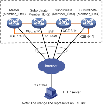

Examples of using issu commands for ISSU on a four-member IRF fabric
As shown in Figure 3, the IRF fabric has four members.
Upgrade a feature from soft-version1 to soft-version2 on the IRF fabric. The two versions are compatible.
Figure 3 Network diagram
Upgrade procedure
# Download the upgrade image file from the TFTP server.

Feature upgrade to an incompatible version (upgrading multiple subordinate members first)
As shown in Figure 5, the IRF fabric has four members.
Upgrade a feature from soft-version1 to soft-version2 on the IRF fabric. The two versions are incompatible.
Figure 5 Network diagram

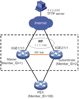

Examples of using issu commands for ISSU on an IRF 3 system
As shown in Figure 6, the IRF 3 system contains a dual-member parent fabric and an S6300 PEX. The PEX is connected to both the master and the subordinate member.
Upgrade the feature1 feature on the parent IRF fabric and the PEX from d2402 to d2403. The two versions are compatible.
Figure 6 Network diagram
As shown in Figure 7, the IRF 3 system contains a dual-member parent fabric and an S6300 PEX. The PEX is connected to both the master and the subordinate member.
Upgrade the feature1 feature on the parent IRF fabric and the PEX from d2402 to d2404. The two versions are incompatible.
Figure 7 Network diagram
Upgrade procedure
# Download the image file that contains the d2404 feature for PEX upgrade from the TFTP server.

Examples of using install commands for ISSU
Feature upgrade example
As shown in Figure 8, the IRF fabric has two members.
Figure 8 Network diagram
Upgrade procedure
# Download the .ipe file that contains the R0202 feature image from the TFTP server.
<Sysname> tftp 2.2.2.2 get feature1-r0202.ipe

Examples of using install commands for ISSU on an IRF 3 system
As shown in Figure 9, the IRF 3 system contains a dual-member parent fabric and an S6300 PEX. The PEX is connected to both the master and the subordinate member.
Figure 9 Network diagram
Upgrade procedure

# Activate the new feature image to upgrade the feature on the PEX.
<Sysname> install activate feature flash:/S6300-feature1-d2403.bin slot 108
Verifying the file flash:/S6300-feature1-d2403.bin on slot 1...Done.
  Demo 2402                   Demo 2403
  Slot                        Upgrade Way
  108                         Service Upgrade
Upgrading software images to compatible versions. Continue? [Y/N]:Y
This operation might take several minutes, please wait......................Done.
# Verify that the IRF members and the PEX are all running the new feature images.
  flash:/boot-d2402.bin
  flash:/system-d2402.bin
  flash:/feature1-d2403.bin
Active packages on slot 108:
  flash:/S6300-boot.bin
  flash:/S6300-system.bin
