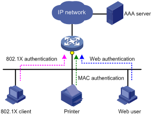

Triple authentication enables an access port to perform Web, MAC, and 802.1X authentication. A terminal can access the network if it passes one type of authentication.
Triple authentication is suitable for a LAN that comprises terminals that require different authentication services, as shown in Figure 1. The triple authentication-enabled access port can perform MAC authentication for the printer, 802.1X authentication for the PC installed with the 802.1X client, and Web authentication for the Web user.
Figure 1 Triple authentication network diagram
In triple authentication, 802.1X authentication supports only the MAC-based access control method.
For more information about Web authentication, MAC authentication and 802.1X authentication, see "Configuring Web authentication," "Configuring MAC authentication," and "Configuring 802.1X."

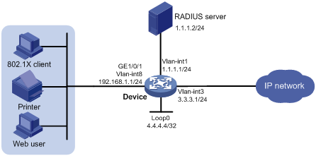

Network requirements
As shown in Figure 2, the terminals are connected to the device to access the IP network. Configure triple authentication on the device's Layer 2 interface that connects to the terminals. A terminal passing one of the three authentication methods, 802.1X authentication, Web authentication, and MAC authentication, can access the IP network.
·     Assign IP addresses on subnet 192.168.1.0/24 to the terminals.
·     Use the remote RADIUS server to perform authentication, authorization, and accounting. Configure the device to send usernames carrying no ISP domain names to the RADIUS server.
·     Configure the local Web authentication server on the device to use listening IP address 4.4.4.4. Configure the device to send a default authentication page to the Web user and forward authentication data by using HTTP.
Figure 2 Network diagram
Configuration prerequisites and restrictions
·     Make sure that the terminals, the server, and the device can reach each other.
·     Make sure the terminal of the Web user has a route to the listening IP address of the local Web authentication server.
·     Configure the RADIUS server to provide normal authentication, authorization, and accounting for users. In this example, configure the following on the RADIUS server:
?     An 802.1X user with username userdot.
?     A Web authentication user with username userpt.
?     A MAC authentication user with a username and password both being the MAC address of the printer f07d6870725f.
·     Edit authentication pages, compress the pages to a .zip file named abc, and upload the .zip file to the device by FTP.
Configuration procedure

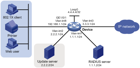

Triple authentication supporting authorization VLAN and authentication failure VLAN configuration example
Network requirement
As shown in Figure 3, the terminals are connected to the device to access the IP network. Configure triple authentication on the device's Layer 2 interface connected to the terminals. A terminal passing one of the three authentication methods, 802.1X authentication, Web authentication, and MAC authentication, can access the IP network.
·     The Web authentication terminal uses DHCP to get an IP address in 192.168.1.0/24 before authentication and in 3.3.3.0/24 after passing authentication. If the terminal fails authentication, it requests IP addresses in 2.2.2.0/24 through DHCP.
You can use the access device or an attached device as the DHCP server. In this example, the access device (the device) provides the DHCP service.
·     The 802.1X terminal uses DHCP to get an IP address in 192.168.1.0/24 before authentication and in 3.3.3.0/24 after passing authentication. If the terminal fails authentication, it requests IP addresses in 2.2.2.0/24 through DHCP.
·     After passing authentication, the printer obtains IP address 3.3.3.111/24 that is bound with its MAC address through DHCP.
·     Use the remote RADIUS server to perform authentication, authorization, and accounting. Configure the device to remove the ISP domain names from usernames sent to the RADIUS server.
·     Configure VLAN 3 as the authorization VLAN. Users passing authentication are added to this VLAN.
·     Configure VLAN 2 as the authentication failure VLAN. Users failing authentication are added to this VLAN.
Figure 3 Network diagram
Configuration prerequisites and guidelines
·     Make sure the terminals, the servers, and the device can reach each other.
?     An authorization VLAN (VLAN 3).
·     Configure the IP address of server update as the authentication-free IP address.
·     Edit authentication pages, compress the pages to a .zip file named defaultfile and upload the .zip file to the device by FTP.
·     Set the DHCP lease according to the network condition and how the terminals update their IP addresses.
A short lease is recommended to shorten the time that terminals use to re-acquire IP addresses after passing or failing authentication. This example uses the lease of 1 minute.
Some terminals do not need to wait for the lease to update their IP addresses. For example, the iNode 802.1X client can automatically renew its IP address after disconnecting from the server.
