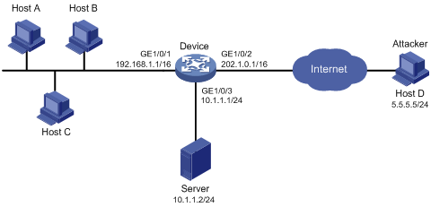

Attack detection and prevention configuration examples
Interface-based attack detection and prevention configuration example
Network requirements
As shown in Figure 1, the device is the gateway for the internal network.
Configure an attack defense policy and apply the policy to GigabitEthernet 1/0/2 to meet the following requirements:
·     Provide low-level scanning attack detection for internal hosts and servers. If a scanning attack is detected, log the attack and keep the attacker on the blacklist for 10 minutes.
·     Protect internal hosts and servers against smurf attacks. If a smurf attack is detected, log the attack.
·     Protect the internal server against SYN flood attacks. If the number of SYN packets sent to the server per second reaches or exceeds 5000, log the attack and drop subsequent packets.
Figure 1 Network diagram
Configuration procedure
# Configure IP addresses for the interfaces on the device. (Details not shown.)
# Enable the global blacklist feature.
<Device> system-view
[Device] blacklist global enable
# Create attack defense policy a1.
[Device] attack-defense policy a1
# Configure signature detection for smurf attacks, and specify logging as the prevention action.
[Device-attack-defense-policy-a1] signature detect smurf action logging
# Configure low-level scanning attack detection, specify logging and block-source as the prevention actions, and set the blacklist entry aging time to 10 minutes.
[Device-attack-defense-policy-a1] scan detect level low action logging block-source timeout 10
# Configure SYN flood attack detection for 10.1.1.2, set the attack prevention triggering threshold to 5000, and specify logging and drop as the prevention actions.
[Device-attack-defense-policy-a1] syn-flood detect ip 10.1.1.2 threshold 5000 action logging drop
[Device-attack-defense-policy-a1] quit
# Apply attack defense policy a1 to GigabitEthernet 1/0/2.
[Device] interface gigabitethernet 1/0/2
[Device-GigabitEthernet1/0/2] attack-defense apply policy a1
[Device-GigabitEthernet1/0/2] quit
# Verify that attack defense policy a1 is successfully configured.
[Device] display attack-defense policy a1

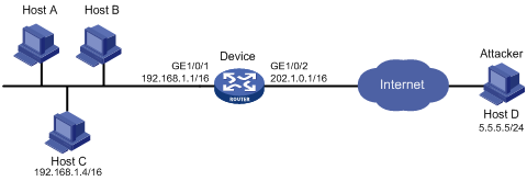

IP blacklist configuration example
As shown in Figure 2, configure the IP blacklist feature on the device to block packets from the attacker Host D permanently and from Host C for 50 minutes.
Figure 2 Network diagram
# Add an IPv4 blacklist entry for Host D.
[Device] blacklist ip 5.5.5.5
# Add an IPv4 blacklist entry for Host C and set the blacklist entry aging time to 50 minutes.
[Device] blacklist ip 192.168.1.4 timeout 50
# Verify that the IPv4 blacklist entries are successfully added.
<Device> display blacklist ip
IP address      VPN instance   DS-Lite tunnel peer  Type    TTL(sec) Dropped
5.5.5.5         --             --                   Manual  Never    0
192.168.1.4     --             --                   Manual  2989     0
# Verify that the device drops packets from Host D. (Details not shown.)
# Execute the undo blacklist ip 5.5.5.5 command and verify that the device forwards packets from Host D. (Details not shown.)
# Verify that the device drops packets from Host C for 50 minutes and forwards packets from Host C after 50 minutes. (Details not shown.)

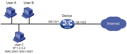

User blacklist configuration example
As shown in Figure 3, configure the user blacklist feature on the device to block packets from User C for 50 minutes. The IP address of User C is 1.2.3.4 and the MAC address of User C is 0001-0001-0001.
Figure 3 Network diagram
1.     Configure IP addresses for the interfaces on the device. (Details not shown.)
2.     Configure user identification:
# Add a network access user named userc.
[Device] local-user userc class network
[Device-luser-network-userc] quit
# Configure a static identity user with username userc, IP address 1.2.3.4, and MAC address 0001-0001-0001.
[Device] user-identity static-user userc bind ipv4 1.2.3.4 mac 0001-0001-0001
# Enable user identification.
[Device] user-identity enable
3.     Configure the user blacklist feature:
# Add a user blacklist entry for user userc and set the blacklist entry aging time to 50 minutes.
[Device] blacklist user userc timeout 50
# Verify that the user blacklist entry is successfully added.
[Device] display blacklist user
User name      Type    TTL(sec) Dropped
userc          Manual  2987     0
# Verify that the device drops packets from User C for 50 minutes and forwards packets from User C after 50 minutes. (Details not shown.)
