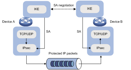

Interface-based IPsec supports setting up IPsec tunnels based on ACLs.
ACL-based IPsec
To implement ACL-based IPsec, configure an ACL to define the data flows to be protected, specify the ACL in an IPsec policy, and then apply the IPsec policy to an interface. When packets sent by the interface match a permit rule of the ACL, the packets are protected by the outbound IPsec SA and encapsulated with IPsec. When the interface receives an IPsec packet destined for the local device, it searches for the inbound IPsec SA according to the SPI in the IPsec packet header for de-encapsulation. If the de-encapsulated packet matches a permit rule of the ACL, the device processes the packet. If the de-encapsulated packet does not match any permit rule of the ACL, the device drops the packet.
The device supports the following data flow protection modes:
·     Standard mode—One IPsec tunnel protects one data flow. The data flow permitted by an ACL rule is protected by one IPsec tunnel that is established solely for it.
·     Aggregation mode—One IPsec tunnel protects all data flows permitted by all the rules of an ACL. This mode is only used to communicate with old-version devices.
·     Per-host mode—One IPsec tunnel protects one host-to-host data flow. One host-to-host data flow is identified by one ACL rule and protected by one IPsec tunnel established solely for it. This mode consumes more system resources when multiple data flows exist between two subnets to be protected.

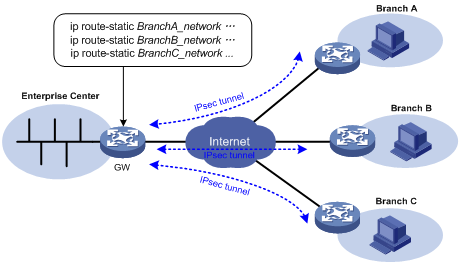

IPsec RRI
As shown in Figure 4, the traffic between the enterprise center and the branches are protected by IPsec. The gateway at the enterprise center is configured with static routes to route traffic to the IPsec-protected interfaces. It is difficult to add or modify static routes on the gateway at the enterprise center if the IPsec VPN has a large number of branches or if the network structure changes.
Figure 4 IPsec VPN
IPsec Reverse Route Injection (RRI) enables an IPsec tunnel gateway to automatically add static routes destined for protected private networks or static routes destined for peer IPsec tunnel gateways to a routing table. As shown in Figure 4, you can enable IPsec RRI on the gateway at the enterprise center. After an IPsec tunnel is established, the gateway automatically adds a static route to the routing table, which can be looked up. The destination IP address is the protected private network, and the next hop is the remote IP address of the IPsec tunnel. The traffic destined for the peer end is routed to the IPsec tunnel interface and thereby protected by IPsec.
You can advertise the static routes created by IPsec RRI in the internal network, and the internal network device can use them to forward traffic in the IPsec VPN.
In an MPLS L3VPN network, IPsec RRI can add static routes to VPN instances' routing tables.
IPsec RRI is applicable to gateways that must provide many IPsec tunnels (for example, a headquarters gateway).

Configuring IPsec RRI
Configuration guidelines
When you enable or disable IPsec RRI for an IPsec policy, the device deletes all IPsec SAs created by this IPsec policy, and the associated static routes.
If you change the preference value or tag value for an IPsec policy, the device deletes all IPsec SAs created by this IPsec policy, and the associated static routes. Your change takes effect for future IPsec RRI-created static routes.
You can set preferences for the static routes created by IPsec RRI to flexibly apply route management policies. For example, you can set the same preference for multiple routes to the same destination to implement load sharing, or you can set different preferences to implement route backup.
You can also set tags for the static routes created by IPsec RRI to implement flexible route control through routing policies.
IPsec RRI does not generate a static route to a destination address to be protected if the destination address is not defined in the ACL used by an IPsec policy or an IPsec policy template. You must manually configure a static route to the destination address.
Configuration procedure
To configure IPsec RRI:
Step
Remarks
N/A
2.     Enter IPsec policy view or IPsec policy template view.
·     To enter IPsec policy view:
ipsec { policy | ipv6-policy } policy-name seq-number  isakmp
·     To enter IPsec policy template view:
ipsec { policy-template | ipv6-policy-template } template-name seq-number
N/A
3.     Enable IPsec RRI.
reverse-route dynamic
By default, IPsec RRI is disabled.
IPsec RRI is supported in both tunnel mode and transport mode.
4.     Optional.) Set the preference value for the static routes created by IPsec RRI.
reverse-route preference number
The default value is 60.
5.     (Optional.) Set the tag value for the static routes created by IPsec RRI.
reverse-route tag tag-value
The default value is 0.

As shown in Figure 6, IKE negotiates SAs for IPsec and transfers the SAs to IPsec, and IPsec uses the SAs to protect IP packets.
Figure 6 Relationship between IKE and IPsec

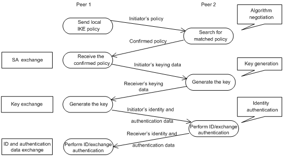

Figure 7 IKE exchange process in main mode
As shown in Figure 7, the main mode of IKE negotiation in phase 1 involves three pairs of messages:
·     SA exchange—Used for negotiating the IKE security policy.
·     Key exchange—Used for exchanging the DH public value and other values, such as the random number. The two peers use the exchanged data to generate key data and use the encryption key and authentication key to ensure the security of IP packets.
·     ID and authentication data exchange—Used for identity authentication.

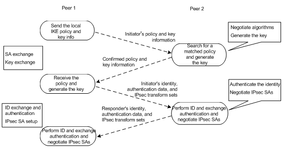

The main difference between the main mode and the aggressive mode is that the aggressive mode does not provide identity information protection and exchanges only three messages, rather than three pairs. The main mode provides identity information protection but is slower.

As shown in Figure 10, IKEv2 uses two exchanges during the initial exchange process: IKE_SA_INIT and IKE_AUTH, each with two messages.
·     IKE_SA_INIT exchange—Negotiates IKE SA parameters and exchanges keys.
·     IKE_AUTH exchange—Authenticates the identity of the peer and establishes IPsec SAs.
After the four-message initial exchanges, IKEv2 sets up one IKE SA and one pair of IPsec SAs. For IKEv1 to set up one IKE SA and one pair of IPsec SAs, it must go through two phases that use a minimum of six messages.
To set up one more pair of IPsec SAs within the IKE SA, IKEv2 goes on to perform an additional two-message exchange—the CREATE_CHILD_SA exchange. One CREATE_CHILD_SA exchange creates one pair of IPsec SAs. IKEv2 also uses the CREATE_CHILD_SA exchange to rekey IKE SAs and Child SAs.
IKEv2 uses the INFORMATIONAL exchange to convey control messages about errors and notifications.
