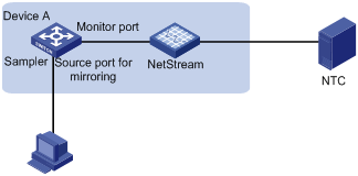

Figure 1 shows the sampling function in port mirroring and NetStream. A NetStream card (LSR1NSM1A1) is installed on Device A. Configure port mirroring with sampling on Device A so that the packets are sampled. The sampled packets are sent to the destination monitor port, and then to the NetStream card for accounting purpose. On the NetStream card, configure NetStream sampling with the same sampling rate so that the NetTraffic Collector (NTC) device will be notified of the sampling rate, and can collect statistics for packets involved in all sampling on Device A.

As shown in Figure 2, configure a sampler in fixed mode, where the first packet out of every 256 packets is selected. Then configure port mirroring with the sampler referenced in the inbound direction of GigabitEthernet 3/0/1 on Switch A and configure GigabitEthernet 3/0/2 as the monitor port. The sampled packets are sent to GigabitEthernet 3/0/2 and then to the NetStream card for accounting.
