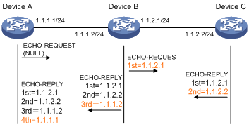

The test procedure with the ping –r command (see Figure 1) is as follows:
1.     The source device (Device A) sends an ICMP echo request with the RR option being empty to the destination (Device C).
2.     The intermediate device (Device B) adds the IP address of its outbound interface (1.1.2.1) to the RR option of the ICMP echo request, and forwards the packet.
3.     Upon receiving the request, the destination device copies the RR option in the request and adds the IP address of its outbound interface (1.1.2.2) to the RR option. Then the destination device sends an ICMP echo reply.
4.     The intermediate device adds the IP address of its outbound interface (1.1.1.2) to the RR option in the ICMP echo reply, and then forwards the reply.
5.     Upon receiving the reply, the source device adds the IP address of its inbound interface (1.1.1.1) to the RR option. Finally, you can get detailed information about routes from Device A to Device C: 1.1.1.1 <-> {1.1.1.2; 1.1.2.1} <-> 1.1.2.2.

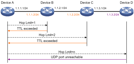

Tracert
Tracert (also called "Traceroute") enables you to get the IP addresses of Layer 3 devices in the path to a specific destination. You can use tracert to test network connectivity and identify failed nodes.
Figure 2 Network diagram
Tracert uses received ICMP error messages to get the IP addresses of devices. As shown in Figure 2, tracert works as follows:
1.     The source device (Device A) sends a UDP packet with a TTL value of 1 to the destination device (Device D). The destination UDP port is not used by any application on the destination device.
2.     The first hop (Device B, the first Layer 3 device that receives the packet) responds by sending a TTL-expired ICMP error message to the source device, with its IP address encapsulated. In this way, the source device can get the address of the first Layer 3 device (1.1.1.2).
3.     The source device sends a packet with a TTL value of 2 to the destination device.
4.     The second hop (Device C) responds with a TTL-expired ICMP error message, which gives the source device the address of the second Layer 3 device (1.1.2.2).
5.     This process continues until a packet sent by the source device reaches the ultimate destination device. Because no application uses the destination port specified in the packet, the destination device responds with a port unreachable ICMP to the source device, with its IP address encapsulated. This way, the source device gets the IP address of the destination device (1.1.3.2).
6.     The source device thinks that the packet has reached the destination device after receiving the port-unreachable ICMP message, and the path to the destination device is 1.1.1.2 to 1.1.2.2 to 1.1.3.2.

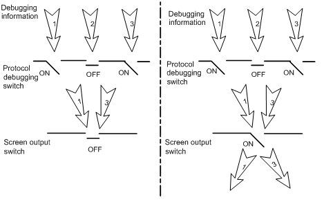

Debugging information control switches
The following two switches control the display of debugging information:
·     Protocol debugging switch—Controls protocol-specific debugging information.
·     Screen output switch—Controls whether to display the debugging information on a certain screen.
As shown in Figure 3, assume that the device can provide debugging for the three modules 1, 2, and 3. The debugging information can be output on a terminal only when both the protocol debugging switch and the screen output switch are turned on.
Output of debugging information depends on the configurations of the information center and the debugging commands of each protocol and functional module. Debugging information is typically displayed on a terminal (including console or VTY). You can also send debugging information to other destinations. For more information, see "Configuring the information center."
Figure 3 Relationship between the protocol and screen output switch
