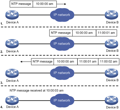

Figure 1 shows how NTP synchronizes the system time between two devices, in this example, Device A and Device B. Assume that:
·     Prior to the clock synchronization, the clock of Device A is set to 10:00:00 am while that of Device B is set to 11:00:00 am.
·     Device B is used as the NTP time server. Device A synchronizes to Device B.
·     It takes 1 second for an NTP message to travel from one device to the other.
Figure 1 Basic work flow of NTP
The synchronization process is as follows:
·     Device A sends Device B an NTP message, which is timestamped when it leaves Device A. The time stamp is 10:00:00 am (T1).
·     When this NTP message arrives at Device B, it is timestamped by Device B. The timestamp is 11:00:01 am (T2).
·     When the NTP message leaves Device B, Device B timestamps it. The timestamp is 11:00:02 am (T3).
·     When Device A receives the NTP message, the local time of Device A is 10:00:03 am (T4).
Up to now, Device A has sufficient information to calculate the following two important parameters:
·     The roundtrip delay of NTP message: Delay = (T4–T1) – (T3-T2) = 2 seconds.
·     Time difference between Device A and Device B: Offset = ((T2-T1) + (T3-T4))/2 = 1 hour.
Based on these parameters, Device A can synchronize to Device B.

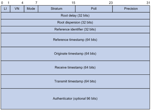

A clock synchronization message is encapsulated in a UDP message, in the format shown in Figure 2.
Figure 2 Clock synchronization message format
Main fields are described as follows:
·     LI (Leap Indicator)A 2-bit leap indicator. When set to 11, it warns of an alarm condition (clock unsynchronized); when set to any other value, it is not to be processed by NTP.
·     VN (Version Number)A 3-bit version number that indicates the version of NTP. The latest version is version 3.
·     ModeA 3-bit code that indicates the operation mode of NTP. This field can be set to these values:
¡     0Reserved
¡     1Symmetric active
¡     2Symmetric passive
¡     3Client
¡     4Server
¡     5Broadcast or multicast
¡     6NTP control message
¡     7Reserved for private use
·     StratumAn 8-bit integer that indicates the stratum level of the local clock, with the value in the range of 1 to 16. Clock precision decreases from stratum 1 through stratum 16. A stratum 1 clock has the highest precision, and a stratum 16 clock is not synchronized and cannot be used as a reference clock.
·     PollAn 8-bit signed integer that indicates the maximum interval between successive messages, which is called the poll interval.
·     PrecisionAn 8-bit signed integer that indicates the precision of the local clock.
·     Root DelayRoundtrip delay to the primary reference source.
·     Root DispersionThe maximum error of the local clock relative to the primary reference source.
·     Reference IdentifierIdentifier of the particular reference source.
·     Reference TimestampThe local time at which the local clock was last set or corrected.
·     Originate TimestampThe local time at which the request departed from the client for the service host.
·     Receive TimestampThe local time at which the request arrived at the service host.
·     Transmit TimestampThe local time at which the reply departed from the service host for the client.
·     Authenticator—Authentication information.

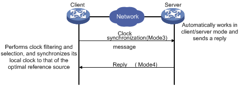

When operating in client/server mode, a client sends a clock synchronization message to servers, with the Mode field in the message set to 3 (client mode). Upon receiving the message, the servers automatically operate in server mode and send a reply, with the Mode field in the messages set to 4 (server mode). Upon receiving the replies from the servers, the client performs clock filtering and selection, and synchronizes to the optimal reference source.
In client/server mode, a client can synchronize to a server, but a server cannot synchronize to a client.

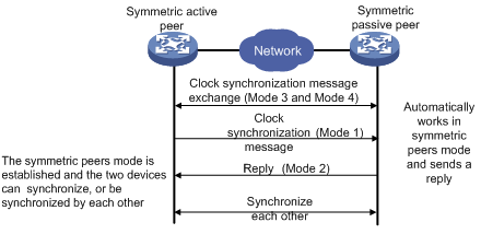

Symmetric peers mode
Figure 4 Symmetric peers mode
In symmetric peers mode, devices that operate in symmetric active mode and symmetric passive mode exchange NTP messages with the Mode field 3 (client mode) and 4 (server mode). Then the device that operates in symmetric active mode periodically sends clock synchronization messages, with the Mode field in the messages set to 1 (symmetric active). The device that receives the messages automatically enters symmetric passive mode and sends a reply, with the Mode field in the message set to 2 (symmetric passive). This exchange of messages establishes symmetric peers mode between the two devices, so the two devices can synchronize, or be synchronized by, each other. If both devices have been synchronized, the device with a lower stratum level synchronizes the other device.

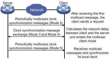

In multicast mode, a server periodically sends clock synchronization messages to the user-configured multicast address, or, if no multicast address is configured, to the default NTP multicast address 224.0.1.1, with the Mode field in the messages set to 5 (multicast mode). Clients listen to the multicast messages from servers. When a client receives the first multicast message, the client and the server start to exchange messages with the Mode field set to 3 (client mode) and 4 (server mode), to calculate the network delay between client and server. Then, the client enters multicast client mode. It continues listening to multicast messages, and synchronizes its local clock based on the received multicast messages.
In symmetric peers mode, broadcast mode and multicast mode, the client (or the symmetric active peer) and the server (the symmetric passive peer) can operate in the specified NTP operation mode only after they exchange NTP messages with the Mode field 3 (client mode) and the Mode field 4 (server mode). During this message exchange process, NTP clock synchronization can be implemented.

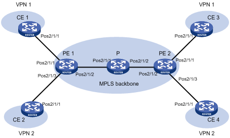

NTP for multiple VPNs
The device supports multiple VPNs when it functions as an NTP client or a symmetric active peer to realize clock synchronization with the NTP server or symmetric passive peer in an MPLS VPN network.
As shown in Figure 7, users in VPN 1 and VPN 2 are connected to the MPLS backbone network through provider edge (PE) devices, and services of the two VPNs are isolated. If you configure the PEs to operate in NTP client or symmetric active mode, and specify the VPN to which the NTP server or NTP symmetric passive peer belongs, the clock synchronization between PEs and CEs of the two VPNs can be realized. For more information about MPLS L3VPN, VPN instance, and PE, see MPLS Configuration Guide.

Configuring the NTP multicast mode
The multicast server periodically sends NTP multicast messages to multicast clients, which send replies after receiving the messages and synchronize their local clocks.
Configure the NTP multicast mode on both the server and clients. The NTP multicast mode must be configured in a specific interface view.
Tunnel interfaces do not support NTP multicast mode. For more information about tunnel interfaces, see Layer 3—IP Services Configuration Guide.
Configuring a multicast client
Step
Remarks
N/A
2.     Enter interface view.
This command enters the view of the interface for sending NTP multicast messages.
3.     Configure the device to operate in NTP multicast client mode.
ntp-service multicast-client [ ip-address ]
You can configure up to 1024 multicast clients, among which 128 can take effect at the same time.

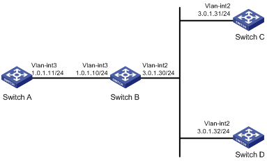

NTP configuration examples
By default, Ethernet, VLAN, and aggregate interfaces are down. To configure such an interface, bring the interface up by executing the undo shutdown command.
Configuring NTP client/server mode
Network requirements
As shown in Figure 8, configure Device A as the reference source, with the stratum level 2. Configure Device B to operate in client/server mode and use Device A as the NTP server of Device B.
Figure 8 Network diagram
Configuration procedure
1.     Set the IP address for each interface as shown in Figure 8. (Details not shown.)
2.     Configure Device A:
# Specify Device A as the reference source, with the stratum level 2.
<DeviceA> system-view
[DeviceA] ntp-service refclock-master 2
3.     Configure Device B:
# View the NTP status of Device B before clock synchronization.
<DeviceB> display ntp-service status
 Clock status: unsynchronized
 Clock stratum: 16
 Reference clock ID: none
 Nominal frequency: 64.0000 Hz
 Actual frequency: 64.0000 Hz
 Clock precision: 2^7
 Clock offset: 0.0000 ms
 Root delay: 0.00 ms
 Root dispersion: 0.00 ms
 Peer dispersion: 0.00 ms
 Reference time: 00:00:00.000 UTC Jan 1 1900 (00000000.00000000)
# Specify Device A as the NTP server of Device B so that Device B can synchronize to Device A.
<DeviceB> system-view
[DeviceB] ntp-service unicast-server 1.0.1.11
# View the NTP status of Device B after clock synchronization.
[DeviceB] display ntp-service status
 Clock status: synchronized
 Clock stratum: 3
 Reference clock ID: 1.0.1.11
 Root delay: 31.00 ms
 Root dispersion: 1.05 ms
 Peer dispersion: 7.81 ms
 Reference time: 14:53:27.371 UTC Sep 19 2005 (C6D94F67.5EF9DB22)
The output shows that Device B has synchronized to Device A, and has the stratum level 3, and Device A has the stratum level 2.
# View NTP session information for Device B, which shows that an association has been set up between Device B and Device A.
[DeviceB] display ntp-service sessions
      source      reference   stra  reach  poll  now  offset  delay  disper
[12345] 1.0.1.11  127.127.1.0    2    63    64    3    -75.5    31.0  16.5
note: 1 source(master),2 source(peer),3 selected,4 candidate,5 configured
Total associations :  1

Configuring NTP multicast mode
As shown in Figure 11, configure Switch C as a reference source, with the stratum level 2. Configure Switch C to operate in multicast server mode and send out multicast messages from VLAN-interface 2. Configure Switch A and Switch D to operate in multicast client mode and receive multicast messages through VLAN-interface 3 and VLAN-interface 2 respectively.
Figure 11 Network diagram
1.     Set the IP address for each interface as shown in Figure 11. (Details not shown.)
2.     Configure Switch C:
# Specify Switch C as the reference source, with the stratum level 2.
<SwitchC> system-view
[SwitchC] ntp-service refclock-master 2
# Configure Switch C to operate in multicast server mode and send multicast messages through VLAN-interface 2.
[SwitchC] interface vlan-interface 2
[SwitchC-Vlan-interface2] ntp-service multicast-server
3.     Configure Switch D:
# Configure Switch D to operate in multicast client mode and receive multicast messages on VLAN-interface 2.
<SwitchD> system-view
[SwitchD] interface vlan-interface 2
[SwitchD-Vlan-interface2] ntp-service multicast-client
Switch D and Switch C are on the same subnet, so Switch D can receive multicast messages from Switch C without being enabled with the multicast functions and can synchronize to Switch C.
# View the NTP status of Switch D after clock synchronization.
[SwitchD-Vlan-interface2] display ntp-service status
 Clock stratum: 3
 Reference clock ID: 3.0.1.31
 Root dispersion: 8.31 ms
 Peer dispersion: 34.30 ms
 Reference time: 16:01:51.713 UTC Sep 19 2005 (C6D95F6F.B6872B02)
The output shows that Switch D has synchronized to Switch C because Switch D has a higher stratum than Switch.
# View NTP session information for Switch D, which shows that an association has been set up between Switch D and Switch C.
[SwitchD-Vlan-interface2] display ntp-service sessions
[1234] 3.0.1.31  127.127.1.0   2   254     64    62   -16.0    31.0   16.6
4.     Configure Switch B:
Switch A and Switch C are on different subnets, so you must enable the multicast functions on Switch B before Switch A can receive multicast messages from Switch C. For more information about configuring IGMP and PIM, see IP Multicast Configuration Guide.
# Enable IP multicast routing and IGMP.
<SwitchB> system-view
[SwitchB] multicast routing-enable
[SwitchB-Vlan-interface2] pim dm
[SwitchB-Vlan-interface2] quit
[SwitchB] vlan 3
[SwitchB-vlan3] port GigabitEthernet 3/0/1
[SwitchB-vlan3] quit
[SwitchB] interface vlan-interface 3
[SwitchB-Vlan-interface3] igmp enable
[SwitchB-Vlan-interface3] igmp static-group 224.0.1.1
[SwitchB-Vlan-interface3] quit
[SwitchB] interface GigabitEthernet 3/0/1
[SwitchB-GigabitEthernet3/0/1] igmp-snooping static-group 224.0.1.1 vlan 3
5.     Configure Switch A:
<SwitchA> system-view
[SwitchA] interface vlan-interface 3
# Configure Switch A to operate in multicast client mode and receive multicast messages on VLAN-interface 3.
[SwitchA-Vlan-interface3] ntp-service multicast-client
# View the NTP status of Switch A after clock synchronization.
[SwitchA-Vlan-interface3] display ntp-service status
 Clock stratum: 3
 Root delay: 40.00 ms
 Root dispersion: 10.83 ms
 Reference time: 16:02:49.713 UTC Sep 19 2005 (C6D95F6F.B6872B02)
The output shows that Switch A has synchronized to Switch C because Switch A is 3 has a higher stratum than Switch C.
# View the NTP session information of Switch A, which shows that an association has been set up between Switch A and Switch C.
[SwitchA-Vlan-interface3] display ntp-service sessions
[1234] 3.0.1.31  127.127.1.0    2   255     64    26   -16.0    40.0   16.6

# View the NTP session information of Switch B, which shows that an association has been set up between Switch B and Switch C.
[SwitchB-Vlan-interface2] display ntp-service sessions
[1234] 3.0.1.31  127.127.1.0   3   254     64    62   -16.0    32.0   16.6
# Configuration of NTP authentication on Switch C does not affect Switch A. Switch A still synchronizes to Switch C.
[SwitchA-Vlan-interface2] display ntp-service status
 Clock stratum: 4
Configuring MPLS VPN time synchronization in client/server mode
As shown in Figure 14, two VPNs are present on PE 1 and PE 2: VPN 1 and VPN 2. CE 1 and CE 3 are devices in VPN 1. To synchronize the time between PE 2 and CE 1 in VPN 1, perform the following configurations:
·     CE 1's local clock is to be used as a reference source, with the stratum level 1.
·     PE 2 is synchronized to CE 1 in client/server mode, and specify that the VPN is VPN 1.
At present, MPLS L3VPN time synchronization can be implemented only in unicast mode (client/server mode or symmetric peers mode), but not in multicast or broadcast mode.
Figure 14 Network diagram
Device
Interface
IP address
Device
Interface
IP address
CE 1
POS2/1/1
10.1.1.1/24
PE 1
POS2/1/1
10.1.1.2/24
CE 2
POS2/1/1
10.2.1.1/24
POS2/1/2
172.1.1.1/24
CE 3
POS2/1/1
10.3.1.1/24
POS2/1/3
10.2.1.2/24
CE 4
POS2/1/1
10.4.1.1/24
PE 2
POS2/1/1
10.3.1.2/24
P
POS2/1/1
172.1.1.2/24
POS2/1/2
172.2.1.2/24
POS2/1/2
172.2.1.1/24
POS2/1/3
10.4.1.2/24
Before you perform the following configuration, be sure you have completed MPLS VPN-related configurations and make sure of the reachability between CE 1 and PE 1, between PE 1 and PE 2, and between PE 2 and CE 3. For information about configuring MPLS VPN, see MPLS Configuration Guide.
1.     Set the IP address for each interface as shown in Figure 14. (Details not shown.)
2.     Configure CE 1:
# Specify CE1 as the reference source, with the stratum level 1.
<CE1> system-view
[CE1] ntp-service refclock-master 1
3.     Configure PE 2:
# Specify CE 1 in VPN 1 as the NTP server of PE 2.
<PE2> system-view
[PE2] ntp-service unicast-server vpn-instance vpn1 10.1.1.1
# View the NTP session information and status information on PE 2 a certain period of time later. The information should show that PE 2 has synchronized to CE 1, with the clock stratum level of 2.
[PE2] display ntp-service status
 Clock stratum: 2
 Reference clock ID: 10.1.1.1
 Nominal frequency: 63.9100 Hz
 Actual frequency: 63.9100 Hz
 Root delay: 47.00 ms
 Root dispersion: 0.18 ms
 Peer dispersion: 34.29 ms
 Reference time: 02:36:23.119 UTC Jan 1 2001(BDFA6BA7.1E76C8B4)
[PE2] display ntp-service sessions
[12345]10.1.1.1       LOCL         1    7   64   15    0.0   47.0    7.8
[PE2]  display ntp-service trace
 server 127.0.0.1,stratum 2, offset -0.013500, synch distance 0.03154
 server 10.1.1.1,stratum 1, offset -0.506500, synch distance 0.03429
 refid 127.127.1.0
Configuring MPLS VPN time synchronization in symmetric peers mode
As shown in Figure 14, two VPNs are present on PE 1 and PE 2: VPN 1 and VPN 2. To synchronize the time between PE 1 and CE 1 in VPN 1, perform the following configurations:
·     PE 1's local clock is to be used as a reference source, with the stratum level 1.
·     PE 1 is synchronized to CE 1 in symmetric peers mode, and specify that the VPN is VPN 1.
2.     Configure CE 1:
<CE1> system-view
3.     Configure PE 1:
# Specify CE 1 in VPN 1 as the symmetric-passive peer of PE 1.
<PE1> system-view
[PE1] ntp-service unicast-peer vpn-instance vpn1 10.1.1.1
# View NTP session information and status information on PE 1 a certain period of time later. The information should show that PE 1 has synchronized to CE 1, with the clock stratum level of 2.
[PE1] display ntp-service status
 Clock stratum: 2
 Root delay: 32.00 ms
 Root dispersion: 0.60 ms
 Reference time: 02:44:01.200 UTC Jan 1 2001(BDFA6D71.33333333)
[PE1] display ntp-service sessions
[12345]10.1.1.1    LOCL          1    1    64    29   -12.0  32.0   15.6
[PE1] display ntp-service trace
 server 127.0.0.1,stratum 2, offset -0.012000, synch distance 0.02448
 server 10.1.1.1,stratum 1, offset 0.003500, synch distance 0.00781
 refid 127.127.1.0
