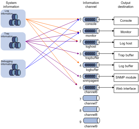

Information Center Overview
Introduction to Information Center
Acting as the system information hub, information center classifies and manages system information. Together with the debugging functionality, information center offers a powerful support for network administrators and developers in monitoring network performance and diagnosing network problems.
The following describes the working process of the information center:
l          Receives the log, trap, and debugging information generated by each module.
l          Outputs the above information to different information channels according to the user-defined output rules.
l          Outputs the information to different destinations based on the information channel-to-destination associations.
To sum up, information center assigns the log, trap and debugging information to the ten information channels according to the eight severity levels and then outputs the information to different destinations. The following describes the working process in details.

Seven Output Destinations and Ten Channels of System Information
The system supports seven information output destinations, including the console, monitor terminal (monitor), logbuffer, loghost, trapbuffer, SNMP module, and web interface (syslog).
The system supports ten channels. The six channels 0 through 6 are configured with channel names, output rules, and are associated with output destinations by default. The channel names, output rules and the associations between the channels and output destinations can be changed through commands. Besides, you can configure channels 7, 8, and 9 without changing the default configuration of the seven channels.
Table 1-2 Information channels and output destinations
