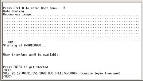

5.          Power on the device and press Enter as prompted.
The default user view prompt <H3C> appears. You can enter commands to configure or manage the device. To get help, enter ?.
Press Ctrl-B to enter Boot Menu   0
Auto-booting
Decompress Image
   OK!
Starting at 0x80100000
Cryptographic algorithms tests passed.
User interface aux0 is available.
Press ENTER to get started.
<H3C>%Sep 24 09:48:54:109 2014 H3C SHELL/4/LOGIN: Console login from aux0
<H3C>

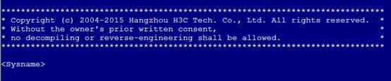

The next time you Telnet to the device, you do not need to provide a username or password, as shown in Figure 3. If the maximum number of login users has been reached, your login attempt fails and the message "All user lines are used, please try later!" appears.
Figure 3 Telnetting to the device without authentication

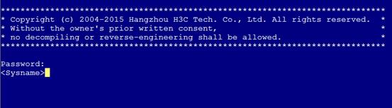

The next time you Telnet to the device, you must provide the configured login password, as shown in Figure 4. If the maximum number of login users has been reached, your login attempt fails and the message "All user lines are used, please try later!" appears.
Figure 4 Password authentication interface for Telnet login

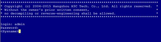

The next time you Telnet to the CLI, you must provide the configured login username and password, as shown in Figure 5. If the maximum number of login users has been reached, your login attempt fails and the message "All lines are used, please try later!" appears.

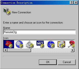

6.          Launch the terminal emulation program on the PC and create a connection using the telephone number of the device-side modem.
Figure 9 through Figure 12 show the configuration procedure in Windows XP HyperTerminal. On Windows Server 2003, add the HyperTerminal program first, and then log in to and manage the device as described in this document. On Windows Server 2008, Windows 7, Windows Vista, or another operating system, obtain a third-party terminal control program first. Then, follow the user guide or online help of that program to log in to the device.
Figure 9 Creating a connection

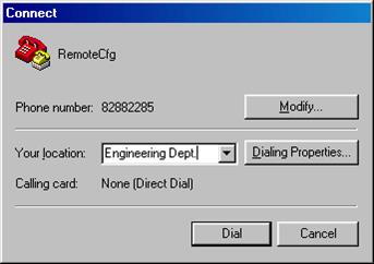

7.          Dial the telephone number to establish a connection to the device.
Figure 11 Dialing the number
8.          After you hear the dial tone, press Enter as prompted.
If the authentication mode is none, the prompt <H3C> appears. If the authentication mode is password or scheme, you must enter the correct authentication information as prompted.
Figure 12 Login page

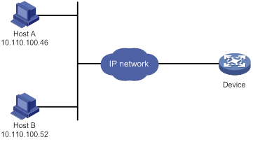

Configuration example
Network requirements
As shown in Figure 14, the device is a Telnet server.
Configure the device to permit only Telnet packets sourced from Host A and Host B.
Figure 14 Network diagram
Configuration procedure
# Configure an ACL to permit packets sourced from Host A and Host B.
<Sysname> system-view
[Sysname] acl number 2000 match-order config
[Sysname-acl-basic-2000] rule 1 permit source 10.110.100.52 0
[Sysname-acl-basic-2000] rule 2 permit source 10.110.100.46 0
[Sysname-acl-basic-2000] quit
# Apply the ACL to filter Telnet logins.
[Sysname] telnet server acl 2000

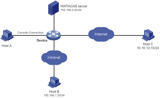

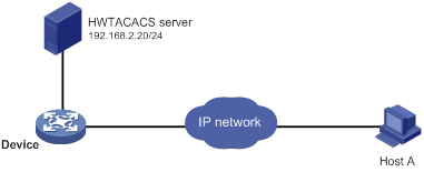

As shown in Figure 16, Host A needs to log in to the device to manage the device.
Configure the device to perform the following tasks:
·           Allows Host A to Telnet in after authentication.
·           Uses the HWTACACS server to control the commands that the user can execute.
·           If the HWTACACS server is not available, uses local authorization.
Figure 16 Network diagram
# Assign IP addresses to relevant interfaces. Make sure the device and the HWTACACS server can reach each other. Make sure the device and Host A can reach each other. (Details not shown.)
# Enable the Telnet server.
<Device> system-view
[Device] telnet server enable
# Enable scheme authentication for user lines VTY 0 through VTY 63.
[Device] line vty 0 63
[Device-line-vty0-63] authentication-mode scheme
# Enable command authorization for the user lines.
[Device-line-vty0-63] command authorization
[Device-line-vty0-63] quit
# Create HWTACACS scheme tac.
[Device] hwtacacs scheme tac
# Configure the scheme to use the HWTACACS server at 192.168.2.20:49 for authentication and authorization.
[Device-hwtacacs-tac] primary authentication 192.168.2.20 49
[Device-hwtacacs-tac] primary authorization 192.168.2.20 49
# Set the shared keys to expert.
[Device-hwtacacs-tac] key authentication expert
[Device-hwtacacs-tac] key authorization expert
# Remove domain names from usernames sent to the HWTACACS server.
[Device-hwtacacs-tac] user-name-format without-domain
[Device-hwtacacs-tac] quit
# Configure the system-predefined domain system. Use the HWTACACS scheme tac for login user authentication and command authorization. Use local authentication and local authorization as the backup method.
[Device] domain system
[Device-isp-system] authentication login hwtacacs-scheme tac local
[Device-isp-system] authorization command hwtacacs-scheme tac local
[Device-isp-system] quit
# Create local user monitor. Set the password to 123, the service type to Telnet, and the default user role to level-1.
[Device] local-user monitor
[Device-luser-manage-admin] password cipher 123
[Device-luser-manage-admin] service-type telnet
[Device-luser-manage-admin] authorization-attribute user-role level-1
As shown in Figure 17, users need to log in to the device to manage the device.
Configure the device to send commands executed by users to the HWTACACS server to monitor and control user operations on the device.
Figure 17 Network diagram
# Enable command accounting for user line AUX 0.
[Device] line aux 0
[Device-line-aux0] command accounting
[Device-line-aux0] quit
# Enable command accounting for user lines VTY 0 through VTY 63.
[Device-line-vty0-63] command accounting
# Configure the scheme to use the HWTACACS server at 192.168.2.20:49 for accounting.
[Device-hwtacacs-tac] primary accounting 192.168.2.20 49
# Set the shared key to expert.
[Device-hwtacacs-tac] key accounting expert
# Configure the system-predefined domain system to use the HWTACACS scheme for command accounting.
[Device-isp-system] accounting command hwtacacs-scheme tac
