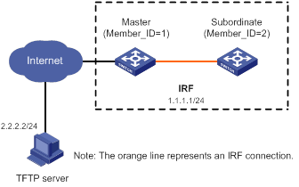

ISSU examples for using issu commands
Software image upgrade to a compatible version
Upgrade requirements
As shown in Figure 1, the IRF fabric has two members.
Upgrade feature1 from R0201 to R0202. The two versions are compatible.
Figure 1 Network diagram

Software image upgrade to an incompatible version
As shown in Figure 2, the IRF fabric has two members.
Upgrade feature1 from R0201 to R0202. The two versions are incompatible.
Figure 2 Network diagram

Software image rollback example
Rollback requirement
As shown in Figure 3, the IRF fabric has two members.
Roll back feature1 from R0202 to R0201 after upgrading it from R0201 to R0202. The two versions are compatible.
Figure 3 Network diagram

ISSU examples for using install commands
Software image upgrade example
As shown in Figure 4, the IRF fabric has two members.
Figure 4 Network diagram

Software image patching example
Patching requirements
As shown in Figure 5, the IRF fabric has two members.
Patch the software images running on the members.
Figure 5 Network diagram
Patching procedure
