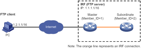

FTP server configuration example
Network requirements
·           Configure the device as an FTP server.
·           Create a local user account with username abc and password 123456 on the FTP server.
·           Use the user account to log in to the FTP server from the FTP client.
·           Upload the file temp.bin from the FTP client to the FTP server.
·           Download the configuration file config.cfg from the FTP server to the FTP client for backup.
Figure 2 Network diagram
Configuration procedure
1.          Configure IP addresses as shown in Figure 2. Make sure the IRF fabric and the PC can reach each other. (Details not shown.)
2.          Configure the FTP server:
# Examine the storage space on the member devices. If the free space is insufficient, use the delete/unreserved file-url command to delete unused files. (Details not shown.)
# Create a local user account abc, set the password to 123456, the user role to network-admin, the working directory to the root directory of the Flash, and the service type to FTP. (To set the working directory to the Flash root directory of the subordinate member, replace flash:/ in the authorization-attribute command with slot2#flash:/.)
# Create a local user with the username abc and password 123456.
<Sysname> system-view
[Sysname] local-user abc class manage
[Sysname-luser-manage-abc] password simple 123456
# Assign the user role network-admin to the user. Set the working directory to the root directory of the flash memory.
[Sysname-luser-manage-abc] authorization-attribute user-role network-admin work-directory flash:/
# Assign the service type FTP to the user.
[Sysname-luser-manage-abc] service-type ftp
[Sysname-luser-manage-abc] quit
# Enable the FTP server.
[Sysname] ftp server enable
[Sysname] quit
3.          Perform FTP operations from the FTP client:
# Log in to the FTP server at 1.1.1.1 using the username abc and password 123456.
c:\> ftp 1.1.1.1
Connected to 1.1.1.1.
220 FTP service ready.
User(1.1.1.1:(none)):abc
331 Password required for abc.
Password:
230 User logged in.
# Use the ASCII mode to download the configuration file config.cfg from the FTP server to the PC for backup.
ftp> ascii
200 TYPE is now ASCII
ftp> get config.cfg back-config.cfg
# Use the binary mode to upload the file temp.bin from the PC to the Flash root directory of the master.
ftp> binary
200 TYPE is now 8-bit binary
ftp> put temp.bin
# Exit FTP.
ftp> bye
