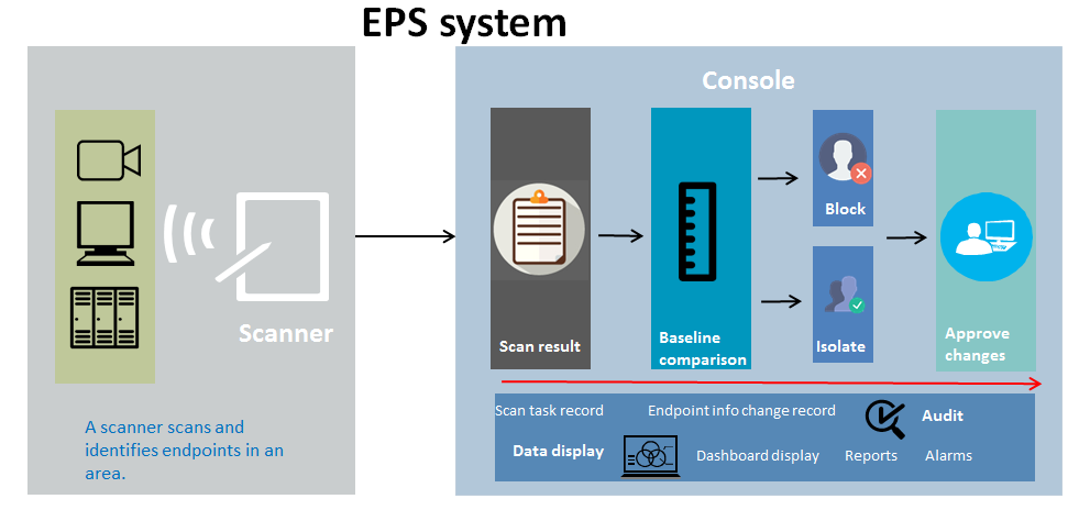

As shown in Figure 1, an EPS system contains the EPS server, scanners, and endpoints.
Figure 1 EPS network architecture
EPS server
The EPS server is a server installed with the iMC EPS component. It acts as the console to assign instructions to scanners, receive scan results, compare scan results with baselines, and support change auditing.
Scanner
A scanner is a device installed with iMC EScan and enabled with EPS agent. The scanner scans and manages endpoints by following the instruction of the EPS server and reports scan results to the EPS server.
EPS agent is based on the Comware platform and integrates the EPS scanner function. This chapter describes how to configure EPS agent.
Endpoint
An endpoint refers to a device scanned by a scanner. EPS supports user-defined endpoint types and the following system-defined endpoint types: camera, PC, server, switch, router, firewall, AP, printer, ATM, unknown, and other.

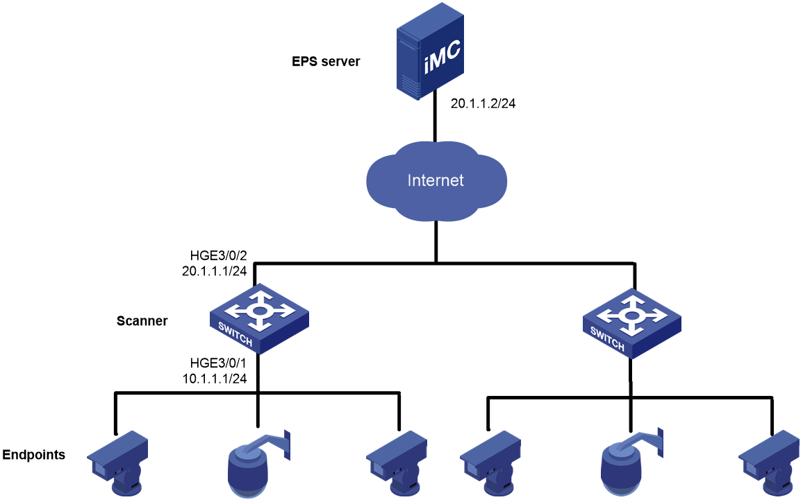

As shown in Figure 2, configure the scanner to enable it to scan endpoints based on the instruction of the EPS server.
