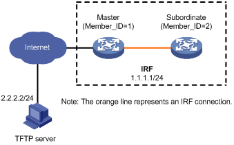

Examples of using issu commands for ISSU (in IRF mode)
Example: Upgrading a feature to a compatible version
Upgrade requirements
As shown in Figure 4, the IRF fabric has two members.
Upgrade the Feature1 feature from T0001015 to T0001016. The two versions are compatible.
Figure 4 Network diagram
Upgrade procedure
# Download the image file that contains the T0001016 Feature1 feature from the TFTP server.

Example: Upgrading a feature to an incompatible version
As shown in Figure 5, the IRF fabric has two members.
Upgrade the Feature1 feature from T0001015 to T0001016, which is an incompatible version.
Figure 5 Network diagram
Upgrade procedure

Example: Rolling back a feature
Rollback requirement
As shown in Figure 6, the IRF fabric has two members.
Roll back the Feature1 feature from T0001016 to T0001015 after upgrading it from T0001015 to T0001016. T0001016 and T0001015 are compatible.
Figure 6 Network diagram
Rollback procedure

Examples of using install commands for ISSU (in IRF mode)
As shown in Figure 8, the IRF fabric has two members.
Figure 8 Network diagram
Upgrade procedure
As shown in Figure 8, the IRF fabric has two members. The Feature1 feature has been upgraded from T0001015 to T0001016. However, the software change has not been committed.
Roll back the Feature1 feature from T0001016 to T0001015.
