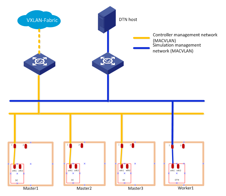

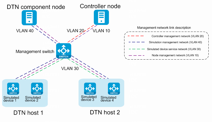

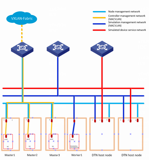

A simulation network includes four types of networks, including node management network, controller management network, simulation management network, and simulated device service network.
·     Node management networkNetwork over which you can log in to servers to perform routine maintenance.
·     Controller management networkNetwork for cluster communication between controllers and device management.
·     Simulation management networkNetwork over which the digital twin network (DTN) microservice component and DTN hosts exchange management information.
·     Simulated device service networkNetwork over which the DTN hosts exchange service data. When multiple DTN hosts exist, they must communicate with each other through a switch, as shown in Figure 1. If only one DTN host exists, a connection between the DTN host and the switch is not needed, as shown in Figure 2.
Before you deploy the simulation system, plan the simulation management network and simulated device service network.
Figure 1 Typical simulation network topology design for the Cloud DC scenario in non-remote disaster recovery mode (with multiple DTN hosts)
Figure 2 Typical simulation network topology design for the Cloud DC scenario in non-remote disaster recovery mode (with one DTN host)
CAUTION
CAUTION:
·     If the controller management network and simulation management network use the same management switch, you must also configure VPN instances for isolation on the management switch to prevent IP address conflicts from affecting the services. If the controller management network and simulation management network use different management switches, physically isolate these switches. For the Layer 3 network configuration, see "Configure the management networks."
·     Configure routes to provide Layer 3 connectivity between simulation management IPs and simulated device management IPs.
·     On the port connecting the switch to the service interface of a DTN host, execute the port link-type trunk command to configure the link type of the port as trunk, and execute the port trunk permit vlan vlan-id-list command to assign the port to 150 contiguous VLAN IDs. Among these VLAN IDs, the start ID is the VLAN ID specified when installing the DTN host, and the end VLAN ID is the start VLAN ID+149. For example, if the start VLAN ID is 11, the permitted VLAN ID range is 11 to 160. When you plan the network, do not use any VLAN ID permitted by the port.
·     When the device and controllers are deployed across Layer 3 networks, the simulation hosts and DTN component must be connected through the management switch.

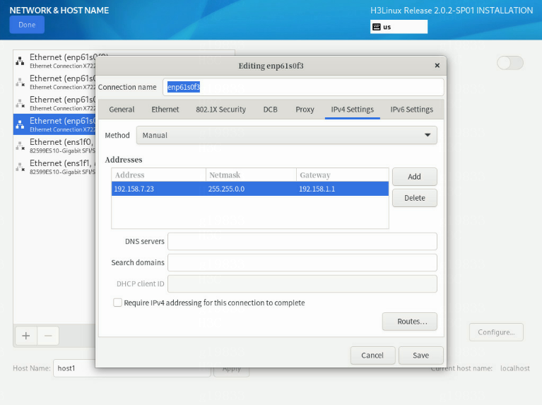

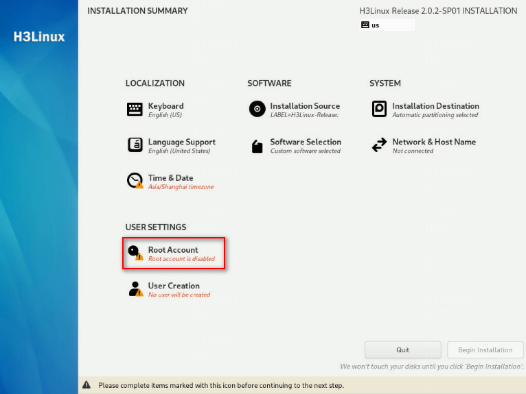

1.     Obtain the required H3Linux-2.0.2-SP01-x86_64-dvd.iso image in ISO format.
2.     Access the remote console of the server, and then mount the ISO image as a virtual optical drive.
3.     Configure the server to boot from the virtual optical drive, and then restart the sever.

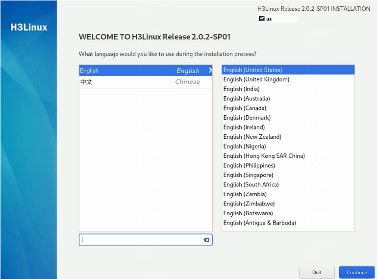

4.     After loading is completed, access the page for selecting a language. In this example, select English. Click Continue.
Figure 3 Selecting the language

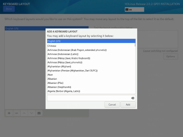

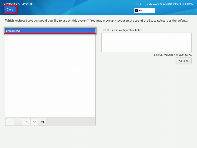

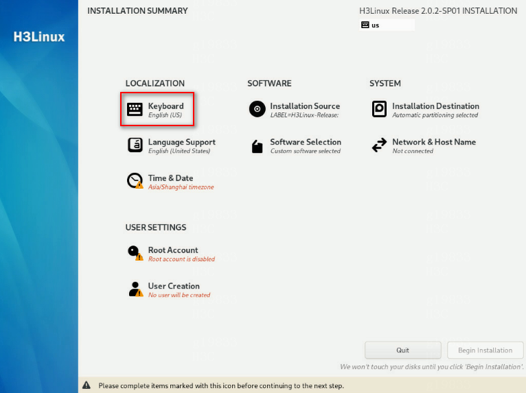

5.     Click the KEYBOARD (K) link in the LOCALIZATION area to select the keyboard layouts. Click the + button to add a keyboard layout. In this example, add Chinese. After selecting the keyboard layout, click Done.
By default, only the English (United States) option is selected.
Figure 4 Localization - Keyboard
Figure 5 Adding the Chinese keyboard layout
Figure 6 Selecting the Chinese keyboard layout

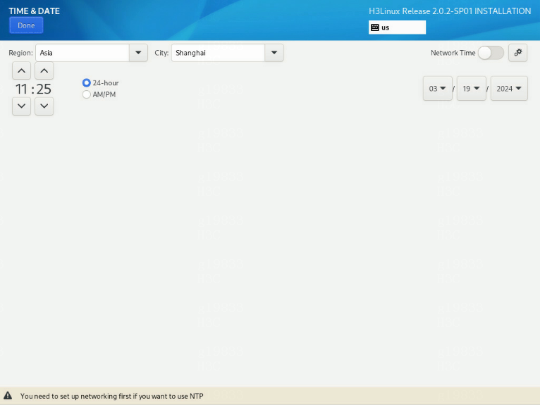

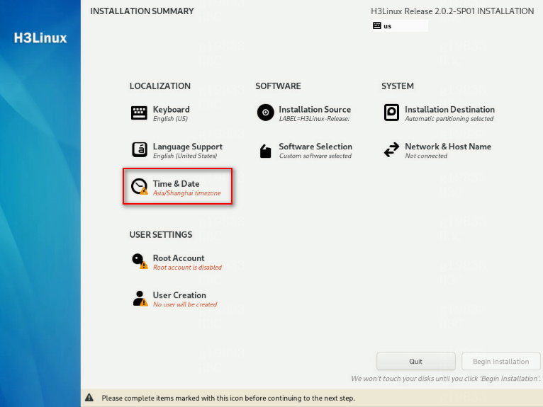

6.     Click the DATE & TIME (T) link in the LOCALIZATION area to access the date & time selection page. In this example, select Asia/Shanghai/16:25. Click Done.
Figure 7 Selecting date & time (T)
Figure 8 Selecting the Asia/Shanghai time zone

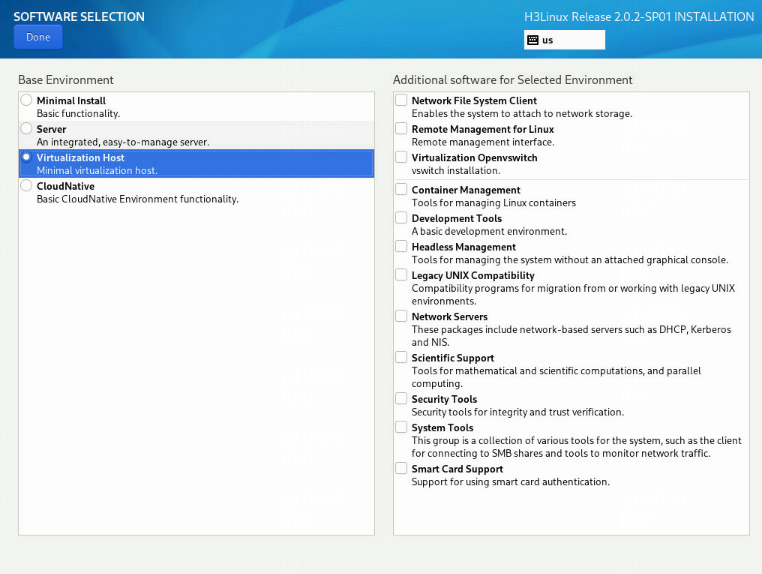

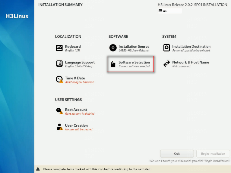

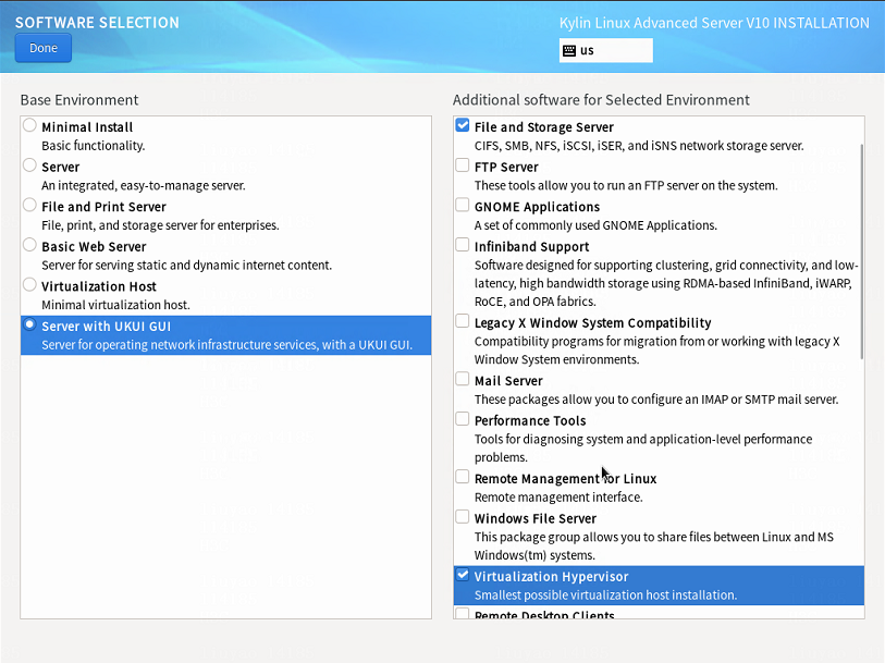

7.     Click the SOFTWARE SELECTION (S) link in the SOFTWARE area and access the page for selecting software. Select the Virtualization Host option in the Base Environment area, and click Done to return to the installation summary page.
Figure 9 Software selection page
Figure 10 Selecting the virtualization host option in the base environment area

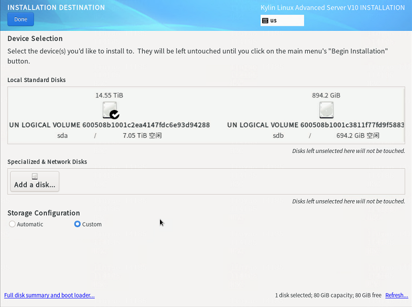

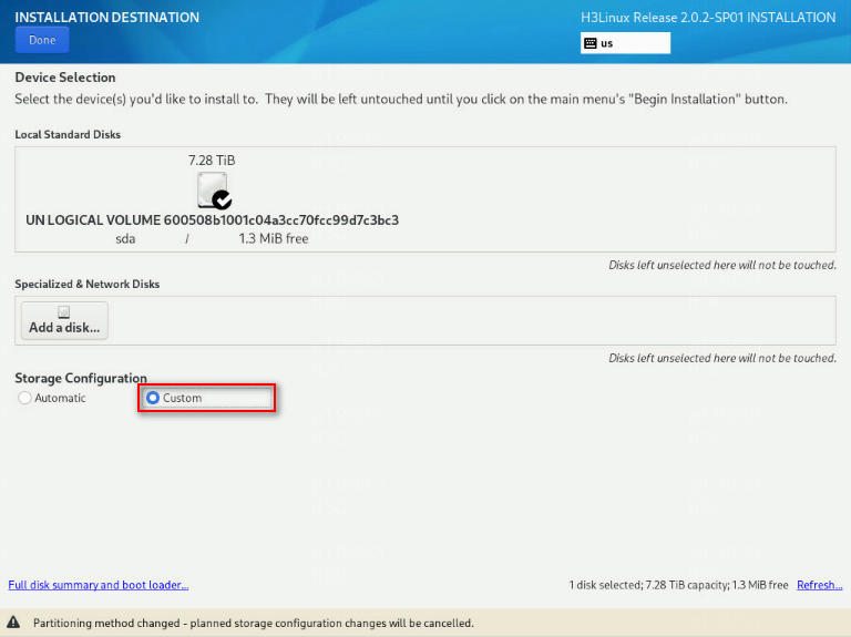

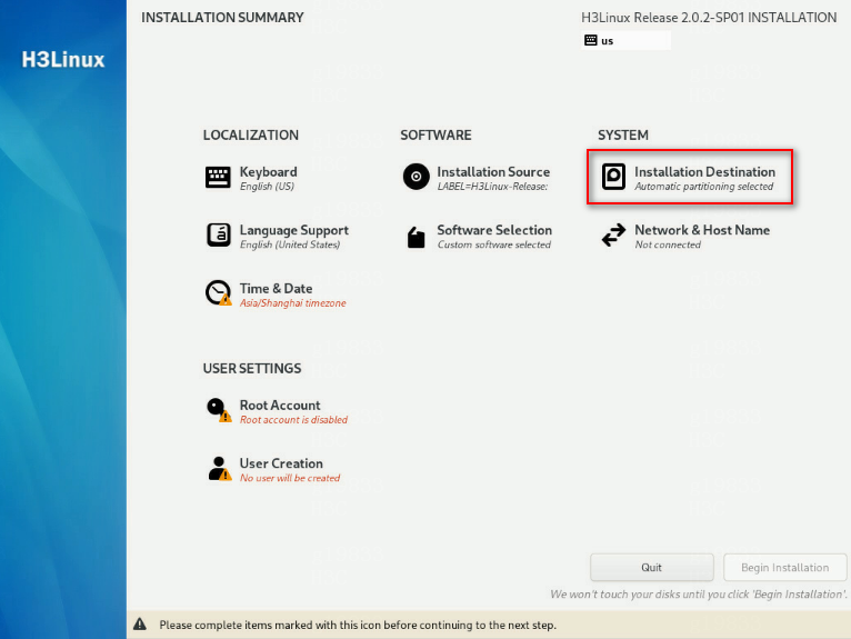

8.     Click the INSTALLATION DESTINATION (D) link in the SYSTEM area to access the page for selecting the installation destination. In the Local Standard Disks area, select the target disk. In the Storage Configuration area, select the Custom option. Click Done to access the manual partitioning page.
Figure 11 INSTALLATION DESTINATION page
Figure 12 Selecting the Custom option

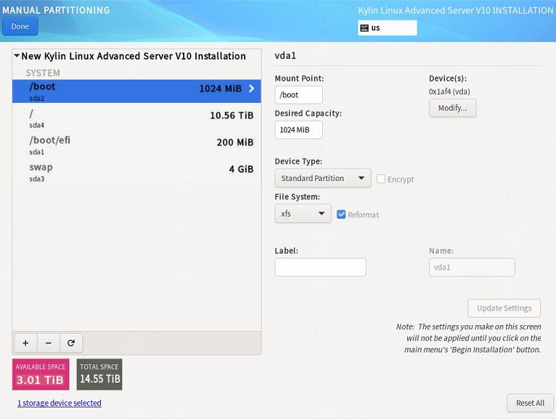

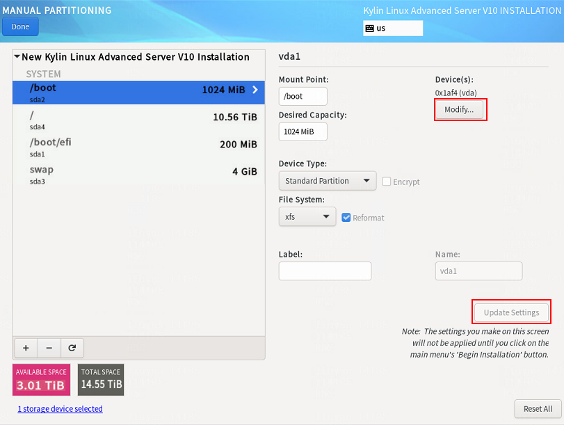

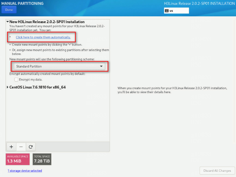

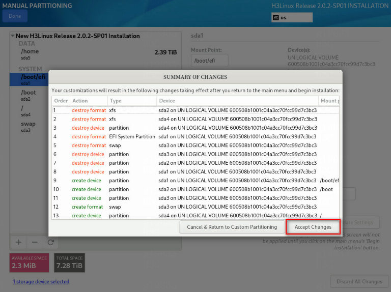

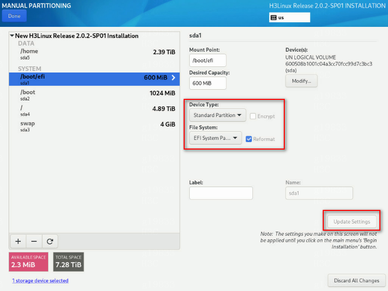

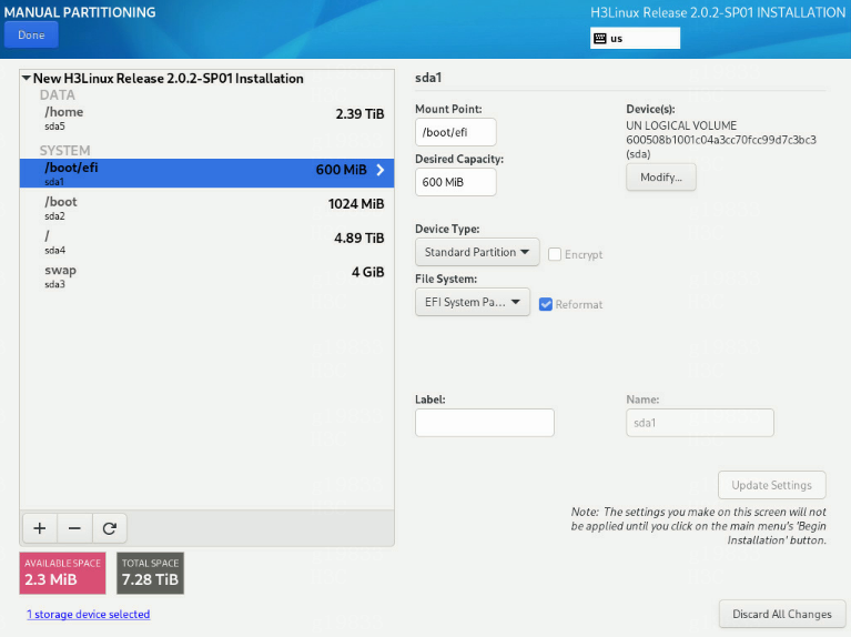

9.     On the manual partitioning page, select the standard partitioning scheme. Click Click here to create them automatically (C) to automatically generate recommended partitions.
By default, the LVM partitioning scheme is selected.
Figure 13 MANUAL PARTITIONING page
The list of automatically created partitions opens. Figure 14 shows the list of automatically created partitions.
IMPORTANT
IMPORTANT:
The /boot/efi partition is available only if UEFI mode is enabled for OS installation.
Figure 14 Automatically created partition list
10.     As a best practice to improve system stability, set the device type to Standard Partition.
Table 6 shows the device type and file system of each partition used in this document.
Table 6 Partition settings
Partition name
Device type
File system
/boot
Standard partition
xfs
/boot/efi (UEFI mode)
Standard partition
EFI System Partition
Standard partition
xfs
/swap
Standard partition
swap
11.     Edit the device type and file system of a partition. Take the /boot/efi partition as an example. Select a partition on the left, and select Standard Partition from the Device Type list and EFI System Partition from the File System list. Then, click Update Settings.
Figure 15 Editing the device type and file system

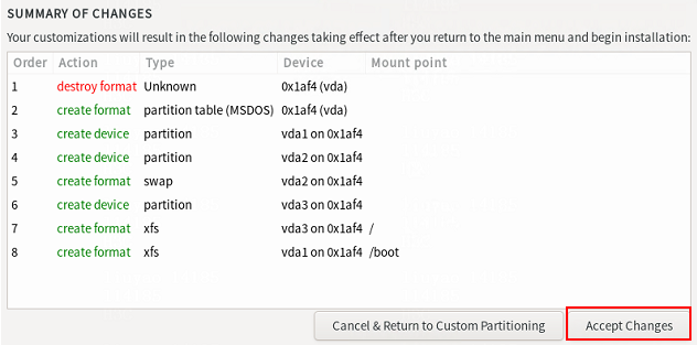

12.     After you finish the partitioning task, click Done in the upper left corner. In the dialog box that opens, select Accept Changes.
Figure 16 Accepting changes

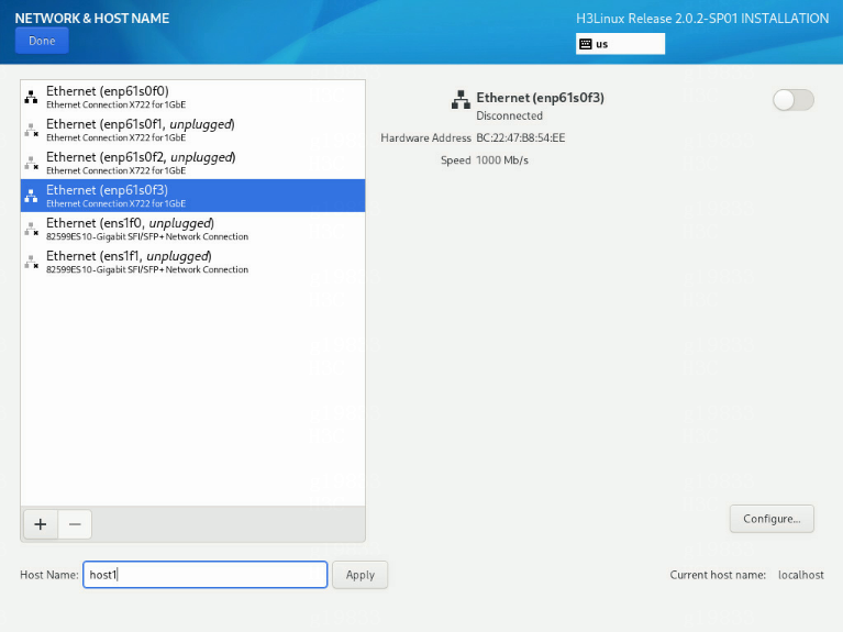

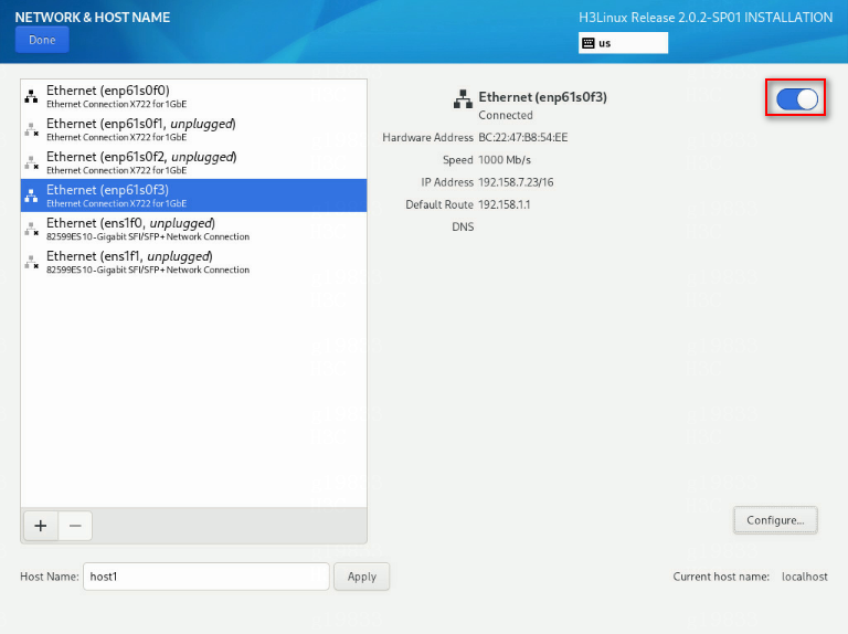

13.     In the INSTALLATION SUMMARY window that opens, click NETWORK & HOSTNAME in the SYSTEM area to configure the host name and network settings.
14.     In the Host name field, enter the host name (for example, host01) for this server, and then click Apply.
Figure 17 Setting the host name
15.     Configure the network settings:
IMPORTANT
IMPORTANT:
Configure network ports as planned. The server requires a minimum of three network ports.
·     The network port IP for the simulation management network is used for communication with the DTN component.
·     The network port IP for the simulated device service network is used for service communication between simulated devices. Specify this IP address in the installation script in “Configure the DTN hosts”, and you do not need to specify this IP address in this section.
·     The network port IP for the node management network is used for routine maintenance of servers.
a.     Select a network port and then click Configure.
b.     In the dialog box that opens, configure basic network port settings on the General tab:
-     Select the Automatically connect to this network when it is available option .
-     Verify that the All users may connect to this network option is selected. By default, this option is selected.
Figure 18 General settings for a network port
16.     Configure IP address settings:
a.     Click the IPv4 Settings or IPv6 Settings tab.
b.     From the Method list, select Manual.
c.     Click Add, assign a simulation management IP address to the DTN host, and then click Save.
d.     Click Done in the upper left corner of the dialog box.
IMPORTANT
IMPORTANT:
DTN service supports IPv4 and IPv6. In the current software version, only a single stack is supported.
Figure 19 Configuring IPv4 address settings for a network port

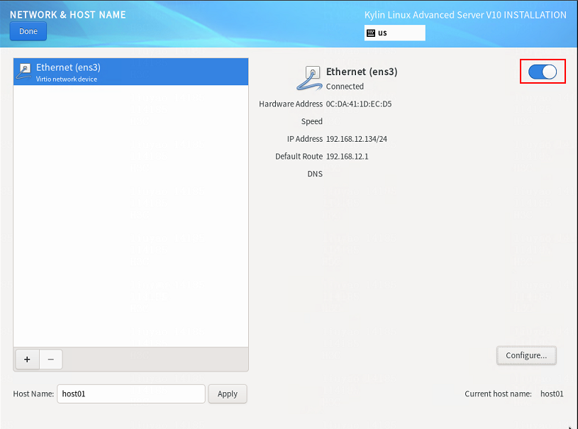

17.     On the NETWORK & HOST NAME page, enable the specified Ethernet connection.
Figure 20 Enabling an Ethernet connection
18.     Repeat steps 15 through 17 to configure the management IP addresses for other DTN hosts.
The IP addresses must be in the network address pool containing IP addresses 192.168.10.110 to 192.168.10.120, for example, 192.168.10.110.

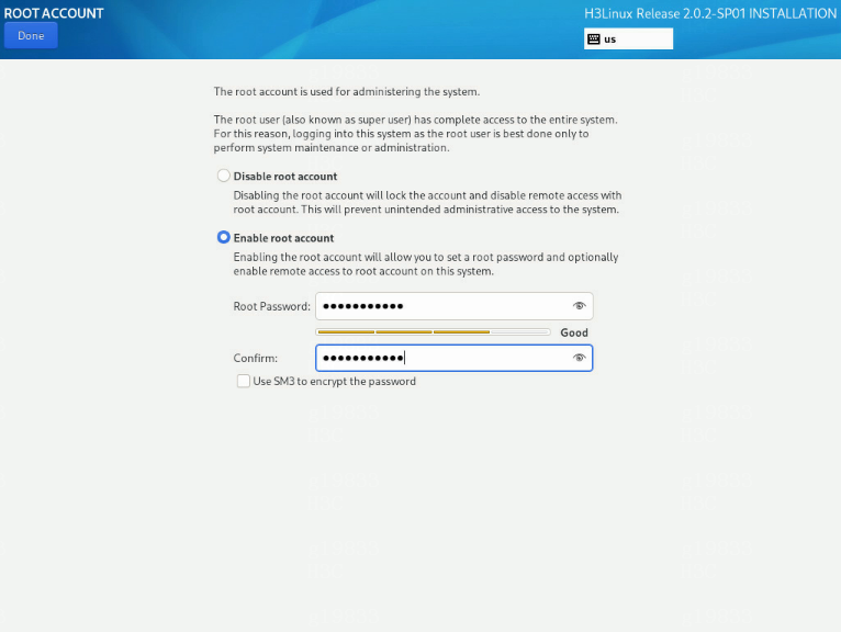

19.     In the USER SETTINGS area, click the ROOT ACCOUNT link if you use the root user as the administrator. On the ROOT ACCOUNT page, enable the root account and configure the root password. If you use the Admin user as the administrator, you can click the USER CREATION (U) link to configure the relevant information for the admin user.
Figure 21 Setting the root account
Figure 22 Configuring the root password

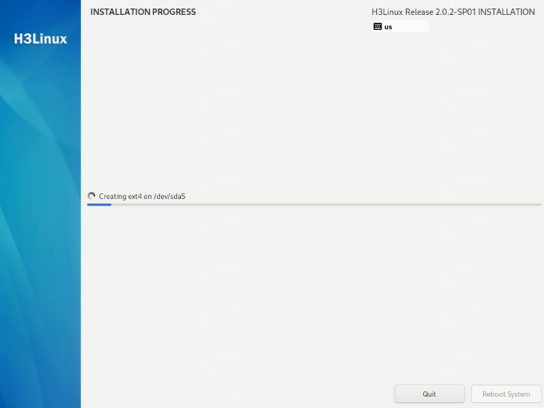

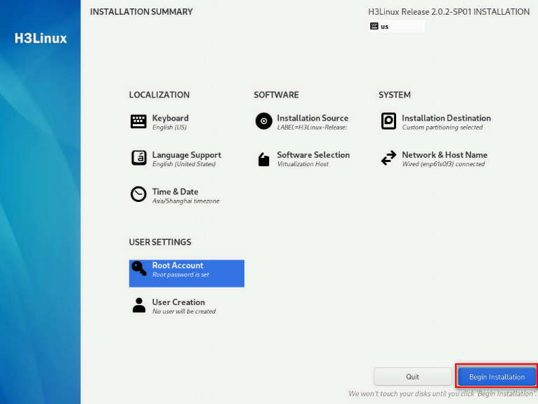

20.     After completing the above configuration, click Begin Installation.
Figure 23 Clicking the Begin Installation button
21.     After the installation is complete, click Reboot System.
Figure 24 Operating system installation in progress

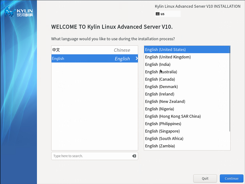

4.     After the ISO image is loaded, select a language used during the installation process.
English is selected in this example.
Figure 25 Selecting a language used during the installation process

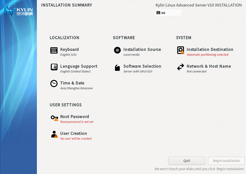

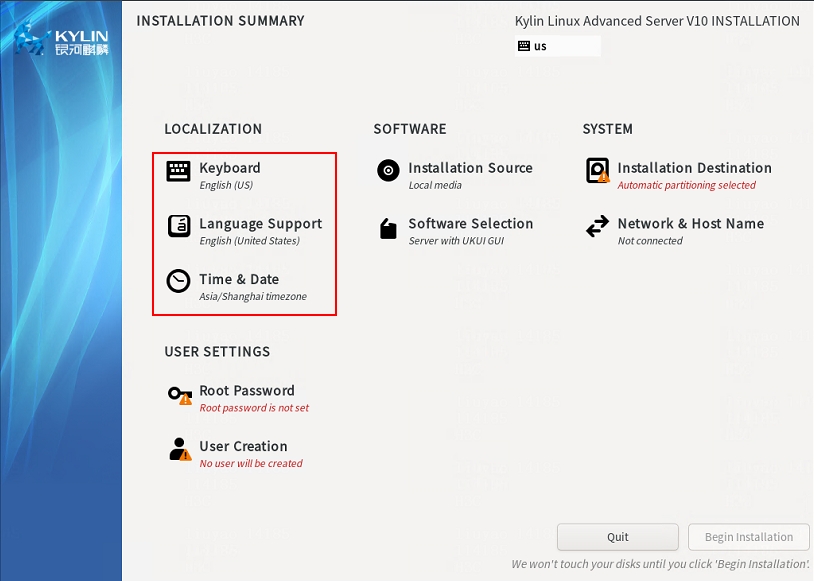

5.     The INSTALLATION SUMMARY page opens.
Figure 26 INSTALLATION SUMMARY page
6.     In the LOCALIZATION area, perform the following tasks:
¡     Click KEYBOARD to select the keyboard layout.
¡     Click LANGUAGE SUPPORT to select your preferred language.
¡     Click TIME & DATE to set the system date and time. Make sure you configure the same time zone for all hosts. The Asia/Shanghai timezone is specified in this example.
Figure 27 INSTALLATION SUMMARY page

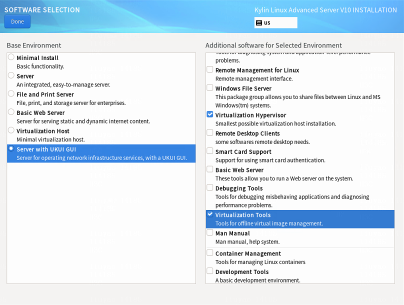

7.     Click SOFTWARE SELECTION in the SOFTWARE area to enter the page for selecting software. Select the Server with UKUI GUI base environment and the File and Storage Server, Virtualization Hypervisor, and Virtualization Tools additional software for the selected environment. Then, click Done to return to the INSTALLATION SUMMARY page.
Figure 28 Selecting software (1)
Figure 29 Selecting software (2)
8.     In the SYSTEM area, click INSTALLATION DESTINATION.
9.     On the INSTALLATION DESTINATION page, perform the following tasks:
a.     Select the target disk from the Local Standard Disks area.
b.     Select Custom in the Storage Configuration area.
c.     Click Done.
Figure 30 INSTALLATION DESTINATION page

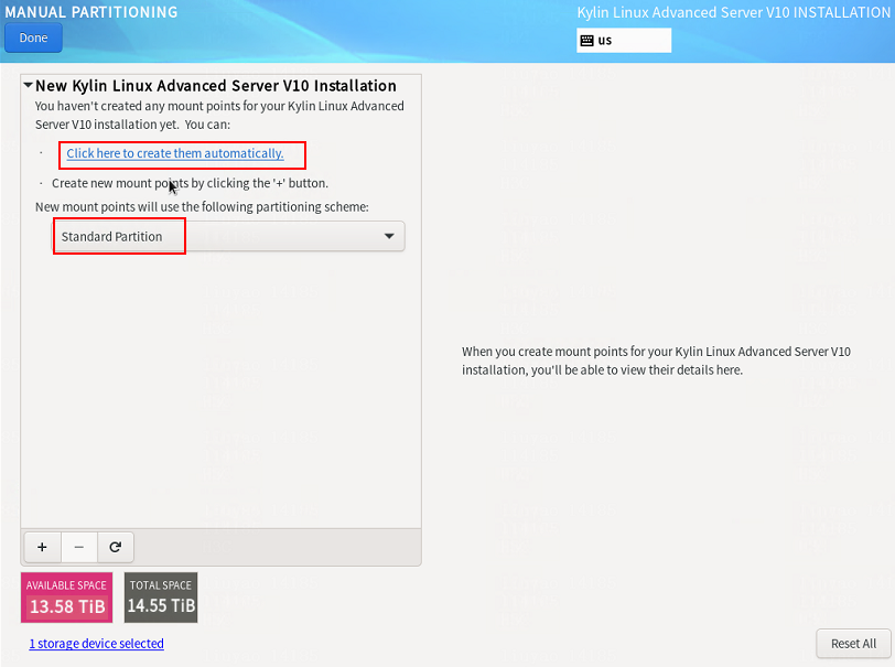

10.     On the MANUAL PARTITIONING page, select the Standard Partition partitioning scheme and then click Click here to create them automatically to automatically generate recommended partitions.
Figure 31 MANUAL PARTITIONING page
11.     The list of automatically created partitions is displayed.
The /boot/efi partition is available only if UEFI mode is enabled for OS installation. If this partition does not exist, add it manually.
Figure 32 Automatically created partition list
12.     Set the device type and file system for each partition. As a best practice, set the device type to Standard Partition to improve system stability. Table 7 shows the device type and file system of each partition used in this document.
Table 7 Partition settings
Partition name

13.     Edit the device type and file system of a partition as shown in Figure 33. Take the /boot partition for example. Select a partition on the left, and select Standard Partition from the Device Type list and xfs from the File System list. Then, click Update Settings.
Figure 33 Configuring partitions
14.     After you finish the partitioning task, click Done in the upper left corner. In the dialog box that opens, select Accept Changes.
Figure 34 Accepting changes

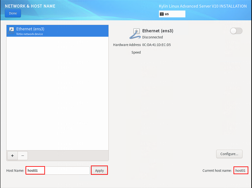

15.     In the INSTALLATION SUMMARY window that opens, click NETWORK & HOSTNAME in the SYSTEM area to configure the host name and network settings.
16.     In the Host name field, enter the host name (for example, host01) for this server, and then click Apply.
Figure 35 Setting the host name

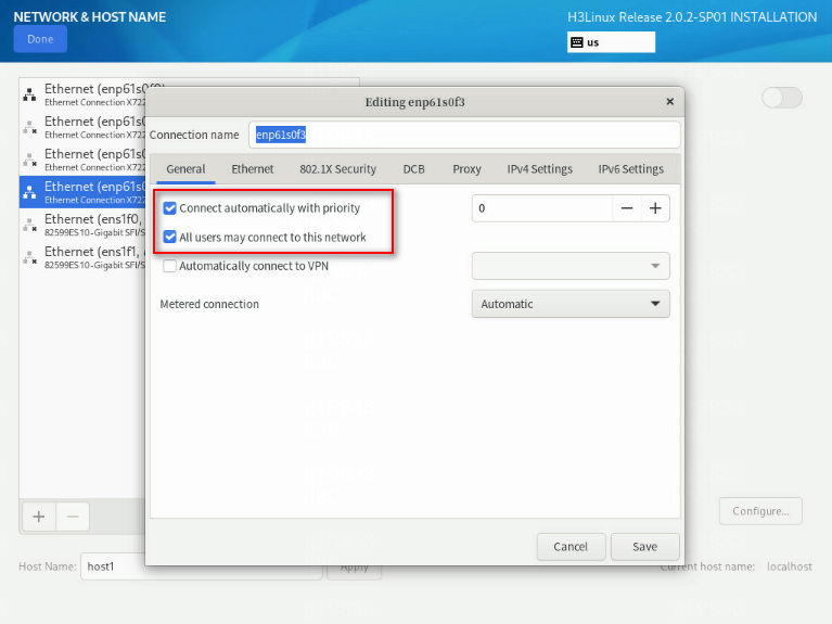

17.     Configure the network settings:
IMPORTANT
IMPORTANT:

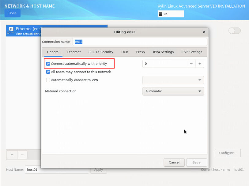

-     Select the Connect automatically with priority option.
Figure 36 General settings for a network port

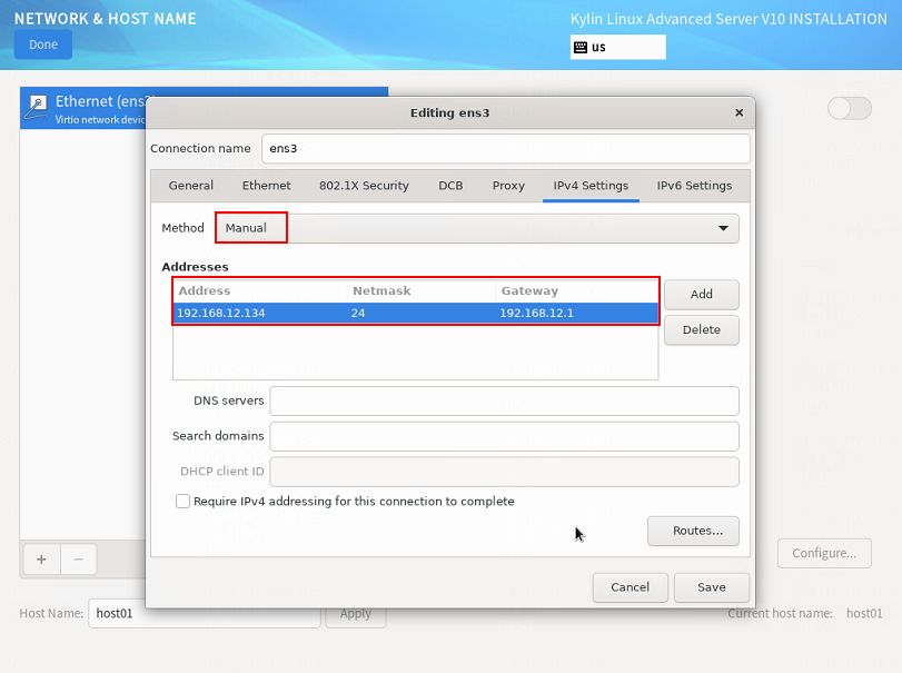

18.     Configure IP address settings:
IMPORTANT
IMPORTANT:
Figure 37 Configuring IPv4 address settings for a network port
Figure 38 Enabling Ethernet connection
19.     Repeat step 17 and step 18 to configure the management IP addresses for other DTN hosts. The IP addresses must be in the network address pool containing IP addresses 192.168.10.110 to 192.168.10.120, for example, 192.168.10.110.

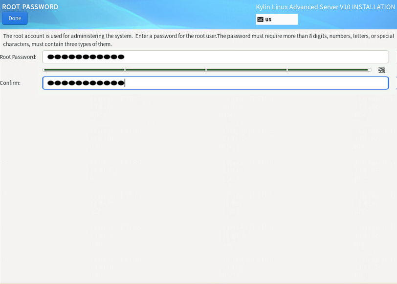

20.     On the INSTALLATION SUMMARY page, click Root Password in the USER SETTINGS area. In the dialog box that opens, set the root password for the system, and then click Done in the upper left corner.
Figure 39 Setting the root password

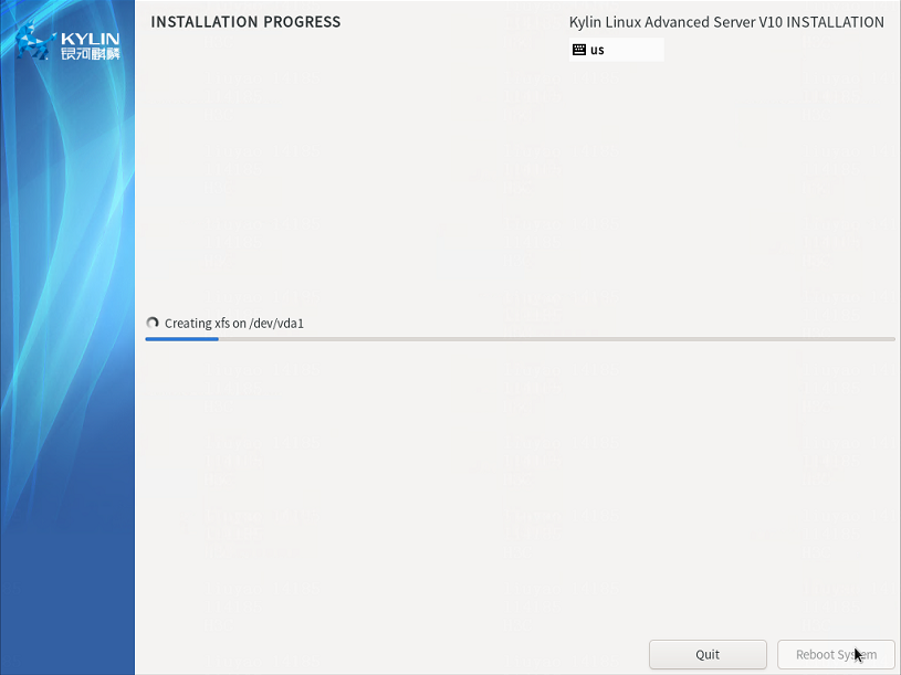

21.     Click Begin Installation to install the OS. After the installation is complete, click Reboot System in the lower right corner.
Figure 40 Installation in progress

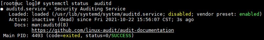

Disabling the auditd service
The auditd service might be memory intensive. If you are not to use the auditd service on the Kylin V10SP02 operating system, disable the auditd service.
To disable the auditd service:
1.     Stop the auditd service.
[root@uc log]# systemctl stop auditd
2.     Disable the auditd service.
[root@uc log]# systemctl disable auditd
3.     Confirm the state of the auditd service.
[root@uc log]# systemctl status auditd
Figure 41 Disabling the auditd service

Plan network topology
A simulation network includes three types of networks, including controller management network, simulation management network, and simulated device service network.
·     Controller management network—Network for cluster communication between controllers and device management.
·     Simulation management network—Network over which the other components and DTN hosts exchange management information.
·     Simulated device service network—Network connected to the default bridge virbr0 of libvirt. The bridge is not bound to a physical NIC. In the current software version, only one lite host is supported.

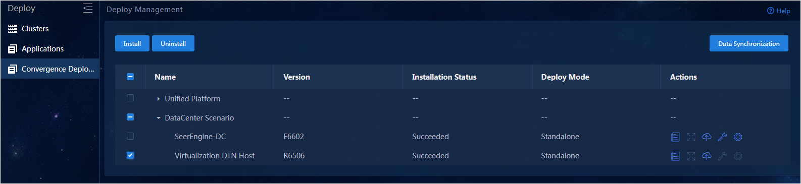

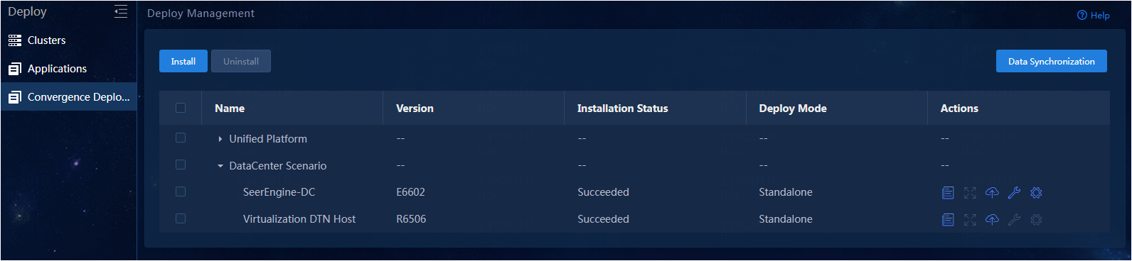

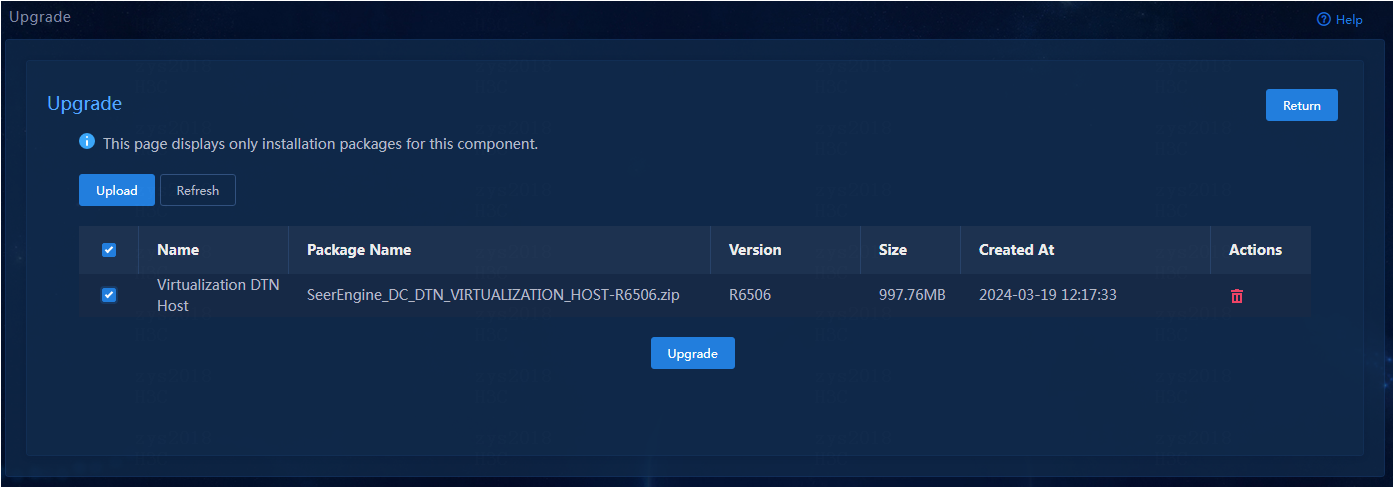

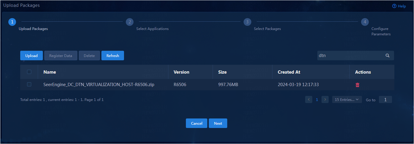

2.     Access the Deploy > Convergence Deployment page, upload the installation package SeerEngine_DC_DTN_VIRTUALIZATION_HOST-version.zip, and click Next after the upload is completed.
Figure 43 Uploading the installation package

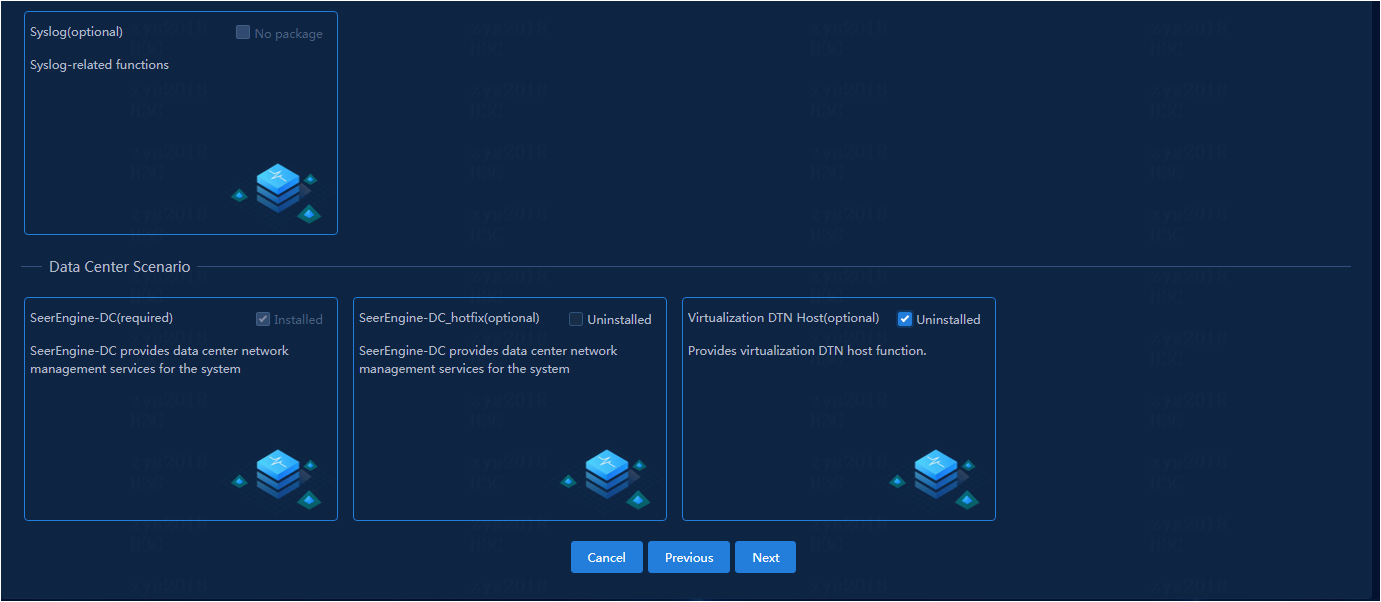

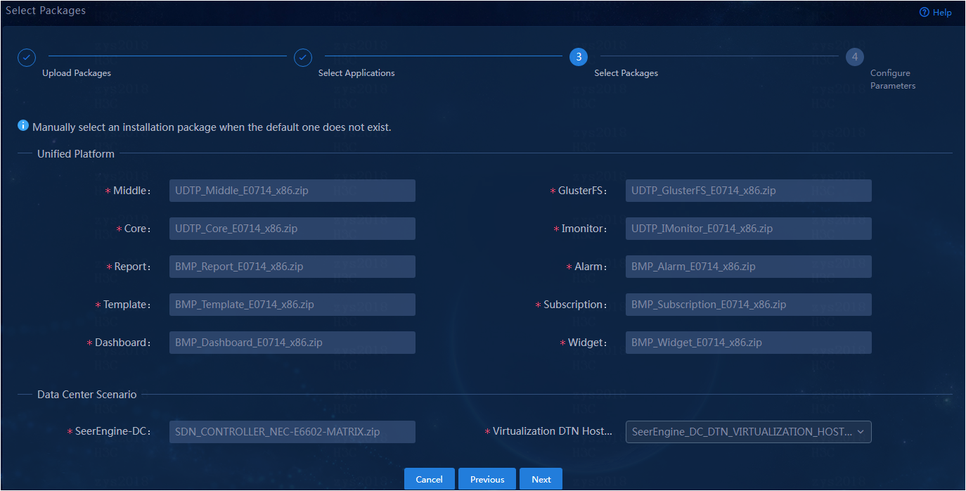

3.     On the application selection page, select the Virtualization DTN Host (optional) option. Click Next.
Figure 44 Selecting applications
4.     On the software installation package selection page, select the virtualization DTN host component package to be deployed. Click Next.
Figure 45 Selecting installation packages

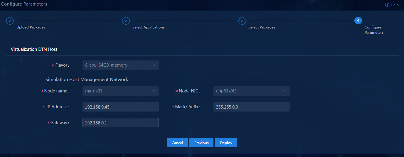

5.     On the parameter configuration page, configure the necessary parameters for the virtualization DTN host. Click Deploy.
Table 10 Virtualization DTN host parameters
Parameter
Description
Flavor
Possible values include:
·     8_cpu_64GB_memory (default): Create a virtualization DTN host with 8-core CPU and 64 GB memory.
·     16_cpu_128GB_memory: Create a DTN host with 16-core CPU and 128 GB memory.
Node Name
The specified node must be deployed through a physical server.
Node NIC
It must occupy a dedicated NIC. If the selected NIC conflicts with the one used by the DTN component, the virtualization DTN host deployment will fail.
IP Address
IP address of the virtualization DTN host. IPv4 and IPv6 addresses are supported. The IP address needs to communicate with the DTN component.
Mask/Prefix
Mask or prefix for the virtualization DTN host.
Gateway
Gateway for the virtualization DTN host.
Figure 46 Configuration parameters

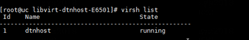

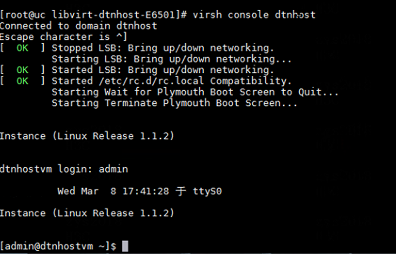

6.     At the specified node, use the virsh list command to check the running status of the virtualization DTN host.
If installation is successful, the State field will display running.
Figure 47 Successful installation of the VM corresponding to the virtualization DTN host
7.     You can log in to the back end of the node where the virtualization DTN host is deployed by using the virsh console dtnhost command.
The username of the virtualization DTN host is admin by default, and the password is Pwd@12345 by default.
Figure 48 Logging in to the corresponding node of the virtualization DTN host by using the virsh console dtnhost command
In this example, the controller management network, node management network, simulation management network, and simulated device service network share one switch to deploy the Layer 3 management networks for simulation.
This chapter describes the deployment of DTN hosts on physical servers. The deployment method of virtualization DTN hosts is the same as that of DTN hosts. Select a deployment method as needed.
Figure 49 Management network diagram

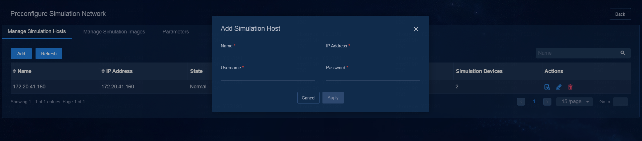

1.     Log in to the controller. Navigate to the Automation > Data Center Networks > Simulation > Build Simulation Network page. Click Preconfigure. The DTN host management page opens.
2.     Click Add. In the dialog box that opens, configure the host name, IP address, username, and password.
Figure 50 Adding DTN hosts
3.     Click Apply.

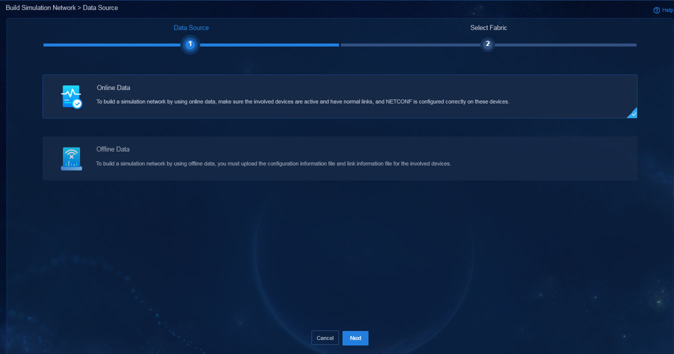

Build a simulation network

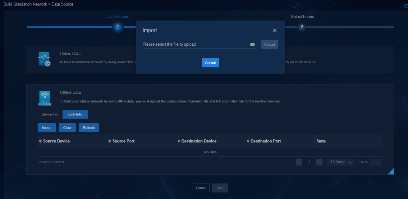

(Optional.) Back up and restore the DC environment, and obtain the link information and device configuration files
To use the offline data to build a simulation network, first back up and restore the environment, and obtain the link information and device configuration files before building a simulation network. More specifically:

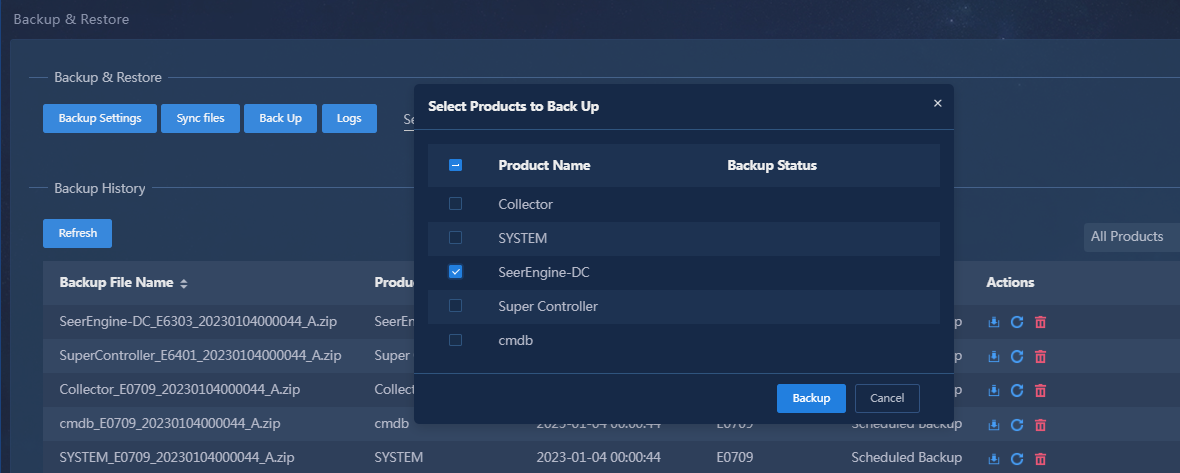

Back up the SeerEngine-DC environment

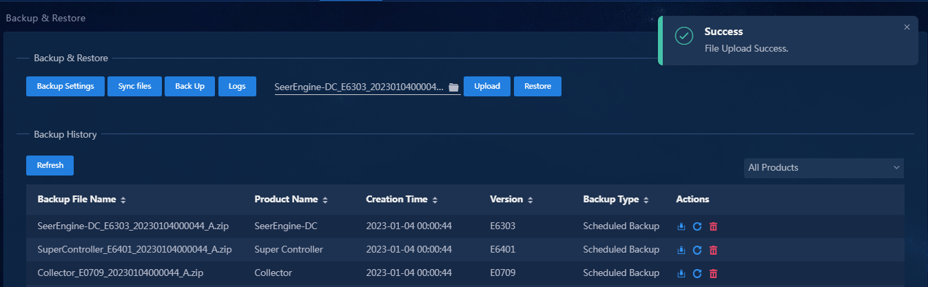

1.     Log in to the controller that is operating normally. Navigate to the System > Backup & Restore page.
2.     Click Start Backup. In the dialog box that opens, select SeerEngine-DC. Click Backup to start backup.
Figure 52 Back up SeerEngine-DC
3.     After the backup is completed, click Download in the Actions column for the backup file to download it.
Obtain the link information file

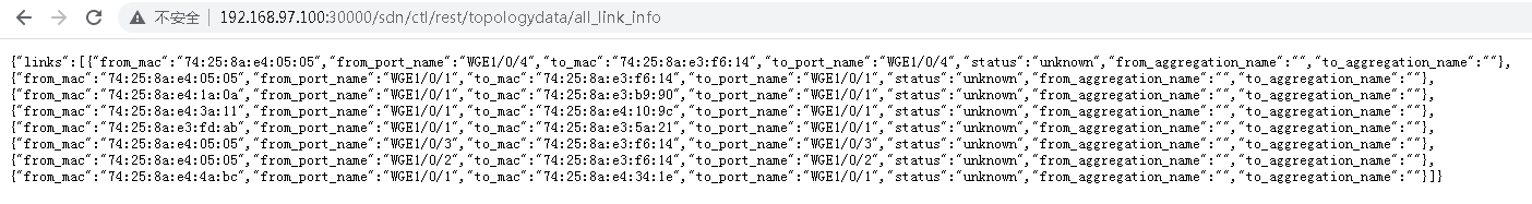

1.     In the address bar of the browser, enter http://ip_address:port/sdn/ctl/rest/topologydata/all_link_info.
Link information of all fabrics in the environment will be displayed.
¡     ip_address: IP address of the controller.
¡     port: Port number.
Figure 53 Link info
2.     Copy the obtained link information to a .txt file, and save the file.
The file name is not limited. The file is the link information file.

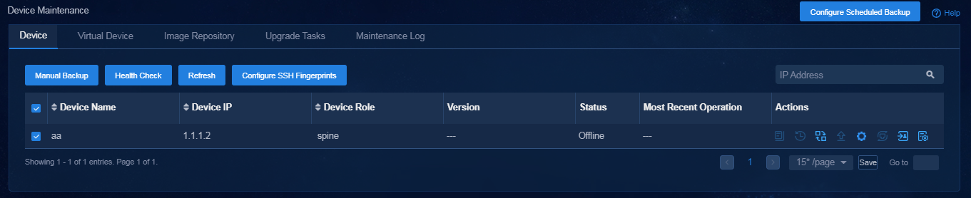

1.     Log in to the controller that is operating normally. Navigate to the Automation > Configuration Deployment > Device Maintenance > Physical Devices page.
2.     Select all devices, and click Manual Backup.
Figure 54 Manually backing up all device information

Restore the SeerEngine-DC environment
1.     Log in to the environment where you want to build a simulation network based on offline data.
2.     Navigate to the System > Backup & Restore page. Use the backup file to restore the environment.
Figure 55 Restore the environment

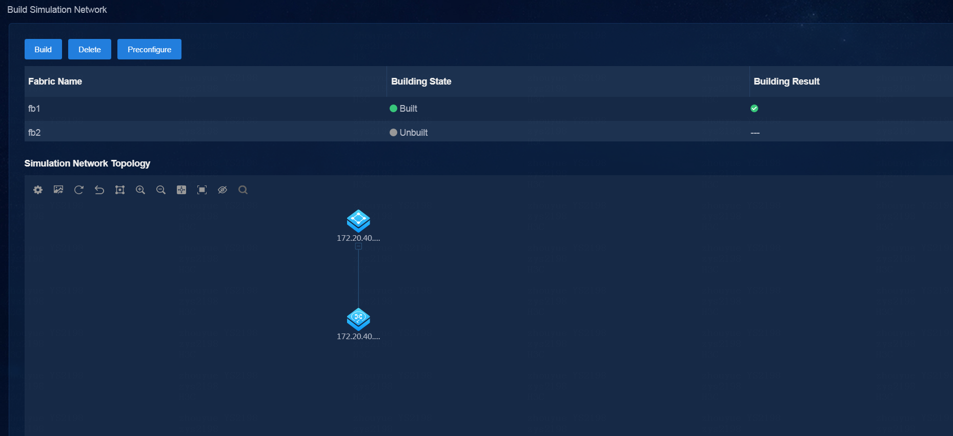

2.     Click Build on the page for building a simulation network.
Building a simulation network includes the following steps: select the data source and select fabrics. The data source can be online data or offline data.
¡     Online Data: After you select this option, directly click Next.
Figure 56 Selecting a data source

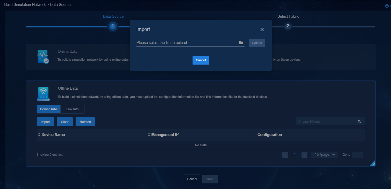

¡     Offline Data: After you select this option, perform the following tasks:
-     On the Device Info page, click Import. In the dialog box that opens, import and upload the device configuration file.
Figure 57 Importing and uploading the device configuration file
-     Down Link Info page, click Import. In the dialog box that opens, import and upload the link information file.
Figure 58 Importing and uploading the link information file
-     Click Next.
3.     Select fabrics as needed, and click Start Building to start building the simulation network. You can select multiple fabrics.
Figure 59 Selecting fabrics

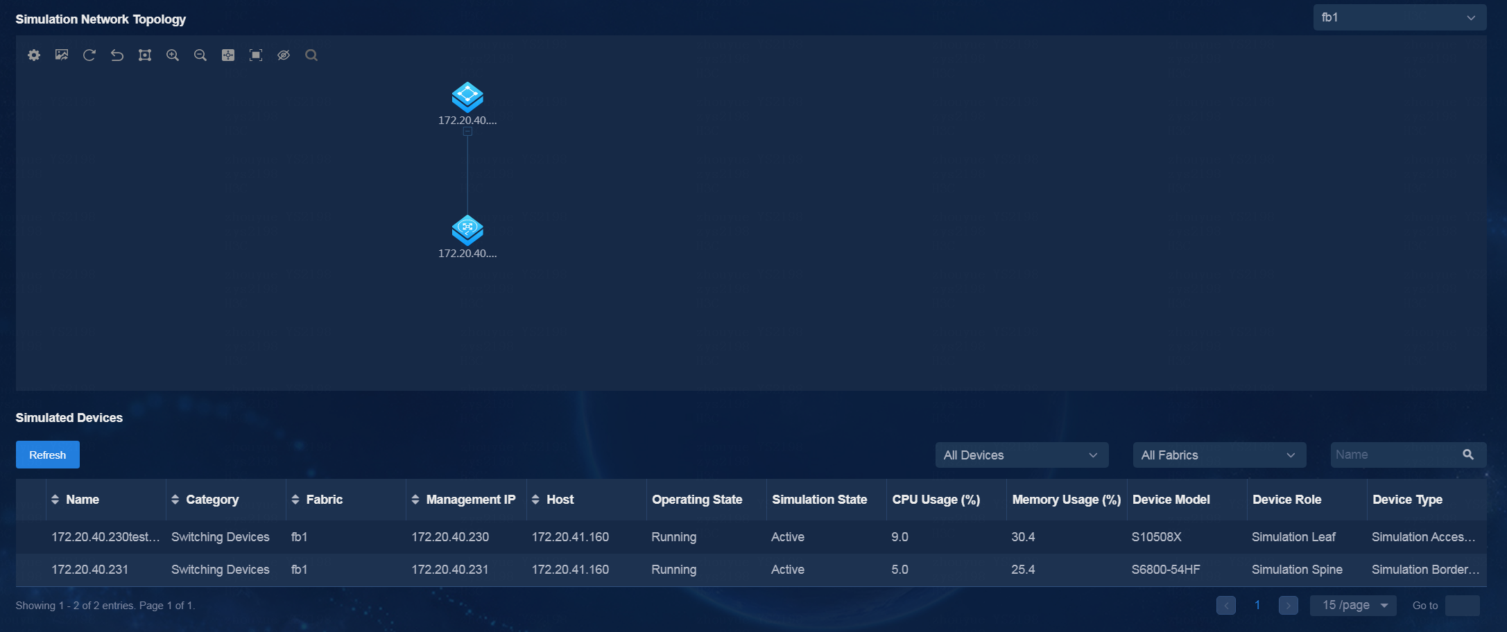

After the simulation network is built successfully, its state is displayed as Built on the page.
Figure 60 Simulation network built successfully
4.     After the simulation network is built successfully, you can view the simulated device information:
¡     The simulated device running state is Active.
¡     The device model is displayed correctly on the real network and the simulation network.
The VMs in the simulation network model are created on the host created. If multiple hosts are available, the controller selects a host with optimal resources for creating VMs.
Figure 61 Viewing simulated devices

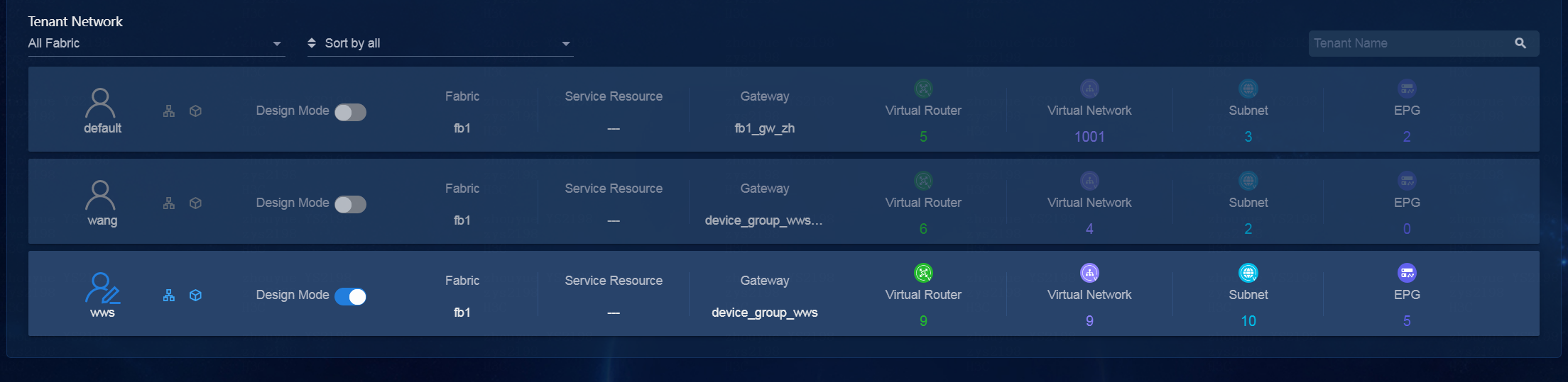

Enable the design mode for the tenant
1.     Navigate to the Automation > Data Center Networks > Simulation > Tenant Service Simulation page.
2.     Click the design mode switch for the specified tenant. A confirmation dialog box opens to ask whether you want to perform network-wide impact analysis.
¡     Select the Network-Wide Impact Analysis option, and click OK to access the network-wide impact analysis page.
As a practice to provide baseline values for the evaluation results, perform network-wide impact analysis.
Figure 62 Performing network-wide impact analysis as a best practice
¡     If you click OK without selecting the Network-Wide Impact Analysis option, the design mode will be enabled.
After design mode is enabled for a tenant, the tenant icon becomes , which means that the tenant is editable. After design mode is disabled for a tenant, the tenant icon becomes , which indicates that the tenant is not editable.
You can enable the design mode and then perform tenant service simulation only when the simulation network is built normally.
Figure 63 Enabling the design mode for the tenant

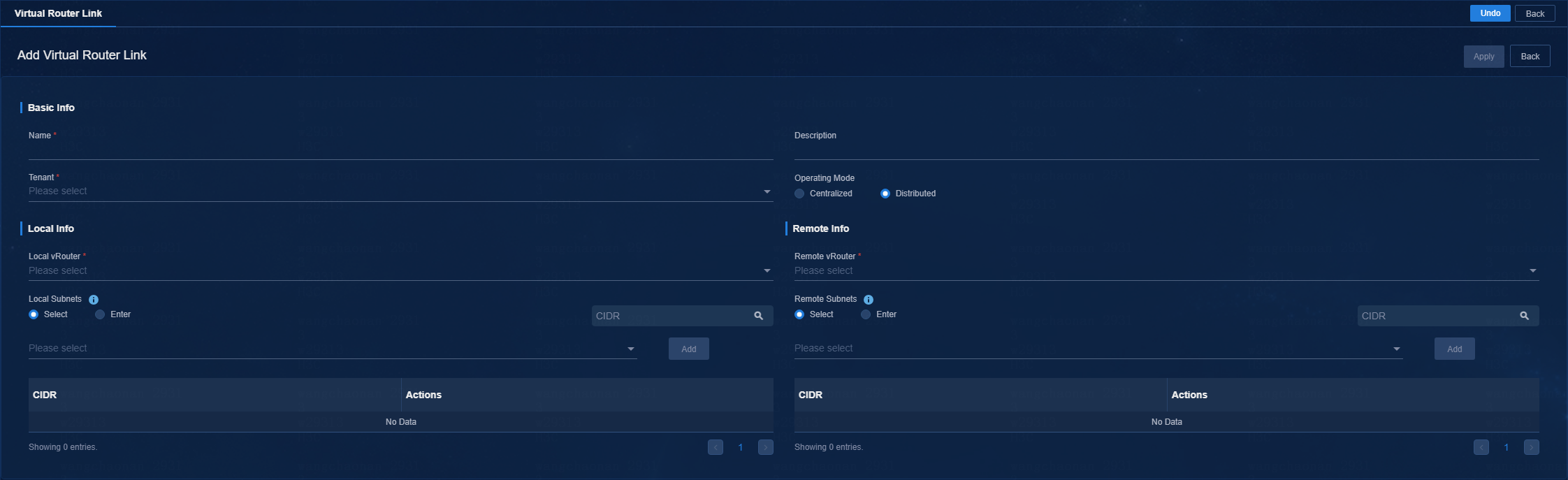

a.     Click Add to access the page for adding a vRouter link. On this page, configure vRouter link settings. Click Apply.
Figure 65 Adding a vRouter link

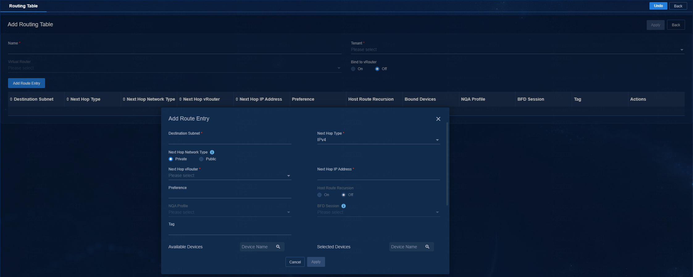

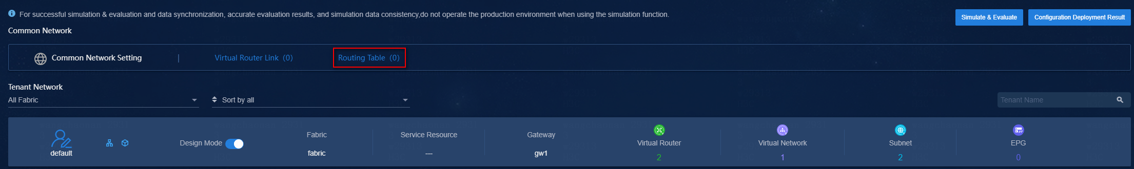

·     Routing table
a.     On the tenant service simulation page, click the routing table link in the common network settings area to access the routing table page.
Figure 66 Common Network Settings > Routing Table
a.     To add a routing table, click Add. On this page, configure the name of the routing table, select the tenant and vRouter, and select a state for the Bind to vRouter option.
b.     Click Add Route Entry. In the dialog box that opens, configure the route entry. Click Apply.
Figure 67 Common Network Settings > Add Routing Table

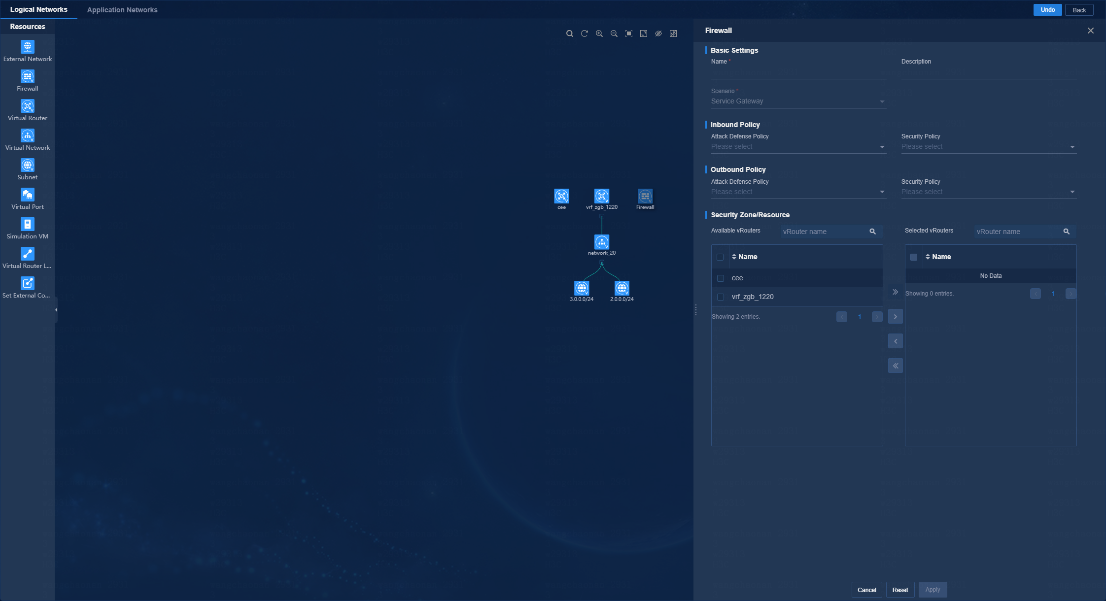

1.     Click the icon for the tenant to access the Tenant Service Simulation (Tenant Name) > Logical Networks page. On this page, you can perform tenant service simulation.
2.     On the logical network page, you can perform the following operations:
¡     Drag a resource icon in the Resources area to the canvas area. Then, a node of this resource is generated in the canvas area, and the configuration panel for the resource node opens on the right.
¡     In the canvas area, you can adjust node locations, bind/unbind resource, and zoom in/out the topology.

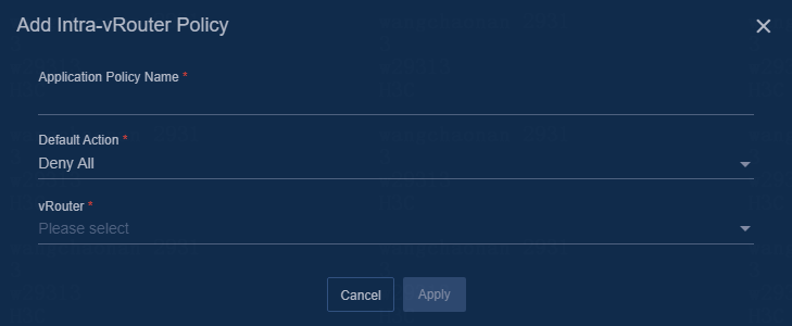

4.     Click the Application Policy tab. On the application policy page, you can perform the following tasks:
¡     Click Intra-vRouter Policy. In the dialog box that opens, add an intra-vRouter EPG policy.
Figure 70 Adding an intra-vRouter policy

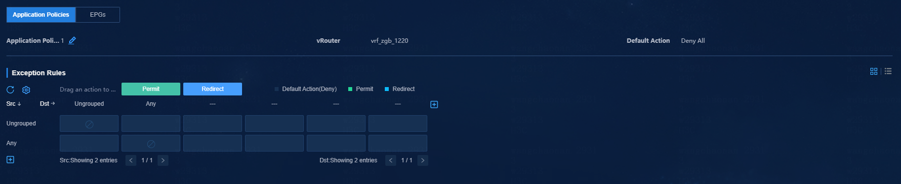

¡     Click Apply to access the exception rule page. Configure exception rules as needed.
Figure 71 Configuring exception rules

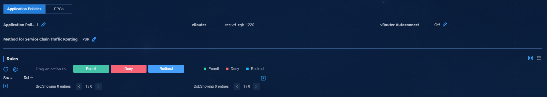

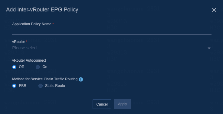

¡     Click Inter-vRouter EPG Policy and configure inter-vRouter EPG policy parameters in the dialog box that opens.
Figure 72 Adding an inter-vRouter EPG policy
¡     Click Apply to access the rule page. Configure rules as needed.
Figure 73 Configuring rules

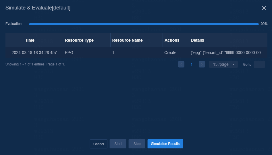

After resource orchestration, click Simulate & Evaluate on the tenant service simulation page. In the dialog box that opens, click Start.
Figure 74 Starting simulation and evaluation
Figure 75 Finishing simulation and evaluation

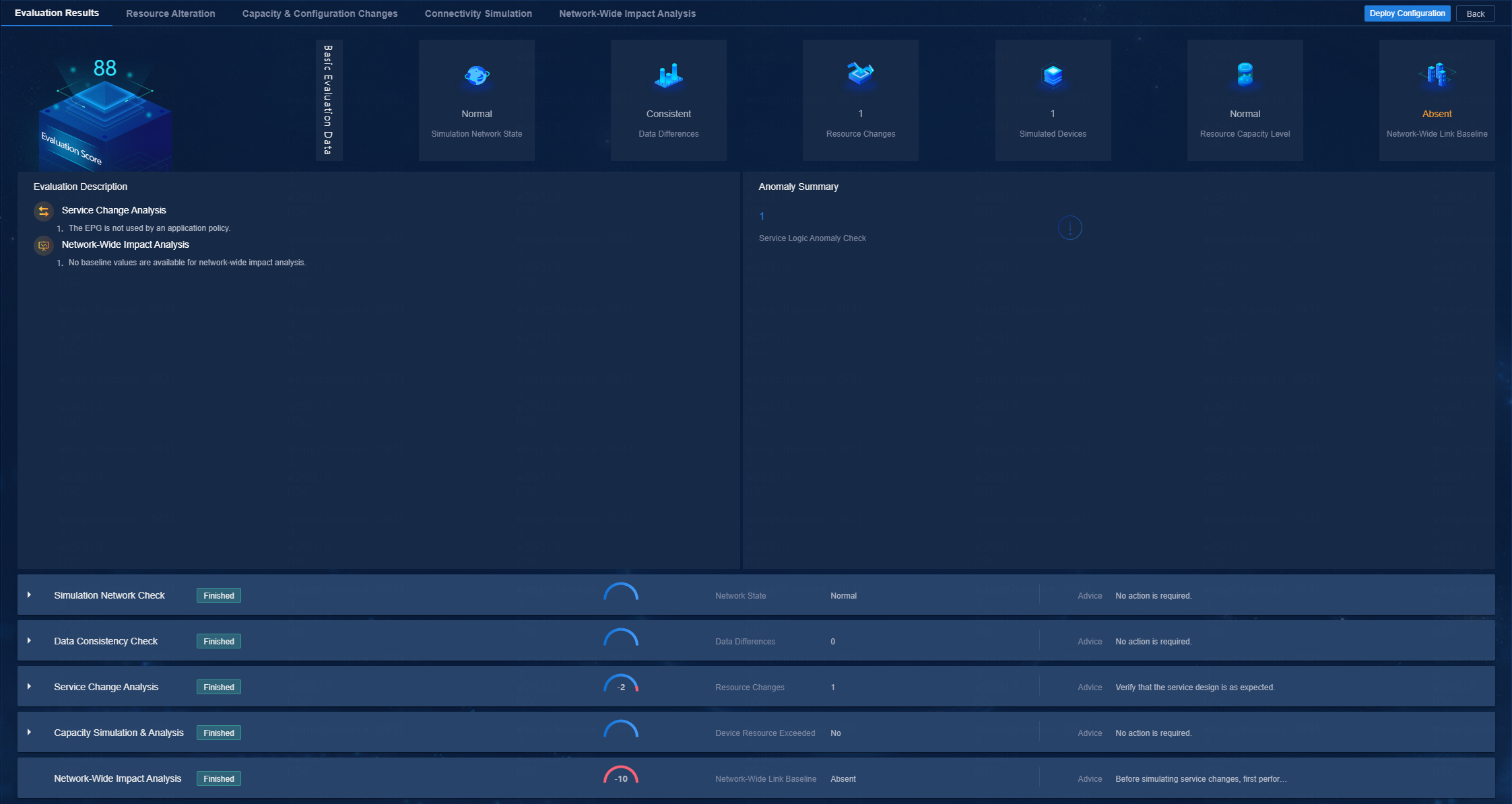

After simulation evaluation is completed, click Simulation Results to enter the simulation result page. On this page, you can view the following simulation results:
·     Evaluation results
This feature displays a quantified table of simulation report scores. You can have a more intuitive understanding of the comprehensive simulation & evaluation score and the evaluation results of service changes from various perspectives.
Figure 76 Evaluation results

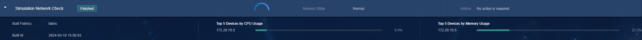

¡     Simulation network check—Evaluate the health of the simulation networks based on factors such as CPU and memory usage of simulated devices.
Figure 77 Simulation network check
¡     Data consistency check—Evaluate the service differences between production and simulation networks.

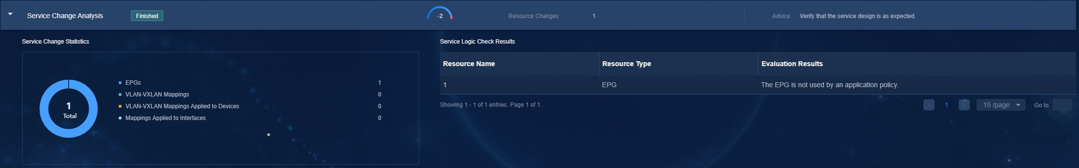

¡     Service change analysis—Analyze from the perspective of whether the service changes are reasonable.
Figure 78 Service change analysis

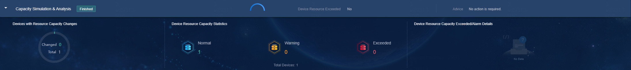

¡     Capacity simulation & analysis—Evaluate from the perspective of resource capacity usage.
Figure 79 Capacity simulation & analysis
¡     Network-wide impact analysis—Evaluate the existence of baseline values for network-wide impact analysis.

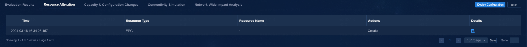

·     Resource changes
This feature displays the resource changes in the current simulation & evaluation.
Figure 80 Resource changes

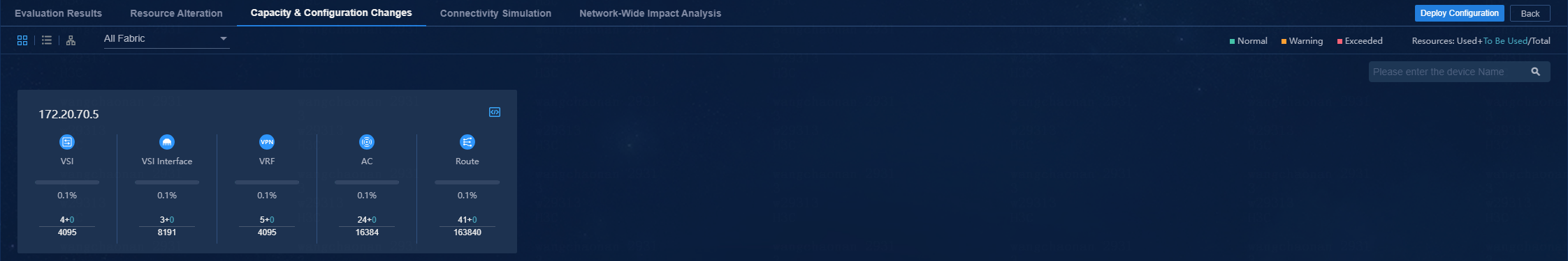

This function is used to calculate the device resource consumption and configuration deployment caused by this service change and present them in multiple views in the form of differences.
¡     Resource capacity
The resource capacity evaluation function evaluates the resource consumption resulting from this service change. By analyzing the total capacity, consumed capacity, and capacity to be consumed of physical device resources on the network, this feature determines whether this service change will fall into the device resource blackhole.
¡     Configuration changes
This feature mainly displays the NETCONF and CLI configuration differences before and after simulation & evaluation.
Figure 81 Capacity and configuration changes

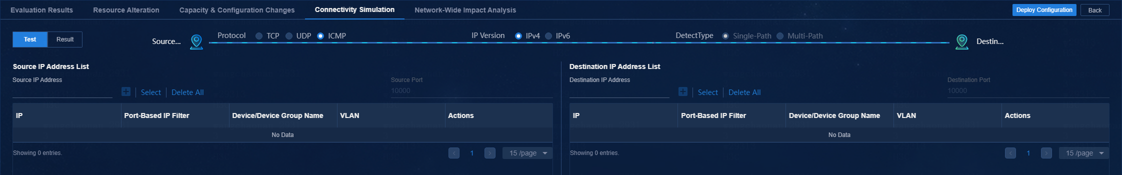

·     Connectivity simulation
On the page, you can manually select ports for detection according to service requirements. The connectivity simulation feature simulates TCP, UDP, and ICMP protocol packets to detect connectivity between ports.
Figure 82 Connectivity detection

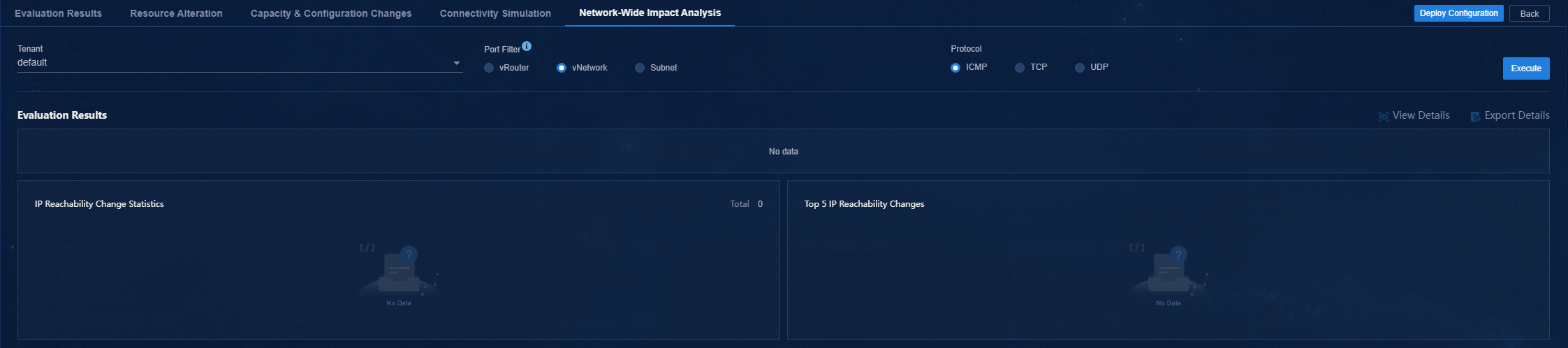

·     Network-wide impact analysis
From the perspective of the overall service, network-wide impact analysis can quickly assess the impact of service changes on the connectivity of networks, and identify the links with state changes. This feature compares the initial state results before this simulation with the network-wide impact analysis results of this simulation, and outputs the comparison results. Then, you can quickly view the link state changes of the entire network.
In the current software version, network-wide impact analysis supports multi-tenant, multi-port filters (vRouters, vNetworks, and subnets) and multiple protocols (ICMP, TCP, and UDP).
Figure 83 Network-wide impact analysis

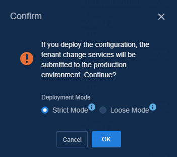

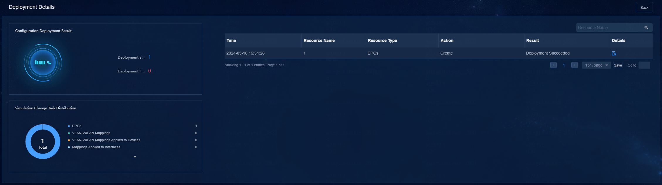

You can click Deploy Configuration to deploy the service configuration to real devices when the simulation evaluation result is as expected. Additionally, you can view details on the deployment details page.
Figure 84 Configuration deployment
Figure 85 Viewing deployment details

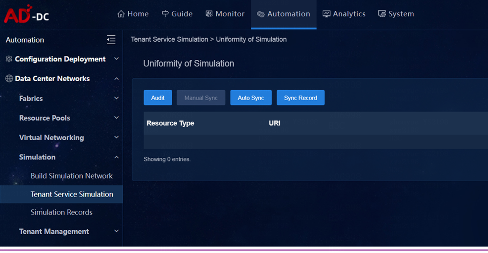

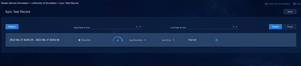

Synchronize data with the production environment
Typically, if the configuration data in the controller production environment changes after the simulation network is built, the user must rebuild the simulation network and then synchronize the incremented configuration data into the simulation environment.
The simulation data consistency feature is developed to resolve this issue. This feature supports synchronizing the configuration data within the specified range of the production environment to the simulation environment without rebuilding the simulation network.
Figure 86 Uniformity of simulation
To synchronize simulation data with that in the production environment:
1.     Log in to the controller. Navigate to the Automation > Data Center Networks > Simulation > Tenant Service Simulation page. Then click Uniformity of Simulation in the upper right corner of the page.
2.     Click Audit to audit the configuration between the simulation network and production environment and display the incremental configuration data after the simulation network is built.
Figure 87 Auditing the configuration between the simulation network and production environment
3.     Synchronize the configuration data manually or automatically.
¡     To synchronize the configuration data manually, click Manual Sync.
¡     To synchronize the configuration data automatically, click Auto Sync and configure the parameters. The system will synchronize incremental data in the specified range from the production environment to the simulation network periodically or at a specified time.

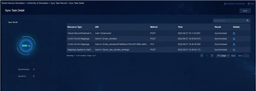

4.     View the synchronization task details and synchronization records.
¡     The Sync Task Detail page displays information of a synchronization task, including the overall progress and synchronization status of each configuration item.
¡     The Sync Task Record page displays the synchronization tasks in progress and completed synchronization tasks. The synchronization results are arranged in chronological order.
Figure 88 Viewing synchronization task details
Figure 89 Viewing the synchronization records

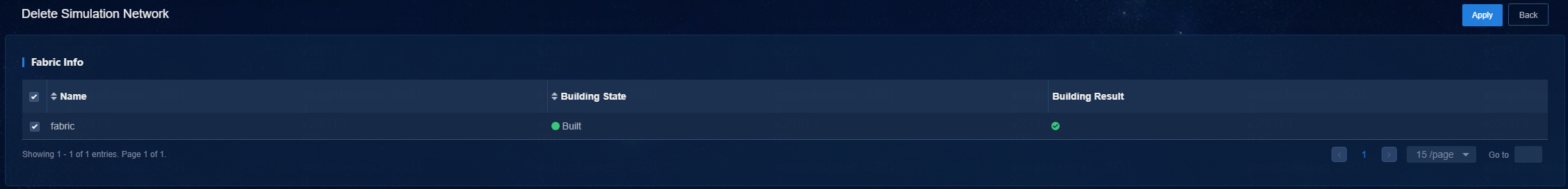

Delete a simulation network
2.     Click Delete. In the dialog box that opens, the fabric for which a simulation network has been built is selected by default.
Figure 90 Deleting a simulation network
3.     Click OK to start deleting the simulation network. When all operation results are displayed as Succeeded and the progress is 100%, the simulation network is deleted completely.

1.     Access the Deploy > Convergence Deployment page of Matrix.
2.     Click the  button for the virtualization DTN host to access the upgrade page.
Figure 91 Upgrading the virtualization DTN host on the convergence deployment page
3.     Upload the installation package and select the package to be deployed.
4.     Click Upgrade to upgrade the virtualization DTN host.
After upgrading the virtualization DTN host, rebuild the simulation network.
Figure 92 Upgrading virtualization DTN hosts
Uninstall a virtualization DTN host
2.     Select the virtualization DTN host option, and click Uninstall to uninstall the specified component.
Figure 93 Uninstall the virtualization DTN host

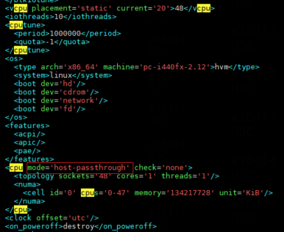

Deploying a DTN host on a VM

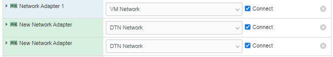

When I deploy a DTN host on a VMware ESXI VM, how can I enable the nested virtualization feature for VMware and the DTN host?
To enable the nested virtualization feature for VMware and the DTN host, perform the following tasks.

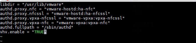

Enabling the nested virtualization feature for Vmware

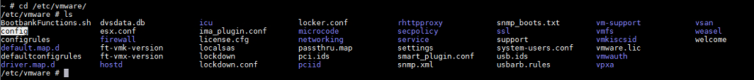

1.     Log in to the back end of the host of VMware. View the file named config in the /etc/vmware directory.
Figure 94 File named config in the /etc/vmware directory
2.     Execute the vi command to enter the configuration file named config. Add the following configuration to the end of the configuration file: vhv.enable = ”TRUE”
Figure 95 Editing the configuration file named config
3.     After the operation, execute the reboot command to restart the ESXi server.

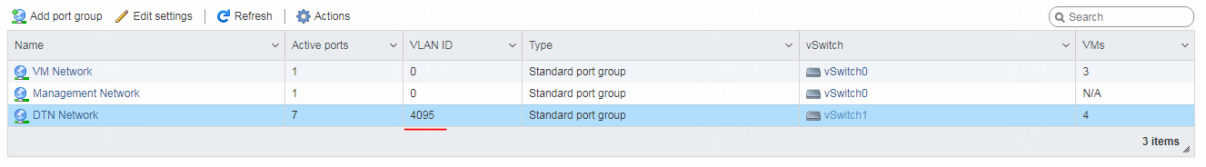

3.     After the configuration is completed, add a port group on VMware. The port group name is DTN Network in this example. Make sure the VLAN ID of the newly added port group is 4095 (the VLAN ID of 4095 means all VLANs are permitted).
Figure 97 Adding a port group
4.     After the port group is added, change the port group bound to the NIC of the DTN host.
Figure 98 Configuring the DTN host NIC
·     The network bound to the port group named DTN Network is used as the simulation management network and simulated device service network. The network bound to the port group named VM Network is used as the node management network.
·     If multiple DTN hosts are bound to the port group named DTN Network, make sure each physical network associated with the port group is reachable.
·     When deploying DTN components and simulation hosts (or simulation devices) across three layers, it is necessary to assign different port groups for the DTN components and simulation hosts, and designate different vSwitches for the port groups.

2.     Execute the virsh edit dtn_host_name command to edit VM settings. The following example edits DTN host dtn_host_9.33.
Figure 101 Edit configuration of DTN host dtn_host_9.33
a.     Edit CPU: Add the mode='host-passthrough' attribute.
Figure 102 Adding host-passthrough for the CPU mode
