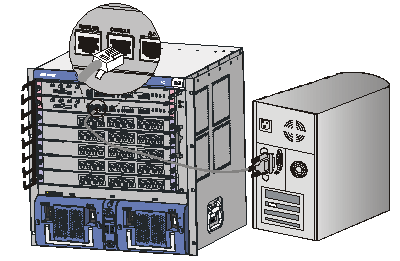

Connect a terminal (a PC in this example) to the switch with the console cable.
Figure 4-1 Connect a PC to the switch with a Console cable

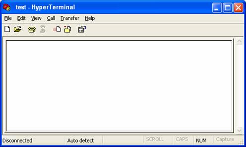

5)         Click OK after setting the serial port parameters to enter the HypterTerminal window, as shown in Figure 4-5.
Figure 4-5 HyperTerminal window

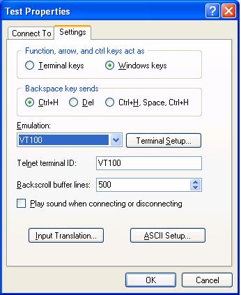

6)         Select Properties in the HyperTerminal window to access the Properties window. Click Settings in the Window (as shown in Figure 4-6), select VT100 for terminal emulation, and click OK.
&  Note:
You are recommended to select the Windows keys option button.
Figure 4-6 Set the terminal emulation parameters
