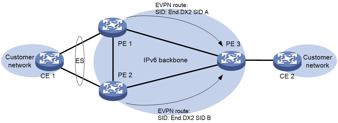

A pair of PEs use BGP EVPN routes to establish PWs as follows:
1.     A PE adds the local service ID and End.DX2 SID of a local cross-connect to Ethernet auto-discovery routes and advertises the routes to the remote PE.
2.     After receiving the routes, the remote PE checks the service ID carried in the routes. If the service ID is the same as the remote service ID configured locally for a cross-connect, the PE establishes an SRv6 tunnel to the other PE. The SID flag of the SRv6 tunnel is the End.DX2 SID in the routes.
The two PEs both advertise End.DX2 SIDs to each other and establish two SRv6 tunnels at two directions. The two SRv6 tunnels form a PW to carry Layer 2 customer traffic. The PW is called an SRv6 PW.

EVPN VPWS over SRv6 multihoming
About EVPN VPWS over SRv6 multihoming
As shown in Figure 2, EVPN VPWS over SRv6 supports deploying multiple PEs at a site for redundancy and high availability. On the redundant PEs, Ethernet links connected to the site form an Ethernet segment (ES) that is uniquely identified by an ES identifier (ESI). EVPN VPWS over SRv6 supports only dualhoming.
Figure 2 EVPN VPWS over SRv6 multihoming
Redundancy mode
The device supports single-active redundancy mode and all-active redundancy mode of EVPN VPWS over SRv6 multihoming.
·     All-active mode—This mode allows all redundant PWs to a multihomed site to load share traffic.
·     Single-active mode—This mode allows one of the redundant PWs to forward traffic. When the main PW becomes unavailable because of device failure or link failure, traffic is switched to the secondary PW for forwarding. A designated forwarder (DF) is elected from the redundant PEs to determine the main PW. For more information about DF election, see EVPN VPWS configuration in EVPN Configuration Guide.
Route advertisement
The redundant PEs at a multihomed site both advertise End.DX2 SIDs to remote PEs. In addition, they advertise the redundancy mode of the multihomed site and their roles (primary or secondary) to remote PEs. A remote PE handles BGP EVPN routes advertised by the redundant PEs based on the redundancy mode.
·     In all-active mode, the remote PE treats the routes advertised by the redundant PEs as ECMP routes that can load share traffic.
·     In single-active mode, the remote PE treats the routes advertised by the primary PE as the optimal routes and only uses the optimal routes to forward traffic.

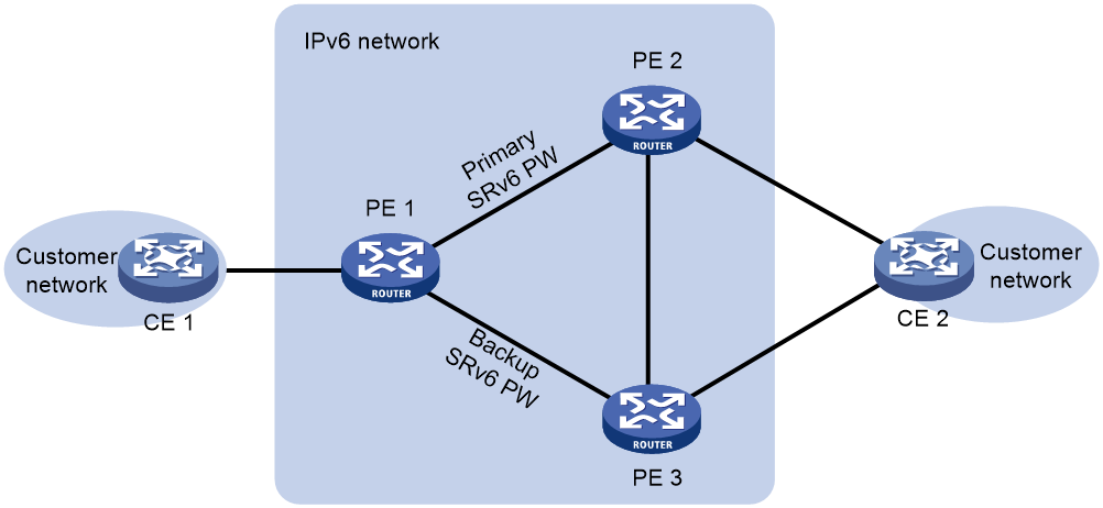

Remote FRR
Remote FRR enables two PEs on an EVPN VPWS over SRv6 network to set up a primary SRv6 PW and a backup SRv6 PW between them to ensure high availability. This feature is applicable to both multihoming and singlehoming scenarios.
As shown in Figure 4, PE 1 is connected to PE 2 and PE 3. For high availability, you can enable remote FRR on PE 1 for it to set up PWs to both PE 2 and PE 3. PE 1 uses the primary SRv6 PW to forward traffic as long as it is available. When the primary SRv6 PW fails, PE 1 switches traffic destined for CE 2 to the backup SRv6 PW. When PE 3 receives the traffic from the backup SRv6 PW, it forwards the traffic to CE 2. When CE 2 receives the traffic, it updates the MAC address table and switches the traffic destined for CE 1 to the link connected to PE 3. The switchover reduces packet loss.
Figure 4 Remote FRR

Enabling cross-connects to ignore the state of ACs
This task helps reduce the traffic loss caused by AC failure at a multihomed site that uses single-active redundancy mode in an EVPN VPWS over SRv6 network.
At a multihomed site that uses single-active redundancy mode in an EVPN VPWS over SRv6 network, CE 1 is dualhomed to PE 1 and PE 2 through a smart trunk. PE 1 is the primary PE, and PE 2 is the secondary PE. When the AC on PE 1 fails, PE 1 and PE 2 act as follows:
·     PE 1 withdraws advertised Ethernet auto-discovery routes.
·     PE 2 brings up its AC and advertises Ethernet auto-discovery routes to remote PEs.
The remote PEs switch traffic to the paths to PE 2 only after receiving the Ethernet auto-discovery routes advertised by PE 2, and traffic loss occurs during path switchover. To resolve this issue, enable cross-connects to ignore the state of ACs on PE 2. This feature allows PE 2 to advertise Ethernet auto-discovery routes to remote PEs regardless of the state of ACs and speeds up path switchover when the AC on PE 1 fails.

Configuring FRR for EVPN VPWS over SRv6
Configuring local FRR
This task enables two PEs at a multihomed EVPN VPWS over SRv6 network site to set up a bypass SRv6 PW between them. Perform this task to help reduce the traffic loss caused by AC failure.
On an EVPN instance, EVPN instance-specific bypass PW configuration takes precedence over global bypass PW configuration.
If you have executed the evpn frr local enable command on an EVPN instance, the undo evpn multihoming vpws-frr local command does not delete the bypass SRv6 PW of the EVPN instance.
Perform this task on the redundant PEs at a multihomed site.
Enabling bypass PW globally
2.     Enable bypass PW globally for EVPN VPWS over SRv6.
By default, bypass PW is disabled globally for EVPN VPWS over SRv6.
For more information about this command, see EVPN Command Reference.
Configuring bypass PW on an EVPN instance
2.     Enter cross-connect group view.
xconnect-group group-name
3.     Enter EVPN instance view.
evpn encapsulation srv6
4.     Configure bypass PW for EVPN VPWS over SRv6.
evpn frr local { disable | enable }
By default, an EVPN instance uses the global bypass PW configuration of EVPN VPWS over SRv6.
Configuring remote FRR
Remote FRR enables two PEs on an EVPN VPWS over SRv6 network to set up a primary PW and a backup PW between them to ensure high availability. The PEs use the primary PW to forward traffic as long as it is available. When the primary PW fails, the PEs switch traffic to the backup PW.
On an EVPN instance, EVPN instance-specific remote FRR configuration takes precedence over global remote FRR configuration.
If you have executed the evpn frr remote enable command on an EVPN instance, the undo evpn vpws-frr remote command does not delete the backup SRv6 PWs of the EVPN instance.

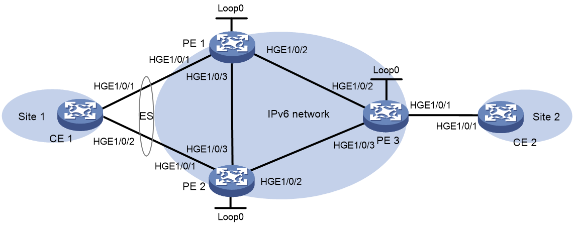

Example: Configuring EVPN VPWS over SRv6 multihoming (static link aggregation dual-homed)
As shown in Figure 6, CE 1 is dual-homed to PE 1 and PE 2 through static link aggregation. Configure EVPN VPWS over SRv6 for dual-homed site 1 and single-homed site 2 to communicate over the IPv6 backbone network through an SRv6 tunnel.
Figure 6 Network diagram
Device
Interface
IP address
Device
Interface
IP address
PE 1
Loop0
1::1/128
CE 1
RAGG1
100::1/64
HGE1/0/1
CE 2
HGE1/0/1
100::2/64
HGE1/0/2
10::1/64
PE 3
Loop0
3::3/128
HGE1/0/3
20::1/64
HGE1/0/1
PE 2
Loop0
2::2/128
HGE1/0/2
10::3/64
HGE1/0/1
HGE1/0/3
30::3/64
HGE1/0/2
30::2/64
HGE1/0/3
20::2/64

Example: Configuring EVPN VPWS over SRv6 multihoming (S-Trunk dual-homed)
As shown in Figure 7, CE 1 is dual-homed to PE 1 and PE 2 through S-Trunk. Configure EVPN VPWS over SRv6 for dual-homed site 1 and single-homed site 2 to communicate over the IPv6 backbone network through an SRv6 tunnel.
Figure 7 Network diagram
Device
Interface
IP address
Device
Interface
IP address
PE 1
Loop0
1::1/128
PE 2
Loop0
2::2/128
HGE1/0/1
N/A
HGE1/0/1
N/A
HGE1/0/2
10::1/64
HGE1/0/2
30::2/64
HGE1/0/3
20::1/64
HGE1/0/3
20::2/64
HGE1/0/3
10.1.2.1/24
HGE1/0/3
10.1.2.2/24
PE 3
Loop0
3::3/128
CE 1
RAGG1
100::1/64
HGE1/0/1
N/A
CE 2
HGE1/0/1
100::2/64
HGE1/0/2
10::3/64
HGE1/0/3
30::3/64
1.     Configure CE 1:
# Create dynamic Layer 3 aggregate interface 1 and assign it an IPv6 address and prefix.
<CE1> system-view
[CE1] interface route-aggregation 1
[CE1-Route-Aggregation1] link-aggregation mode dynamic
[CE1-Route-Aggregation1] ipv6 address 100::1 64
[CE1-Route-Aggregation1] quit
# Assign HundredGigE 1/0/1 and HundredGigE 1/0/2 to aggregation group 1.
[CE1] interface hundredgige 1/0/1
[CE1-HundredGigE1/0/1] port link-aggregation group 1
[CE1-HundredGigE1/0/1] quit
[CE1] interface hundredgige 1/0/2
[CE1-HundredGigE1/0/2] port link-aggregation group 1
[CE1-HundredGigE1/0/2] quit
2.     Configure PE 1:
# Run OSPFv3 on PE 1.
<PE1> system-view
[PE1] ospfv3
[PE1-ospfv3-1] router-id 1.1.1.1
[PE1-ospfv3-1] segment-routing ipv6 locator aaa
[PE1-ospfv3-1] area 0
[PE1-ospfv3-1-area-0.0.0.0] quit
[PE1-ospfv3-1] quit
# Configure interface Loopback 0.
[PE1] interface loopback 0
[PE1-LoopBack0] ipv6 address 1::1 128
[PE1-LoopBack0] ospfv3 1 area 0
[PE1-LoopBack0] quit
# Enable L2VPN.
[PE1] l2vpn enable
# Configure HundredGigE 1/0/2, the interface connected to PE 3.
[PE1] interface hundredgige 1/0/2
[PE1-HundredGigE1/0/2] ipv6 address 10::1/64
[PE1-HundredGigE1/0/2] ospfv3 1 area 0
[PE1-HundredGigE1/0/2] undo shutdown
[PE1-HundredGigE1/0/2] quit
# Configure HundredGigE 1/0/3, the interface connected to PE 2.
[PE1] interface hundredgige 1/0/3
[PE1-HundredGigE1/0/3] ipv6 address 20::1/64
[PE1-HundredGigE1/0/3] ospfv3 1 area 0
[PE1-HundredGigE1/0/3] undo shutdown
[PE1-HundredGigE1/0/3] quit
# Configure PE 1 to establish IBGP neighbor relationships with PE 2 and PE 3, and enable BGP EVPN to advertise routes in SRv6 encapsulation to PE 2 and PE 3.
[PE1] bgp 100
[PE1-bgp-default] router-id 1.1.1.1
[PE1-bgp-default] peer 2::2 as-number 100
[PE1-bgp-default] peer 2::2 connect-interface loopback 0
[PE1-bgp-default] peer 3::3 as-number 100
[PE1-bgp-default] peer 3::3 connect-interface loopback 0
[PE1-bgp-default] address-family l2vpn evpn
[PE1-bgp-default-evpn] peer 2::2 enable
[PE1-bgp-default-evpn] peer 3::3 enable
[PE1-bgp-default-evpn] peer 2::2 advertise encap-type srv6
[PE1-bgp-default-evpn] peer 3::3 advertise encap-type srv6
[PE1-bgp-default-evpn] quit
[PE1-bgp-default] quit
# Configure S-Trunk for CE 1 to be dual-homed to PE 1 and PE 2.
[PE1] lacp system-priority 10
[PE1] lacp system-mac 1-1-1
[PE1] lacp system-number 1
[PE1] s-trunk id 1
[PE1-s-trunk1] s-trunk ip destination 10.1.2.2 source 10.1.2.1
[PE1-s-trunk1] quit
[PE1] interface route-aggregation 1
[PE1-Route-Aggregation1] link-aggregation mode dynamic
[PE1-Route-Aggregation1] s-trunk 1
[PE1-Route-Aggregation1] s-trunk port-role primary
[PE1-Route-Aggregation1] quit
[PE1] interface hundredgige 1/0/1
[PE1-HundredGigE1/0/1] port link-aggregation group 1
[PE1-HundredGigE1/0/1] quit
# Assign an ESI to site-facing interface Route-Aggregation 1 and set its redundancy mode to all-active.
[PE1-Route-Aggregation1] esi 1.1.1.1.1
[PE1-Route-Aggregation1] evpn redundancy-mode all-active
# Create a cross-connect group named vpna, create an EVPN instance for it, and enable SRv6 encapsulation. Configure an RD and route targets for the EVPN instance and enable SRv6-BE route recursion mode.
[PE1] xconnect-group vpna
[PE1-xcg-vpna] evpn encapsulation srv6
[PE1-xcg-vpna-evpn-srv6] route-distinguisher 1:1
[PE1-xcg-vpna-evpn-srv6] vpn-target 1:1 export-extcommunity
[PE1-xcg-vpna-evpn-srv6] vpn-target 1:1 import-extcommunity
[PE1-xcg-vpna-evpn-srv6] segment-routing ipv6 best-effort
[PE1-xcg-vpna-evpn-srv6] quit
# Create cross-connect pw1 and map Route-Aggregation 1 to it. Create an SRv6 tunnel on the cross-connect.
[PE1-xcg-vpna] connection pw1
[PE1-xcg-vpna-pw1] ac interface route-aggregation 1
[PE1-xcg-vpna-pw1-Route-Aggregation1] quit
[PE1-xcg-vpna-pw1] evpn local-service-id 1 remote-service-id 2
[PE1-xcg-vpna-pw1] segment-routing ipv6 locator aaa
[PE1-xcg-vpna-pw1] quit
[PE1-xcg-vpna] quit
# Specify a source IP address for the outer IPv6 header of SRv6-encapsulated packets, and configure a locator to apply for End.DX2 SIDs.
[PE1] segment-routing ipv6
[PE1-segment-routing-ipv6] encapsulation source-address 1::1
[PE1-segment-routing-ipv6] locator aaa ipv6-prefix 111:: 64 static 32 args 16
[PE1-segment-routing-ipv6-locator-aaa] quit
[PE1-segment-routing-ipv6] quit
3.     Configure PE 2:
# Run OSPFv3 on PE 2.
<PE2> system-view
[PE2] ospfv3
[PE2-ospfv3-1] router-id 2.2.2.2
[PE2-ospfv3-1] segment-routing ipv6 locator aaa
[PE2-ospfv3-1] area 0.0.0.0
[PE2-ospfv3-1-area-0.0.0.0] quit
[PE2-ospfv3-1] quit
[PE2] interface loopback 0
[PE2-LoopBack0] ipv6 address 2::2 128
[PE2-LoopBack0] ospfv3 1 area 0
[PE2-LoopBack0] quit
# Enable L2VPN.
[PE2] l2vpn enable
# Configure HundredGigE 1/0/3, the interface connected to PE 1.
[PE2] interface hundredgige 1/0/3
[PE2-HundredGigE1/0/3] ipv6 address 20::2 64
[PE2-HundredGigE1/0/3] ospfv3 1 area 0
[PE2-HundredGigE1/0/3] undo shutdown
[PE2-HundredGigE1/0/3] quit
[PE2] interface hundredgige 1/0/2
[PE2-HundredGigE1/0/2] ipv6 address 30::2 64
[PE2-HundredGigE1/0/2] ospfv3 1 area 0
[PE2-HundredGigE1/0/2] undo shutdown
[PE2-HundredGigE1/0/2] quit
# Configure PE 2 to establish IBGP neighbor relationships with PE 1 and PE 3, and enable BGP EVPN to advertise routes in SRv6 encapsulation to PE 1 and PE 3.
[PE2] bgp 100
[PE2-bgp-default] router-id 2.2.2.2
[PE2-bgp-default] peer 1::1 as-number 100
[PE2-bgp-default] peer 1::1 connect-interface loopback 0
[PE2-bgp-default] peer 3::3 as-number 100
[PE2-bgp-default] peer 3::3 connect-interface loopback 0
[PE2-bgp-default] address-family l2vpn evpn
[PE2-bgp-default-evpn] peer 1::1 enable
[PE2-bgp-default-evpn] peer 3::3 enable
[PE2-bgp-default-evpn] peer 1::1 advertise encap-type srv6
[PE2-bgp-default-evpn] peer 3::3 advertise encap-type srv6
[PE2-bgp-default-evpn] quit
[PE2-bgp-default] quit
[PE2] lacp system-priority 10
[PE2] lacp system-mac 1-1-1
[PE2] lacp system-number 2
[PE2] s-trunk id 1
[PE2-s-trunk1] s-trunk ip destination 10.1.2.1 source 10.1.2.2
[PE2-s-trunk1] quit
[PE2] interface route-aggregation 1
[PE2-Route-Aggregation1] link-aggregation mode dynamic
[PE2-Route-Aggregation1] s-trunk 1
[PE2-Route-Aggregation1] s-trunk port-role primary
[PE2-Route-Aggregation1] quit
[PE2] interface hundredgige 1/0/1
[PE2-HundredGigE1/0/1] port link-aggregation group 1
[PE2-HundredGigE1/0/1] quit
[PE2-Route-Aggregation1] esi 1.1.1.1.1
[PE2-Route-Aggregation1] evpn redundancy-mode all-active
[PE2] xconnect-group vpna
[PE2-xcg-vpna] evpn encapsulation srv6
[PE2-xcg-vpna-evpn-srv6] route-distinguisher 1:1
[PE2-xcg-vpna-evpn-srv6] vpn-target 1:1 export-extcommunity
[PE2-xcg-vpna-evpn-srv6] vpn-target 1:1 import-extcommunity
[PE2-xcg-vpna-evpn-srv6] segment-routing ipv6 best-effort
[PE2-xcg-vpna-evpn-srv6] quit
[PE2-xcg-vpna] connection pw1
[PE2-xcg-vpna-pw1] ac interface route-aggregation 1
[PE2-xcg-vpna-pw1-Route-Aggregation1] quit
[PE2-xcg-vpna-pw1] evpn local-service-id 1 remote-service-id 2
[PE2-xcg-vpna-pw1] segment-routing ipv6 locator aaa
[PE2-xcg-vpna-pw1] quit
[PE2-xcg-vpna] quit
[PE2] segment-routing ipv6
[PE2-segment-routing-ipv6] encapsulation source-address 2::2
[PE2-segment-routing-ipv6] locator aaa ipv6-prefix 222:: 64 static 32
[PE2-segment-routing-ipv6-locator-aaa] quit
[PE2-segment-routing-ipv6] quit
4.     Configure PE 3:
# Run OSPFv3 on PE 3.
<PE3> system-view
[PE3] ospfv3
[PE3-ospfv3-1] router-id 3.3.3.3
[PE3-ospfv3-1] segment-routing ipv6 locator aaa
[PE3-ospfv3-1] area 0
[PE3-ospfv3-1-area-0.0.0.0] quit
[PE3-ospfv3-1] quit
[PE3] interface loopback 0
[PE3-LoopBack0] ipv6 address 3::3 128
[PE3-LoopBack0] ospfv3 1 area 0
[PE3-LoopBack0] quit
# Enable L2VPN.
[PE3] l2vpn enable
# Configure HundredGigE 1/0/2, the interface connected to PE 1.
[PE3] interface hundredgige 1/0/2
[PE3-HundredGigE1/0/2] ipv6 address 10::3 64
[PE3-HundredGigE1/0/2] ospfv3 1 area 0
[PE3-HundredGigE1/0/2] undo shutdown
[PE3-HundredGigE1/0/2] quit
[PE3] interface hundredgige 1/0/3
[PE3-HundredGigE1/0/3] ipv6 address 30::3 64
[PE3-HundredGigE1/0/3] ospfv3 1 area 0
[PE3-HundredGigE1/0/3] undo shutdown
[PE3-HundredGigE1/0/3] quit
# Configure PE 3 to establish IBGP neighbor relationships with PE 1 and PE 2, and enable BGP EVPN to advertise routes in SRv6 encapsulation to PE 1 and PE 2.
[PE3] bgp 100
[PE3-bgp-default] router-id 3.3.3.3
[PE3-bgp-default] peer 1::1 as-number 100
[PE3-bgp-default] peer 1::1 connect-interface loopback 0
[PE3-bgp-default] peer 2::2 as-number 100
[PE3-bgp-default] peer 2::2 connect-interface loopback 0
[PE3-bgp-default] address-family l2vpn evpn
[PE3-bgp-default-evpn] peer 1::1 enable
[PE3-bgp-default-evpn] peer 2::2 enable
[PE3-bgp-default-evpn] peer 1::1 advertise encap-type srv6
[PE3-bgp-default-evpn] peer 2::2 advertise encap-type srv6
[PE3-bgp-default-evpn] quit
[PE3-bgp-default] quit
[PE3] xconnect-group vpna
[PE3-xcg-vpna] evpn encapsulation srv6
[PE3-xcg-vpna-evpn-srv6] route-distinguisher 1:1
[PE3-xcg-vpna-evpn-srv6] vpn-target 1:1 export-extcommunity
[PE3-xcg-vpna-evpn-srv6] vpn-target 1:1 import-extcommunity
[PE3-xcg-vpna-evpn-srv6] segment-routing ipv6 best-effort
[PE3-xcg-vpna-evpn-srv6] quit
# Create cross-connect pw1 and map HundredGigE 1/0/1 to it. Create an SRv6 tunnel on the cross-connect.
[PE3-xcg-vpna] connection pw1
[PE3-xcg-vpna-pw1] ac interface hundredgige 1/0/1
[PE3-xcg-vpna-pw1-HundredGigE1/0/1] quit
[PE3-xcg-vpna-pw1] evpn local-service-id 2 remote-service-id 1
[PE3-xcg-vpna-pw1] segment-routing ipv6 locator aaa
[PE3-xcg-vpna-pw1] quit
[PE3-xcg-vpna] quit
[PE3] segment-routing ipv6
[PE3-segment-routing-ipv6] encapsulation source-address 3::3
[PE3-segment-routing-ipv6] locator aaa ipv6-prefix 333:: 64 static 32
[PE3-segment-routing-ipv6-locator-aaa] quit
[PE3-segment-routing-ipv6] quit
5.     Configure CE 2.
<CE2> system-view
[CE2] interface hundredgige 1/0/1
[CE2-HundredGigE1/0/1] ipv6 address 100::2 64
[CE2-HundredGigE1/0/1] quit
# Verify that PE 1 has established an SRv6 tunnel to PE 3.
[PE1] display l2vpn peer srv6
Total number of SRv6 Tunnels: 1
1 up, 0 blocked, 0 down
Xconnect-group Name: vpna
   Peer            : 3::3
   Flag            : Main
   State           : Up
   Remote SrvID    : 2
# Verify that PE 3 has established SRv6 tunnels to PE 1 and PE 2. The SRv6 tunnels are ECMP tunnels that load share traffic.
[PE3] display l2vpn peer srv6
Total number of SRv6 Tunnels: 2
2 up, 0 blocked, 0 down
   Peer            : 2::2
   Flag            : ECMP
   State           : Up
   Remote SrvID    : 1
   Peer            : 1::1
   Flag            : ECMP
   State           : Up
   Remote SrvID    : 1
# Verify that the SRv6 forwarding information on PE 1 and PE 3 is correct. You can see input and output SID information about the SRv6 tunnel.
[PE1] display l2vpn forwarding srv6
Total number of cross-connections: 1
Total number of SRv6 tunnels: 1, 1 up, 0 blocked, 0 down
Xconnect-group Name : vpna
Connection Name     : pw1
Link ID             : 0x1         Type: BE    State: Up
In SID              : 111::1:0:3
Out SID             : 333::1:0:3
[PE3] display l2vpn forwarding srv6
Total number of SRv6 tunnels: 2, 2 up, 0 blocked, 0 down
In SID              : 333::1:0:3
Out SID             : 111::1:0:3
In SID              : 333::1:0:3
Out SID             : 222::1:0:3
# Verify that CE 1 and CE 2 can ping each other. (Details not shown.)
# Verify that CE 1 and CE 2 can ping each other when the PW on PE 1 or PE 2 fails. (Details not shown.)
