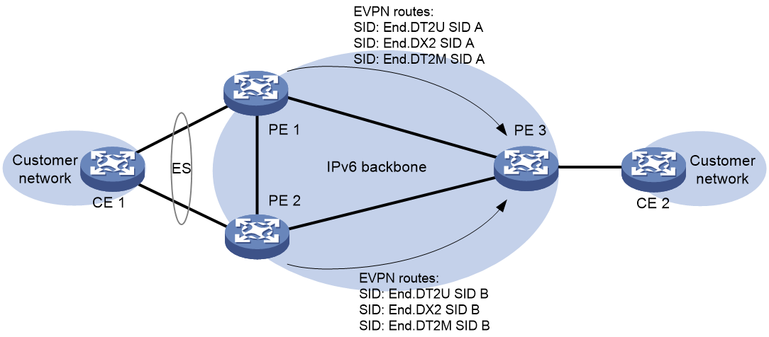

As shown in Figure 1, PEs set up an SRv6 tunnel by advertising End.DT2M SIDs, End.DT2U SIDs, End.DX2 SIDs, and End.DX2L SIDs to each other through BGP EVPN routes. On a PE, this SRv6 tunnel is used as a PW to encapsulate and forward Layer 2 data packets received from the local site and destined for a remote site. The devices on the IPv6 backbone transport network forward the SRv6-encapsulated packets according to the optimal routes calculated by an IGP. As a result, Layer 2 data packets of one customer site can be transparently forwarded to another site over the IPv6 backbone transport network.
Figure 1 EVPN VPLS over SRv6 network diagram
BGP EVPN route advertisement
A PE adds the End.DT2M SID and End.DT2U SID of a local VSI or the End.DX2 SID of an AC to BGP EVPN routes and advertises the routes to remote PEs. The routes help the PE establish an SRv6 tunnel to each remote PE.
·     The End.DT2M SID is carried in IMET routes and is used to deliver EVPN VPLS broadcast, unknown unicast, and multicast (BUM) traffic.
·     The End.DT2U or End.DX2 SID is carried in MAC/IP advertisement routes and is used to deliver EVPN VPLS known unicast traffic.
A pair of PEs both advertise End.DT2M SIDs and End.DT2U or End.DX2 SIDs, and they establish two SRv6 tunnels at two directions. The two SRv6 tunnels form a PW to carry Layer 2 customer traffic.

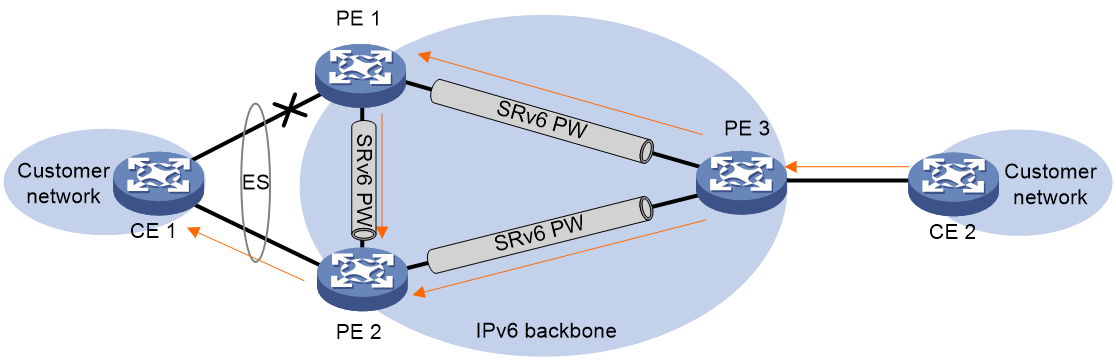

Local FRR for EVPN VPLS over SRv6
As shown in Figure 3, CE 1 is dualhomed to PE 1 and PE 2, and PE 1 is the DF. When the AC on PE 1 fails, PE 1 deletes the corresponding MAC address entries and advertises the local unreachable event to PE 2 and remote PEs (PE 3 in this example). Then, the remote PEs will switch traffic destined for CE 1 to the tunnels to PE 2. This process takes some time. PE 1 might receive packets destined for CE 1 before the remote PEs are notified of the unreachable event and perform link switchover. In this situation, PE 1 drops the packets, because the AC's MAC address entries have been deleted. To resolve this issue, enable local FRR on PE 1. If an AC fails, PE 1 changes the output interface of the AC's MAC address entries to the index of the bypass SRv6 PW between PE 1 and PE 2. When receiving packets from remote PEs after its AC fails, PE 1 forwards the packets to PE 2 over the bypass SRv6 PW to prevent traffic loss.
Figure 3 Local FRR network diagram
A loop might exist if PE 1 and PE 2 establish a bypass SRv6 PW between them through End.DT2U or End.DX2 SIDs. When the AC on PE 1 or PE 2 fails, PE 1 or PE 2 forwards the packets received from its peer back to its peer through the bypass SRv6 PW. To resolve this issue, use End.DT2UL or End.DX2L SIDs to establish a bypass SRv6 PW between PE 1 and PE 2. The packets from a bypass SRv6 PW carry an End.DT2UL or End.DX2L SID. A PE does not forward the packets back to the bypass SRv6 PW.
PEs preferentially use End.DT2UL or End.DX2L SIDs to establish a bypass SRv6 PW. If no End.DT2UL or End.DX2L SIDs are available, the PEs use End.DT2U or End.DX2 SIDs to establish a bypass SRv6 PW.

EVPN VPLS over SRv6 multihoming provides the single-active redundancy mode and all-active redundancy mode.
The redundant PEs at a dualhomed site each establish an EVPN PW to a remote PE. To use one PW as a backup of the other PW, use the single-active mode. To distribute traffic across the PWs for load sharing, use the all-active mode.

Local fast reroute (FRR) enables two PEs at a multihomed EVPN VPLS over SRv6 network site to set up a bypass SRv6 PW between them. This feature helps reduce the traffic loss caused by AC failure.

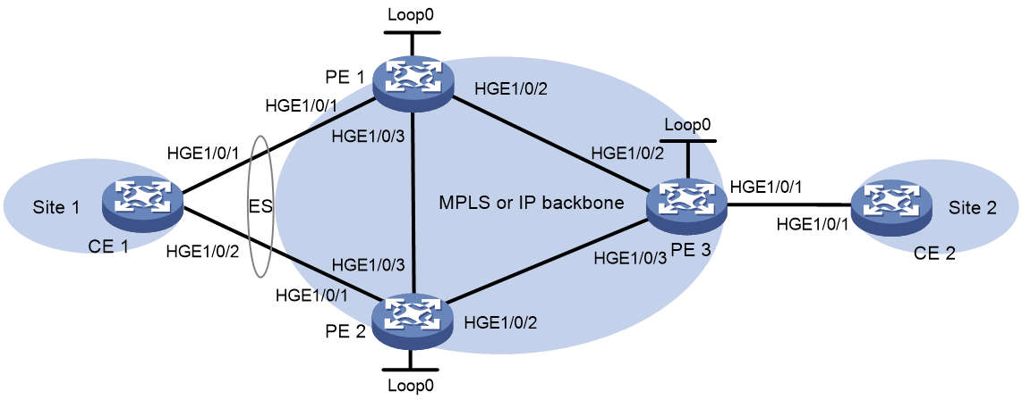

Example: Configuring EVPN VPLS over SRv6 multihoming (static link aggregation dual-homed)
As shown in Figure 5, CE 1 is dual-homed to PE 1 and PE 2 through static link aggregation. Configure EVPN VPLS over SRv6 for dual-homed site 1 and single-homed site 2 to communicate over the IPv6 backbone network through an SRv6 tunnel.

Example: Configuring EVPN VPLS over SRv6 multihoming (S-Trunk dual-homed)
As shown in Figure 6, CE 1 is dual-homed to PE 1 and PE 2 through S-Trunk. Configure EVPN VPLS over SRv6 for dual-homed site 1 and single-homed site 2 to communicate over the IPv6 backbone network through an SRv6 tunnel.
Figure 6 Network diagram
Device
Interface
IP address
Device
Interface
IP address
PE 1
Loop0
1::1/128
PE 2
Loop0
2::2/128
HGE1/0/1
N/A
HGE1/0/1
N/A
HGE1/0/2
10::1/64
HGE1/0/2
30::2/64
HGE1/0/3
20::1/64
HGE1/0/3
20::2/64
HGE1/0/3
10.1.2.1/24
HGE1/0/3
10.1.2.2/24
PE 3
Loop0
3::3/128
CE 1
RAGG1
100::1/64
HGE1/0/1
N/A
CE 2
HGE1/0/1
100::2/64
HGE1/0/2
10::3/64
HGE1/0/3
30::3/64

4.     Configure PE 3:
# Run OSPFv3 on PE 3.
<PE3> system-view
[PE3] ospfv3
[PE3-ospfv3-1] router-id 3.3.3.3
[PE3-ospfv3-1] segment-routing ipv6 locator aaa
[PE3-ospfv3-1] area 0
[PE3-ospfv3-1-area-0.0.0.0] quit
[PE3-ospfv3-1] quit
# Configure interface Loopback 0.
[PE3] interface loopback 0
[PE3-LoopBack0] ipv6 address 3::3 128
[PE3-LoopBack0] ospfv3 1 area 0
[PE3-LoopBack0] quit
# Enable L2VPN.
[PE3] l2vpn enable
# Configure HundredGigE 1/0/2, the interface connected to PE 1.
[PE3] interface hundredgige 1/0/2
[PE3-HundredGigE1/0/2] ipv6 address 10::3 64
[PE3-HundredGigE1/0/2] ospfv3 1 area 0
[PE3-HundredGigE1/0/2] undo shutdown
[PE3-HundredGigE1/0/2] quit
# Configure HundredGigE 1/0/3, the interface connected to PE 2.
[PE3] interface hundredgige 1/0/3
[PE3-HundredGigE1/0/3] ipv6 address 30::3 64
[PE3-HundredGigE1/0/3] ospfv3 1 area 0
[PE3-HundredGigE1/0/3] undo shutdown
[PE3-HundredGigE1/0/3] quit
# Configure PE 3 to establish IBGP neighbor relationships with PE 1 and PE 2, and enable BGP EVPN to advertise routes in SRv6 encapsulation to PE 1 and PE 2.
[PE3] bgp 100
[PE3-bgp-default] router-id 3.3.3.3
[PE3-bgp-default] peer 1::1 as-number 100
[PE3-bgp-default] peer 1::1 connect-interface loopback 0
[PE3-bgp-default] peer 2::2 as-number 100
[PE3-bgp-default] peer 2::2 connect-interface loopback 0
[PE3-bgp-default] address-family l2vpn evpn
[PE3-bgp-default-evpn] peer 1::1 enable
[PE3-bgp-default-evpn] peer 2::2 enable
[PE3-bgp-default-evpn] peer 1::1 advertise encap-type srv6
[PE3-bgp-default-evpn] peer 2::2 advertise encap-type srv6
[PE3-bgp-default-evpn] quit
[PE3-bgp-default] quit
# Create VSI vpna, create an EVPN instance for it, and enable SRv6 encapsulation. Configure an RD and route targets for the EVPN instance, enable the SID-route-recursion feature, and apply a locator to the EVPN instance.
[PE3] vsi vpna
[PE3-vsi-vpna] evpn encapsulation srv6
[PE3-vsi-vpna-evpn-srv6] route-distinguisher 1:1
[PE3-vsi-vpna-evpn-srv6] vpn-target 1:1 export-extcommunity
[PE3-vsi-vpna-evpn-srv6] vpn-target 1:1 import-extcommunity
[PE3-vsi-vpna-evpn-srv6] segment-routing ipv6 best-effort
[PE3-vsi-vpna-evpn-srv6] segment-routing ipv6 locator aaa
[PE3-vsi-vpna-evpn-srv6] quit
# Map HundredGigE 1/0/1 to the VSI.
[PE3] interface hundredgige 1/0/1
[PE3-HundredGigE1/0/1] xconnect vsi vpna
[PE3-HundredGigE1/0/1] quit
# Specify a source IP address for the outer IPv6 header of SRv6-encapsulated packets, and configure a locator to apply for End.DT2U SIDs and End.DT2M SIDs.
[PE3] segment-routing ipv6
[PE3-segment-routing-ipv6] encapsulation source-address 3::3
[PE3-segment-routing-ipv6] locator aaa ipv6-prefix 333:: 64 static 32
[PE3-segment-routing-ipv6-locator-aaa] quit
[PE3-segment-routing-ipv6] quit
5.     Configure CE 2.
<CE2> system-view
[CE2] interface hundredgige 1/0/1
[CE2-HundredGigE1/0/1] ipv6 address 100::2 64
[CE2-HundredGigE1/0/1] quit
# Verify that PE 3 has established SRv6 tunnels to PE 1 and PE 2. The SRv6 tunnels are ECMP tunnels that can load share traffi.
[PE3] display l2vpn peer srv6
Total number of SRv6 Tunnels: 2
2 up, 0 blocked, 0 down
VSI Name: vpna
   Peer            : 1::1
   Flag            : Main
   State           : Up
   Peer            : 2::2
   Flag            : Main
   State           : Up
# Verify that the SRv6 forwarding information on PE 3 is correct.
[PE3] display l2vpn forwarding srv6
Total number of VSIs: 1
Total number of SRv6 tunnels: 2, 2 up, 0 blocked, 0 down
VSI Name : vpna
Link ID             : 0x9000000   Type: BE    State: Up
In SID   : 333::1:0:4
Out SID  : 111::1:0:4
Link ID             : 0x9000001   Type: BE    State: Up
In SID   : 333::1:0:4
Out SID  : 222::1:0:3
# Verify that CE 1 and CE 2 can ping each other. (Details not shown.)
# Verify that CE 1 and CE 2 can ping each other when the PW on PE 1 or PE 2 fails. (Details not shown.)

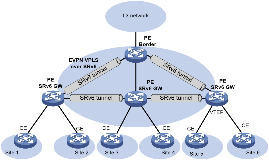

About distributed SRv6 gateways
Distributed SRv6 gateways provide Layer 3 forwarding for traffic in different subnets across sites and provide Layer 3 connectivity to the external network.
Distributed SRv6 gateway deployment

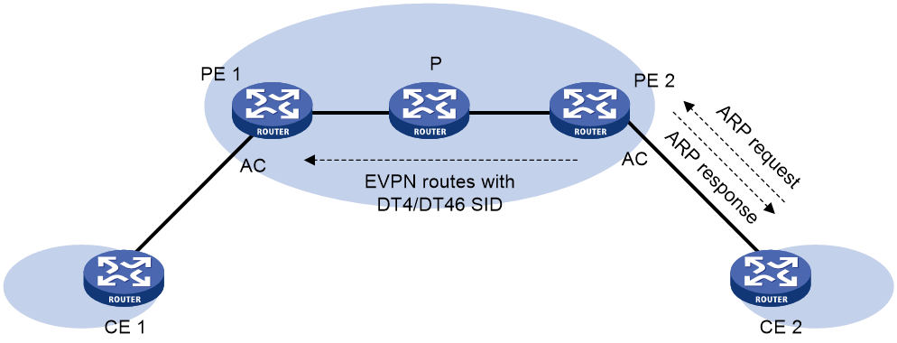

As shown in Figure 7, each site's PE acts as a distributed SRv6 gateway to perform Layer 3 forwarding for the traffic of the local site. A PE acts as a border gateway to the external Layer 3 network. On all the SRv6 gateways and border gateway, you must create VSI interfaces as gateway interfaces. The same VSI interface on multiple SRv6 gateways must be assigned the same IP address. This IP address will be used as the gateway address for users in the EVPN VPLS over SRv6 network.
Figure 7 Distributed SRv6 gateway deployment
Control plane working mechanisms
A distributed SRv6 gateway allocates an End.DT4 or End.DT46 SID to a MAC/IP advertisement route to identify the VPN instance to which the packets that match the route belong.
As shown in Figure 8, the ARP learning and BGP EVPN route advertisement process is as follows:
1.     CE 2 sends an ARP request to obtain the MAC address of the gateway (a VSI interface on PE 2).
2.     When PE 2 receives the ARP request from an AC, it identifies the VSI of the AC, and searches for the VSI interface associated with the VSI.
3.     PE 2 relies to the ARP request with the MAC address of the VSI interface. At the same time, PE 2 learns the ARP information of CE 2 to the VPN instance bound to the VSI interface and generates a FIB entry for the ARP information.
4.     PE 2 advertises the ARP information to PE 1 in a MAC/IP advertisement route. The route includes the End.DT4 or End.DT46 SID allocated by PE 2 to the VPN instance.
5.     PE 1 matches the route targets in the route with the local import route targets for a matching VPN instance. If a matching VPN instance is found, PE 1 learns the ARP information to the ARP table of the matching VPN instance and generates a FIB entry for the ARP information. The FIB entry includes the End.DT4 or End.DT46 SID allocated by PE 2.
In this process, both PE 1 and PE 2 have learned the ARP information of CE 2 and CE 2 has learned the MAC address of the gateway. In the same way, PE 1 and PE 2 can learn the ARP information of CE 1 and CE 1 can learn the MAC address of the gateway.

Specifying a source address for the IPv6 packets encapsulated by a distributed SRv6 gateway
To ensure that a distributed SRv6 gateway can forward data traffic, you must specify s source address for the outer IPv6 header encapsulated by the distributed SRv6 gateway.
You can specify any IPv6 address as the source address. As a best practice, specify an unused IPv6 address.
2.     Enter SRv6 view.
3.     Specify a source address for the IPv6 packets encapsulated by the distributed SRv6 gateway.
encapsulation source-address ipv6-address [ ip-ttl ttl-value ]
By default, no source address is specified for the IPv6 packets encapsulated by a distributed SRv6 gateway.

Verifying and maintaining distributed SRv6 gateways
·     Display EVPN ARP information.
display evpn route arp [ local | remote ] [ public-instance | vpn-instance vpn-instance-name ] [ count ]
·     Display EVPN routing table information.
display evpn routing-table [ ipv6 ] { public-instance | vpn-instance vpn-instance-name } [ count ]
·     Display IPv4 routing table information.
display ip routing-table [ all-vpn-instance | vpn-instance vpn-instance-name ] [ verbose ]
Distributed SRv6 gateway configuration examples
Example: Configuring distributed SRv6 gateways
As shown in Figure 9, PE 1 and PE 2 are distributed SRv6 gateways in the EVPN VPLS over SRv6 network. They forward Layer 3 traffic in different subnets across sistes.
