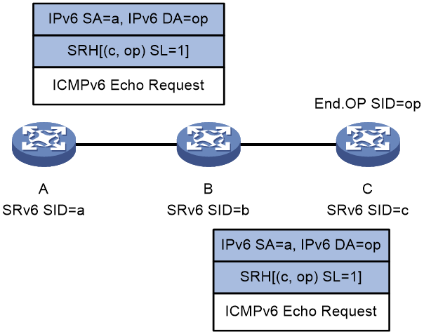

End.OP SID
An End.OP SID is an SRv6 SID of OAM type used in SRv6 SID/SRv6 TE policy-based ping/tracert operations. When a device receives a request packet destined for the local End.OP SID, it further checks the SRv6 SID in the packet. If the SRv6 SID is the local SRv6 SID, the device sends a reply; if not, the device discards the packet.
Take SRv6 SID-based ping as an example. As shown in Figure 2, in order to ping Device C, Device A constructs an ICMPv6 echo request by adding the End.OP SID of Device C to the SRH header in the request. Upon receiving the request and finding that request is destined for the local End.OP SID, Device C further checks whether SRv6 SID c is the local SRv6 SID. If it is the local SRv6 SID, Device C sends an ICMPv6 echo reply; if not, Device C discards the ICMPv6 echo request.
Figure 2 End.OP SID used in an SRv6 SID-based ping

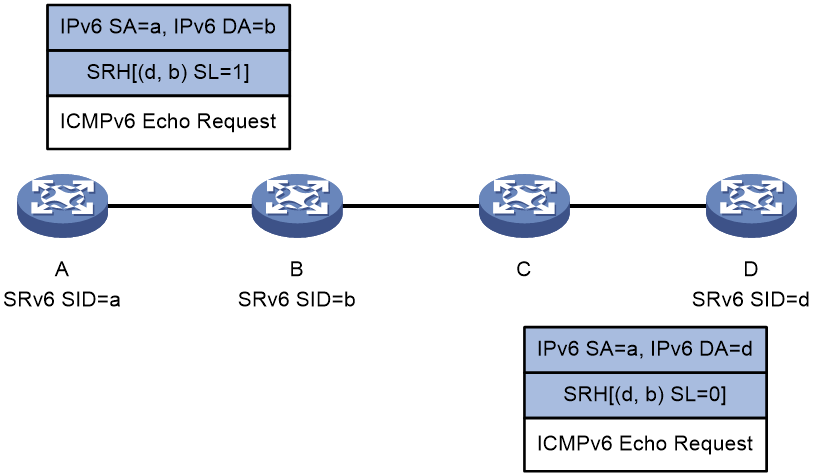

End-to-end ping
Use end-to-end ping to detect connectivity of the destination node in the SRv6 path. Only the destination node sends an ICMPv6 echo reply to the source node.
Figure 4 End-to-end ping
Figure 4 shows the end-to-end ping process as follows:
1.     Device A initiates a ping to Device D, with the SRv6 SIDs of Device B and Device D specified. It constructs an ICMPv6 echo request encapsulated with an SRH and then sends the request.
2.     Upon receiving the ICMPv6 echo request, the intermediate node performs relevant operations depending on whether it is SRv6 capable:
¡     On an SRv6 capable node (such as Device B):
The node forwards the ICMPv6 echo request based on the SRH if the packet destination IPv6 address is the local SRv6 SID.
¡     On an SRv6 incapable node (such as Device C):
The node forwards the ICMPv6 echo request according to routing table lookup.
3.     Upon receiving the ICMPv6 echo request with SL=0 in the SRH, Device D verifies the packet destination IPv6 address.
¡     If the IPv6 address is the local SRv6 SID, the verification succeeds, and Device D sends an ICMPv6 echo reply to Device A.
¡     If the IPv6 address is not the local SRv6 SID, the verification fails, and Device D discards the ICMPv6 echo request.
4.     Device A determines whether the destination node is reachable based on reception of the ICMPv6 echo reply:
¡     If the ICMPv6 echo reply is received before the specified timeout timer expires, the destination node is reachable.
¡     If no ICMPv6 echo reply is received when the specified timeout timer expires, the destination node is unreachable.

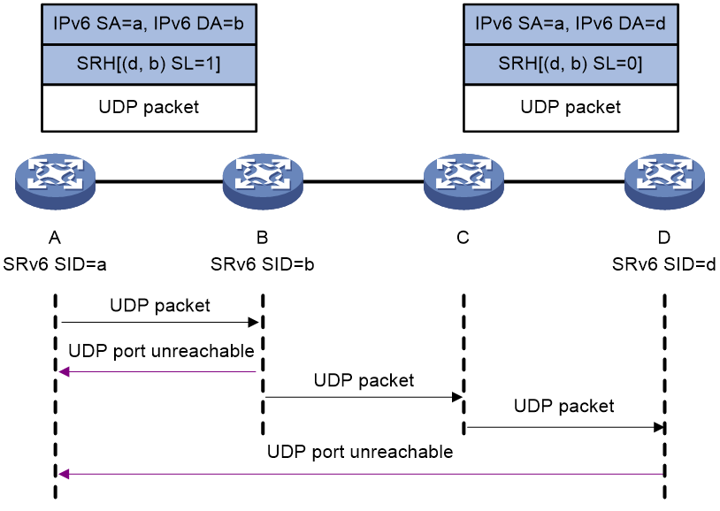

Overlay tracert
Use overlay tracert to display information about only SRv6 nodes in the SRv6 path.
In an overlay tracert operation, do not specify the End.OP SID because some nodes might fail to send a reply.
Figure 5 Overlay tracert
Figure 5 shows the overlay tracert process as follows:
1.     Device A initiates a tracert to Device D, with the SRv6 SIDs of Device B and Device D specified. It constructs a UDP packet encapsulated with an SRH and then sends the UDP packet (the Hop Limit value is 64 in the IPv6 packet header).
Make sure you specify a destination UDP port that is not used by any applications on the destination node.
2.     Upon receiving the UDP packet, the intermediate node performs relevant operations depending on whether it is SRv6 capable:
The node sends an ICMPv6 port unreachable message to Device A, and then forwards the UDP packet based on the SRH if the following conditions exist:
-     The packet destination IPv6 address is the local SRv6 SID.
-     The O-flag is set in the packet SRH Flags field.
The node forwards the UDP packet according to routing table lookup without returning an ICMPv6 port unreachable message.
3.     Upon receiving the UDP packet with O-flag set and SL=0 in the SRH, Device D verifies the packet destination IPv6 address.
¡     If the IPv6 address is the local SRv6 SID, the verification succeeds, and Device D sends an ICMPv6 port unreachable message to Device A.
¡     If the IPv6 address is not the local SRv6 SID, the verification fails, and Device D discards the UDP packet.
4.     Device A determines whether the destination node is reachable based on reception of the ICMPv6 port unreachable message:
¡     If the ICMPv6 port unreachable message is received before the specified timeout timer expires, the destination node is reachable. The tracert result displays the SRv6 path from the source node to the destination node.
¡     If no ICMPv6 port unreachable message is received when the specified timeout timer expires, the destination node is unreachable. You can locate the faulty node based on the tracert result.

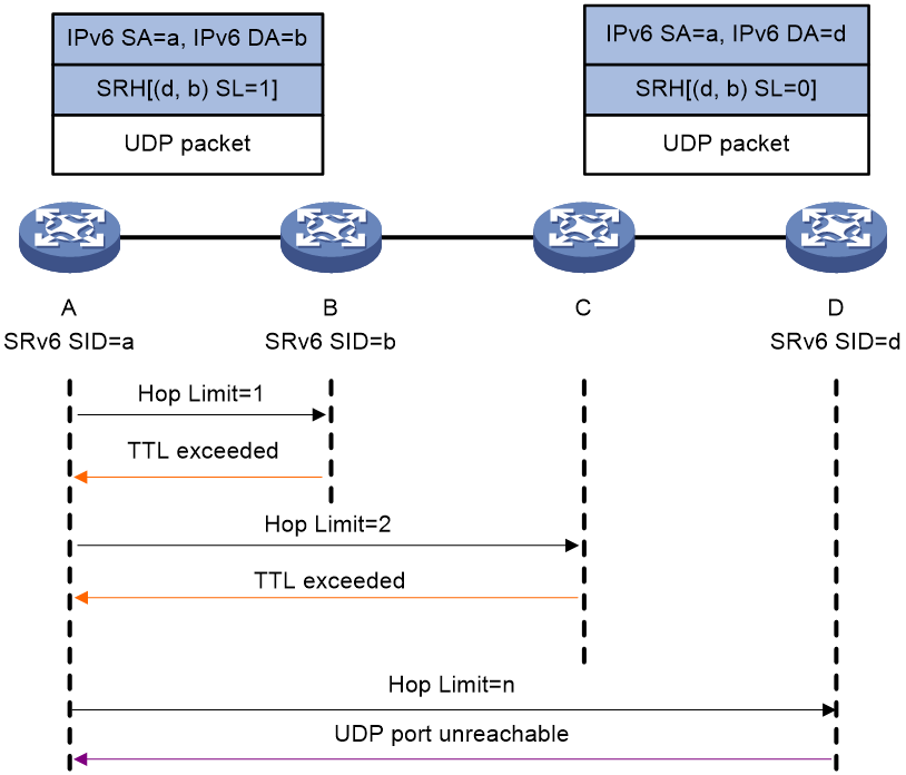

Hop-by-hop tracert
Use hop-by-hop tracert to display information about all nodes (whether they are SRv6 capable or not) in the SRv6 path.
Figure 6 Hop-by-hop tracert
Figure 6 shows the hop-by-hop tracert process as follows:
1.     Device A initiates a tracert to Device D, with the SRv6 SIDs of Device B and Device D specified. It constructs a UDP packet encapsulated with an SRH and then sends the UDP packet (the Hop Limit value is 1 in the IPv6 packet header).
2.     Upon receiving the UDP packet with the Hop Limit value in the IPv6 packet header being 0, the intermediate node sends an ICMPv6 timeout message to Device A.
3.     Upon receiving the ICMPv6 timeout message, Device A sends another UDP packet by adding the Hop limit value by 1.
4.     Upon receiving the UDP packet with the Hop Limit value in the IPv6 packet header not being 0, the intermediate node forwards the UDP packet as follows:
The node forwards the UDP packet based on the SRH if the packet destination IPv6 address is the local SRv6 SID.
The node forwards the UDP packet according to routing table lookup.
5.     Upon receiving the UDP packet (with Hop Limit 0 in the IPv6 packet header and SL=0 in the SRH), Device D verifies the packet destination IPv6 address.
6.     Device A determines whether the destination node is reachable based on reception of the ICMPv6 port unreachable message:
