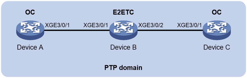

Clock node and PTP port (IEEE 1588 version 2)
A node in a PTP domain is called a clock node. A port enabled with PTP is called a PTP port. IEEE 1588 version 2 defines the following types of basic clock nodes:
·     Ordinary Clock (OC)—A PTP clock with a single PTP port in a PTP domain for time synchronization. It synchronizes time from its upstream clock node through the port. If an OC operates as the clock source, it sends synchronization time through a single PTP port to its downstream clock nodes.
·     Boundary Clock (BC)—A clock with more than one PTP port in a PTP domain for time synchronization. A BC uses one of the ports to synchronize time from its upstream clock node. It uses the other ports to synchronize time to the relevant downstream clock nodes. If a BC operates as the clock source, such as BC 1 in Figure 1, it synchronizes time through multiple PTP ports to its downstream clock nodes.
·     Transparent Clock (TC)—A TC does not keep time consistency with other clock nodes. A TC has multiple PTP ports. It forwards PTP messages among these ports and performs delay corrections for the messages, instead of performing time synchronization. TCs include the following types:
¡     End-to-End Transparent Clock (E2ETC)—Forwards non-P2P PTP messages in the network and calculates the delay of the entire link.
¡     Peer-to-Peer Transparent Clock (P2PTC)—Forwards only Sync, Follow_Up, and Announce messages, terminates other PTP messages, and calculates the delay of each link segment.
Figure 1 shows the positions of these basic clock nodes in a PTP domain.
Figure 1 Clock nodes and PTP ports in a PTP domain (IEEE 1588 version 2)
In addition to these basic types of clock nodes, PTP introduces hybrid clock nodes. For example, a TC+OC has multiple PTP ports in a PTP domain. One port is the OC type, and the others are the TC type.
A TC+OC forwards PTP messages through TC-type ports and performs delay corrections. In addition, it synchronizes time through its OC-type port. TC+OCs include these types: E2ETC+OC and P2PTC+OC.

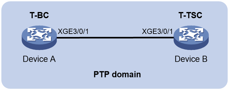

Clock node and PTP port (ITU-T G.8275.1)
A node in a PTP domain is a clock node. A port enabled with PTP is a PTP port.
ITU-T G.8275.1 defines the following types of basic clock nodes:
·     Telecom boundary clock (T-BC)—A clock node with more than one PTP port in a PTP domain for time synchronization. It uses one of the ports to synchronize time to its upstream clock node and uses the other ports to distribute time to the downstream clock nodes. If a T-BC operates as the clock source, it distributes time through multiple PTP ports to its downstream clock nodes.
·     Telecom transparent Clock (T-TC)—A clock code that forwards non-P2P PTP messages in the network. The forwarding duration will be included in calculation of the entire link delay.
·     Telecom time slave clock (T-TSC) —An OC clock node (as defined in IEEE 1588 version 2 and IEEE 802.1AS) that can act only as a member clock.
Figure 2 Clock nodes and PTP ports in a PTP domain (ITU-T G.8275.1)

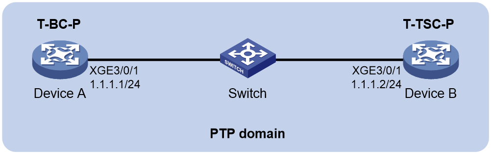

Clock nodes and PTP ports (ITU-T G.8275.2)

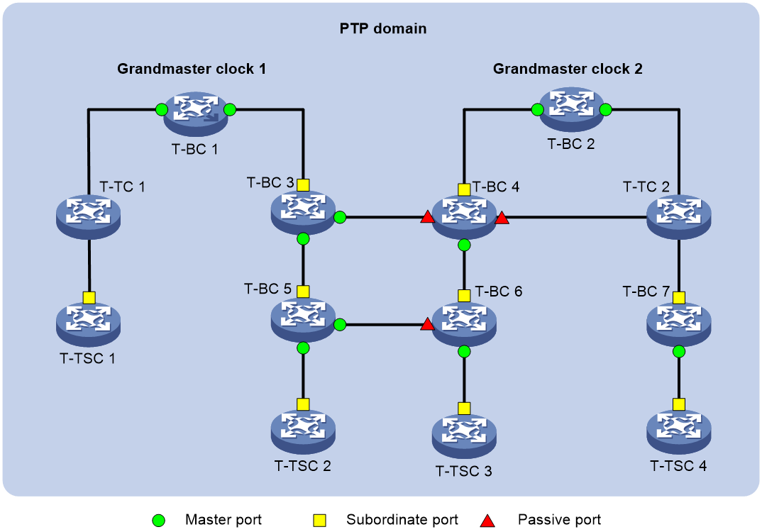

ITU-T G.8275.2 defines the following types of basic clock nodes:
·     Partial-support telecom boundary clock (T-BC-P)—A clock node with more than one PTP port in a PTP domain for time synchronization. It uses one of the ports to synchronize time to its upstream clock node and uses the other ports to distribute time to the downstream clock nodes. When a T-BC-P clock node is a clock source, it distributes time through multiple PTP ports to its downstream clock nodes.
·     Partial-support telecom time slave clock (T-TSC-P)—A clock node with a single PTP port in a PTP domain for time synchronization. It synchronizes time from its upstream clock node through the port. It can operate only as a member clock.
Figure 3 shows the positions of these basic clock nodes in a PTP domain.
Figure 3 Clock nodes and PTP ports in a PTP domain (ITU-T G.8275.2)

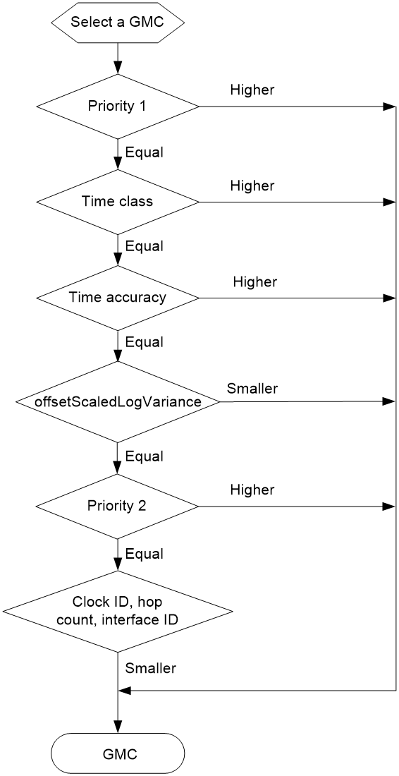

A GM can be manually specified. It can also be automatically elected through the BMC algorithm as follows:
1.     The clock nodes in a PTP domain exchange announce messages and elect a GM by using the following rules in descending order of precedence:
a.     Clock node with higher priority 1.
b.     Clock node with higher time class.
c.     Clock node with higher time accuracy.
d.     Clock node with higher priority 2.
e.     Clock node with a smaller port ID (containing clock number and port number).
The master nodes, member nodes, master ports, and subordinate ports are determined during the process. Then a spanning tree with the GM as the root is generated for the PTP domain.
2.     The master node periodically sends announce messages to the member nodes. If the member nodes do not receive announce messages from the master node, they determine that the master node is invalid, and they start to elect another GM.
Figure 4 BMC comparison rule for GMC selection

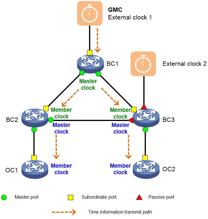

The master-member/subordinate relationships between the clock nodes (except for the TCs) on a PTP network are automatically determined based on the Best Master Clock (BMC) algorithm. You can also manually specify a role for the clock nodes.
The following master-member/subordinate relationships exist:
·     Master/Member node—A master node propagates time synchronization information, and a member node receives time synchronization information.
·     Master/Member clock—The clock on a master node is a master clock. The clock on a member node is a member clock.
·     Master/Subordinate port—A master port propagates time synchronization, and a subordinate port receives time synchronization information. The master and subordinate ports can be on a BC or an OC. A port that neither propagates nor receives timing information is a passive port. Passive ports are used to prevent PTP messages from forming loops.
After the grandmaster clock is elected and master-member/subordinate relationships are established, a loop-free, all connected shortest path tree with the grandmaster clock as the root is established in the PTP domain, as shown in Figure 5. Time is synchronized between the clock nodes in the domain along the path tree.
Figure 5 PTP master-member/subordinate relationships

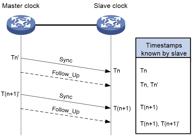

After the grandmaster clock is selected and master-member relationships are established, the master clock sends Sync messages to the member clocks periodically. Assume that the path delay between the master and member clock nodes remains unchanged, if the frequency of the member clock and the master clock are synchronized, the time offset between the master and member clock will be the same at the same intervals, which is T(n+1)–Tn = T(n+1)'–Tn', as shown in Figure 6.
1.     If T(n+1)–Tn > T(n+1)'–Tn', the member clock is faster in frequency than the master clock and will reduce its frequency.
2.     If T(n+1)–Tn < T(n+1)'–Tn', the member clock is slower in frequency than the master clock and will increase frequency faster.
The member clock uses the formula T(n+1)–Tn / T(n+1)'–Tn' to calculate its frequency ratio with the master clock and adjust its clock frequency accordingly.
PTP frequency synchronization can run in single-step mode or two-step mode. The figure below shows the most commonly used two-step frequency synchronization mode. In single-step mode, Tn' and T(n+1)' timestamps are carried in a Sync message, and no Follow_Up message is sent.
Figure 6 PTP frequency synchronization in two-step mode

The Peer Delay mechanism measures the average path delay between two clock nodes by using Pdelay messages. The two clock nodes (BC, TC, or OC) using this mechanism send Pdelay messages to each other, and calculate the one-way link delay between them independently. The message interaction process and delay calculation method are identical on the two nodes. TCs that exist between master and member clock nodes divide the synchronization path into multiple links. Each TC makes link delay and residence time corrections on the Sync messages.
This mechanism can be implemented in one of the following two modes:
·     Two-step mode
As shown in Figure 8, Pdelay messages include Pdelay_Req, Pdelay_Resp, and Pdelay_Resp_Follow_Up messages. t2 is carried in the Pdelay_Resp message, and t3 is carried in the Pdelay_Resp_Follow_Up message.
·     Single-step mode:
Pdelay messages include Pdelay_Req and Pdelay_Resp messages. t3 – t2 is carried in the Pdelay_Resp, and no Pdelay_Resp_Follow_Up message is sent.
Figure 8 uses Clock node B as an example to describe the Peer Delay mechanism.
1.     Clock node B sends a Pdelay_Req message to Clock node A, and records the sending time t1. Upon receiving the message, Clock node A records the receiving time t2.
2.     Clock node A sends a Pdelay_Req message that carries t2 to Clock node B, and records the sending time t3. Upon receiving the message, Clock node B records the receiving time t4.
3.     Clock node A immediately sends a Pdelay_Resp_Follow_Up message carrying t3 to Clock node B after sending the Pdelay_Req message.
After this procedure, Clock node B obtains all the four timestamps and can make the following calculations:
·     Round-trip delay between Clock node A and Clock node B: (t2 – t1) + (t4 – t3)
·     One-way delay between Clock node A and Clock node B: [(t2 – t1) + (t4 – t3)] / 2 = [(t4 – t1) – (t3 – t2)] / 2
·     Time offset between the member clock and the master clock: Sync message receiving time on the member clock Sync message sending time on the master clock – Total one-way delays on all links – Total PTP message residence time on all TCs.
Figure 8 Peer Delay mechanism (two-step mode)

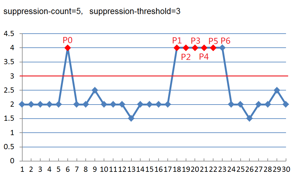

Configuring the PTP offset threshold and PTP synchronization suppressions
Application scenarios
This command is used to prevent clock source jumps. With this mechanism, the device can ensure that time synchronization is restored after the clock source stabilizes, and avoid time synchronization errors caused by sudden clock changes.
Operating mechanism
After master-member relationships are established between the clock nodes, the master and member clock nodes exchange PTP messages and record the message transmit and receive time. Based on the timestamps, each member clock calculates the path delay and then gets the time offset between them and the master clock and adjusts their time accordingly for time synchronization with the master clock.
With this command configured, if the clock is in a stable synchronization state but the offset value at the current sampling point exceeds the PTP time offset threshold, the device will identify this as a clock source jump and stop the current PTP time synchronization. The device will then determine whether to synchronize subsequent clock signals based on the following rules:
·     If the offset for the next sampling point is smaller than or equal to the PTP time offset threshold, the device continues synchronization with the clock source.
·     If the offset is greater the PTP time offset threshold, the device performs PTP time synchronization only when the number of suppressions reaches the specified value. When the device receives the next clock signal, it performs PTP time synchronization no matter whether the offset value is greater than the PTP time offset threshold or not.
Assume that the values for suppression-count and threshold-value are set to 5 and 3, respectively. When the offset is less than or equal to 3, the device synchronizes its time with the clock source normally. When a sudden clock change causes the offset to exceed 3, the device stops synchronization with the clock signal until the value of suppression-count is reached. As shown in Figure 9, because the offset value is greater than 3 at sampling points P0 through P5, the device stops synchronization with the clock source. At sampling point P6, the device starts to synchronize with the clock source no matter whether the offset is greater than the PTP time offset threshold or not, because the number of suppressions has reached 5.
Figure 9 PTP clock source jump prevention
2.     Configure the PTP offset threshold and the number of times PTP time synchronization is suppressed.
ptp time-offset { suppression-count suppression-count | suppression-threshold threshold-value } *
By default, the PTP offset threshold is 3000 nanoseconds, and PTP time synchronization is suppressed twice.

When the device acts as the GM clock on the network and services that rely on PTP clock synchronization (such as iFIT measurement and deterministic network technology) exist on the network, a PTP time jump might affect the operation of these services. This task helps reduce PTP time jumps, and consequently minimize the impact of PTP time jumps on services.
Operating mechanism
The device has two local clock sources: one is UTC time (generated by the local crystal on the MPU), and the other is TAI time (also known as PTP time, generated by the clock daughtcard/PTP chip). After this task is configured, the device synchronizes the TAI time and UTC time as follows by default if the device acts as the GM clock on the network:
1.     The device uses the UTC time as the reference clock source for the entire network.
2.     After the network administrator enables PTP in interface view, the device synchronizes the clock daughtcard/PTP chip with the UTC time.
3.     After synchronizing with the UTC time, the clock daughtcard/PTP chip uses its own frequency for timekeeping. The device synchronizes downstream devices with the TAI time.
4.     The device automatically synchronizes the PTP-enabled clock daughtercard/PTP chip with the UTC time every 6 hours.
5.     If the network administrator changes the UTC time (for example, execute the clock data-time, ptp utc offset, or ptp utc { leap59-date | leap61-date } command, the device will instantly and automatically synchronize the clock daughtercard and PTP chip with the UTC time.
Finally, devices on the network are synchronized with the UTC time of the device.

Configuring clock priorities
Configuring a priority for a clock (IEEE 1588 version 2)
Priorities for clocks are used to elect the GM. The smaller the priority value, the higher the priority.
2.     Configure the priority for a clock .
ptp priority clock-source { local | tod0 | tod1 } { priority1 priority1 | priority2 priority2 }
When the PTP profile is IEEE 1588 version 2, the priority 1 and priority 2 default values are both 128.
Configuring a priority for a clock (ITU-T G.8275.1 and ITU-T G.8275.2)
Under the ITU-T G.8275.1 or ITU-T G.8275.2 PTP profile, you can configure priorities for the local clock node and the peer clock node.
Priorities for clocks affect the GM election. The smaller the priority value, the higher the priority. For more information about GM election, see "PTP operating mechanisms
Grandmaster clock selection and master-member/subordinate relationship establishment."
This task is available only under the ITU-T G.8275.1 and ITU-T G.8275.2 PTP profiles.
Configuring priorities for the local clock node
2.     Configure the priority for a clock.
ptp priority clock-source { local | tod0 | tod1 } { priority2 priority2 | local-priority local-priority }
By default, the priority 2 value is 128 for T-BC, T-TC, and T-BC-P clock nodes and 255 for T-TSC and T-TSC-P clock nodes. The local priority value is 128.
Configuring a priority for the peer clock node
An announce message does not carry the local priority of the clock node. Each PTP interface on a clock node has a local priority. You can use the ptp local-priority command to configure a local priority for a PTP interface. This priority will be used as the local priority of the peer node in BMC selection and is one of the factors that determine whether the peer node can be elected as the GM.
To configure a priority for the peer clock node:
2.     Enter Layer 2 Ethernet interface view, Layer 3 Ethernet interface view, or FlexE physical interface view.
3.     Configure a priority for the peer clock node.
ptp local-priority local-priority
By default, the clock priority of the peer clock node is 128.

PTP configuration examples

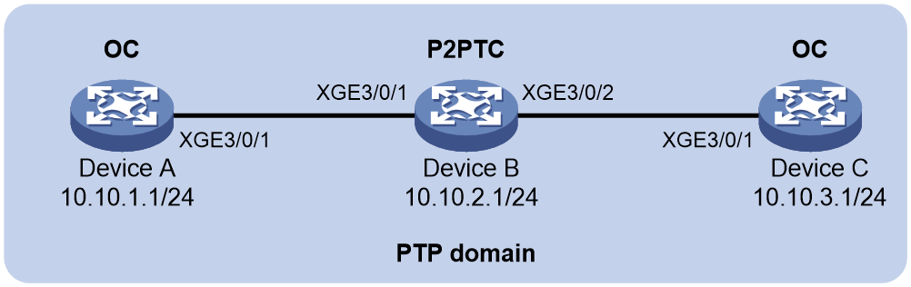

Example: Configuring PTP (IEEE 1588 version 2, IEEE 802.3/Ethernet transport, multicast transmission)
As shown in Figure 10, configure PTP (IEEE 1588 version 2, IEEE 802.3/Ethernet transport, multicast transmission) to enable time synchronization between Device A and Device C.
·     Specify the IEEE 1588 version 2 PTP profile and multicast IEEE 802.3/Ethernet transport of PTP messages for Device A, Device B, and Device C.
·     Assign Device A, Device B, and Device C to the same PTP domain. Specify the OC clock node type for Device A and Device C, and E2ETC clock node type for Device B. All clock nodes elect a GM through BMC in the PTP domain.
·     Use the default Request_Response delay measurement mechanism on Device A and Device C.
Figure 10 Network diagram
1.     Configure Device A:
# Specify the IEEE 1588 version 2 PTP profile.
<DeviceA> system-view
[DeviceA] ptp profile 1588v2
# Specify the OC clock node type.
[DeviceA] ptp mode oc
# Specify PTP for obtaining the time on the default MDC.
[DeviceA] clock protocol ptp mdc 1
# Enable PTP on Ten-GigabitEthernet 3/0/1.
[DeviceA] interface ten-gigabitethernet 3/0/1
[DeviceA-Ten-GigabitEthernet3/0/1] ptp enable
[DeviceA-Ten-GigabitEthernet3/0/1] quit
2.     Configure Device B:
<DeviceB> system-view
[DeviceB] ptp profile 1588v2
# Specify the E2ETC clock node type.
[DeviceB] ptp mode e2etc
[DeviceB] clock protocol ptp mdc 1
[DeviceB] interface ten-gigabitethernet 3/0/1
[DeviceB-Ten-GigabitEthernet3/0/1] ptp enable
[DeviceB-Ten-GigabitEthernet3/0/1] quit
# Enable PTP on Ten-GigabitEthernet 3/0/2.
[DeviceB] interface ten-gigabitethernet 3/0/2
[DeviceB-Ten-GigabitEthernet3/0/2] ptp enable
[DeviceB-Ten-GigabitEthernet3/0/2] quit
3.     Configure Device C:
<DeviceC> system-view
[DeviceC] ptp profile 1588v2
[DeviceC] ptp mode oc
[DeviceC] clock protocol ptp mdc 1
[DeviceC] interface ten-gigabitethernet 3/0/1
[DeviceC-Ten-GigabitEthernet3/0/1] ptp enable
[DeviceC-Ten-GigabitEthernet3/0/1] quit
When the network is stable, perform the following tasks:
·     Use the display ptp clock command to display PTP clock information.
·     Use the display ptp interface brief command to display brief PTP running information for all PTP interfaces.
# Display PTP clock information on Device A.
[DeviceA] display ptp clock
PTP profile         : IEEE 1588 Version 2
PTP mode            : OC
Slave only          : No
Sync uncertain      : Disabled
Clock state         : Disabled
Lock status         : Unlocked
Clock ID            : 000FE2-FFFE-FF0000
Clock type          : Local
Clock domain        : 0
Number of PTP ports : 1
Priority1     : 128
Priority2     : 128
Clock quality :
 Class                 : 248
 Accuracy              : 254
 Offset (log variance) : 65535
Offset from master : 0 (ns)
Mean path delay    : 0 (ns)
Steps removed      : 0
Local clock time   : Sun Jan 15 20:57:29 2019
Clock source info:
 Clock   Pri1 Pri2 Accuracy Class TimeSrc Direction In-Status Offset(log variance)
 Local   128  128  254      248   160     N/A       N/A       65535
 ToD0    128  128  32       6     32      In        Inactive  65535

# Display PTP clock information on Device B.
[DeviceB] display ptp clock
PTP mode            : E2ETC
Slave only          : No
Clock ID            : 000FE2-FFFE-FF0001
Clock type          : Local
Clock domain        : 0
Number of PTP ports : 2
Priority1     : 128
Priority2     : 128
Clock quality :
 Class                 : 248
 Accuracy              : 254
Offset from master : N/A
Mean path delay    : N/A
Steps removed      : N/A
Clock source info:
 ToD1    128  128  32       6     32      N/A       Inactive  65535
# Display brief PTP running information for all PTP interfaces on Device B.
[DeviceB] display ptp interface brief
Name         State         Delay mechanism  Clock step  Asymmetry correction
XGE3/0/1     N/A           E2E              Two         0
XGE3/0/2     N/A           E2E              Two         0
The output shows that Device A is elected as the GM, and Ten-GigabitEthernet3/0/1 on Device A is the master port.
Example: Configuring PTP (IEEE 1588 version 2, IPv4 UDP transport, multicast transmission)
As shown In Figure 11, configure PTP (IEEE 1588 version 2, IPv4 UDP transport, multicast transmission) to enable time synchronization between the devices.
·     Specify the IEEE 1588 version 2 PTP profile and multicast IPv4 UDP transport of PTP messages for Device A, Device B, and Device C.
·     Assign Device A, Device B, and Device C to the same PTP domain. Specify the OC clock node type for Device A and Device C, and P2PTC clock node type for Device B. All clock nodes elect a GM through BMC in the PTP domain.
·     Specify the peer delay measurement mechanism (p2p) for Device A and Device C.
Figure 11 Network diagram
# Configure the source IP address for multicast PTP messages transmitted over IPv4 UDP.
[DeviceA] ptp source 10.10.1.1
# On Ten-GigabitEthernet 3/0/1, specify the IPv4 UDP transport protocol for PTP messages and the peer delay measurement mechanism, and enable PTP.
[DeviceA-Ten-GigabitEthernet3/0/1] ptp transport-protocol udp
[DeviceA-Ten-GigabitEthernet3/0/1] ptp delay-mechanism p2p
# Specify the P2PTC clock node type.
[DeviceB] ptp mode p2ptc
[DeviceB] ptp source 10.10.2.1
# On Ten-GigabitEthernet 3/0/1, specify the IPv4 UDP transport protocol for PTP messages and enable PTP.
[DeviceB-Ten-GigabitEthernet3/0/1] ptp transport-protocol udp
# On Ten-GigabitEthernet 3/0/2, specify the IPv4 UDP transport protocol for PTP messages and enable PTP.
[DeviceB-Ten-GigabitEthernet3/0/2] ptp transport-protocol udp
[DeviceC] ptp source 10.10.3.1
[DeviceC-Ten-GigabitEthernet3/0/1] ptp transport-protocol udp
[DeviceC-Ten-GigabitEthernet3/0/1] ptp delay-mechanism p2p
When the network is stable, perform the following tasks on Device A and Device B.
PTP mode            : OC
Slave only          : No
Clock type          : Local
Clock domain        : 0
Priority1     : 128
Priority2     : 128
Clock quality :
 Class                 : 248
 Accuracy              : 254
Steps removed      : 0
Clock source info:
# Display brief PTP running information for all PTP interfaces on Device A.
[DeviceA] display ptp interface brief
XGE3/0/1     Master        P2P              Two         0
PTP mode            : P2PTC
Slave only          : No
Clock type          : Local
Clock domain        : 0
Priority1     : 128
Priority2     : 128
Clock quality :
 Class                 : 248
 Accuracy              : 254
Steps removed      : N/A
Clock source info:
XGE3/0/1     N/A           P2P              Two         0
XGE3/0/2     N/A           P2P              Two         0

# Display brief PTP running information for all PTP interfaces on Device C.
[DeviceC] display ptp interface brief
XGE3/0/1     Slave         E2E              Two         0
XGE3/0/2     Master        E2E              Two        0
Example: Configuring PTP (ITU-T G.8275.1, IEEE 802.3/Ethernet transport, multicast transmission)
As shown in Figure 13, configure PTP (ITU-T G.8275.1, IEEE 802.3/Ethernet transport, multicast transmission) to enable Device A to synchronize Device B.
·     Specify the ITU-T G.8275.1 PTP profile for Device A and Device B.
·     Assign Device A and Device B to the same PTP domain. Specify the T-BC clock node type for Device A and T-TSC clock node type for Device B.
·     Use the default Request_Response delay measurement mechanism on Device A and Device B.
Figure 13 Network diagram
IMPORTANT
IMPORTANT:
The ITU-T G.8275.1 PTP profile transports PTP messages over IEEE 802.3/Ethernet rather than IPv4 UDP and in multicast rather than unicast mode.
# Specify the ITU-T G.8275.1 PTP profile.
[DeviceA] ptp profile g8275.1
# Specify the T-BC clock node type.
[DeviceA] ptp mode t-bc
[DeviceB] ptp profile g8275.1
# Specify the T-TSC clock node type.
[DeviceB] ptp mode t-tsc
PTP profile         : ITU-T G.8275.1
PTP mode            : T-BC
Slave only          : No
Clock ID            : 24881D-FFFE-F20100
Clock type          : Local
Clock domain        : 24
Priority1      : 128
Priority2      : 128
Local priority : 128
Clock quality :
 Class                 : 248
 Accuracy              : 254
Steps removed       : 0
Local clock time    : Fri Dec 7 00:59:44 2018
Clock source info:
XGE3/0/1     Master        E2E              Two         0
PTP mode            : T-TSC
Slave only          : No
Clock ID            : 2461E3-FFFE-A20200
Clock type          : Local
Clock domain        : 24
Priority1      : 128
Priority2      : 255
Clock quality :
 Class                 : 255
 Accuracy              : 254
Offset from master  : 50 (ns)
Mean path delay     : 5000 (ns)
Steps removed       : 1
Local clock time    : Fri Dec 7 14:52:54 2018
Clock source info:
Example: Configuring PTP (ITU-T G.8275.2, IPv4 UDP encapsulation, unicast transmission)
As shown in Figure 14, Device A and Device B are in a PTP domain. The switch is a Layer 2 switch that does not support PTP. Configure PTP (ITU-TG.8275.2, IPv4 UDP encapsulation, unicast transmission) to enable Device B to synchronize to Device A.
·     Specify the ITU-TG.8275.2 PTP profile for Device A and Device B.
Figure 14 Network diagram
Configure IP addresses and routing protocols for the devices. Make sure the devices are reachable to each other.
IMPORTANT
IMPORTANT:
The ITU-T G.8275.2 PTP profile transports PTP messages over IPv4 UDP rather than IEEE 802.3/Ethernet and in unicast rather than multicast mode.
# Specify the ITU-T G.8275.2 PTP profile.
[DeviceA] ptp profile g8275.2
# Specify the T-BC-P clock node type.
[DeviceA] ptp mode t-bc-p
# Enable PTP and configure PTP parameters on Ten-GigabitEthernet 3/0/1.
[DeviceA-Ten-GigabitEthernet3/0/1] ptp unicast-destination 1.1.1.2
[DeviceA-Ten-GigabitEthernet3/0/1] ptp unicast-negotiate grant-port
[DeviceA-Ten-GigabitEthernet3/0/1] ptp notslave disable
[DeviceB] ptp profile g8275.2
# Specify the T-TSC-P clock node type.
[DeviceB] ptp mode t-tsc-p
[DeviceB-Ten-GigabitEthernet3/0/1] ptp unicast-destination 1.1.1.1
[DeviceB-Ten-GigabitEthernet3/0/1] ptp unicast-negotiate request-port
·     Use the display ptp interface brief command to display brief PTP running information for all interfaces.
PTP profile         : ITU-T G.8275.2
PTP mode            : T-BC-P
Slave only          : No
Clock ID            : 140570-FFFE-930100
Clock type          : Local
Clock domain        : 44
Priority1      : 128
Priority2      : 128
Clock quality :
 Class                 : 248
 Accuracy              : 254
Steps removed       : 0
Local clock time    : Sat May 9 10:38:42 2020
Clock source info:
 Clock   LP   Pri2 Accuracy Class TimeSrc Direction In-Status Offset(log variance)
 ToD0    128  128  32       6     32      N/A       Inactive  65535
# Display brief PTP running information on Device A.
PTP mode            : T-TSC-P
Slave only          : No
Clock ID            : 147405-FFFE-E30200
Clock type          : Local
Clock domain        : 44
Priority1      : 128
Priority2      : 255
Clock quality :
 Class                 : 255
 Accuracy              : 254
Mean path delay     : 2169 (ns)
Steps removed       : 1
Local clock time    : Sat May 9 10:40:04 2020
Clock source info:
 Local   128  255  254      255   160     N/A       N/A       65535
 ToD0    128  255  254      255   32      N/A       Inactive  65535
 ToD1    128  255  254      255   32      N/A       Inactive  65535
# Display brief PTP running information on Device B.
GE1/0/2      Slave         E2E              Two         0
The output shows that Device A has been elected as the GM, and Ten-GigabitEthernet 3/0/1 on Device A is the master port.
