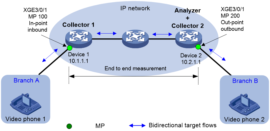

End-to-end packet loss measurement
iNQA measures whether packet loss occurs between the ingress points (where the target flow enters the IP network) and the egress points (where the flow leaves the network).
·     Scenario 1: The target flow has only one ingress point and one egress point , and the two points are on the same network, for example, the local area network or the core network.
As shown in Figure 5, to measure packet loss for the flow in the network, deploy iNQA on Device 1 and Device 3.
Figure 5 Scenario 1

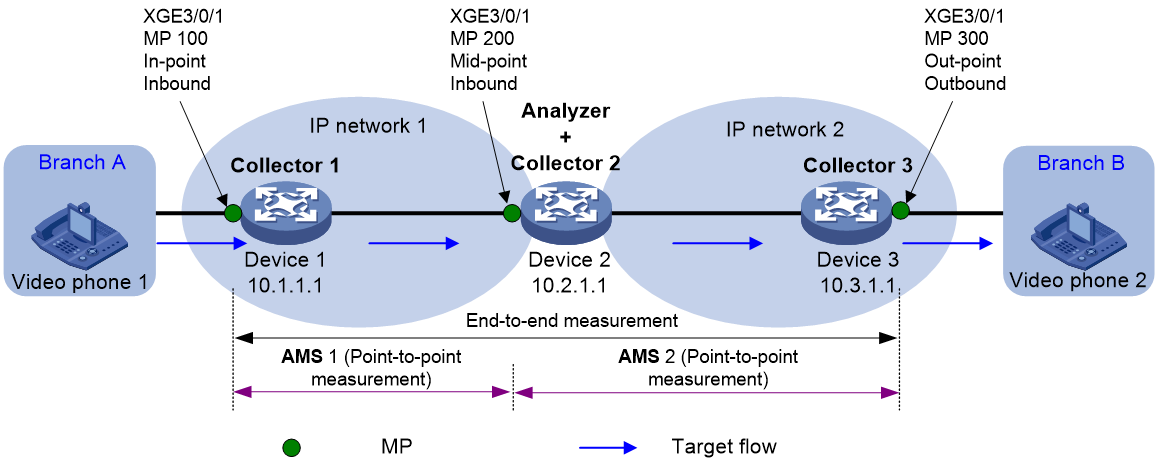

Point-to-point packet loss measurement
This measurement is based on atomic measurement spans (AMSs), which define smaller ranges than the end-to-end measurement. This method is helpful if you want to find out between which specific devices the packet loss occurs.
As shown in Figure 8, to configure point-to-point measurement, define AMSs, specify the flow direction in each AMS, and configure the ingress MP group and egress MP group for each AMS.
Figure 8 Point-to-point packet loss measurement

Example: Configuring an end-to-end iNQA packet loss measurement
As shown in Figure 10, Video phone 1 sends a video data flow to Video phone 2 through an IP network. The Video phone 2 is experiencing an erratic video display problem.
·     Enable the collector functionality on Device 1 and Device 2 and enable the analyzer functionality on Device 2.
·     Define the flow from Device 1 to Device 2 as the forward flow.
·     Set the packet loss upper limit and packet loss lower limit to 6% and 4%, respectively.
Figure 10 Network diagram
1.     Assign 10.1.1.1 and 10.2.1.1 to Collector 1 and Collector 2, respectively.
2.     Configure OSPF in the IP network to make Collector 1 and the analyzer can reach each other. (Details not shown.)
3.     Configure NTP or PTP on Collector 1 and Collector 2 for clock synchronization. (Details not shown.)
1.     Configure Collector 1:
# Specify 10.1.1.1 as the collector ID.
<Collector1> system-view
[Collector1] inqa collector
[Collector1-inqa-collector] collector id 10.1.1.1
# Bind the collector to the analyzer with ID 10.2.1.1.
[Collector1-inqa-collector] analyzer 10.2.1.1
# Specify ToS field bit 6 as the flag bit.
[Collector1-inqa-collector] flag loss-measure tos-bit 6
# Configure collector instance 1 to monitor the bidirectional flows entering the network from Ten-GigabitEthernet3/0/1 between 10.1.1.0 and 10.2.1.0.
[Collector1-inqa-collector] instance 1
[Collector1-inqa-collector-instance-1] flow bidirection source-ip 10.1.1.0 24 destination-ip 10.2.1.0 24
[Collector1-inqa-collector-instance-1] mp 100 in-point port-direction inbound
[Collector1-inqa-collector-instance-1] quit
[Collector1-inqa-collector] quit
[Collector1] interface ten-gigabitethernet 3/0/1
[Collector1-Ten-GigabitEthernet3/0/1] inqa mp 100
[Collector1-Ten-GigabitEthernet3/0/1] quit
# Enable continual packet loss measurement.
[Collector1-inqa-collector-instance-1] loss-measure enable continual
2.     Configure Collector 2 and the analyzer:
# Specify 10.2.1.1 as the collector ID.
<AnalyzerColl2> system-view
[AnalyzerColl2] inqa collector
[AnalyzerColl2-inqa-collector] collector id 10.2.1.1
[AnalyzerColl2-inqa-collector] analyzer 10.2.1.1
[AnalyzerColl2-inqa-collector] flag loss-measure tos-bit 6
[AnalyzerColl2-inqa-collector] instance 1
[AnalyzerColl2-inqa-collector-instance-1] flow bidirection source-ip 10.1.1.0 24 destination-ip 10.2.1.0 24
[AnalyzerColl2-inqa-collector-instance-1] mp 200 out-point port-direction outbound
[AnalyzerColl2-inqa-collector-instance-1] quit
[AnalyzerColl2-inqa-collector] quit
[AnalyzerColl2] interface ten-gigabitethernet 3/0/1
[AnalyzerColl2-Ten-GigabitEthernet3/0/1] inqa mp 200
[AnalyzerColl2-Ten-GigabitEthernet3/0/1] quit
[AnalyzerColl2-inqa-collector-instance-1] loss-measure enable continual
# Specify 10.2.1.1 as the analyzer ID.
[AnalyzerColl2] inqa analyzer
[AnalyzerColl2-inqa-analyzer] analyzer id 10.2.1.1
# Bind analyzer instance 1 to Collector 1 and Collector 2.
[AnalyzerColl2-inqa-analyzer] instance 1
[AnalyzerColl2-inqa-analyzer-instance-1] collector 10.1.1.1
[AnalyzerColl2-inqa-analyzer-instance-1] collector 10.2.1.1
# Set the packet loss upper limit and lower limit to 6% and 4%, respectively.
[AnalyzerColl2-inqa-analyzer-instance-1] loss-measure alarm upper-limit 6 lower-limit 4
# Enable the measurement functionality of analyzer instance 1.
[AnalyzerColl2-inqa-analyzer-instance-1] measure enable
[AnalyzerColl2-inqa-analyzer-instance-1] quit
[AnalyzerColl2-inqa-analyzer] quit
1.     On Collector 1:

Example: Configuring an point-to-point iNQA packet loss measurement
As shown in Figure 11, Video phone 1 sends a video data flow to Video phone 2 through an IP network. The Video phone 2 is experiencing an erratic video display problem.
·     Enable the collector functionality on Device 1, Device 2, and Device 3, and enable the analyzer functionality on Device 2.
·     Define the flow from Device 1 to Device 3 as the forward flow.
·     Run the packet loss measurement for 15 minutes.
Figure 11 Network diagram
1.     Assign 10.1.1.1, 10.2.1.1, and 10.3.1.1 to Collector 1, Collector 2, and Collector 3, respectively.
2.     Configure OSPF in the IP network to make sure the analyzer Collector 1, Collector 3, and the analyzer can reach each other. (Details not shown.)
3.     Configure NTP or PTP on Collector 1, Collector 2, and Collector 3 for clock synchronization. (Details not shown.)
# Configure collector instance 1 to monitor the forward flow entering the network at Ten-GigabitEthernet3/0/1 from 10.1.1.0 and 10.3.1.0.
[Collector1-inqa-collector-instance-1] flow forward source-ip 10.1.1.0 24 destination-ip 10.3.1.0 24
# Run the packet loss measurement for 15 minutes for collector instance 1.
[Collector1-inqa-collector-instance-1] loss-measure enable duration 15
[AnalyzerColl2-inqa-collector-instance-1] flow forward source-ip 10.1.1.0 24 destination-ip 10.3.1.0 24
[AnalyzerColl2-inqa-collector-instance-1] mp 200 mid-point port-direction inbound
[AnalyzerColl2-inqa-collector-instance-1] loss-measure enable mid-point duration 15
# Bind analyzer instance 1 to Collector 1, Collector 2, and Collector 3.
[AnalyzerColl2-inqa-analyzer-instance-1] collector 10.3.1.1
# Configure AMS 1 to measure the packet loss rate for the forward flow from MP 100 to MP 200.
[AnalyzerColl2-inqa-analyzer-instance-1] ams 1
[AnalyzerColl2-inqa-analyzer-instance-1-ams-1] flow forward
[AnalyzerColl2-inqa-analyzer-instance-1-ams-1] in-group collector 10.1.1.1 mp 100
[AnalyzerColl2-inqa-analyzer-instance-1-ams-1] out-group collector 10.2.1.1 mp 200
[AnalyzerColl2-inqa-analyzer-instance-1-ams-1] quit
# Configure AMS 2 to measure the packet loss rate for the forward flow from MP 200 to MP 300.
[AnalyzerColl2-inqa-analyzer-instance-1] ams 2
[AnalyzerColl2-inqa-analyzer-instance-1-ams-2] flow forward
[AnalyzerColl2-inqa-analyzer-instance-1-ams-2] in-group collector 10.2.1.1 mp 200
[AnalyzerColl2-inqa-analyzer-instance-1-ams-2] out-group collector 10.3.1.1 mp 300
[AnalyzerColl2-inqa-analyzer-instance-1-ams-2] quit
3.     Configure Collector 3:
# Specify 10.3.1.1 as the collector ID.
<Collector3> system-view
[Collector3] inqa collector
[Collector3-inqa-collector] collector id 10.3.1.1
[Collector3-inqa-collector] analyzer 10.2.1.1
[Collector3-inqa-collector] flag loss-measure tos-bit 6
[Collector3-inqa-collector] instance 1
[Collector3-inqa-collector-instance-1] flow forward source-ip 10.1.1.0 24 destination-ip 10.3.1.0 24
[Collector3-inqa-collector-instance-1] mp 300 out-point port-direction outbound
[Collector3-inqa-collector-instance-1] quit
[Collector3-inqa-collector] quit
[Collector3] interface ten-gigabitethernet 3/0/1
[Collector3-Ten-GigabitEthernet3/0/1] inqa mp 300
[Collector3-Ten-GigabitEthernet3/0/1] quit
[Collector3-inqa-collector-instance-1] loss-measure enable duration 15
1.     On Collector 1:
# Display the collector configuration.
[Collector1] display inqa collector
Collector ID             : 10.1.1.1
Loss-measure flag        : 6
Analyzer ID              : 10.2.1.1
Analyzer UDP-port        : 53312
VPN-instance-name        : --
Current instance count   : 1
# Display the configuration of collector instance 1.
[Collector1] display inqa collector instance 1
Instance ID              : 1
Status                   : Enabled
Duration                 : 15 min (Non mid-point)
Remaining time           : 14 min 52 sec
Description              : --
Analyzer ID              : --
Analyzer UDP-port        : --
Interval                 : 10 sec
Flow configuration:
MP configuration:
  mp 100 in-point inbound, XGE3/0/1
2.     On Collector 2 and the analyzer:
[AnalyzerColl2] display inqa collector
Collector ID             : 10.2.1.1
[AnalyzerColl2] display inqa collector instance 1
Instance ID              : 1
Status                   : Enabled
Duration                 : 15 min (Mid-point)
Remaining time           : 14 min 50 sec
Description              : --
Analyzer ID              : --
Interval                 : 10 sec
Flow configuration:
MP configuration:
  mp 200 mid-point inbound, XGE3/0/1
# Display analyzer configuration.
[AnalyzerColl2] display inqa analyzer
Protocol UDP-port        : 53312
# Display the configuration of analyzer instance 1.
[AnalyzerColl2] display inqa analyzer instance 1
Instance ID              : 1
Status                   : Enabled
Description              : --
Alarm upper-limit        : 6.000000%
Alarm lower-limit        : 4.000000%
Current AMS count        : 2
Collectors               : 10.1.1.1
                           10.2.1.1
                           10.3.1.1
# Display the configuration of all AMSs in analyzer instance 1.
[AnalyzerColl2] display inqa analyzer instance 1 ams all
AMS ID                   : 1
Flow direction           : forward
In-group                 : collector 10.1.1.1 mp 100
Out-group                : collector 10.2.1.1 mp 200
AMS ID                   : 2
In-group                 : collector 10.2.1.1 mp 200
Out-group                : collector 10.3.1.1 mp 300
# Display iNQA packet loss statistics of analyzer instance 1.
[AnalyzerColl2] display inqa statistics loss instance 1 ams 1
Latest packet loss statistics for forward flow:
 Period     LostPkts             PktLoss%     LostBytes            ByteLoss%
 19122483   15                   15.000000%   1500                 15.000000%
 19122482   15                   15.000000%   1500                 15.000000%
 19122481   15                   15.000000%   1500                 15.000000%
 19122480   15                   15.000000%   1500                 15.000000%
 19122479   15                   15.000000%   1500                 15.000000%
 19122478   15                   15.000000%   1500                 15.000000%
3.     On Collector 3:
[Collector3] display inqa collector
Collector ID             : 10.3.1.1
[Collector3] display inqa collector instance 1
Instance ID              : 1
Status                   : Enabled
Remaining time           : 14 min 51 sec
Description              : --
Analyzer ID              : --
Interval                 : 10 sec
Flow configuration:
MP configuration:
  mp 300 out-point outbound, XGE3/0/1
