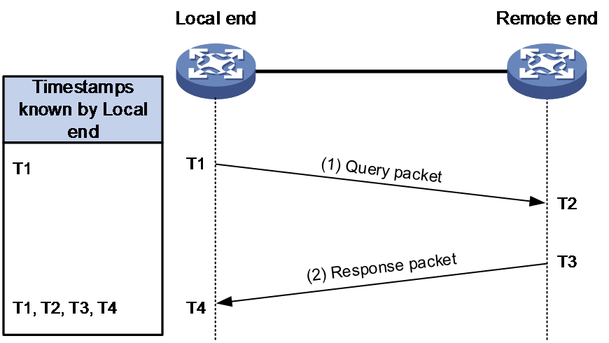

As shown in Figure 1, SRPM has the following roles:
·     Local end—Responsible for starting SRPM measurement, periodically sending SRPM query packets to the remote end, and calculating the measurement result.
·     Remote end—Responsible for replying to the SRPM query packets with SRPM response packets.
Figure 1 Two-way SRPM delay measurement
SRPM uses the following process to implement two-way delay measurement:
1.     The local end sends an SRPM query packet to the remote end. The query packet contains timestamp T1 (time when the query packet was sent).
2.     When the remote end receives the query packet, it records the receiving time as T2. Then, the remote end replies to the local end with an SRPM response packet at time T3. The response packet contains timestamp T1, T2, and T3.
3.     When the local end receives the response packet, it records the receiving time as T4. Then, the local end uses the following formula to calculate the two-way delay: two-way delay = (T2 - T1) + (T4 - T3).
IMPORTANT
IMPORTANT:
The local end can calculate jitter values after it obtains two or more two-way delay values. A jitter value is the absolute value for the difference between the delay values measured in two consecutive rounds.

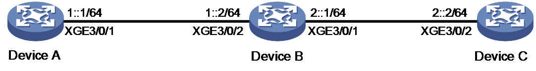

Example: Configuring link-based SRPM delay measurement
As shown in Figure 2, the devices are in an SRv6 network. Use SRPM to measure two-way delay for the links between Device A and Device B and between Device B and Device C. Device B is the remote end to Device A and Device C is the remote end to Device B.
Figure 2 Network diagram
The delay measurement configuration is the same in an SRv6 network and an SR-MPLS network except for the following settings:
·     In an SRv6 network, you must use the srpm destination command to specify a destination IP address for SRPM packets. This configuration is not required in an SR-MPLS network.
·     In an SRv6 network, set the encapsulation method to UDPv6 for SRPM packets. In an SR-MPLS network, set the encapsulation method to MPLS for SRPM packets.

[DeviceB-srpm] quit
# On interface Ten-GigabitEthernet 3/0/2, enable link-based SRPM delay measurement response and associate the interface with profile test1.
[DeviceB] interface ten-gigabitethernet 3/0/2
[DeviceB-Ten-GigabitEthernet3/0/2] srpm delay-profile link-based test1 response enable
[DeviceB-Ten-GigabitEthernet3/0/2] quit
# On interface Ten-GigabitEthernet 3/0/1, specify the IP address of Ten-GigabitEthernet 3/0/2 on Device C as the destination IP address of SRPM packets.
[DeviceB] interface ten-gigabitethernet 3/0/1
[DeviceB-Ten-GigabitEthernet3/0/1] srpm destination ipv6 2::2
# Enable link-based SRPM delay measurement query and associate delay profile test1 with the interface.
[DeviceB-Ten-GigabitEthernet3/0/1] srpm delay-profile link-based test1 query enable
[DeviceB-Ten-GigabitEthernet3/0/1] quit
3.     Configure Device C:
# Enable SRPM and enter SRPM view.
<DeviceC> system-view
[DeviceC] srpm
# Create a link-based delay profile named test1, set the encapsulation method to UDPv6 for SRPM packets, and activate the profile.
[DeviceC-srpm] delay-profile link-based test1
[DeviceC-srpm-delay-profile-link-based-test1] protocol udpv6
[DeviceC-srpm-delay-profile-link-based-test1] activate profile
[DeviceC-srpm-delay-profile-link-based-test1] quit
[DeviceC-srpm] quit
# On interface Ten-GigabitEthernet 3/0/2, enable link-based SRPM delay measurement response and associate delay profile test1 with the interface.
[DeviceC] interface ten-gigabitethernet 3/0/2
[DeviceC-Ten-GigabitEthernet3/0/2] srpm delay-profile link-based test1 response enable
[DeviceC-Ten-GigabitEthernet3/0/2] quit
1.     Display two-way delay between Device A and Device B.
On Device A, display the most recent five SRPM delay measurement statistics on interface Ten-GigabitEthernet 3/0/1.
[DeviceA] display srpm delay-statistics interface ten-gigabitethernet 3/0/1
Latest two-way delay statistics (us) for Ten-GigabitEthernet3/0/1:
Index          Delay                Jitter
11             9                    -
12             7                    2
13             11                   4
14             10                   1
15             8                    2
Average delay: 9                    Average jitter: 2
Maximum delay: 11                   Maximum jitter: 4
Minimum delay: 7                    Minimum jitter: 1
2.     Display two-way delay between Device B and Device C.
On Device B, display the most recent five SRPM delay measurement statistics on interface Ten-GigabitEthernet 3/0/1.
[DeviceB] display srpm delay-statistics interface ten-gigabitethernet 3/0/1
