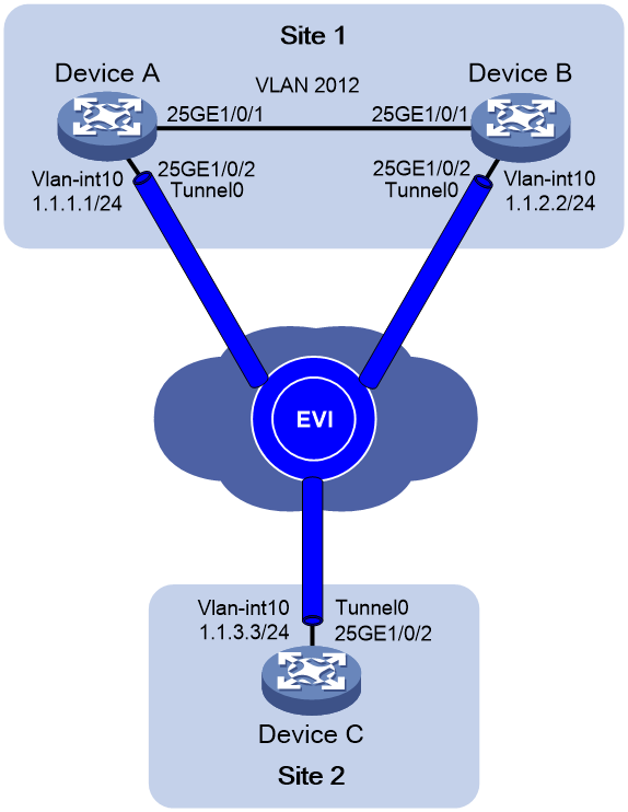

Example: Configuring EVI IS-IS-Track-BFD collaboration
As shown in Figure 9:
·     Use EVI to extend VLANs 21 through 100 across site 1, site 2, and site 3 over an IPv4 network.
·     Deploy Switch A and Switch B to connect site 1 to the EVI network for redundancy. Use VLAN 2012 as the designated site VLAN.
·     Use network ID 1 to identify the EVI network.
·     Use Switch B as an ENDS and all other edge switches as ENDCs for neighbor discovery.
·     Configure a track entry on Switch A and Switch B to monitor their respective EVI links to site 1 for quick failover.
Figure 9 Network diagram
1.     Configure routes for the sites to reach each other. (Details not shown.)
2.     Configure Switch A:
# Configure the site ID.
<SwitchA> system-view
[SwitchA] evi site-id 1
# Create VLAN 10, and assign the transport-facing physical interface Twenty-FiveGigE 1/0/2 to the VLAN.
[SwitchA] vlan 10
[SwitchA-vlan10] port twenty-fivegige 1/0/2
[SwitchA-vlan10] quit
# Create VLAN-interface 10, and assign an IP address to it.
[SwitchA-Vlan-interface10] ip address 1.1.1.1 24
[SwitchA-Vlan-interface10] quit
# Create an IPv4 EVI tunnel interface.
[SwitchA] interface tunnel 0 mode evi
# Specify the IP address of VLAN-interface 10 as the source IP of the EVI tunnel.
[SwitchA-Tunnel0] source 1.1.1.1
# Set the network ID to 1 for the EVI tunnel interface.
[SwitchA-Tunnel0] evi network-id 1
# Specify extended VLANs on the EVI tunnel interface.
[SwitchA-Tunnel0] evi extend-vlan 21 to 100
# Configure Switch A as an ENDC of Switch B.
[SwitchA-Tunnel0] evi neighbor-discovery client enable 1.1.2.2
[SwitchA-Tunnel0] quit
# Associate track entry 1 with BFD to monitor the link between Switch A and Switch C.
[SwitchA] bfd echo-source-ip 8.8.8.81
[SwitchA] track 1 bfd echo interface vlan-interface 10 remote ip 1.1.3.3 local ip 1.1.1.1
# Associate the EVI tunnel interface with track entry 1.
[SwitchA-Tunnel0] evi isis track 1
# Configure VLAN 2012 as the designated EVI IS-IS site VLAN, and assign Twenty-FiveGigE 1/0/1 to the VLAN.
[SwitchA] vlan 2012
[SwitchA-vlan2012] port twenty-fivegige 1/0/1
[SwitchA-vlan2012] quit
[SwitchA] evi designated-vlan 2012
# Enable EVI on the transport-facing port Twenty-FiveGigE 1/0/2.
[SwitchA] interface twenty-fivegige 1/0/2
[SwitchA-Twenty-FiveGigE1/0/2] evi enable
[SwitchA-Twenty-FiveGigE1/0/2] quit
3.     Configure Switch B:
<SwitchB> system-view
[SwitchB] evi site-id 1
# Create VLAN 10, and assign the transport-facing physical interface Twenty-FiveGigE 1/0/2 to VLAN 10.
[SwitchB] vlan 10
[SwitchB-vlan10] port twenty-fivegige 1/0/2
[SwitchB-vlan10] quit
[SwitchB] interface vlan-interface 10
[SwitchB-Vlan-interface10] ip address 1.1.2.2 24
[SwitchB-Vlan-interface10] quit
[SwitchB] interface tunnel 0 mode evi
[SwitchB-Tunnel0] source 1.1.2.2
[SwitchB-Tunnel0] evi network-id 1
[SwitchB-Tunnel0] evi extend-vlan 21 to 100
# Configure Switch B as an ENDS on the EVI tunnel interface.
[SwitchB-Tunnel0] evi neighbor-discovery server enable
# Set a DED priority of 100 on the EVI tunnel interface.
[SwitchB-Tunnel0] evi isis ded-priority 100
[SwitchB-Tunnel0] quit
# Associate track entry 1 with BFD to monitor the link between Switch B and Switch C.
[SwitchB] bfd echo-source-ip 8.8.8.82
[SwitchB] track 1 bfd echo interface vlan-interface 10 remote ip 1.1.3.3 local ip 1.1.2.2
[SwitchB-Tunnel0] evi isis track 1
[SwitchB] vlan 2012
[SwitchB-vlan2012] port twenty-fivegige 1/0/1
[SwitchB-vlan2012] quit
[SwitchB] evi designated-vlan 2012
[SwitchB] interface twenty-fivegige 1/0/2
[SwitchB-Twenty-FiveGigE1/0/2] evi enable
[SwitchB-Twenty-FiveGigE1/0/2] quit
4.     Configure Switch C:
<SwitchC> system-view
[SwitchC] evi site-id 2
[SwitchC] vlan 10
[SwitchC-vlan10] port twenty-fivegige 1/0/2
[SwitchC-vlan10] quit
[SwitchC] interface vlan-interface 10
[SwitchC-Vlan-interface10] ip address 1.1.3.3 24
[SwitchC-Vlan-interface10] quit
[SwitchC] interface tunnel 0 mode evi
[SwitchC-Tunnel0] source 1.1.3.3
[SwitchC-Tunnel0] evi network-id 1
[SwitchC-Tunnel0] evi extend-vlan 21 to 100
# Configure Switch C as an ENDC of Switch B.
[SwitchC-Tunnel0] evi neighbor-discovery client enable 1.1.2.2
[SwitchC-Tunnel0] quit
[SwitchC] interface twenty-fivegige 1/0/2
[SwitchC-Twenty-FiveGigE1/0/2] evi enable
[SwitchC-Twenty-FiveGigE1/0/2] quit
1.     Verify the configuration on Switch A:
# Display neighbor entries that Switch A has learned.
[SwitchA] display evi neighbor-discovery client member
Interface: Tunnel0    Network ID: 1
Local Address: 1.1.1.1
Server Address: 1.1.2.2
Neighbor        System ID         Created Time           Expire    Status
1.1.2.2         c4ca-d94d-1385    2013/01/06 09:40:26    64        Up
1.1.3.3         c4ca-d94d-138d    2013/01/06 09:40:26    64        Up
# Display information about EVI-Link interfaces.
[SwitchA] display evi link interface tunnel 0
Interface     Status Source          Destination
EVI-Link0     UP     1.1.1.1         1.1.2.2
EVI-Link1     UP     1.1.1.1         1.1.3.3
# Display BFD session information.
[SwitchA] display bfd session
 Total Session Num: 1     Up Session Num: 1     Init Mode: Active
 IPv4 Session Working Under Echo Mode:
 LD             SourceAddr      DestAddr        State    Holdtime    Interface
 1025           1.1.1.1         1.1.3.3         Up       2331ms      Vlan10
The output shows that the BFD session on Switch A is up. This state indicates that the EVI link from Switch A to Switch C is operating correctly.
# Display EVI IS-IS information for the EVI tunnel interface. Check the DED field and the LAV field to verify the DED role and active extended VLANs on Switch A. Check the AEF field to verify the qualification of Switch A as an appointed edge forwarder.
[SwitchA] display evi isis tunnel 0
Tunnel0
MTU: 1400
DED: No
DED priority: 64
Hello timer: 10s
Hello multiplier: 3
CSNP timer: 10s
LSP timer: 100ms
LSP transmit-throttle count: 5
AEF: Yes
EVI-Link0    DED: Yes
EVI-Link1    DED: No
LAV:
  61-100
The output shows that Switch A is not elected the DED for site 1 because of its low DED priority. Switch A can be an appointed edge forwarder for extended VLANs. VLAN 61 to VLAN 100 are active on Switch A.
 1025           1.1.2.2         1.1.3.3         Up       2055ms      Vlan10
The output shows that the BFD session on Switch B is up. This state indicates that the EVI link from Switch B to Switch C is operating correctly.
# Display EVI IS-IS information for the EVI tunnel interface. Check the DED field and the LAV field to verify the DED role and active extended VLANs on Switch B. Check the AEF field to verify the qualification of Switch B as an appointed edge forwarder.
[SwitchB] display evi isis tunnel 0
Tunnel0
MTU: 1400
DED: Yes
DED priority: 100
Hello timer: 10s
Hello multiplier: 3
CSNP timer: 10s
LSP timer: 100ms
AEF: Yes
EVI-Link0    DED: Yes
EVI-Link1    DED: Yes
LAV:
  21-60
The output shows that Switch B is elected the DED for site 1 because of its high DED priority. Switch B can be an appointed edge forwarder for extended VLANs. VLAN 21 to VLAN 60 are active on Switch B.
3.     Verify the configuration on Switch C:
# Display neighbor entries that Switch C has learned.
[SwitchC] display evi neighbor-discovery client member
Local Address: 1.1.3.3
1.1.1.1         c4ca-d94d-1200    2013/01/06 09:40:29    64        Up
1.1.2.2         c4ca-d94d-1385    2013/01/06 09:40:29    64        Up
[SwitchC] display evi link interface tunnel 0
EVI-Link0     UP     1.1.3.3         1.1.1.1
EVI-Link1     UP     1.1.3.3         1.1.2.2
4.     Verify that hosts in different sites can ping one another in the same extended VLAN.
5.     Verify that a failover occurs immediately after BFD detects an EVI link failure on Switch B.
# Display BFD session information on Switch A.
 1025           1.1.1.1         1.1.3.3         Up       2330ms      Vlan10
The output shows that the BFD session on the EVI link between Switch A and Switch C is up. The EVI link on Switch A is operating correctly.
# Display BFD session information on Switch B.
[SwitchB] display bfd session
 Total Session Num: 1     Up Session Num: 0     Init Mode: Active
 1025           1.1.2.2         1.1.3.3         Down        /        Vlan10
The output shows that the BFD session on the EVI link between Switch B and Switch C is down. This state indicates that the EVI link has failed.
# On Switch A, verify that all active VLANs on Switch B have been moved to Switch A after the EVI link on Switch B fails.
Tunnel0
MTU: 1400
DED: No
DED priority: 64
Hello timer: 10s
Hello multiplier: 3
CSNP timer: 10s
LSP timer: 100ms
AEF: Yes
EVI-Link0    DED: Yes
EVI-Link1    DED: No
LAV:
  21-100
# Verify that the appointed edge forwarder role of Switch B has been removed because it is down, and the switch does not have any active VLANs.
Tunnel0
MTU: 1400
DED: Yes
DED priority: 100
Hello timer: 10s
Hello multiplier: 3
CSNP timer: 10s
LSP timer: 100ms
AEF: No
EVI-Link0    DED: Yes
LAV:
  None
