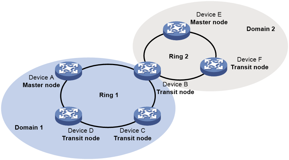

Figure 1 shows a typical RRPP network with two Ethernet rings and multiple nodes. RRPP detects ring status and sends topology change information by exchanging Rapid Ring Protection Protocol Data Units (RRPPDUs) among the nodes.
Figure 1 RRPP networking diagram

As shown in Figure 1, Domain 1 is an RRPP domain, containing two RRPP rings: Ring 1 and Ring 2. All the nodes on the two RRPP rings belong to the RRPP domain.

As shown in Figure 1, Ring 1 is the primary ring and Ring 2 is a subring. Device A is the master node of Ring 1. Device B, Device C, and Device D are the transit nodes of Ring 1. Device E is the master node of Ring 2, Device B is the edge node of Ring 2, and Device C is the assistant edge node of Ring 2.

As shown in Figure 1, Device A is the master node of Ring 1. Port 1 and Port 2 are the primary port and the secondary port of the master node on Ring 1, respectively. Device B, Device C, and Device D are the transit nodes of Ring 1. Their Port 1 and Port 2 are the primary port and the secondary port on Ring 1, respectively.

As shown in Figure 1, Device B and Device C reside on Ring 1 and Ring 2. Device B's Port 1 and Port 2 and Device C's Port 1 and Port 2 access the primary ring, so they are common ports. Device B's Port 3 and Device C's Port 3 access only the subring, so they are edge ports.

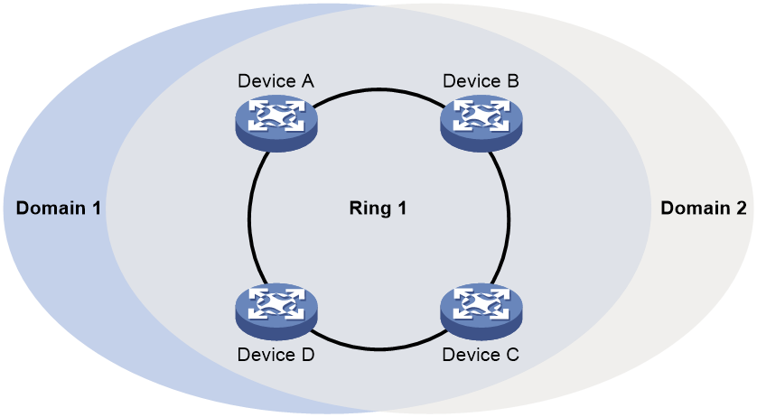

In a ring network, traffic from multiple VLANs might be transmitted at the same time. RRPP can implement load balancing by transmitting traffic from different VLANs along different paths.
You can configure multiple RRPP domains for a ring network. Each RRPP domain transmits the traffic from the specified VLANs (protected VLANs). Traffic from different VLANs can be transmitted according to different topologies in the ring network for load balancing.
As shown in Figure 6, Ring 1 is configured as the primary ring of Domain 1 and Domain 2, which are configured with different protected VLANs. Device A is the master node of Ring 1 in Domain 1. Device B is the master node of Ring 1 in Domain 2. With such configurations, traffic from different VLANs can be transmitted on different links for load balancing in the single-ring network.

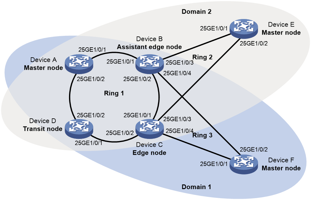

As shown in Figure 5, Ring 1 is the primary ring, and Ring 2 and Ring 3 are subrings. When the two SRPTs between the edge node and the assistant edge node are down, the master nodes of Ring 2 and Ring 3 will open their secondary ports. A loop is generated among Device B, Device C, Device E, and Device F, causing a broadcast storm.
To avoid generating a loop, the edge node will temporarily block the edge port. The blocked edge port is activated only when the edge node determines that no loop will be generated when the edge port is activated.

As shown in Figure 5, Device B is the edge node of Ring 2 and Ring 3. Device C is the assistant edge node of Ring 2 and Ring 3. Device B and Device C need to send or receive Edge-Hello packets frequently. If more subrings are configured or more domains are configured for load balancing, Device B and Device C will send or receive a large number of Edge-Hello packets.
To reduce Edge-Hello traffic, perform the following tasks:
·     Assign Ring 2 and Ring 3 to an RRPP ring group configured on the edge node Device B.
·     Assign Ring 2 and Ring 3 to an RRPP ring group configured on the assistant edge node Device C.
If all rings are activated, only Ring 2 on Device B sends Edge-Hello packets.

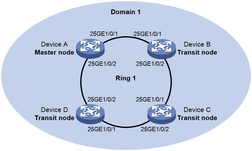

Single ring
As shown in Figure 2, only a single ring exists in the network topology. You need only define an RRPP domain.
Figure 2 Schematic diagram for a single-ring network

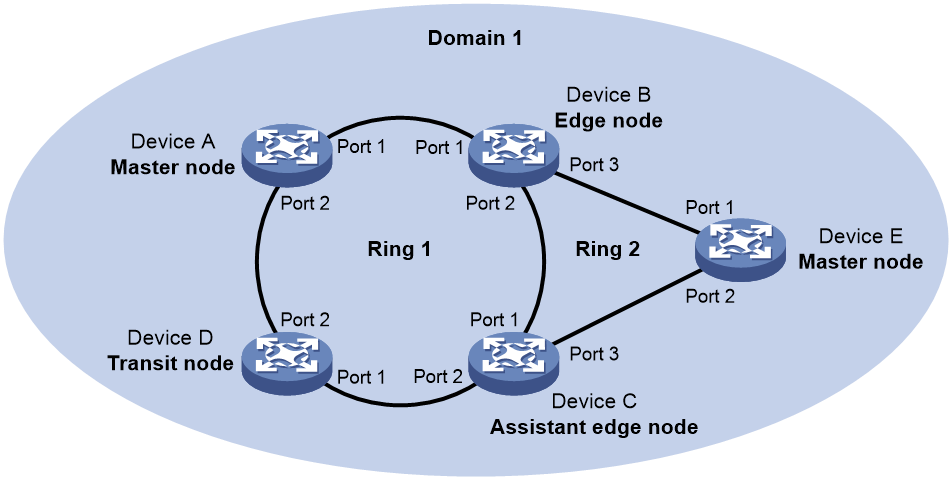

As shown in Figure 4, two or more rings exist in the network topology and two common nodes exist between rings. You need only define an RRPP domain and configure one ring as the primary ring and the other rings as subrings.
Figure 4 Schematic diagram for an intersecting-ring network

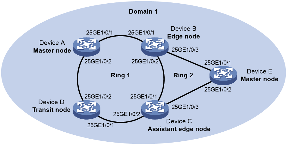

Dual-homed rings
As shown in Figure 5, two or more rings exist in the network topology and two similar common nodes exist between rings. You need only define an RRPP domain and configure one ring as the primary ring and the other rings as subrings.
Figure 5 Schematic diagram for a dual-homed-ring network

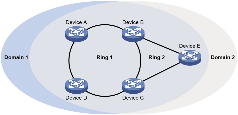

Intersecting-ring load balancing
In an intersecting-ring network, you can also achieve load balancing by configuring multiple domains.
As shown in Figure 7:
·     Ring 1 is the primary ring and Ring 2 is the subring in both Domain 1 and Domain 2.
·     Domain 1 and Domain 2 are configured with different protected VLANs.
·     Device A is configured as the master node of Ring 1 in Domain 1.
·     Device D is configured as the master node of Ring 1 in Domain 2.
·     Device E is configured as the master node of Ring 2 in both Domain 1 and Domain 2. However, different ports on Device E are blocked in Domain 1 and Domain 2.
Traffic from different VLANs can travel over different paths in the subring and primary ring.
Figure 7 Schematic diagram for an intersecting-ring load balancing network

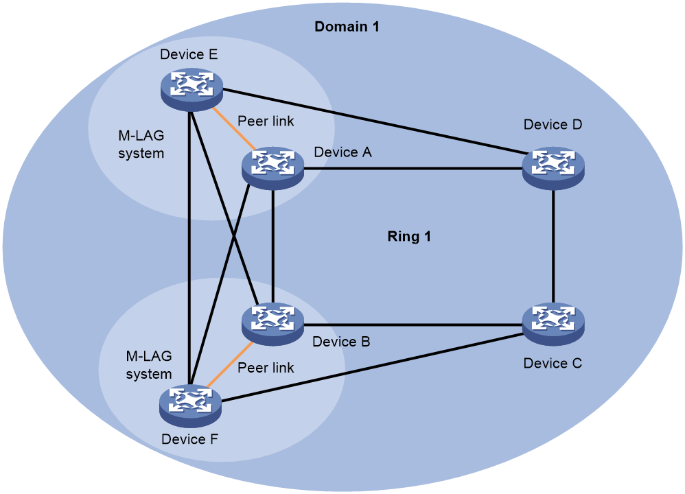

RRPP with M-LAG
M-LAG allows you to virtualize the devices in an RRPP ring into one system through multichassis link, thereby achieving device-level redundancy and load balancing.
As shown in Figure 8, the M-LAG system composed of Device A and Device E is the master node of Ring 1, and the M-LAG system composed of Device B and Device F is the transit node of Ring 1. For more information about M-LAG, see Layer 2—LAN Switching Configuration Guide.
Figure 8 RRPP with M-LAG

Example: Configuring a single ring
As shown in Figure 9:
·     Device A, Device B, Device C, and Device D form RRPP domain 1. Specify the primary control VLAN of RRPP domain 1 as VLAN 4092. Specify the protected VLANs of RRPP domain 1 as VLANs 1 through 30.
·     Device A, Device B, Device C, and Device D form primary ring 1.
·     Specify Device A as the master node of primary ring 1, Twenty-FiveGigE 1/0/1 as the primary port, and Twenty-FiveGigE 1/0/2 as the secondary port.
·     Specify Device B, Device C, and Device D as the transit nodes of primary ring 1. Specify Twenty-FiveGigE 1/0/1 as the primary port and Twenty-FiveGigE 1/0/2 as the secondary port on Device B, Device C, and Device D.
Figure 9 Network diagram
1.     Configure Device A:
# Create VLANs 1 through 30.
<DeviceA> system-view
[DeviceA] vlan 1 to 30
# Map these VLANs to MSTI 1.
[DeviceA] stp region-configuration
[DeviceA-mst-region] instance 1 vlan 1 to 30
# Activate the MST region configuration.
[DeviceA-mst-region] active region-configuration
[DeviceA-mst-region] quit
# Set the physical state change suppression interval to 0 seconds on Twenty-FiveGigE 1/0/1.
[DeviceA] interface twenty-fivegige 1/0/1
[DeviceA-Twenty-FiveGigE1/0/1] link-delay up 0
[DeviceA-Twenty-FiveGigE1/0/1] link-delay down 0
# Disable the spanning tree feature on the port.
[DeviceA-Twenty-FiveGigE1/0/1] undo stp enable
# Configure the port as a trunk port.
[DeviceA-Twenty-FiveGigE1/0/1] port link-type trunk
# Assign the port to VLANs 1 through 30.
[DeviceA-Twenty-FiveGigE1/0/1] port trunk permit vlan 1 to 30
[DeviceA-Twenty-FiveGigE1/0/1] quit
# Configure Twenty-FiveGigE 1/0/2 in the same way Twenty-FiveGigE 1/0/1 is configured.
[DeviceA] interface twenty-fivegige 1/0/2
[DeviceA-Twenty-FiveGigE1/0/2] link-delay up 0
[DeviceA-Twenty-FiveGigE1/0/2] link-delay down 0
[DeviceA-Twenty-FiveGigE1/0/2] undo stp enable
[DeviceA-Twenty-FiveGigE1/0/2] port link-type trunk
[DeviceA-Twenty-FiveGigE1/0/2] port trunk permit vlan 1 to 30
[DeviceA-Twenty-FiveGigE1/0/2] quit
# Create RRPP domain 1.
[DeviceA] rrpp domain 1
# Configure VLAN 4092 as the primary control VLAN of RRPP domain 1.
[DeviceA-rrpp-domain1] control-vlan 4092
# Configure the VLANs mapped to MSTI 1 as the protected VLANs of RRPP domain 1.
[DeviceA-rrpp-domain1] protected-vlan reference-instance 1
# Configure Device A as the master node of primary ring 1, with Twenty-FiveGigE 1/0/1 as the primary port and Twenty-FiveGigE 1/0/2 as the secondary port. Enable ring 1.
[DeviceA-rrpp-domain1] ring 1 node-mode master primary-port twenty-fivegige 1/0/1 secondary-port twenty-fivegige 1/0/2 level 0
[DeviceA-rrpp-domain1] ring 1 enable
[DeviceA-rrpp-domain1] quit
# Enable RRPP.
[DeviceA] rrpp enable
2.     Configure Device B:
<DeviceB> system-view
[DeviceB] vlan 1 to 30
[DeviceB] stp region-configuration
[DeviceB-mst-region] instance 1 vlan 1 to 30
[DeviceB-mst-region] active region-configuration
[DeviceB-mst-region] quit
[DeviceB] interface twenty-fivegige 1/0/1
[DeviceB-Twenty-FiveGigE1/0/1] link-delay up 0
[DeviceB-Twenty-FiveGigE1/0/1] link-delay down 0
[DeviceB-Twenty-FiveGigE1/0/1] undo stp enable
[DeviceB-Twenty-FiveGigE1/0/1] port link-type trunk
[DeviceB-Twenty-FiveGigE1/0/1] port trunk permit vlan 1 to 30
[DeviceB-Twenty-FiveGigE1/0/1] quit
[DeviceB] interface twenty-fivegige 1/0/2
[DeviceB-Twenty-FiveGigE1/0/2] link-delay up 0
[DeviceB-Twenty-FiveGigE1/0/2] link-delay down 0
[DeviceB-Twenty-FiveGigE1/0/2] undo stp enable
[DeviceB-Twenty-FiveGigE1/0/2] port link-type trunk
[DeviceB-Twenty-FiveGigE1/0/2] port trunk permit vlan 1 to 30
[DeviceB-Twenty-FiveGigE1/0/2] quit
[DeviceB] rrpp domain 1
[DeviceB-rrpp-domain1] control-vlan 4092
[DeviceB-rrpp-domain1] protected-vlan reference-instance 1
# Configure Device B as the transit node of primary ring 1, with Twenty-FiveGigE 1/0/1 as the primary port and Twenty-FiveGigE 1/0/2 as the secondary port. Enable ring 1.
[DeviceB-rrpp-domain1] ring 1 node-mode transit primary-port twenty-fivegige 1/0/1 secondary-port twenty-fivegige 1/0/2 level 0
[DeviceB-rrpp-domain1] ring 1 enable
[DeviceB-rrpp-domain1] quit
# Enable RRPP.
[DeviceB] rrpp enable
3.     Configure Device C:
Configure Device C in the same way Device B is configured.
4.     Configure Device D:
Configure Device D in the same way Device B is configured.
# Use the display commands to view RRPP configuration and operational information on each device.
Example: Configuring intersecting rings
As shown in Figure 10:
·     Device A, Device B, Device C, Device D, and Device E form RRPP domain 1. VLAN 4092 is the primary control VLAN of RRPP domain 1. RRPP domain 1 protects VLANs 1 through 30.
·     Device A, Device B, Device C, and Device D form primary ring 1. Device B, Device C, and Device E form subring 2.
·     Device A is the master node of primary ring 1, with Twenty-FiveGigE 1/0/1 as the primary port and Twenty-FiveGigE 1/0/2 the secondary port.
·     Device E is the master node of subring 2, with Twenty-FiveGigE 1/0/1 as the primary port and Twenty-FiveGigE 1/0/2 the secondary port.
·     Device B is the transit node of primary ring 1 and the edge node of subring 2, with Twenty-FiveGigE 1/0/3 as the edge port.
·     Device C is the transit node of primary ring 1 and the assistant edge node of subring 1, with Twenty-FiveGigE 1/0/3 as the edge port.
·     Device D is the transit node of primary ring 1, with Twenty-FiveGigE 1/0/1 as the primary port and Twenty-FiveGigE 1/0/2 the secondary port.
Figure 10 Network diagram
# Enable RRPP.
# Configure Twenty-FiveGigE 1/0/3 in the same way Twenty-FiveGigE 1/0/1 is configured.
[DeviceB] interface twenty-fivegige 1/0/3
[DeviceB-Twenty-FiveGigE1/0/3] link-delay up 0
[DeviceB-Twenty-FiveGigE1/0/3] link-delay down 0
 [DeviceB-Twenty-FiveGigE1/0/3] undo stp enable
[DeviceB-Twenty-FiveGigE1/0/3] port link-type trunk
[DeviceB-Twenty-FiveGigE1/0/3] port trunk permit vlan 1 to 30
[DeviceB-Twenty-FiveGigE1/0/3] quit
# Configure Device B as a transit node of primary ring 1, with Twenty-FiveGigE 1/0/1 as the primary port and Twenty-FiveGigE 1/0/2 as the secondary port. Enable ring 1.
# Configure Device B as the edge node of subring 2, with Twenty-FiveGigE 1/0/3 as the edge port. Enable ring 2.
[DeviceB-rrpp-domain1] ring 2 node-mode edge edge-port twenty-fivegige 1/0/3
[DeviceB-rrpp-domain1] ring 2 enable
# Enable RRPP.
<DeviceC> system-view
[DeviceC] vlan 1 to 30
[DeviceC] stp region-configuration
[DeviceC-mst-region] instance 1 vlan 1 to 30
[DeviceC-mst-region] active region-configuration
[DeviceC-mst-region] quit
[DeviceC] interface twenty-fivegige 1/0/1
[DeviceC-Twenty-FiveGigE1/0/1] link-delay up 0
[DeviceC-Twenty-FiveGigE1/0/1] link-delay down 0
[DeviceC-Twenty-FiveGigE1/0/1] undo stp enable
[DeviceC-Twenty-FiveGigE1/0/1] port link-type trunk
[DeviceC-Twenty-FiveGigE1/0/1] port trunk permit vlan 1 to 30
[DeviceC-Twenty-FiveGigE1/0/1] quit
[DeviceC] interface twenty-fivegige 1/0/2
[DeviceC-Twenty-FiveGigE1/0/2] link-delay up 0
[DeviceC-Twenty-FiveGigE1/0/2] link-delay down 0
[DeviceC-Twenty-FiveGigE1/0/2] undo stp enable
[DeviceC-Twenty-FiveGigE1/0/2] port link-type trunk
[DeviceC-Twenty-FiveGigE1/0/2] port trunk permit vlan 1 to 30
[DeviceC-Twenty-FiveGigE1/0/2] quit
[DeviceC] interface twenty-fivegige 1/0/3
[DeviceC-Twenty-FiveGigE1/0/3] link-delay up 0
[DeviceC-Twenty-FiveGigE1/0/3] link-delay down 0
[DeviceC-Twenty-FiveGigE1/0/3] undo stp enable
[DeviceC-Twenty-FiveGigE1/0/3] port link-type trunk
[DeviceC-Twenty-FiveGigE1/0/3] port trunk permit vlan 1 to 30
[DeviceC-Twenty-FiveGigE1/0/3] quit
[DeviceC] rrpp domain 1
[DeviceC-rrpp-domain1] control-vlan 4092
[DeviceC-rrpp-domain1] protected-vlan reference-instance 1
# Configure Device C as a transit node of primary ring 1, with Twenty-FiveGigE 1/0/1 as the primary port and Twenty-FiveGigE 1/0/2 as the secondary port. Enable ring 1.
[DeviceC-rrpp-domain1] ring 1 node-mode transit primary-port twenty-fivegige 1/0/1 secondary-port twenty-fivegige 1/0/2 level 0
[DeviceC-rrpp-domain1] ring 1 enable
# Configure Device C as the assistant edge node of subring 2, with Twenty-FiveGigE 1/0/3 as the edge port. Enable ring 2.
[DeviceC-rrpp-domain1] ring 2 node-mode assistant-edge edge-port twenty-fivegige 1/0/3
[DeviceC-rrpp-domain1] ring 2 enable
[DeviceC-rrpp-domain1] quit
# Enable RRPP.
[DeviceC] rrpp enable
<DeviceD> system-view
[DeviceD] vlan 1 to 30
[DeviceD] stp region-configuration
[DeviceD-mst-region] instance 1 vlan 1 to 30
[DeviceD-mst-region] active region-configuration
[DeviceD-mst-region] quit
[DeviceD] interface twenty-fivegige 1/0/1
[DeviceD-Twenty-FiveGigE1/0/1] link-delay up 0
[DeviceD-Twenty-FiveGigE1/0/1] link-delay down 0
[DeviceD-Twenty-FiveGigE1/0/1] undo stp enable
[DeviceD-Twenty-FiveGigE1/0/1] port link-type trunk
[DeviceD-Twenty-FiveGigE1/0/1] port trunk permit vlan 1 to 30
[DeviceD-Twenty-FiveGigE1/0/1] quit
[DeviceD] interface twenty-fivegige 1/0/2
[DeviceD-Twenty-FiveGigE1/0/2] link-delay up 0
[DeviceD-Twenty-FiveGigE1/0/2] link-delay down 0
[DeviceD-Twenty-FiveGigE1/0/2] undo stp enable
[DeviceD-Twenty-FiveGigE1/0/2] port link-type trunk
[DeviceD-Twenty-FiveGigE1/0/2] port trunk permit vlan 1 to 30
[DeviceD-Twenty-FiveGigE1/0/2] quit
[DeviceD] rrpp domain 1
[DeviceD-rrpp-domain1] control-vlan 4092
[DeviceD-rrpp-domain1] protected-vlan reference-instance 1
# Configure Device D as the transit node of primary ring 1, with Twenty-FiveGigE 1/0/1 as the primary port and Twenty-FiveGigE 1/0/2 as the secondary port. Enable ring 1.
[DeviceD-rrpp-domain1] ring 1 node-mode transit primary-port twenty-fivegige 1/0/1 secondary-port twenty-fivegige 1/0/2 level 0
[DeviceD-rrpp-domain1] ring 1 enable
[DeviceD-rrpp-domain1] quit
# Enable RRPP.
[DeviceD] rrpp enable
5.     Configure Device E:
<DeviceE> system-view
[DeviceE] vlan 1 to 30
[DeviceE] stp region-configuration
[DeviceE-mst-region] instance 1 vlan 1 to 30
[DeviceE-mst-region] active region-configuration
[DeviceE-mst-region] quit
[DeviceE] interface twenty-fivegige 1/0/1
[DeviceE-Twenty-FiveGigE1/0/1] link-delay up 0
[DeviceE-Twenty-FiveGigE1/0/1] link-delay down 0
[DeviceE-Twenty-FiveGigE1/0/1] undo stp enable
[DeviceE-Twenty-FiveGigE1/0/1] port link-type trunk
[DeviceE-Twenty-FiveGigE1/0/1] port trunk permit vlan 1 to 30
[DeviceE-Twenty-FiveGigE1/0/1] quit
[DeviceE] interface twenty-fivegige 1/0/2
[DeviceE-Twenty-FiveGigE1/0/2] link-delay up 0
[DeviceE-Twenty-FiveGigE1/0/2] link-delay down 0
[DeviceE-Twenty-FiveGigE1/0/2] undo stp enable
[DeviceE-Twenty-FiveGigE1/0/2] port link-type trunk
[DeviceE-Twenty-FiveGigE1/0/2] port trunk permit vlan 1 to 30
[DeviceE-Twenty-FiveGigE1/0/2] quit
[DeviceE] rrpp domain 1
[DeviceE-rrpp-domain1] control-vlan 4092
[DeviceE-rrpp-domain1] protected-vlan reference-instance 1
# Configure Device E as the master node of subring 2, with Twenty-FiveGigE 1/0/1 as the primary port and Twenty-FiveGigE 1/0/2 as the secondary port. Enable ring 2.
[DeviceE-rrpp-domain1] ring 2 node-mode master primary-port twenty-fivegige 1/0/1 secondary-port twenty-fivegige 1/0/2 level 1
[DeviceE-rrpp-domain1] ring 2 enable
[DeviceE-rrpp-domain1] quit
# Enable RRPP.
[DeviceE] rrpp enable
Example: Configuring load-balanced intersecting rings
As shown in Figure 11:
·     Device A, Device B, Device C, Device D, and Device F form RRPP domain 1. VLAN 100 is the primary control VLAN of the RRPP domain. Device A is the master node of the primary ring, Ring 1. Device D is the transit node of Ring 1. Device F is the master node of the subring Ring 3. Device C is the edge node of the subring Ring 3. Device B is the assistant edge node of the subring Ring 3.
·     Device A, Device B, Device C, Device D, and Device E form RRPP domain 2. VLAN 105 is the primary control VLAN of the RRPP domain. Device A is the master node of the primary ring, Ring 1. Device D is the transit node of Ring 1. Device E is the master node of the subring Ring 2. Device C is the edge node of the subring Ring 2. Device B is the assistant edge node of the subring Ring 2.
·     Specify VLAN 11 as the protected VLAN of domain 1, and VLAN 12 the protected VLAN of domain 2. You can implement VLAN-based load balancing on Ring 1.
·     Ring 2 and Ring 3 have the same edge node and assistant edge node, and the two subrings have the same SRPTs. You can add Ring 2 and Ring 3 to an RRPP ring group to reduce Edge-Hello traffic.
Figure 11 Network diagram
# Create VLANs 11 and 12.
[DeviceA] vlan 11 to 12
# Map VLAN 11 to MSTI 1 and VLAN 12 to MSTI 2.
[DeviceA-mst-region] instance 1 vlan 11
[DeviceA-mst-region] instance 2 vlan 12
# Remove the port from VLAN 1, and assign it to VLANs 11 and 12.
[DeviceA-Twenty-FiveGigE1/0/1] undo port trunk permit vlan 1
[DeviceA-Twenty-FiveGigE1/0/1] port trunk permit vlan 11 12
# Configure VLAN 11 as the default VLAN.
[DeviceA-Twenty-FiveGigE1/0/1] port trunk pvid vlan 11
[DeviceA-Twenty-FiveGigE1/0/2] undo port trunk permit vlan 1
[DeviceA-Twenty-FiveGigE1/0/2] port trunk permit vlan 11 12
[DeviceA-Twenty-FiveGigE1/0/2] port trunk pvid vlan 11
# Configure VLAN 100 as the primary control VLAN of RRPP domain 1.
[DeviceA-rrpp-domain1] control-vlan 100
# Configure the VLAN mapped to MSTI 1 as the protected VLAN of RRPP domain 1.
# Create RRPP domain 2.
[DeviceA] rrpp domain 2
# Configure VLAN 105 as the primary control VLAN of RRPP domain 2.
[DeviceA-rrpp-domain2] control-vlan 105
# Configure the VLAN mapped to MSTI 2 as the protected VLAN of RRPP domain 2.
[DeviceA-rrpp-domain2] protected-vlan reference-instance 2
# Configure Device A as the master node of primary ring 1, with Twenty-FiveGigE 1/0/2 as the master port and Twenty-FiveGigE 1/0/1 as the secondary port. Enable ring 1.
[DeviceA-rrpp-domain2] ring 1 node-mode master primary-port twenty-fivegige 1/0/2 secondary-port twenty-fivegige 1/0/1 level 0
[DeviceA-rrpp-domain2] ring 1 enable
[DeviceA-rrpp-domain2] quit
# Enable RRPP.
[DeviceB] vlan 11 to 12
[DeviceB-mst-region] instance 1 vlan 11
[DeviceB-mst-region] instance 2 vlan 12
[DeviceB-Twenty-FiveGigE1/0/1] undo port trunk permit vlan 1
[DeviceB-Twenty-FiveGigE1/0/1] port trunk permit vlan 11 12
[DeviceB-Twenty-FiveGigE1/0/1] port trunk pvid vlan 11
[DeviceB-Twenty-FiveGigE1/0/2] undo port trunk permit vlan 1
[DeviceB-Twenty-FiveGigE1/0/2] port trunk permit vlan 11 12
[DeviceB-Twenty-FiveGigE1/0/2] port trunk pvid vlan 11
# Set the physical state change suppression interval to 0 seconds on Twenty-FiveGigE 1/0/3.
# Remove the port from VLAN 1, and assign it to VLAN 12.
[DeviceB-Twenty-FiveGigE1/0/3] undo port trunk permit vlan 1
[DeviceB-Twenty-FiveGigE1/0/3] port trunk permit vlan 12
# Configure VLAN 12 as the default VLAN.
[DeviceB-Twenty-FiveGigE1/0/3] port trunk pvid vlan 12
# Set the physical state change suppression interval to 0 seconds on Twenty-FiveGigE 1/0/4.
[DeviceB] interface twenty-fivegige 1/0/4
[DeviceB-Twenty-FiveGigE1/0/4] link-delay up 0
[DeviceB-Twenty-FiveGigE1/0/4] link-delay down 0
[DeviceB-Twenty-FiveGigE1/0/4] undo stp enable
[DeviceB-Twenty-FiveGigE1/0/4] port link-type trunk
# Remove the port from VLAN 1, and assign it to VLAN 11.
[DeviceB-Twenty-FiveGigE1/0/4] undo port trunk permit vlan 1
[DeviceB-Twenty-FiveGigE1/0/4] port trunk permit vlan 11
[DeviceB-Twenty-FiveGigE1/0/4] port trunk pvid vlan 11
[DeviceB-Twenty-FiveGigE1/0/4] quit
[DeviceB-rrpp-domain1] control-vlan 100
# Configure Device B as a transit node of primary ring 1 in RRPP domain 1, with Twenty-FiveGigE 1/0/1 as the primary port and Twenty-FiveGigE 1/0/2 as the secondary port. Enable ring 1.
# Configure Device B as the assistant edge node of subring 3 in RRPP domain 1, with Twenty-FiveGigE 1/0/4 as the edge port. Enable subring 3.
[DeviceB-rrpp-domain1] ring 3 node-mode assistant-edge edge-port twenty-fivegige 1/0/4
[DeviceB-rrpp-domain1] ring 3 enable
[DeviceB] rrpp domain 2
[DeviceB-rrpp-domain2] control-vlan 105
[DeviceB-rrpp-domain2] protected-vlan reference-instance 2
[DeviceB-rrpp-domain2] ring 1 node-mode transit primary-port twenty-fivegige 1/0/1 secondary-port twenty-fivegige 1/0/2 level 0
[DeviceB-rrpp-domain2] ring 1 enable
# Configure Device B as the assistant edge node of subring 2 in RRPP domain 2, with Twenty-FiveGigE 1/0/3 as the edge port. Enable subring 2.
[DeviceB-rrpp-domain2] ring 2 node-mode assistant-edge edge-port twenty-fivegige 1/0/3
[DeviceB-rrpp-domain2] ring 2 enable
[DeviceC-rrpp-domain2] quit
# Enable RRPP.
[DeviceC] vlan 11 to 12
[DeviceC-mst-region] instance 1 vlan 11
[DeviceC-mst-region] instance 2 vlan 12
[DeviceC-Twenty-FiveGigE1/0/1] undo port trunk permit vlan 1
[DeviceC-Twenty-FiveGigE1/0/1] port trunk permit vlan 11 12
[DeviceC-Twenty-FiveGigE1/0/1] port trunk pvid vlan 11
[DeviceC-Twenty-FiveGigE1/0/2] undo port trunk permit vlan 1
[DeviceC-Twenty-FiveGigE1/0/2] port trunk permit vlan 11 12
[DeviceC-Twenty-FiveGigE1/0/2] port trunk pvid vlan 11
[DeviceC-Twenty-FiveGigE1/0/3] undo port trunk permit vlan 1
[DeviceC-Twenty-FiveGigE1/0/3] port trunk permit vlan 12
[DeviceC-Twenty-FiveGigE1/0/3] port trunk pvid vlan 12
[DeviceC] interface twenty-fivegige 1/0/4
[DeviceC-Twenty-FiveGigE1/0/4] link-delay up 0
[DeviceC-Twenty-FiveGigE1/0/4] link-delay down 0
[DeviceC-Twenty-FiveGigE1/0/4] undo stp enable
[DeviceC-Twenty-FiveGigE1/0/4] port link-type trunk
[DeviceC-Twenty-FiveGigE1/0/4] undo port trunk permit vlan 1
[DeviceC-Twenty-FiveGigE1/0/4] port trunk permit vlan 11
[DeviceC-Twenty-FiveGigE1/0/4] port trunk pvid vlan 11
[DeviceC-Twenty-FiveGigE1/0/4] quit
[DeviceC-rrpp-domain1] control-vlan 100
# Configure Device C as the transit node of primary ring 1 in RRPP domain 1, with Twenty-FiveGigE 1/0/1 as the primary port and Twenty-FiveGigE 1/0/2 as the secondary port. Enable ring 1.
# Configure Device C as the edge node of subring 3 in RRPP domain 1, with Twenty-FiveGigE 1/0/4 as the edge port. Enable subring 3.
[DeviceC-rrpp-domain1] ring 3 node-mode edge edge-port twenty-fivegige 1/0/4
[DeviceC-rrpp-domain1] ring 3 enable
[DeviceC] rrpp domain 2
[DeviceC-rrpp-domain2] control-vlan 105
[DeviceC-rrpp-domain2] protected-vlan reference-instance 2
# Configure Device C as the transit node of primary ring 1 in RRPP domain 2, with Twenty-FiveGigE 1/0/1 as the primary port and Twenty-FiveGigE 1/0/2 as the secondary port. Enable ring 1.
[DeviceC-rrpp-domain2] ring 1 node-mode transit primary-port twenty-fivegige 1/0/1 secondary-port twenty-fivegige 1/0/2 level 0
[DeviceC-rrpp-domain2] ring 1 enable
# Configure Device C as the edge node of subring 2 in RRPP domain 2, with Twenty-FiveGigE 1/0/3 as the edge port. Enable subring 2.
[DeviceC-rrpp-domain2] ring 2 node-mode edge edge-port twenty-fivegige 1/0/3
[DeviceC-rrpp-domain2] ring 2 enable
# Enable RRPP.
[DeviceD] vlan 11 to 12
[DeviceD-mst-region] instance 1 vlan 11
[DeviceD-mst-region] instance 2 vlan 12
[DeviceD-Twenty-FiveGigE1/0/1] undo port trunk permit vlan 1
[DeviceD-Twenty-FiveGigE1/0/1] port trunk permit vlan 11 12
[DeviceD-Twenty-FiveGigE1/0/1] port trunk pvid vlan 11
[DeviceD-Twenty-FiveGigE1/0/2] undo port trunk permit vlan 1
[DeviceD-Twenty-FiveGigE1/0/2] port trunk permit vlan 11 12
[DeviceD-Twenty-FiveGigE1/0/2] port trunk pvid vlan 11
[DeviceD-rrpp-domain1] control-vlan 100
# Configure Device D as the transit node of primary ring 1 in RRPP domain 1, with Twenty-FiveGigE 1/0/1 as the primary port and Twenty-FiveGigE 1/0/2 as the secondary port. Enable ring 1.
[DeviceD] rrpp domain 2
[DeviceD-rrpp-domain2] control-vlan 105
[DeviceD-rrpp-domain2] protected-vlan reference-instance 2
# Configure Device D as the transit node of primary ring 1 in RRPP domain 2, with Twenty-FiveGigE 1/0/1 as the primary port and Twenty-FiveGigE 1/0/2 as the secondary port. Enable ring 1.
[DeviceD-rrpp-domain2] ring 1 node-mode transit primary-port twenty-fivegige 1/0/1 secondary-port twenty-fivegige 1/0/2 level 0

# Enable RRPP.
# Create VLAN 12.
[DeviceE] vlan 12
# Map VLAN 12 to MSTI 2.
[DeviceE-vlan12] quit
[DeviceE-mst-region] instance 2 vlan 12
[DeviceE-Twenty-FiveGigE1/0/1] undo port trunk permit vlan 1
[DeviceE-Twenty-FiveGigE1/0/1] port trunk permit vlan 12
[DeviceE-Twenty-FiveGigE1/0/1] port trunk pvid vlan 12
[DeviceE-Twenty-FiveGigE1/0/2] undo port trunk permit vlan 1
[DeviceE-Twenty-FiveGigE1/0/2] port trunk permit vlan 12
[DeviceE-Twenty-FiveGigE1/0/2] port trunk pvid vlan 12
[DeviceE] rrpp domain 2
[DeviceE-rrpp-domain2] control-vlan 105
[DeviceE-rrpp-domain2] protected-vlan reference-instance 2
# Configure Device E as the master mode of subring 2 in RRPP domain 2, with Twenty-FiveGigE 1/0/2 as the primary port and Twenty-FiveGigE 1/0/1 as the secondary port. Enable ring 2.
[DeviceE-rrpp-domain2] ring 2 node-mode master primary-port twenty-fivegige 1/0/2 secondary-port twenty-fivegige 1/0/1 level 1
[DeviceE-rrpp-domain2] ring 2 enable
[DeviceE-rrpp-domain2] quit
# Enable RRPP.
6.     Configure Device F:
# Create VLAN 11.
<DeviceF> system-view
[DeviceF] vlan 11
[DeviceF-vlan11] quit
# Map VLAN 11 to MSTI 1.
[DeviceF] stp region-configuration
[DeviceF-mst-region] instance 1 vlan 11
[DeviceF-mst-region] active region-configuration
[DeviceF-mst-region] quit
[DeviceF] interface twenty-fivegige 1/0/1
[DeviceF-Twenty-FiveGigE1/0/1] link-delay up 0
[DeviceF-Twenty-FiveGigE1/0/1] link-delay down 0
[DeviceF-Twenty-FiveGigE1/0/1] undo stp enable
[DeviceF-Twenty-FiveGigE1/0/1] port link-type trunk
[DeviceF-Twenty-FiveGigE1/0/1] undo port trunk permit vlan 1
[DeviceF-Twenty-FiveGigE1/0/1] port trunk permit vlan 11
[DeviceF-Twenty-FiveGigE1/0/1] port trunk pvid vlan 11
[DeviceF-Twenty-FiveGigE1/0/1] quit
[DeviceF] interface twenty-fivegige 1/0/2
[DeviceF-Twenty-FiveGigE1/0/2] link-delay up 0
[DeviceF-Twenty-FiveGigE1/0/2] link-delay down 0
[DeviceF-Twenty-FiveGigE1/0/2] undo stp enable
[DeviceF-Twenty-FiveGigE1/0/2] port link-type trunk
[DeviceF-Twenty-FiveGigE1/0/2] undo port trunk permit vlan 1
[DeviceF-Twenty-FiveGigE1/0/2] port trunk permit vlan 11
[DeviceF-Twenty-FiveGigE1/0/2] port trunk pvid vlan 11
[DeviceF-Twenty-FiveGigE1/0/2] quit
[DeviceF] rrpp domain 1
[DeviceF-rrpp-domain1] control-vlan 100
[DeviceF-rrpp-domain1] protected-vlan reference-instance 1
# Configure Device F as the master node of subring 3 in RRPP domain 1, with Twenty-FiveGigE 1/0/1 as the primary port and Twenty-FiveGigE 1/0/2 as the secondary port. Enable subring 3.
[DeviceF-rrpp-domain1] ring 3 node-mode master primary-port twenty-fivegige 1/0/1 secondary-port twenty-fivegige 1/0/2 level 1
[DeviceF-rrpp-domain1] ring 3 enable
[DeviceF-rrpp-domain1] quit
# Enable RRPP.
[DeviceF] rrpp enable
7.     Configure RRPP ring group settings on Device B and Device C:
# Create RRPP ring group 1 on Device B, and add subrings 2 and 3 to the RRPP ring group.
[DeviceB] rrpp ring-group 1
[DeviceB-rrpp-ring-group1] domain 2 ring 2
[DeviceB-rrpp-ring-group1] domain 1 ring 3
# Create RRPP ring group 1 on Device C, and add subrings 2 and 3 to the RRPP ring group.
[DeviceC] rrpp ring-group 1
[DeviceC-rrpp-ring-group1] domain 2 ring 2
[DeviceC-rrpp-ring-group1] domain 1 ring 3
