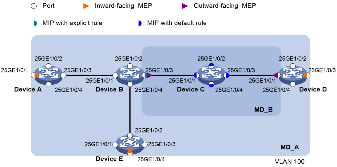

CFD levels
MD levels
To accurately locate faults, CFD introduces eight levels (from 0 to 7) to MDs. The bigger the number, the higher the level and the larger the area covered. Domains can touch or nest (if the outer domain has a higher level than the nested one) but cannot intersect or overlap.
MD levels facilitate fault location and make fault location more accurate. As shown in Figure 1, MD_A in light blue nests MD_B in dark blue. If a connectivity fault is detected at the boundary of MD_A, any of the devices in MD_A, including Device A through Device E, might fail. If a connectivity fault is also detected at the boundary of MD_B, the failure points can be any of Device B through Device D. If the devices in MD_B can operate correctly, at least Device C is operational.
This section assumes that physical links between devices are in good condition.
Figure 1 Two nested MDs
CFD exchanges messages and performs operations on a per-domain basis. By planning MDs correctly in a network, you can use CFD to rapidly locate failure points.

CFD configuration examples
Example: Configuring CFD in an Ethernet network
As shown in Figure 4:
·     The network comprises five devices and is divided into two MDs: MD_A (level 5) and MD_B (level 3). All ports belong to VLAN 100, and the MAs in the two MDs all serve VLAN 100. Assume that the MAC addresses of Device A through Device E are 0010-FC01-6511, 0010-FC02-6512, 0010-FC03-6513, 0010-FC04-6514, and 0010-FC05-6515, respectively.
·     MD_A has three edge ports: Twenty-FiveGigE 1/0/1 on Device A, Twenty-FiveGigE 1/0/3 on Device D, and Twenty-FiveGigE 1/0/4 on Device E. They are all inward-facing MEPs. MD_B has two edge ports: Twenty-FiveGigE 1/0/3 on Device B and Twenty-FiveGigE 1/0/1 on Device D. They are both outward-facing MEPs.
·     In MD_A, Device B is designed to have MIPs when its port is configured with low level MEPs. Port Twenty-FiveGigE 1/0/3 is configured with MEPs of MD_B, and the MIPs of MD_A can be configured on this port. You must configure the MIP generation rule of MD_A as explicit.
·     The MIPs of MD_B are designed on Device C, and are configured on all ports. You must configure the MIP generation rule as default.
·     Configure CC to monitor the connectivity among all the MEPs in MD_A and MD_B. Configure LB to locate link faults, and use the AIS and EAIS functions to suppress the error alarms that are reported.
·     Configure port collaboration on Twenty-FiveGigE 1/0/3 of Device B. After the outward-facing MEP on the interface detects a link fault, the interface is shut down or blocked.
·     After the status information of the entire network is obtained, use LT, LM, one-way DM, two-way DM, and TST to detect link faults.
Figure 4 Network diagram
On each device shown in Figure 4, create VLAN 100 and assign ports Twenty-FiveGigE 1/0/1 through Twenty-FiveGigE 1/0/4 to VLAN 100.

# Use continual LM to test the frame loss from MEP 1001 to MEP 4002 in service instance 1 on Device A.
[DeviceA] cfd slm continual service-instance 1 mep 1001 target-mep 4002
# Display the LM result on MEP 4002 in service instance 1 on Device A.
[DeviceA] display cfd slm history service-instance 1 mep 1001
Service instance: 1
MEP ID: 1001
Send status: Testing
Test state: Active
Reply from 0010-fc04-6514:
Far-end frame loss : 10                   Far-end frame loss rate : 10.00%
Near-end frame loss: 20                   Near-end frame loss rate: 20.00%
Far-end frame loss : 40                   Far-end frame loss rate : 40.00%
Near-end frame loss: 40                   Near-end frame loss rate: 40.00%
Far-end frame loss : 0                    Far-end frame loss rate : 0.00%
Near-end frame loss: 10                   Near-end frame loss rate: 10.00%
Far-end frame loss : 30                   Far-end frame loss rate : 30.00%
Near-end frame loss: 30                   Near-end frame loss rate: 30.00%
Far-end frame loss : 20                   Far-end frame loss rate : 20.00%
Near-end frame loss: 25                   Near-end frame loss rate: 25.00%
Average:
4.     Verify the one-way DM function after the CC function obtains the status information of the entire network:
# Test the one-way frame delay from MEP 1001 to MEP 4002 in service instance 1 on Device A.
[DeviceA] cfd dm one-way service-instance 1 mep 1001 target-mep 4002
5 1DMs have been sent. Please check the result on the remote device.
# Display the one-way DM result on MEP 4002 in service instance 1 on Device D.
[DeviceD] display cfd dm one-way history service-instance 1 mep 4002
Service instance: 1
MEP ID: 4002
Sent 1DM total number: 0
Received 1DM total number: 5
Frame delay: 10ms 9ms 11ms 5ms 5ms
Delay average: 8ms
Delay variation: 5ms 4ms 6ms 0ms 0ms
Variation average: 3ms
5.     Verify the two-way DM function after the CC function obtains the status information of the entire network:
# Use short-period two-way DM to test the two-way frame delay from MEP 1001 to MEP 4002 in service instance 1 on Device A.
[DeviceA] cfd dm two-way service-instance 1 mep 1001 target-mep 4002
Frame delay:
Reply from 0010-fc04-6514: 10us
Reply from 0010-fc04-6514: 9us
Reply from 0010-fc04-6514: 11us
Reply from 0010-fc04-6514: 5us
Average: 8us
Frame delay variation: 1us 2us 6us 0us
Average: 2us
Packet statistics:
Sent DMMs: 5        Received: 5        Lost: 0
# Use continual two-way DM to test the two-way frame delay from MEP 1001 to MEP 4002 in service instance 1 on Device A.
[DeviceA] cfd dm two-way continual service-instance 1 mep 1001 target-mep 4002
# Display the two-way DM result on MEP 1001 in service instance 1 on Device A.
[DeviceA] display cfd dm two-way history service-instance 1 mep 1001
Service instance: 1
MEP ID: 1001
Frame delay:
Reply from 0010-fc04-6514: 564us
Reply from 0010-fc04-6514: 606us
Reply from 0010-fc04-6514: 650us
Reply from 0010-fc04-6514: 626us
Reply from 0010-fc04-6514: 660us
Average: 621us
Frame delay variation: 42us 44us 24us 34us
Average: 36us
Packet statistics:
6.     Verify the TST function after the CC function obtains the status information of the entire network:
# Use short-period TST to test the bit errors on the link from MEP 1001 to MEP 4002 in service instance 1 on Device A.
[DeviceA] cfd tst service-instance 1 mep 1001 target-mep 4002
5 TSTs have been sent. Please check the result on the remote device.
# Display the TST result on MEP 4002 in service instance 1 on Device D.
[DeviceD] display cfd tst history service-instance 1 mep 4002
Service instance: 1
MEP ID: 4002
Received from 0010-fc01-6511, Bit True,  sequence number 0
Received from 0010-fc01-6511, Bit True,  sequence number 1
Received from 0010-fc01-6511, Bit True,  sequence number 2
Received from 0010-fc01-6511, Bit True,  sequence number 3
Received from 0010-fc01-6511, Bit True,  sequence number 4
Sent TST total number: 7
Received TST total number: 5
Received bit error TST number: 0
Percentage of error messages: 0.00%
