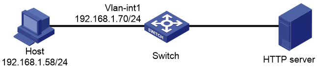

APR configuration examples
Example: Configuring PBAR
As shown in Figure 1, configure PBAR on the switch to recognize the HTTP packets sent by the host and destined for port 8080.
The switch drops the packets recognized by PBAR.
Figure 1 Network diagram
# Create an application group named group1, and enter application group view.
<Switch> system-view
[Switch] app-group group1
# Add HTTP to the application group.
[Switch-app-group-group1] include application http
[Switch-app-group-group1] quit
# Map HTTP to TCP and port 8080.
[Switch] port-mapping application http port 8080 protocol tcp
# Create a traffic class named classifier_1, and match group1 to the class.
[Switch] traffic classifier classifier_1
[Switch-classifier-classifier_1] if-match app-group group1
[Switch-classifier-classifier_1] quit
# Create a traffic behavior named bdeny, and configure the action as deny.
[Switch] traffic behavior bdeny
[Switch-behavior-bdeny] filter deny
[Switch-behavior-bdeny] quit
# Create QoS policy 1, associate classifier_1 with traffic behavior bdeny to create a class-behavior association in the QoS policy.
[Switch] qos policy 1
[Switch-qospolicy-1] classifier classifier_1 behavior bdeny
[Switch-qospolicy-1] quit
# Apply the QoS policy to the inbound direction of VLAN-interface 1.
[Switch] interface vlan-interface 1
[Switch-Vlan-interface1] qos apply policy 1 inbound
[Switch-Vlan-interface1] quit
# Verify that the host fails to establish an HTTP connection whose destination port is 8080 with the public network. (Details not shown.)
