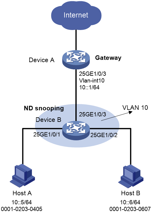

Example: Configuring ND attack detection
As shown in Figure 2, configure ND attack detection on Device B to check user validity for ND messages from Host A and Host B.
Figure 2 Network diagram
1.     Configure Device A:
# Create VLAN 10.
<DeviceA> system-view
[DeviceA] vlan 10
[DeviceA-vlan10] quit
# Configure Twenty-FiveGigE 1/0/3 to trunk VLAN 10.
[DeviceA] interface twenty-fivegige 1/0/3
[DeviceA-Twenty-FiveGigE1/0/3] port link-type trunk
[DeviceA-Twenty-FiveGigE1/0/3] port trunk permit vlan 10
[DeviceA-Twenty-FiveGigE1/0/3] quit
# Assign IPv6 address 10::1/64 to VLAN-interface 10.
[DeviceA] interface vlan-interface 10
[DeviceA-Vlan-interface10] ipv6 address 10::1/64
[DeviceA-Vlan-interface10] quit
2.     Configure Device B:
# Create VLAN 10.
<DeviceB> system-view
[DeviceB] vlan 10
[DeviceB-vlan10] quit
# Configure Twenty-FiveGigE 1/0/1, Twenty-FiveGigE 1/0/2, and Twenty-FiveGigE 1/0/3 to trunk VLAN 10.
[DeviceB] interface twenty-fivegige 1/0/1
[DeviceB-Twenty-FiveGigE1/0/1] port link-type access
[DeviceB-Twenty-FiveGigE1/0/1] port access vlan 10
[DeviceB-Twenty-FiveGigE1/0/1] quit
[DeviceB] interface twenty-fivegige 1/0/2
[DeviceB-Twenty-FiveGigE1/0/2] port link-type access
[DeviceB-Twenty-FiveGigE1/0/2] port access vlan 10
[DeviceB-Twenty-FiveGigE1/0/2] quit
[DeviceB] interface twenty-fivegige 1/0/3
[DeviceB-Twenty-FiveGigE1/0/3] port link-type trunk
[DeviceB-Twenty-FiveGigE1/0/3] port trunk permit vlan 10
[DeviceB-Twenty-FiveGigE1/0/3] quit
# Enable ND attack detection for VLAN 10.
[DeviceB] vlan 10
[DeviceB-vlan10] ipv6 nd detection enable
# Enable ND snooping for IPv6 global unicast addresses and ND snooping for IPv6 link-local addresses in VLAN 10.
[DeviceB-vlan10] ipv6 nd snooping enable global
[DeviceB-vlan10] ipv6 nd snooping enable link-local
# Configure Twenty-FiveGigE 1/0/3 as ND trusted interface.
[DeviceB-Twenty-FiveGigE1/0/3] ipv6 nd detection trust
Verify that Device B inspects all ND messages received by Twenty-FiveGigE 1/0/1 and Twenty-FiveGigE 1/0/2 based on the ND snooping entries. (Details not shown.)

Example: Configuring RA guard
As shown in Figure 3, Twenty-FiveGigE 1/0/1, Twenty-FiveGigE 1/0/2, and Twenty-FiveGigE 1/0/3 of Device B are in VLAN 10.
Configure RA guard on Device B to filter forged and unwanted RA messages.
·     Configure an RA policy in VLAN 10 for Twenty-FiveGigE 1/0/2 to filter all RA messages received from the unknown device.
·     Specify host as the role of the host. All RA messages received on Twenty-FiveGigE 1/0/1 are dropped.
·     Specify router as the role of the Device A. All RA messages received on Twenty-FiveGigE 1/0/3 are forwarded.
Figure 3 Network diagram

# Verify that the device forwards or drops RA messages received on Twenty-FiveGigE 1/0/2 based on the RA guard policy. (Details not shown.)
# Verify that the device drops RA messages received on Twenty-FiveGigE 1/0/1. (Details not shown.)
# Verify that the device forwards RA messages received on Twenty-FiveGigE 1/0/3 to other interfaces in VLAN 10. (Details not shown.)
