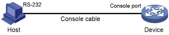

As shown in Figure 1, use a terminal emulator program, such as HyperTerminal or PuTTY to connect the configuration terminal to the device.
Figure 1 Connecting the PC to the device
Configure the terminal parameters as follows:
·     Bits per second—9600.
·     Data bits—8.
·     Stop bits—1.
·     Parity—None.
·     Flow control—None.
