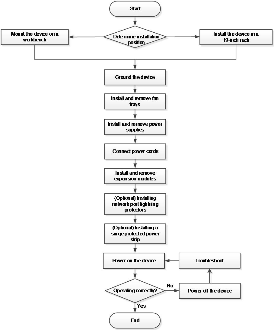

Installation workflow
Figure1-1 Installation workflow

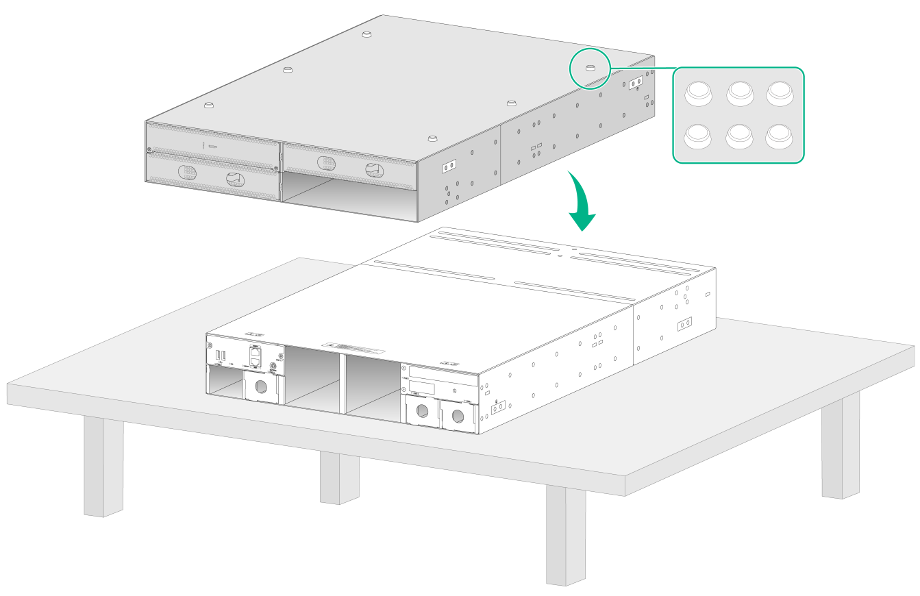

1.     Place the device upside down. Clean the recessed areas on the chassis bottom.
2.     Attach the six rubber feet to the recessed areas on the chassis bottom.
3.     Place the device on the workbench with the upside up. Make sure the six rubber feet stand firmly on the workbench.
Figure1-2 Mounting the device on a workbench

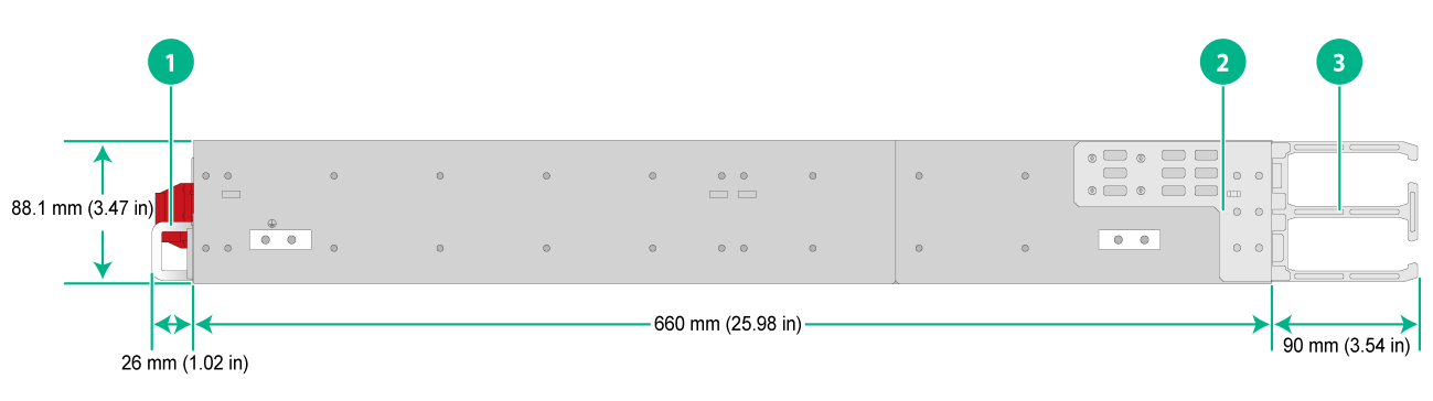

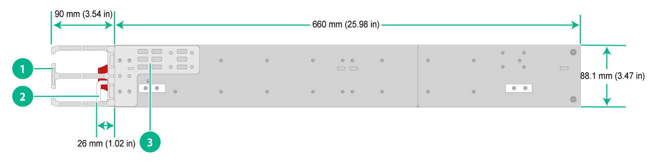

Chassis dimensions and rack requirements
Figure1-4 Chassis dimensions (mounting brackets installed at the port side)
(1) Power supply handle
(2) Mounting bracket
Figure1-5 Chassis dimensions (mounting brackets installed at the power supply side)
Table1-1 Chassis dimensions and installation requirements for the rack

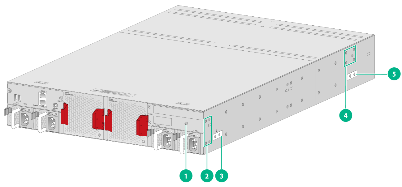

The device has one mounting position near the network ports and one mounting position near the power supplies for mounting brackets.
The device provides a primary grounding point and two auxiliary grounding points. The primary grounding point has a grounding sign.
Figure1-6 Mounting brackets and grounding cable installation positions on the device
(1) Auxiliary grounding point 2
(2) Power supply-side installation position for the mounting bracket
(3) Primary grounding point
(4) Port-side installation position for the mounting bracket
(5) Auxiliary grounding point 1

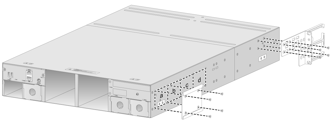

2.     Determine the installation position of the chassis rails based on the position of mounting brackets and the distance between the front and rear rack posts.
Table1-2 Chassis rail installation position
Installation method
Mounting bracket position
Distance between the front and rear rack posts
Port-side mounting position, as shown in Figure1-7.
675 to 923 mm (26.58 to 36.34 in)
Position a
611 to 858 mm (24.06 to 33.78 in)
Position b
546 to 793 mm (21.50 to 31.22 in)
Position c
518 to 728 mm (20.39 to 28.66 in)
Position d
Power supply-side mounting position, as shown in Figure1-8.
Position e
Position f
Position g
3.     Place the chassis rail against the chassis side panel. Align the chassis rail installation holes with the screw holes. Use the provided M4 × 6 screws to attach the chassis rail to the chassis. See Figure1-7 and Figure1-8.
Figure1-7 Attaching the mounting brackets and chassis rails to the device (port-side mounting position for the mounting brackets)
Figure1-8 Attaching the mounting brackets and chassis rails to the device (power supply-side mounting position for the mounting brackets)

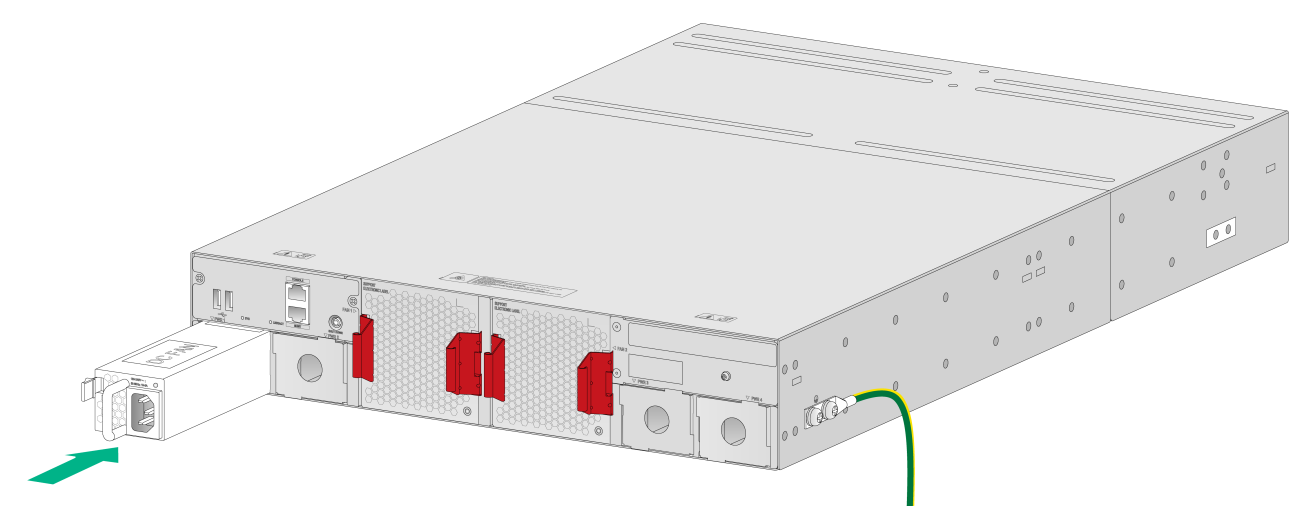

Connecting the grounding cable to the chassis
CAUTION
CAUTION:

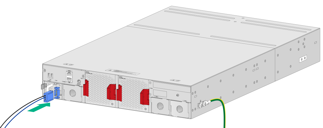

If you use a grounding point to ground the device, you must connect the grounding cable to the grounding point before you mount the device in the rack.
The device provides a primary grounding point and two auxiliary grounding points. The primary grounding point and auxiliary grounding point 1 are at the right panel and auxiliary grounding point 2 is at the front panel. The primary grounding point has a grounding sign and the auxiliary grounding points do not. If you use a grounding cable that has a dual-hole lug, connect it to the primary grounding point or auxiliary grounding point 1. If you use a grounding cable that has a single-hole lug, connect it to auxiliary grounding point 2. Choose the grounding point according to the mounting bracket installation positions.
The grounding cable connection procedure is the same for the primary and auxiliary grounding points. The following procedure connects the grounding cable to the primary grounding point.
To connect the grounding cable to the primary grounding point:
1.     Choose a grounding point as required.
When you install the mounting brackets at the port-side mounting position, choose the auxiliary grounding points. When you install the mounting brackets at the power supply-side mounting position, choose the primary grounding point.
2.     Unpack the grounding cable and grounding screws.
3.     Use the two grounding screws to attach the two-hole grounding lug of the grounding cable to the grounding holes at the grounding point. Use a screwdriver to fasten the screws. See Figure1-9.
As a best practice, use a torque of 20 kgf-cm (1.96 Nm) to fasten the grounding screws.

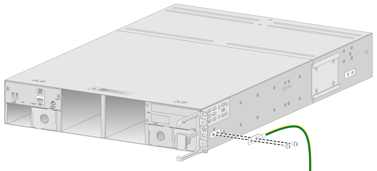

4.     To connect the grounding cable to auxiliary grounding point 2, use the grounding screw to attach the grounding lug of the grounding cable to the grounding hole at auxiliary grounding point 2. Use a screwdriver to tighten the screw.
Figure1-10 Attaching a grounding cable that has a single-hole lug to auxiliary grounding point 2

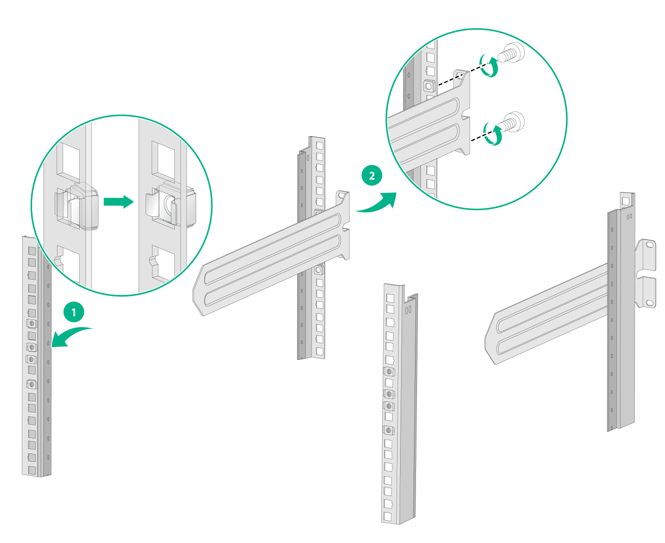

Attaching the slide rails to the rack
1.     Identify the slide rail installation position in the rack.
2.     Install cage nuts (user-supplied) in the mounting holes in the rack posts.
3.     Align the screw holes in one slide rail with the cage nuts in a rear rack post. Use user-supplied M6 screws to attach the slide rail to the post. See Figure1-11.
As a best practice, use a torque of 30 kgf-cm (2.94 Nm) to fasten M6 screws.
4.     Repeat the preceding steps to attach the other slide rail to the other rear rack post.
Keep the two slide rails at the same height so the slide rails can attach into the chassis rails.
Figure1-11 Installing the slide rails

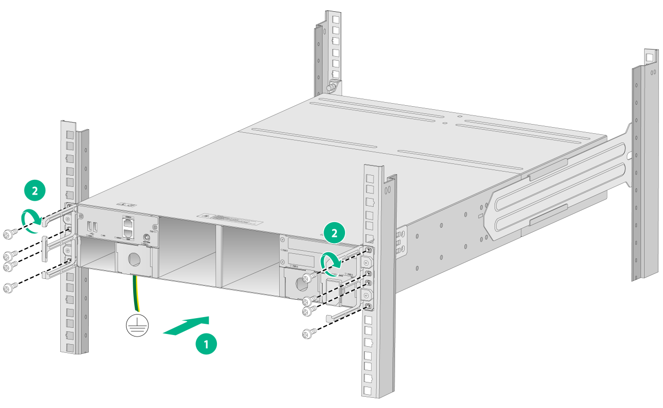

Mounting the device in the rack
This task requires two people.
To mount the device in the rack:
1.     Wear an ESD wrist strap and make sure it makes good skin contact and is reliably grounded.
2.     Verify that the mounting brackets and chassis rails have been securely attached to the device chassis. For more information, see "Attaching the mounting brackets and chassis rails to the chassis".
3.     Verify that the slide rails have been correctly attached to the rear rack posts. For more information, see "Attaching the slide rails to the rack".
4.     Attach cage nuts (user-supplied) to the front rack posts and make sure they are at the same level as the slide rails.
5.     One person performs the following operations:
a.     Supporting the bottom of the device, aligns the chassis rails with the slide rails on the rack posts.
b.     Pushes the device slowly to slide the chassis rails along the slide rails until the mounting brackets are flush with the rack posts.
IMPORTANT
IMPORTANT:
Make sure the front ends of the slide rails reach out of the chassis rails for a maximum of 30 mm (1.18 in).
6.     Another person uses user-supplied M6 screws to attach the mounting brackets to the rack.
Figure1-12 Mounting the device in the rack (port-side mounting position for the mounting brackets)
Figure1-13 Mounting the device in the rack (power supply-side mounting position for the mounting brackets)

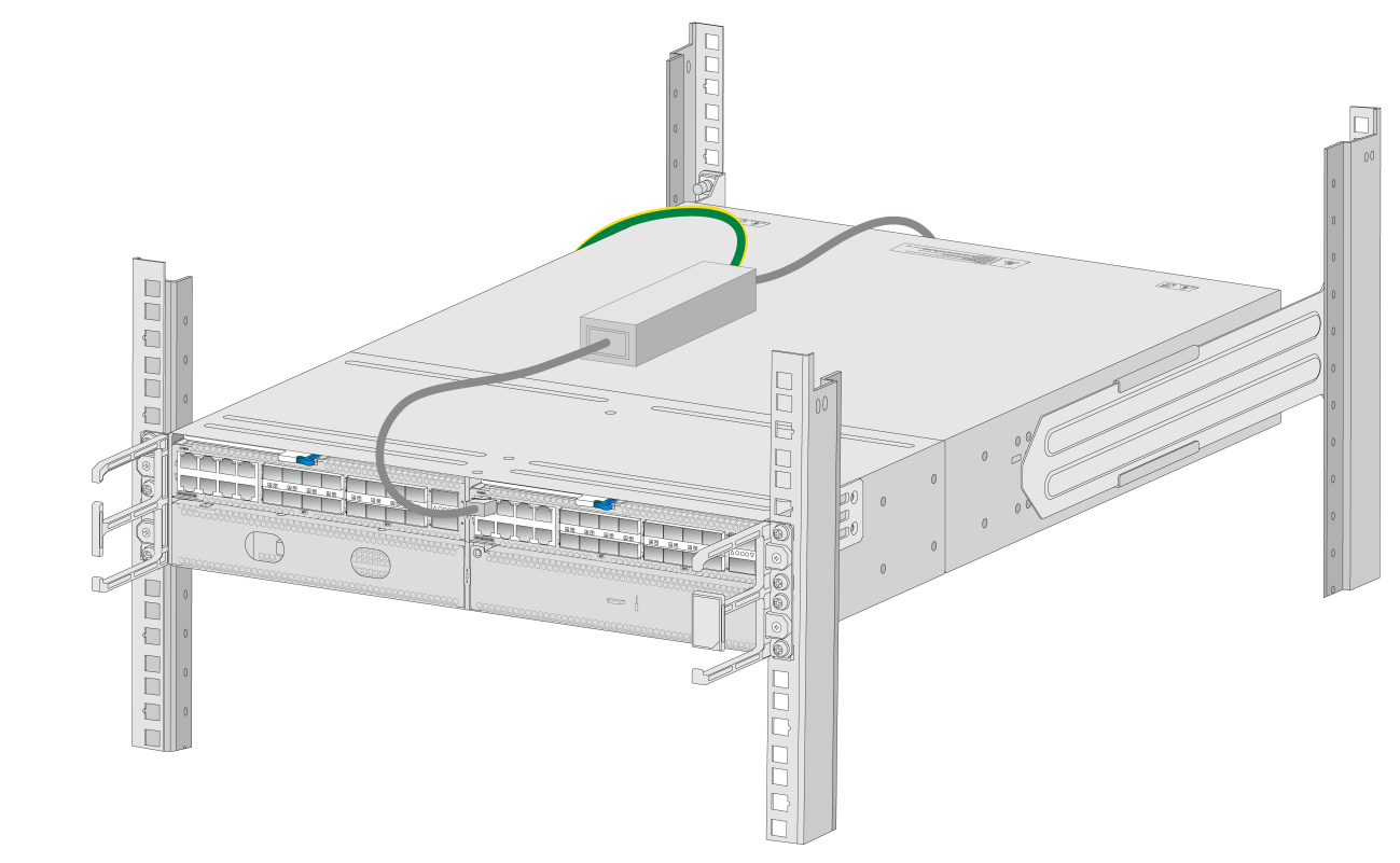

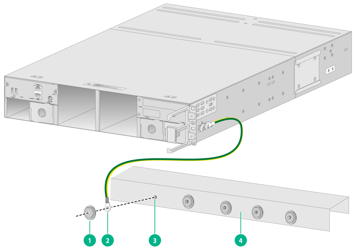

Grounding the device through a grounding strip
1.     Attach the two-hole grounding lug of the grounding cable to a grounding point on the chassis. For more information, see "Connecting the grounding cable to the chassis".
2.     Remove the hex nut of a grounding post on the grounding strip.
3.     Attach the ring terminal of the grounding cable to the grounding post on the grounding strip, and secure the ring terminal to the grounding post with the hex nut.
Figure1-14 Connecting the grounding cable to a grounding strip
(1) Hex nut
(2) Ring terminal
(3) Grounding post
(4) Grounding strip

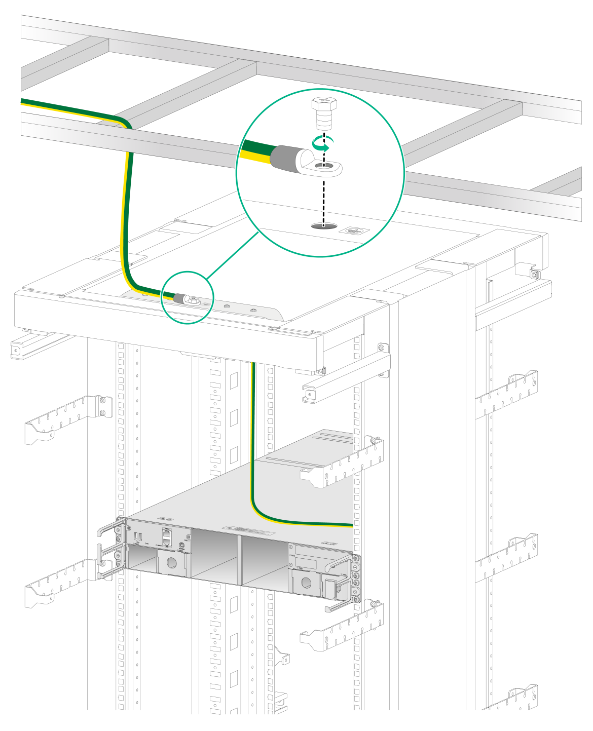

Grounding the device through the rack
If the device is installed in a rack, you can connect the other end of the grounding cable to the grounding point on the rack. Make sure the rack is reliably grounded.
Figure1-15 Grounding the device through the rack

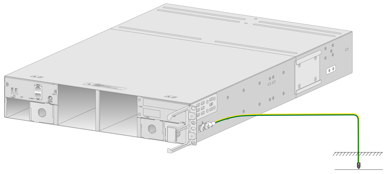

Grounding the device with a grounding conductor buried in the earth
If earth is available at the installation site, you can ground the device with a grounding conductor buried in the earth.
Hammer a 0.5 m (1.64 ft) or longer angle iron or steel tube into the earth to serve as a grounding conductor. Weld the yellow-green grounding cable to the angel iron or steel tube and treat the joint for corrosion protection.
Figure1-16 Grounding the device by burying the grounding conductor into the earth

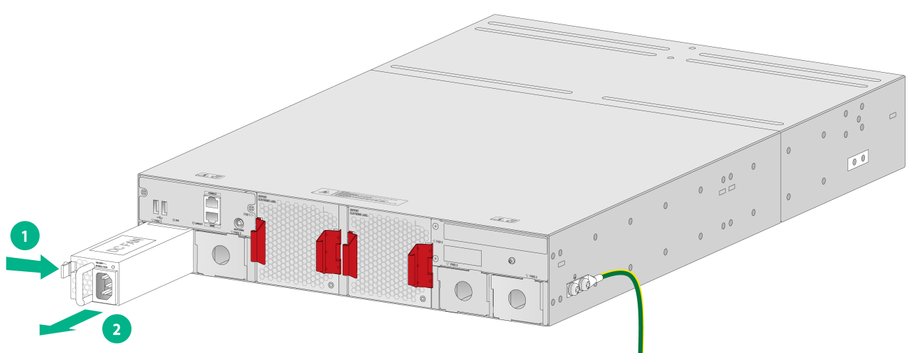

Installing/removing fan trays
CAUTION
CAUTION:
The device has two fan tray slots. To ensure good ventilation of the device, follow these guidelines to install and remove fan trays:
·     The device is provided with the fan tray slots empty. Before powering on the device, make sure all fan tray slots have fan trays installed and the fan trays are the same model.
·     Make sure all slots have a module or filler panel installed when the device is operating.
·     If both fan trays fail on an operating device, do not remove the fan trays at the same time. Replace the fan trays one after another and finish replacing each fan tray within 1 minute.
The fan trays support obtaining electronic label information.

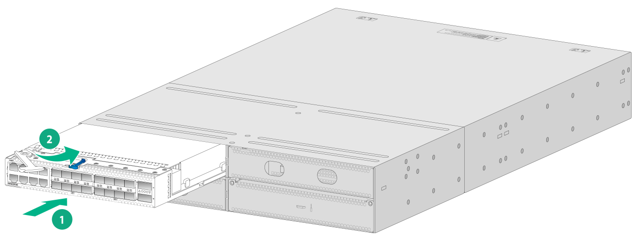

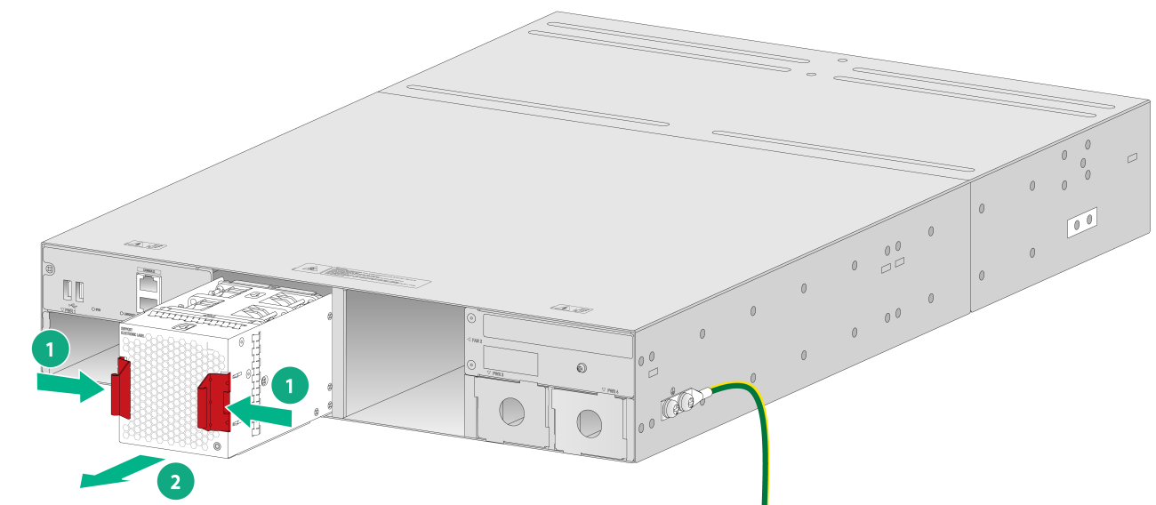

Installing a fan tray
CAUTION
CAUTION:
To prevent damage to the fan tray or the connectors on the backplane, insert the fan tray gently. If you encounter a hard resistance while inserting the fan tray, pull out the fan tray and insert it again.
Select fan trays for the device as needed. For the available fan trays and their specifications, see H3C WX5800X Series Access Controllers Hardware Information and Specifications.

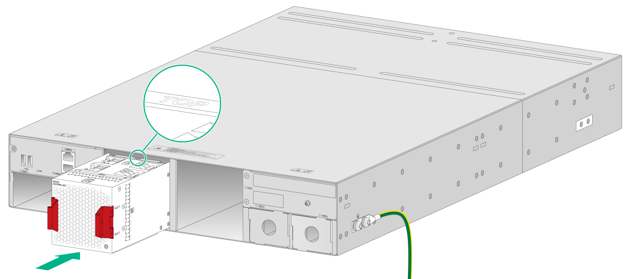

To install a fan tray:
2.     Unpack the fan tray and verify that the fan tray model is correct.
3.     Orient the fan tray with the "TOP" mark on top. Grasp the handle of the fan tray with one hand and support the fan tray bottom with the other, and slide the fan tray along the guide rails into the slot until the fan tray is fully seated in the slot and has a firm contact with the backplane. See Figure1-17.
Figure1-17 Installing a fan tray in the device

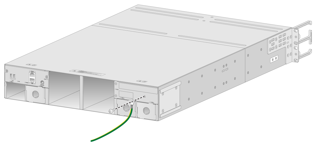

Removing a fan tray
WARNING
WARNING!
·     Ensure electricity safety and never touch the rotating fans when you hot-swap a fan tray.
·     To prevent a fan from causing loud noise, do not touch the fan blades and rotation axis, even if the fan is not rotating.
To remove a fan tray:
2.     Grasp the handle of the fan tray with one hand and pull the fan tray part way out of the slot. Support the fan tray bottom with the other and pull the fan tray completely out of the slot.
3.     Put the removed fan tray in an antistatic bag.
Figure1-18 Removing a fan tray
Installing/removing power supplies
WARNING
WARNING!
·     To avoid bodily injury and device damage, strictly follow the procedures in Figure1-19 and Figure1-20 to install and remove a power supply.
·     Provide a separate circuit breaker for each power supply.
Figure1-19 Installation procedure
Figure1-20 Removal procedure
Installing a power supply
CAUTION
CAUTION:
·     Follow the forward inertia of the power supply when inserting it into the chassis, and make sure the power supply has firm contact with the connectors on the backplane.
·     To prevent damage to the connectors inside the device chassis, insert the power supply gently. If you encounter a hard resistance while inserting the power supply, pull out the power supply and insert it again.
·     Do not install a DC power supply and an AC power supply on the same device.
To install a power supply:

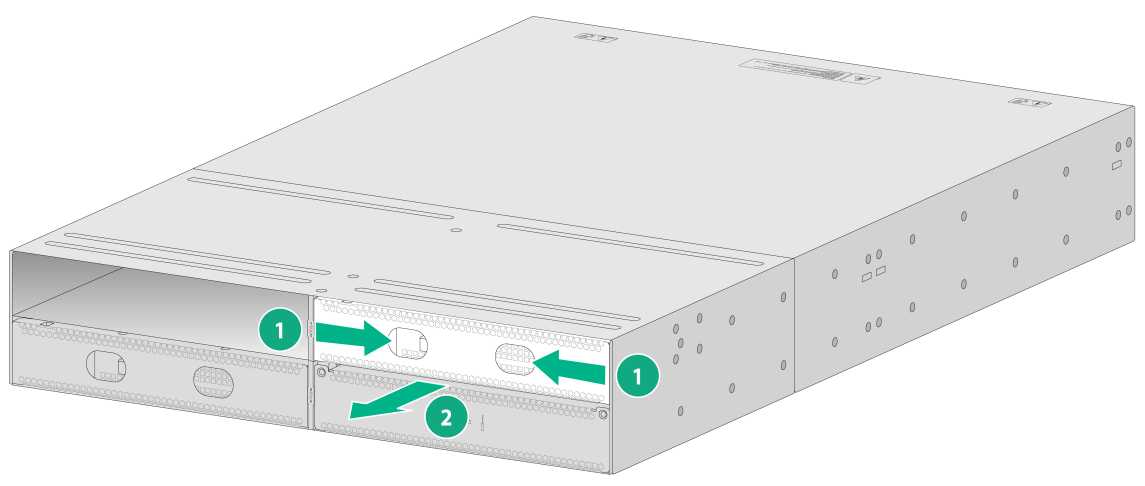

2.     Remove the filler panel, if any, from the target power supply slot, as shown in Figure1-21.
Figure1-21 Removing a filler panel

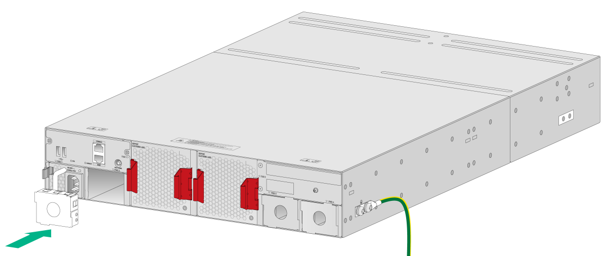

3.     Unpack the power supply and verify that the power supply model is correct.
4.     Correctly orient the power supply with the words on the power supply upward. Grasp the handle of the power supply with one hand and support its bottom with the other, and slide the power supply slowly along the guide rails into the slot.
The slot is foolproof. If you cannot insert the power supply into the slot, re-orient the power supply rather than use excessive force to push it in.
Figure1-22 Installing a power supply
Removing a power supply
CAUTION
CAUTION:
When the device has two, three, and four power supplies in 1+1, 1+2, and 1+3 redundancy mode, removing one, two, and three power supplies, respectively does not affect the operation of the device.
To remove a power supply:
2.     Remove the power cord from the power supply. To remove a DC power cord, squeeze the tabs on the power cord connector with your thumb and forefinger, and then pull the connector out.
3.     Hold the handle on the power supply with one hand, pivot the latch on the power supply to the right with your thumb, and pull the power supply part way out of the slot, as shown in Figure1-23.
4.     Supporting the power supply bottom with one hand, slowly pull the power supply out with the other hand.
5.     Put the removed power supply in an antistatic bag for future use.
6.     If you are not to install a new power supply, install a filler panel in the slot to ensure good ventilation in the device, as shown in Figure1-24.
Figure1-23 Removing the power supply
Figure1-24 Installing a filler panel

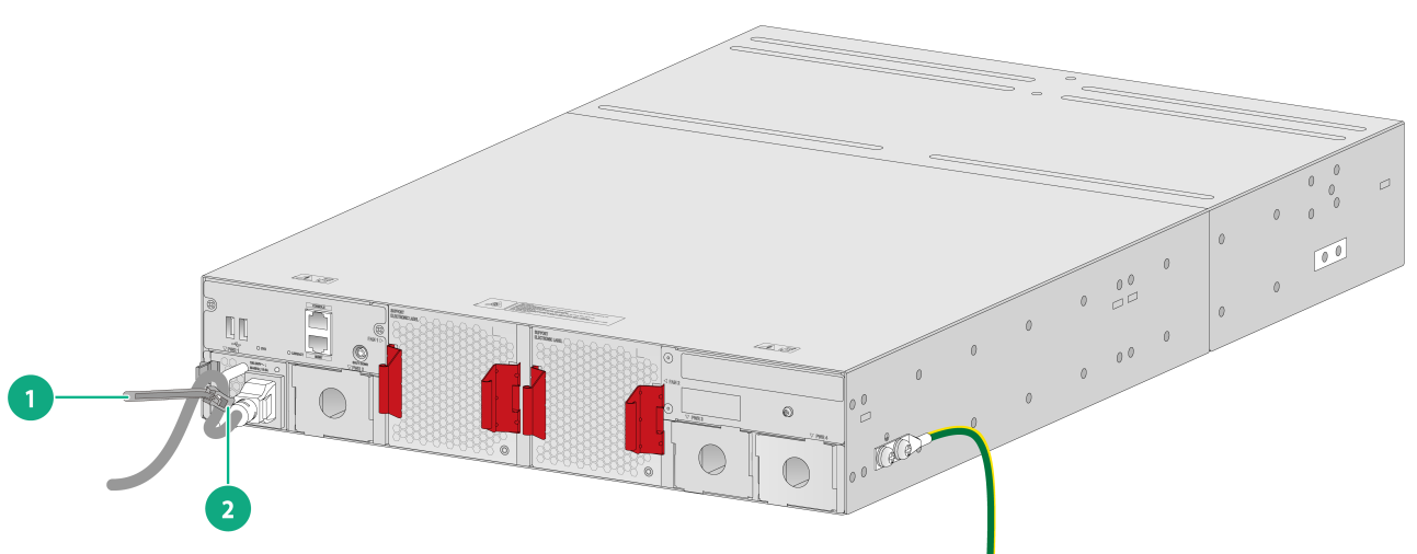

Connecting an AC power cord
1.     Insert the female connector of the AC power cord supplied with the power supply into the power receptacle on the power supply.
2.     Use a cable tie to secure the power cord to the handle of the power supply, as shown in Figure1-25.
3.     Connect the other end of the power cord to an AC power outlet.
Figure1-25 Connecting an AC power cord to a power supply
(1) Releasable cable tie
(2) Tighten the releasable cable tie to secure the power cord to the handle of the power supply

Installing an expansion module
1.     Wear an ESD wrist strap and make sure the wrist strap makes good skin contact and is reliably grounded.
2.     Remove the filler panel, if any, from the target expansion module slot. As shown in Figure1-27, put your thumb and forefinger into the two holes of the filler panel. Then press down the metal tab in the top hole and pull out the filler panel along the guide rails.
Figure1-27 Removing the filler panel from the expansion module slot
Keep the removed filler panel secure for future use.
3.     Unpack the expansion module.

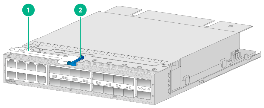

4.     Press down and hold the latch of the ejector lever to pull the ejector lever out.
Figure1-28 Expansion module
(1) Latch
(2) Ejector lever
5.     Insert the module slowly into the slot along the guide rails, as shown by callout 1 in Figure1-29.
6.     Press down and hold the latch of the ejector lever to rotate the ejector lever to its original place, and then release the grip on the latch to lock the ejector lever in place, as shown by callout 2 in Figure1-29.
Figure1-29 Installing an expansion module

(Optional) Installing network port lightning protectors
IMPORTANT
IMPORTANT:
·     Before installing a network port lightning protector, read the instructions in the document that comes with the protector.
·     Network port lightning protectors are available only for 100M/1000M RJ-45 Ethernet copper ports.
·     If multiple network ports have network cables routed outdoors, install a network port lightning protector for each network port.
If part of the network cable for a network port is routed outdoors, install a network port lightning protector for the port to protect against damages caused by lightning strikes.
No network port lightning protectors are provided with the device. Purchase them yourself as required.
To install a network port lightning protector for a network port:
1.     Use a double-faced adhesive tape to stick the network port lightning protector onto the device chassis, and make sure it is as close to the grounding screw of the device as possible.
2.     Cut the ground wire of the protector to a length (as short as possible) as required by the distance between the protector and the grounding screw of the device. Attach the ground wire securely to the grounding screw of the device.
Make sure the grounding screw of the device is reliably grounded.
3.     Use a multimeter to verify that the ground wire of the protector makes good contact with the grounding screw of the chassis.
4.     Insert the outdoor network cable into the protector's Surge end marked IN, and insert the cable from the network port into the Protect end marked OUT.
5.     Examine the port LED to verify that the port is operating correctly.
Figure1-31 Installing a lightning protector for a network port
