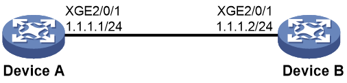

Example: Tracing IPv4 TCP connections
As show in Figure 3, you can Telnet to Device B from Device A. Configure TCP connection trace on Device A to trace the TCP connection between Device A and Device B. When the connection is abnormally closed, you can use the trace information to locate disconnection reasons. Enable persistence for TCP connection trace configuration so that the configuration can survive Device A reboot.
Figure 3 Network diagram
·     Configure Device B as a Telnet server. For more information, see login management configuration in Fundamentals Configuration Guide.
·     Assign an IP address to each interface as shown in Figure 3. (Details not shown.)

Example: Tracing IPv6 TCP connections
As show in Figure 4, you can Telnet to Device B from Device A. Configure TCP connection trace on Device A to trace the IPv6 TCP connection between Device A and Device B. When the connection is abnormally closed, you can use the trace information to locate disconnection reasons. Enable persistence for TCP connection trace configuration so that the configuration can survive Device A reboot.
Figure 4 Network diagram
·     Assign an IPv6 address to each interface as shown in Figure 4. (Details not shown.)
