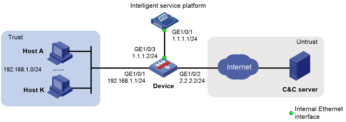

The intelligent service platform is installed on the device as a module and is connected to the device through an internal Ethernet interface. Figure 1 shows the network diagram of the intelligent service platform module.
Figure 1 Intelligent service platform module
After the intelligent service platform module is installed on the device, the internal Ethernet interface (Port4 in the figure) is presented as another Ethernet interface (Port1 in the figure). Port1 connects to Port4 logically. The device communicates with Port4 of the intelligent service platform module through Port1.
