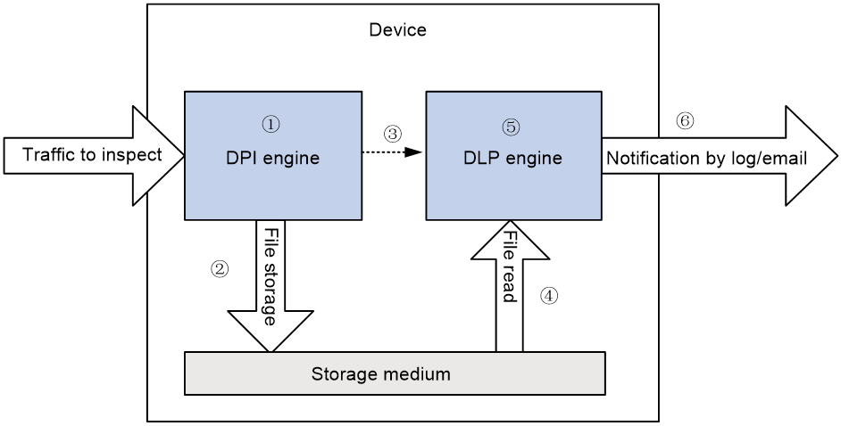

As shown in Figure 1, the device uses the DPI engine and DLP engine to perform DLP flow monitoring. The DPI engine performs file extraction and the DLP engine performs sensitive information detection. For more information about the DPI engine, see "Configuring DPI engine."
DLP uses the following workflow:
1.     The DPI engine extracts files from the traffic to inspect.
2.     The DPI engine stores the files to the storage medium of the device.
3.     The DPI engine notifies the DLP engine to scan the files.
4.     The DLP engine scans and reads the files from the storage medium.
5.     The DLP engine detects sensitive information in the files.
6.     The DLP engine sends a notification by log or email based on the detection result.
Figure 1 DLP mechanism

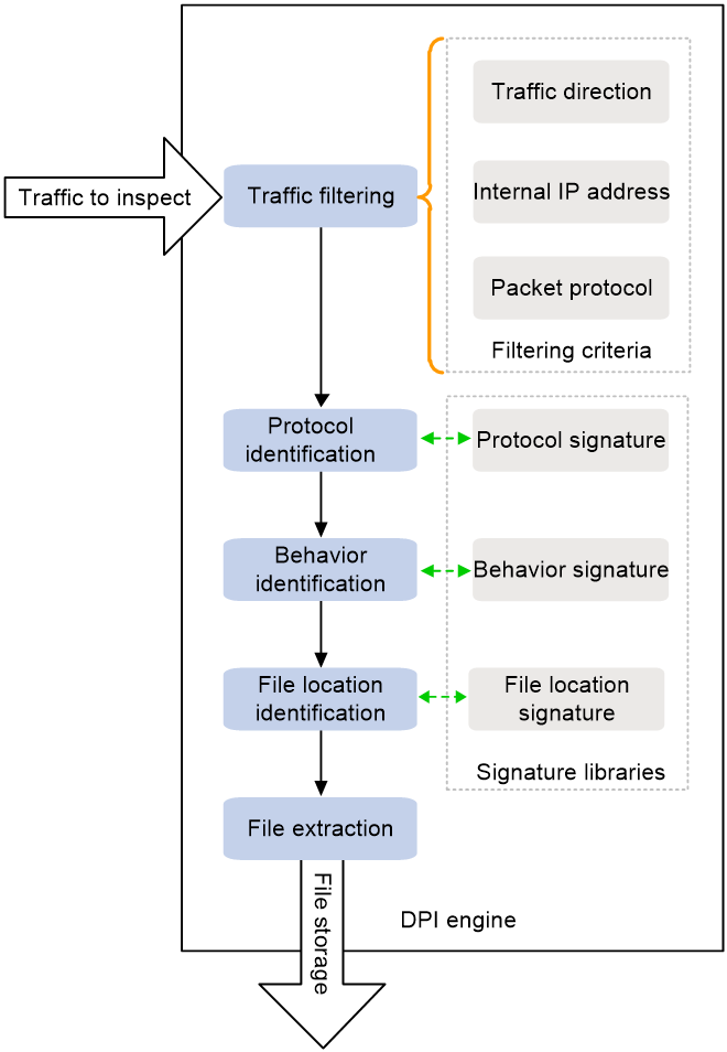

File extraction
As shown in Figure 2, the DPI engine identifies the application layer information and extracts files in packets as follows:
1.     Filters traffic by using the following filtering criteria:
¡     Traffic direction—Matches the packet transmission direction. Options include external-to-internal, internal-to-external, and bidirectional.
¡     Internal IP address—Matches the destination IP address of packets transferred in the external-to-internal direction and matches the source IP address of packets transferred in the internal-to-external direction.
¡     Packet protocol—Matches the application layer protocol of packets.
2.     Identifies the application layer protocol of the matching packets, FTP or SMTP, for example.
3.     Identifies the behavior of the matching packets, for example, uploading a file or sending an email.
4.     Searches the signature libraries to identify the start and end locations of the files to be extracted in the packets.
5.     Extracts the files from the packets, saves the extracted files locally on the device, and assigns a unique URL to each file for the DLP engine to access.
Figure 2 DPI engine operation process

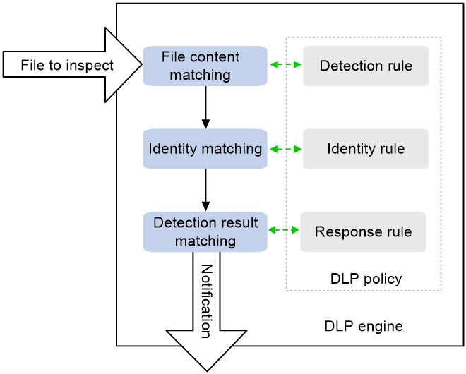

Sensitive information detection
If the extracted file is a compressed file, the DLP engine will decompress the file and perform sensitive information detection on the extracted file as follows:
1.     Uses the detection rule to match the file content.
2.     Uses the identity rule to match the identity of the sender or recipient.
3.     Uses the response rule to match the detection result.
4.     Sends a notification.
Figure 3 DLP engine operation process

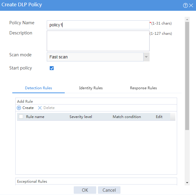

6.     Configure a DLP policy:
a.     Log in to the Web interface of the device.
b.     Select Policies > DLP > DLP Policies.
c.     Click Create.
d.     In the dialog box that opens, configure parameters for the DLP policy:
-     Enter a policy name.
-     Select a scan mode.
-     Select Start policy.
Figure 5 Creating a DLP policy

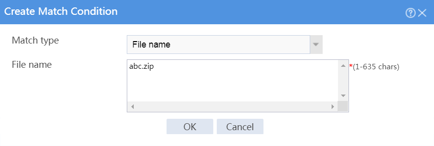

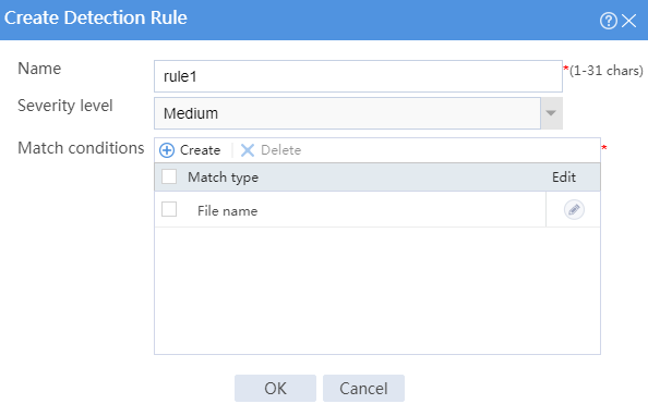

e.     On the Detection Rules tab of the Create DLP Policy dialog box, click Create in the Add Rule area.
f.     Configure parameters for the detection rule:
-     Enter a rule name.
-     Select a severity level.
-     Configure the match conditions as matching the file named abc.zip.
Figure 6 Creating a detection rule
Figure 7 Creating a match condition

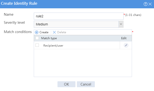

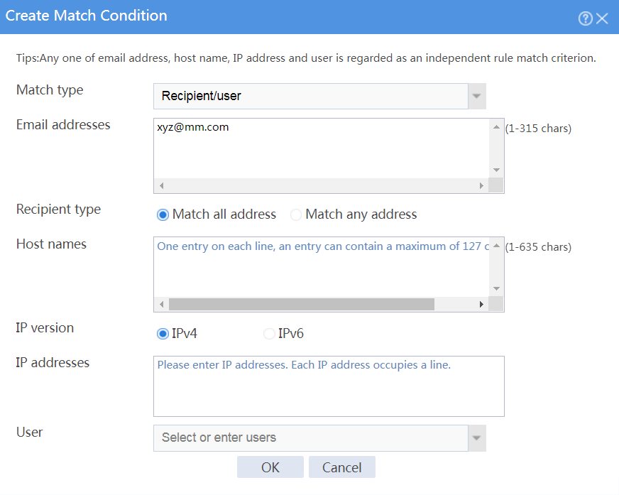

g.     Click OK. Then, click the Identity Rules tab on the Create DLP Policy dialog box and click Create in the Add Rule area.
h.     Configure parameters for the identity rule:
-     Configure the match conditions as matching the recipient at [email protected].
Figure 8 Creating an identity rule
Figure 9 Creating a match condition

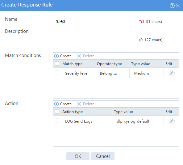

i.     Click OK. Then, click the Response Rules tab on the Create DLP Policy dialog box and create a response rule.
j.     Configure parameters for the response rule:
-     Configure the match conditions as matching security events with the medium severity level.
-     Configure the action as sending logs.
Figure 10 Creating a response rule
