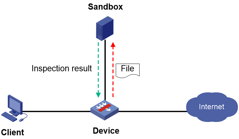

As shown in Figure 1, when an external attacker initiates an APT attack towards the enterprise network, the APT defense is implemented as follows:
1.     The device identifies the application layer protocol of the traffic and the file type, extracts the file content from the traffic. The device reconstructs the file when the following conditions are met:
¡     The attack traffic matches the APT defense policy, if any, on the device.
¡     The file size is within the file size limit defined by the sandbox inspection.
¡     The device has established a connection to the sandbox successfully.
2.     The device sends the reconstructed file to the sandbox for threat analysis.
3.     The sandbox executes the file and analyzes the file behavior to determine if the file is malicious. After the inspection completes, the sandbox sends the file inspection result back to the device, and the device saves the result in its APT defense cache.
¡     If the traffic is malicious, the device will execute the block or alert actions for subsequent traffic based on the specified anti-virus policy.
¡     If the traffic is not malicious, the device permits it to pass.
Figure 1 APT defense implementation
