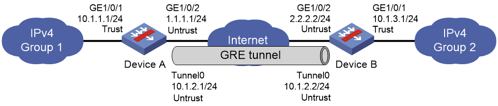

Example: Configuring an IPv4 over IPv4 GRE tunnel
As shown in Figure 6, Group 1 and Group 2 are two private IPv4 networks. The two networks both use private network addresses and belong to the same VPN. Establish a GRE tunnel between Device A and Device B to interconnect the two private IPv4 networks Group 1 and Group 2.
Figure 6 Network diagram
1.     Configure Device A:
# Assign an IP addresse to interface GigabitEthernet 1/0/1.
<DeviceA> system-view
[DeviceA-GigabitEthernet1/0/1] ip address 10.1.1.1 255.255.255.0
[DeviceA-GigabitEthernet1/0/1] quit
# Create tunnel interface Tunnel 0, and specify the tunnel mode as GRE/IPv4.
[DeviceA] interface tunnel 0 mode gre
[DeviceA-Tunnel0] ip address 10.1.2.1 255.255.255.0
[DeviceA-Tunnel0] source 1.1.1.1
[DeviceA-Tunnel0] destination 2.2.2.2
[DeviceA-Tunnel0] quit
# Configure settings for routing. This example configures static routes. In the routes, the output interface is Tunnel 0 and the next hop is 1.1.1.2.

Example: Configuring an IPv4 over IPv6 GRE tunnel
As shown in Figure 7, two IPv4 subnets Group 1 and Group 2 are connected to an IPv6 network. Create a GRE/IPv6 tunnel between Device A and Device B, so the two IPv4 subnets can communicate with each other through the GRE tunnel over the IPv6 network.
Figure 7 Network diagram

Troubleshooting GRE
The key to configuring GRE is to keep the configuration consistent. Most faults can be located by using the debugging gre or debugging tunnel command. This section analyzes one type of fault for illustration, with the scenario shown in Figure 8.
Figure 8 Network diagram
Hosts at both ends of a GRE tunnel cannot ping each other
Symptom
The interfaces at both ends of the tunnel are configured correctly and can ping each other, but Host A and Host B cannot ping each other.
Solution
To resolve the issue:
1.     Execute the display ip routing-table command on Device A and Device C to view whether Device A has a route over tunnel 0 to 10.2.0.0/16 and whether Device C has a route over tunnel 0 to 10.1.0.0/16.
2.     If such a route does not exist, execute the ip route-static command in system view to add the route. Take Device A as an example:
[DeviceA] ip route-static 10.2.0.0 255.255.0.0 tunnel 0
3.     If the issue persists, contact H3C Support.
