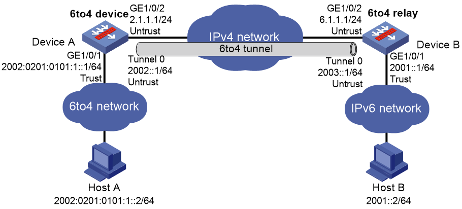

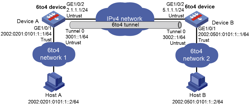

6to4 tunneling
·     Ordinary 6to4 tunneling
A 6to4 tunnel is a point-to-multipoint automatic tunnel. It is used to connect multiple isolated IPv6 networks over an IPv4 network.
The ends of a 6to4 tunnel are 6to4 addresses. The address format is 2002:abcd:efgh:subnet number::interface ID/48.
¡     2002 is the fixed IPv6 address prefix.
¡     abcd:efgh represents a 32-bit globally unique IPv4 address in hexadecimal notation.
For example, 1.1.1.1 can be represented by 0101:0101. The IPv4 address identifies a 6to4 network (an IPv6 network where all hosts use 6to4 addresses). The border router of a 6to4 network must have the IPv4 address abcd:efgh configured on the interface connected to the IPv4 network.
¡     The subnet number identifies a subnet in the 6to4 network.
¡     The subnet number::interface ID uniquely identifies a host in the 6to4 network.
The destination IPv4 address of a 6to4 tunnel is embedded in the destination 6to4 address. This mechanism enables the device to automatically obtain the tunnel destination address.
6to4 tunneling uses an IPv4 address to identify a 6to4 network. This method overcomes the limitations of automatic IPv4-compatible IPv6 tunneling.
·     6to4 relay
6to4 relay connects a 6to4 network and an IPv6 network that uses an IP prefix other than 2002::/16. A 6to4 relay router is a gateway that forwards packets from a 6to4 network to an IPv6 network.
As shown in Figure 2, 6to4 network Site 1 communicates with IPv6 network Site 3 over a 6to4 tunnel. Configure a static route on the border router (Device A) in the 6to4 network. The next hop address must be the 6to4 address of the 6to4 relay router (Device C). Device A forwards all packets destined for the IPv6 network over the 6to4 tunnel, and Device C then forwards them to the IPv6 network.
Figure 2 Principle of 6to4 tunneling and 6to4 relay

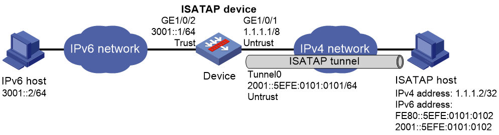

ISATAP tunneling
An ISATAP tunnel is a point-to-multipoint automatic tunnel. It provides a solution to connect an IPv6 host and an IPv6 network over an IPv4 network.
The destination address of an ISATAP tunnel is an ISATAP address. The address format is prefix:0:5EFE:abcd:efgh/64.
·     The 64-bit prefix is a valid IPv6 unicast address prefix.
·     The abcd:efgh/64 segments represent a 32-bit IPv4 address in hexadecimal notation, which identifies the tunnel destination but does not require global uniqueness.
ISATAP tunnels are mainly used for communication between IPv6 routers or between an IPv6 host and an IPv6 router over an IPv4 network.
Figure 3 Principle of ISATAP tunneling

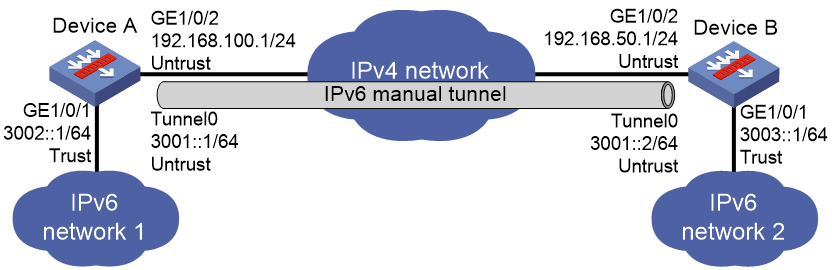

Example: Configuring an IPv6 over IPv4 manual tunnel
As shown in Figure 4, configure an IPv6 over IPv4 tunnel between Device A and Device B so the two IPv6 networks can reach each other over the IPv4 network. Because the tunnel destination IPv4 address cannot be automatically obtained from the destination IPv6 addresses, configure an IPv6 over IPv4 manual tunnel.
Figure 4 Network diagram

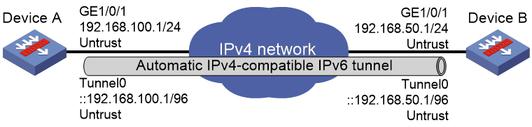

Figure 5 Network diagram
1.     Configure Device A:
# Assign an IP address to interface GigabitEthernet 1/0/1.
<DeviceA> system-view
[DeviceA-GigabitEthernet1/0/1] ip address 192.168.100.1 255.255.255.0
[DeviceA-GigabitEthernet1/0/1] quit
# Create an automatic IPv4-compatible IPv6 tunnel interface.
[DeviceA] interface tunnel 0 mode ipv6-ipv4 auto-tunnel
[DeviceA-Tunnel0] ipv6 address ::192.168.100.1/96
[DeviceA-Tunnel0] source gigabitethernet 1/0/1
# Configure settings for routing. This example configures a static route, and the next hop in the route is 192.168.100.2.
[DeviceA] ip route-static 192.168.50.1 24 192.168.100.2
# Add interfaces to security zone Untrust.
[DeviceA] security-zone name Untrust
[DeviceA-security-zone-Untrust] import interface Tunnel 0
[DeviceA-security-zone-Untrust] import interface gigabitethernet 1/0/1
[DeviceA-security-zone-Untrust] quit
# Configure a rule named tunnellocalout in the IPv4 security policy to allow Device A to send packets to Device B.
[DeviceA] security-policy ip
[DeviceA-security-policy-ip] rule name tunnellocalout
[DeviceA-security-policy-ip-1-tunnellocalout] source-zone local
[DeviceA-security-policy-ip-1-tunnellocalout] destination-zone untrust
[DeviceA-security-policy-ip-1-tunnellocalout] source-ip-host 192.168.100.1
[DeviceA-security-policy-ip-1-tunnellocalout] destination-ip-host 192.168.50.1
[DeviceA-security-policy-ip-1-tunnellocalout] action pass
[DeviceA-security-policy-ip-1-tunnellocalout] quit
[DeviceA-security-policy-ip] quit
# Configure a rule named tunnellocalout in the IPv6 security policy to allow Device A to send packets to Device B.
[DeviceA] security-policy ipv6
[DeviceA-security-policy-ipv6] rule name tunnellocalout
[DeviceA-security-policy-ipv6-1-tunnellocalout] source-zone local
[DeviceA-security-policy-ipv6-1-tunnellocalout] destination-zone untrust
[DeviceA-security-policy-ipv6-1-tunnellocalout] source-ip-host ::192.168.100.1
[DeviceA-security-policy-ipv6-1-tunnellocalout] destination-ip-host ::192.168.50.1
[DeviceA-security-policy-ipv6-1-tunnellocalout] action pass
[DeviceA-security-policy-ipv6-1-tunnellocalout] quit
[DeviceA-security-policy-ipv6] quit
# Configure a rule named tunnellocalin in the IPv4 security policy to allow Device A to receive the packets sent from Device B.
[DeviceA-security-policy-ip] rule name tunnellocalin
[DeviceA-security-policy-ip-2-tunnellocalin] source-zone untrust
[DeviceA-security-policy-ip-2-tunnellocalin] destination-zone local
[DeviceA-security-policy-ip-2-tunnellocalin] source-ip-host 192.168.50.1
[DeviceA-security-policy-ip-2-tunnellocalin] destination-ip-host 192.168.100.1
[DeviceA-security-policy-ip-2-tunnellocalin] action pass
[DeviceA-security-policy-ip-2-tunnellocalin] quit
# Configure a rule named tunnellocalin in the IPv6 security policy to allow Device A to receive the packets sent from Device B.
[DeviceA-security-policy-ipv6] rule name tunnellocalin
[DeviceA-security-policy-ipv6-2-tunnellocalin] source-zone untrust
[DeviceA-security-policy-ipv6-2-tunnellocalin] destination-zone local
[DeviceA-security-policy-ipv6-2-tunnellocalin] source-ip-host ::192.168.50.1
[DeviceA-security-policy-ipv6-2-tunnellocalin] destination-ip-host ::192.168.100.1
[DeviceA-security-policy-ipv6-2-tunnellocalin] action pass
[DeviceA-security-policy-ipv6-2-tunnellocalint] quit

Example: Configuring a 6to4 tunnel
As shown in Figure 6, configure a 6to4 tunnel between 6to4 devices Device A and Device B so the two hosts can reach each other over the IPv4 network.
Figure 6 Network diagram
Analysis
To enable communication between 6to4 networks, configure 6to4 addresses for 6to4 devices and hosts in the 6to4 networks.
·     The IPv4 address of GigabitEthernet 1/0/2 on Device A is 2.1.1.1/24, and the corresponding 6to4 prefix is 2002:0201:0101::/48. Host A must use this prefix.
·     The IPv4 address of GigabitEthernet 1/0/2 on Device B is 5.1.1.1/24, and the corresponding 6to4 prefix is 2002:0501:0101::/48. Host B must use this prefix.

Example: Configuring 6to4 relay
As shown in Figure 7, Device A is a 6to4 device, and 6to4 addresses are used on the connected IPv6 network. Device B acts as a 6to4 relay device and is connected to an IPv6 network (2001::/16). Configure a 6to4 tunnel between Device A and Device B to make Host A and Host B reachable to each other.
The configuration on a 6to4 relay device is similar to that on a 6to4 device. However, to enable communication between the 6to4 network and the IPv6 network, you must configure a route to the IPv6 network on the 6to4 device. The IPv4 address of GigabitEthernet 1/0/2 on the relay device is 6.1.1.1/24 and its corresponding 6to4 prefix is 2002:0601:0101::/48. The next hop of the static route must be an address using this prefix.
Figure 7 Network diagram

Example: Configuring an ISATAP tunnel
As shown in Figure 8, configure an ISATAP tunnel between the device and the ISATAP host so the ISATAP host in the IPv4 network can access the IPv6 network.
Figure 8 Network diagram
1.     Configure the device:
# Assign IP addresses to interfaces GigabitEthernet 1/0/1 and GigabitEthernet 1/0/2.
<Device> system-view
[Device-GigabitEthernet1/0/1] ip address 1.1.1.1 8
[Device] interface gigabitethernet 1/0/2
[Device-GigabitEthernet1/0/2] ipv6 address 3001::1/64
[Device-GigabitEthernet1/0/2] quit
# Create ISATAP tunnel interface Tunnel 0.
[Device] interface tunnel 0 mode ipv6-ipv4 isatap
[Device-Tunnel0] ipv6 address 2001:: 64 eui-64
[Device-Tunnel0] source gigabitethernet 1/0/1
[Device-Tunnel0] undo ipv6 nd ra halt
[Device-Tunnel0] quit
# Add interfaces to security zones.
[Device] security-zone name Untrust
[Device-security-zone-Untrust] import interface Tunnel 0
[Device-security-zone-Untrust] import interface gigabitethernet 1/0/1

2.     Configure the ISATAP host:
Settings on the ISATAP host vary by operating system. The following configuration is performed on Windows XP.
# Install IPv6.
C:\>ipv6 install
# On a host running Windows XP, the ISATAP interface is typically interface 2. Display information about the ISATAP interface.
C:\>ipv6 if 2
Interface 2: Automatic Tunneling Pseudo-Interface
  Guid {48FCE3FC-EC30-E50E-F1A7-71172AEEE3AE}
  does not use Neighbor Discovery
  does not use Router Discovery
  routing preference 1
  EUI-64 embedded IPv4 address: 0.0.0.0
  router link-layer address: 0.0.0.0
  preferred link-local fe80::5efe:1.1.1.2, life infinite
  link MTU 1280 (true link MTU 65515)
  current hop limit 128
  reachable time 42500ms (base 30000ms)
  retransmission interval 1000ms
  DAD transmits 0
  default site prefix length 48
# Specify an IPv4 address for the ISATAP device.
C:\>netsh interface ipv6 isatap set router 1.1.1.1
# Display information about the ISATAP interface.
C:\>ipv6 if 2
  uses Router Discovery
  EUI-64 embedded IPv4 address: 1.1.1.2
  router link-layer address: 1.1.1.1
  preferred global 2001::5efe:1.1.1.2, life 29d23h59m46s/6d23h59m46s (public)
  link MTU 1500 (true link MTU 65515)
  current hop limit 255
  DAD transmits 0
The host has obtained the prefix 2001::/64 and has automatically generated the global unicast address 2001::5efe:1.1.1.2. The message "uses Router Discovery" indicates that the router discovery feature is enabled on the host.
# Display information about IPv6 routes on the host.
C:\>ipv6 rt
2001::/64 -> 2 pref 1if+8=9 life 29d23h59m43s (autoconf)
::/0 -> 2/fe80::5efe:1.1.1.1 pref 1if+256=257 life 29m43s (autoconf)
3.     On the IPv6 host, configure a route to the ISATAP device.
C:\>netsh interface ipv6 set route 2001::/64 5 3001::1
# Verify that the ISATAP host can ping the IPv6 host.
C:\>ping 3001::2
Pinging 3001::2 with 32 bytes of data:
Reply from 3001::2: time=1ms
Ping statistics for 3001::2:
Enabling dropping IPv6 packets that use IPv4-compatible IPv6 addresses
Automatic IPv4-compatible IPv6 tunnels do not support this feature.

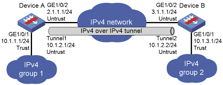

IPv4 over IPv4 tunneling
About IPv4 over IPv4 tunneling
IPv4 over IPv4 tunneling (RFC 1853) enables isolated IPv4 networks to communicate. For example, an IPv4 over IPv4 tunnel can connect isolated private IPv4 networks over a public IPv4 network.
Figure 9 IPv4 over IPv4 tunnel
Figure 9 shows the encapsulation and de-encapsulation processes.
·     Encapsulation:
a.     Device A receives an IP packet from an IPv4 host and submits it to the IP protocol stack.
b.     The IPv4 protocol stack determines how to forward the packet according to the destination address in the IP header. If the packet is destined for the IPv4 host connected to Device B, Device A delivers the packet to the tunnel interface.
c.     The tunnel interface adds a new IPv4 header to the IPv4 packet and submits it to the IP protocol stack.
In the new header, the source IP address specifies the tunnel source, and the destination IP address specifies the tunnel destination.
d.     The IP protocol stack uses the destination IP address of the new IP header to look up the routing table, and then sends the packet out.
·     De-encapsulation:
a.     After receiving the packet, Device B delivers it to the IP protocol stack.
b.     If the protocol number is 4 (indicating an IPv4 packet is encapsulated within the packet), the IP protocol stack delivers the packet to the tunnel module for de-encapsulation.
c.     The tunnel module de-encapsulates the IP packet and sends it back to the IP protocol stack.
d.     The protocol stack forwards the de-encapsulated packet.
Restrictions and guidelines: IPv4 over IPv4 tunnel configuration
Follow these guidelines when you configure an IPv4 over IPv4 tunnel:
·     The tunnel destination address specified on the local device must be identical with the tunnel source address specified on the tunnel peer device.
·     Do not specify the same tunnel source and destination addresses for tunnels of the same tunnel mode.
·     The IPv4 address of the local tunnel interface cannot be on the same subnet as the destination address configured on the tunnel interface.
·     To ensure correct packet forwarding, identify whether the destination IPv4 network and the IPv4 address of the local tunnel interface are on the same subnet. If they are not, configure a route reaching the destination IPv4 network through the tunnel interface. You can configure the route by using one of the following methods:
¡     Configure a static route, and specify the local tunnel interface as the egress interface or specify the IPv4 address of the peer tunnel interface as the next hop.
¡     Enable a dynamic routing protocol on both the local and remote tunnel interfaces.
For more information about route configuration, see Layer 3—IP Routing Configuration Guide.
·     The destination address of the route passing the tunnel interface cannot be on the same subnet as the destination address configured on the tunnel interface.
Configuring an IPv4 over IPv4 tunnel
2.     Enter IPv4 over IPv4 tunnel interface view.
interface tunnel number [ mode ipv4-ipv4 ]
3.     Configure an IPv4 address for the tunnel interface.
ip address ip-address { mask | mask-length } [ sub ]
4.     Configure a source address or source interface for the tunnel.
source { ipv4-address | interface-type interface-number }
By default, no source address or source interface is configured for a tunnel.
If you specify a source address, it is used as the source IP address of tunneled packets.
If you specify a source interface, the primary IP address of this interface is used as the source IP address of tunneled packets.
5.     Configure a destination address for the tunnel.
destination ipv4-address
By default, no destination address is configured for a tunnel.
The tunnel destination address must be the IP address of the receiving interface on the tunnel peer. It is used as the destination IP address of tunneled packets.
6.     (Optional.) Set the DF bit for tunneled packets.
tunnel dfbit enable
By default, the DF bit is not set for tunneled packets.
IPv4 over IPv4 tunnel configuration examples
Example: Configuring an IPv4 over IPv4 tunnel
As shown in Figure 10, the two subnets IPv4 group 1 and IPv4 group 2 use private IPv4 addresses. Configure an IPv4 over IPv4 tunnel between Device A and Device B to make the two subnets reachable to each other.
Figure 10 Network diagram
# Assign an IP addresse to interface GigabitEthernet 1/0/1.
[DeviceA-GigabitEthernet1/0/1] ip address 10.1.1.1 24
# Create IPv4 over IPv4 tunnel interface Tunnel 1.
[DeviceA] interface tunnel 1 mode ipv4-ipv4
[DeviceA-Tunnel1] ip address 10.1.2.1 255.255.255.0
[DeviceA-Tunnel1] source 2.1.1.1
[DeviceA-Tunnel1] destination 3.1.1.1
[DeviceA-Tunnel1] quit
# Configure settings for routing. This example configures static routes. In the routes, the output interface is Tunnel 1 and the next hop is 2.1.1.2.
[DeviceA] ip route-static 3.1.1.1 24 2.1.1.2
[DeviceA] ip route-static 10.1.3.0 24 tunnel 1
[DeviceA-security-zone-Untrust] import interface tunnel 1
[DeviceA-security-zone-Untrust] import interface gigabitethernet 1/0/2
[DeviceA] security-zone name Trust
[DeviceA-security-zone-Trust] import interface gigabitethernet 1/0/1
[DeviceA-security-zone-Trust] quit
[DeviceA-security-policy-ip-1-tunnellocalout] source-ip-host 2.1.1.1
[DeviceA-security-policy-ip-1-tunnellocalout] destination-ip-host 3.1.1.1
# Configure a rule named trust-untrust in the IPv4 security policy to permit the packets from IPv4 group 1 to IPv4 group 2.
[DeviceA-security-policy-ip] rule name trust-untrust
[DeviceA-security-policy-ip-2-trust-untrust] source-zone trust
[DeviceA-security-policy-ip-2-trust-untrust] destination-zone untrust
[DeviceA-security-policy-ip-2-trust-untrust] source-ip-subnet 10.1.1.0 24
[DeviceA-security-policy-ip-2-trust-untrust] destination-ip-subnet 10.1.3.0 24
[DeviceA-security-policy-ip-2-trust-untrust] action pass
[DeviceA-security-policy-ip-2-trust-untrust] quit
[DeviceA-security-policy-ip-3-tunnellocalin] source-zone untrust
[DeviceA-security-policy-ip-3-tunnellocalin] destination-zone local
[DeviceA-security-policy-ip-3-tunnellocalin] source-ip-host 3.1.1.1
[DeviceA-security-policy-ip-3-tunnellocalin] destination-ip-host 2.1.1.1
[DeviceA-security-policy-ip-3-tunnellocalin] action pass
[DeviceA-security-policy-ip-3-tunnellocalin] quit
# Configure a rule named untrust-trust in the IPv4 security policy to permit the packets from IPv4 group 2 to IPv4 group 1.
[DeviceA-security-policy-ip] rule name untrust-trust
[DeviceA-security-policy-ip-4-untrust-trust] source-zone untrust
[DeviceA-security-policy-ip-4-untrust-trust] destination-zone trust
[DeviceA-security-policy-ip-4-untrust-trust] source-ip-subnet 10.1.3.0 24
[DeviceA-security-policy-ip-4-untrust-trust] destination-ip-subnet 10.1.1.0 24
[DeviceA-security-policy-ip-4-untrust-trust] action pass
[DeviceA-security-policy-ip-4-untrust-trust] quit
2.     Configure Device B:
<DeviceB> system-view
[DeviceB-GigabitEthernet1/0/1] ip address 10.1.3.1 24
[DeviceB-GigabitEthernet1/0/1] quit
# Create IPv4 over IPv4 tunnel interface Tunnel 2.
[DeviceB] interface tunnel 2 mode ipv4-ipv4
[DeviceB-Tunnel2] ip address 10.1.2.2 255.255.255.0
[DeviceB-Tunnel2] source 3.1.1.1
[DeviceB-Tunnel2] destination 2.1.1.1
[DeviceB-Tunnel2] quit
# Configure settings for routing. This example configures static routes. In the routes, the output interface is Tunnel 2 and the next hop is 3.1.1.2.
[DeviceB] ip route-static 2.1.1.1 24 3.1.1.2
[DeviceB] ip route-static 10.1.1.0 24 tunnel 2
[DeviceB] security-zone name Untrust
[DeviceB-security-zone-Untrust] import interface tunnel 2
[DeviceB-security-zone-Untrust] import interface gigabitethernet 1/0/2
[DeviceB-security-zone-Untrust] quit
[DeviceB] security-zone name Trust
[DeviceB-security-zone-Trust] import interface gigabitethernet 1/0/1
[DeviceB-security-zone-Trust] quit
# Configure a rule named tunnellocalout in the IPv4 security policy to allow Device B to send packets to Device A.
[DeviceB] security-policy ip
[DeviceB-security-policy-ip] rule name tunnellocalout
[DeviceB-security-policy-ip-1-tunnellocalout] source-zone local
[DeviceB-security-policy-ip-1-tunnellocalout] destination-zone untrust
[DeviceB-security-policy-ip-1-tunnellocalout] source-ip-host 3.1.1.1
[DeviceB-security-policy-ip-1-tunnellocalout] destination-ip-host 2.1.1.1
[DeviceB-security-policy-ip-1-tunnellocalout] action pass
[DeviceB-security-policy-ip-1-tunnellocalout] quit
# Configure a rule named trust-untrust in the IPv4 security policy to permit the packets from IPv4 group 2 to IPv4 group 1.

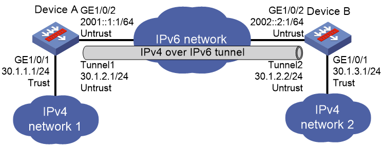

IPv4 over IPv6 tunneling
About IPv4 over IPv6 tunneling
Implementation
IPv4 over IPv6 tunneling adds an IPv6 header to IPv4 packets so that the IPv4 packets can pass an IPv6 network through a tunnel to realize interworking between isolated IPv4 networks.
Figure 11 IPv4 over IPv6 tunnel
Figure 11 shows the encapsulation and de-encapsulation processes.

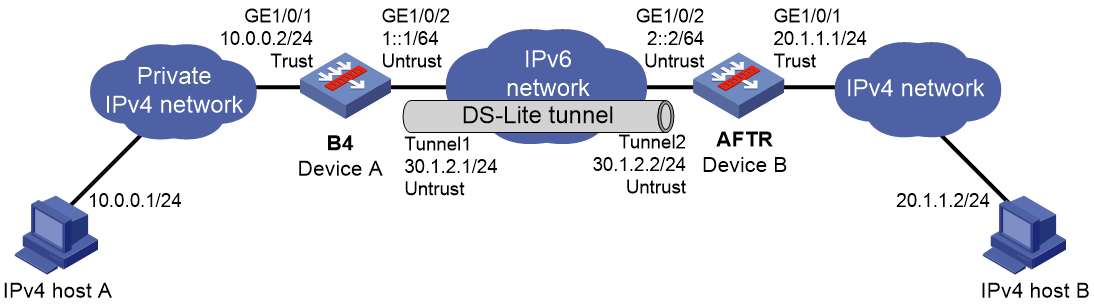

DS-Lite tunnel
Dual Stack Lite (DS-Lite) is a combination of the tunneling and NAT technologies. NAT translates the private IPv4 addresses of the IPv4 hosts before the hosts reach the IPv4 public network.
DS-Lite tunnel supports only an IPv4 host in a private network initiating communication with an IPv4 host on the Internet. It does not support an IPv4 host on the Internet initiating communication with an IPv4 host in a private network.
Figure 12 DS-Lite tunnel
As shown in Figure 12, the DS-Lite feature contains the following components:
·     Basic Bridging BroadBand (B4) element
The B4 element is typically a CPE router that connects end hosts. IPv4 packets entering the B4 router are encapsulated into IPv6 packets and sent to the AFTR. IPv6 packets from the AFTR are de-encapsulated into IPv4 packets and sent to the subscriber's network.
Hosts that can act as the B4 router are referred to as DS-Lite hosts.
·     Address Family Transition Router (AFTR)
An AFTR resides in the ISP network and terminates the tunnel from the B4 router. NAT is also implemented on the interface that is connected to the public IPv4 network.
An AFTR de-encapsulates the tunneled packet, translates the network address, and routes the packet to the destination IPv4 network. For IPv4 packets coming from the public IPv4 network, the AFTR performs reverse address translation and sends them to the B4 router by using the DS-Lite tunnel.
Figure 13 Packet forwarding process in DS-Lite
As shown in Figure 13, the packet forwarding process in DS-Lite is as follows:
1.     Upon receiving a packet from the private IPv4 network, the B4 router adds an IPv6 header to the packet and sends the IPv6 packet to the AFTR through the tunnel.
2.     The AFTR performs the following operations:
a.     Removes the IPv6 header from the tunneled packet.
b.     Assigns a tunnel ID for the B4 router.
c.     Records the mapping between the IPv6 address of the B4 router (the source IPv6 address of the packet), and the tunnel ID.
3.     After de-encapsulation, the AFTR translates the source private IPv4 address of the packet into a public IPv4 address and sends the packet to the destination IPv4 host. The AFTR also maps the NAT entries to the tunnel ID so that IPv4 networks connected to different B4 routers can use the same address space.
4.     Upon receiving the response packet from the public network, the AFTR translates the destination public IPv4 address into the private IPv4 address. The AFTR performs the following operations:
a.     Looks up the IPv6 address-tunnel ID mapping to obtain the IP address of the B4 router.
b.     Uses the address as the destination address of the encapsulated IPv6 packet.
c.     Forwards the packet to the B4 router.
Figure 13 shows an example of PAT translation for dynamic NAT. Typically, dynamic NAT is used. When you use static NAT for DS-Lite tunneling, make sure the IP addresses of private IPv4 networks connected to different B4 routers do not overlap. For more information about NAT, see NAT Configuration Guide.

As shown in Figure 14, configure an IPv4 over IPv6 manual tunnel between Device A and Device B so the two networks can reach each other over the IPv6 network.
Figure 14 Network diagram

Example: Configuring a DS-Lite tunnel
As shown in Figure 15, to enable hosts in the private IPv4 network to access the public IPv4 network over the IPv6 network, perform the following tasks:
·     Configure a DS-Lite tunnel between Device A and Device B.
·     Configure NAT on GigabitEthernet 1/0/1 on the AFTR.
Figure 15 Network diagram
[DeviceA-GigabitEthernet1/0/1] ip address 10.0.0.2 24
[DeviceA] interface gigabitethernet 1/0/2
[DeviceA-GigabitEthernet1/0/2] ipv6 address 1::1 64
[DeviceA-GigabitEthernet1/0/2] quit
# Create IPv6 tunnel interface Tunnel 1.
[DeviceA] interface tunnel 1 mode ipv6
[DeviceA-Tunnel1] ip address 30.1.2.1 255.255.255.0
[DeviceA-Tunnel1] source 1::1
[DeviceA-Tunnel1] destination 2::2
# Configure settings for routing. This example configures static routes. In the routes, the output interface is Tunnel 1 and the next hop is 1::2.
[DeviceA] ipv6 route-static 2002::2:1 64 1::2
[DeviceA] ip route-static 20.1.1.0 24 tunnel 1
[DeviceA-security-policy-ipv6-1-tunnellocalout] source-ip-host 1::1
[DeviceA-security-policy-ipv6-1-tunnellocalout] destination-ip-host 2::2
# Configure a rule named trust-untrust in the IPv4 security policy to permit the packets from IPv4 host A to IPv4 host B.
[DeviceA-security-policy-ip-1-trust-untrust] source-zone trust
[DeviceA-security-policy-ip-1-trust-untrust] destination-zone untrust
[DeviceA-security-policy-ip-1-trust-untrust] source-ip-subnet 10.0.0.0 24
[DeviceA-security-policy-ip-1-trust-untrust] destination-ip-subnet 20.1.1.0 24
[DeviceA-security-policy-ip-1-trust-untrust] action pass
[DeviceA-security-policy-ip-1-trust-untrust] quit
[DeviceA-security-policy-ipv6-2-tunnellocalin] source-ip-host 2::2
[DeviceA-security-policy-ipv6-2-tunnellocalin] destination-ip-host 1::1
[DeviceA-security-policy-ipv6-2-tunnellocalin] quit
# Configure a rule named untrust-trust in the IPv4 security policy to permit the packets from IPv4 host B to IPv4 host A.
[DeviceA-security-policy-ip-2-untrust-trust] source-zone untrust
[DeviceA-security-policy-ip-2-untrust-trust] destination-zone trust
[DeviceA-security-policy-ip-2-untrust-trust] source-ip-subnet 20.1.1.0 24
[DeviceA-security-policy-ip-2-untrust-trust] destination-ip-subnet 10.0.0.0 24
[DeviceA-security-policy-ip-2-untrust-trust] action pass
[DeviceA-security-policy-ip-2-untrust-trust] quit
[DeviceB-GigabitEthernet1/0/1] ip address 20.1.1.1 24
[DeviceB] interface gigabitethernet 1/0/2
[DeviceB-GigabitEthernet1/0/2] ipv6 address 2::2 64
[DeviceB-GigabitEthernet1/0/2] quit
# Create DS-Lite tunnel interface Tunnel 2.
[DeviceB] interface tunnel 2 mode ds-lite-aftr
[DeviceB-Tunnel2] ip address 30.1.2.2 255.255.255.0
[DeviceB-Tunnel2] source gigabitethernet 1/0/2
# Enable DS-Lite tunneling on GigabitEthernet 1/0/1.
[DeviceB-GigabitEthernet1/0/1] ds-lite enable
# Enable NAT on GigabitEthernet 1/0/1 and use the IP address of GigabitEthernet 1/0/1 as the translated address.
[DeviceB-GigabitEthernet1/0/1] nat outbound
# Configure settings for routing. This example configures a static route, and the next hop in the route is 2::3.
[DeviceB] ipv6 route-static 1::1 64 2::3
# Configure a rule named tunnellocalout in the IPv6 security policy to allow Device B to send packets to Device A.
[DeviceB] security-policy ipv6
[DeviceB-security-policy-ipv6] rule name tunnellocalout
[DeviceB-security-policy-ipv6-1-tunnellocalout] source-zone local
[DeviceB-security-policy-ipv6-1-tunnellocalout] destination-zone untrust
[DeviceB-security-policy-ipv6-1-tunnellocalout] source-ip-host 2::2
[DeviceB-security-policy-ipv6-1-tunnellocalout] destination-ip-host 1::1
[DeviceB-security-policy-ipv6-1-tunnellocalout] action pass
[DeviceB-security-policy-ipv6-1-tunnellocalout] quit
[DeviceB-security-policy-ipv6] quit
# Configure a rule named trust-untrust in the IPv4 security policy to permit the packets from IPv4 host B to IPv4 host A.
[DeviceB-security-policy-ip] rule name trust-untrust
[DeviceB-security-policy-ip-2-trust-untrust] source-zone trust
[DeviceB-security-policy-ip-2-trust-untrust] destination-zone untrust
[DeviceB-security-policy-ip-2-trust-untrust] source-ip-subnet 20.1.1.0 24
[DeviceB-security-policy-ip-2-trust-untrust] destination-ip-subnet 10.0.0.0 24
[DeviceB-security-policy-ip-2-trust-untrust] action pass
[DeviceB-security-policy-ip-2-trust-untrust] quit
[DeviceB-security-policy-ip] quit
# Configure a rule named tunnellocalin in the IPv6 security policy to allow Device B to receive the packets sent from Device A.
[DeviceB-security-policy-ipv6] rule name tunnellocalin
[DeviceB-security-policy-ipv6-3-tunnellocalin] source-zone untrust
[DeviceB-security-policy-ipv6-3-tunnellocalin] destination-zone local
[DeviceB-security-policy-ipv6-3-tunnellocalin] source-ip-host 1::1
[DeviceB-security-policy-ipv6-3-tunnellocalin] destination-ip-host 2::2
[DeviceB-security-policy-ipv6-3-tunnellocalin] action pass
[DeviceB-security-policy-ipv6-3-tunnellocalin] quit
# Configure a rule named untrust-trust in the IPv4 security policy to permit the packets from IPv4 host A to IPv4 host B.
[DeviceB-security-policy-ip] rule name untrust-trust
[DeviceB-security-policy-ip-4-untrust-trust] source-zone untrust
[DeviceB-security-policy-ip-4-untrust-trust] destination-zone trust
[DeviceB-security-policy-ip-4-untrust-trust] source-ip-subnet 10.0.0.0 24
[DeviceB-security-policy-ip-4-untrust-trust] destination-ip-subnet 20.1.1.0 24
[DeviceB-security-policy-ip-4-untrust-trust] action pass
[DeviceB-security-policy-ip-4-untrust-trust] quit
3.     On host A, specify the IP address for the host as 10.0.0.1 and configure a static route to 20.1.1.0/24 with next hop 10.0.0.2. (Details not shown.)
4.     On host B, specify the IP address for the host as 20.1.1.2. (Details not shown.)
# Use the display interface tunnel command to display the status of the tunnel interfaces on Device A and Device B. Verify that the tunnel interfaces are up. (Details not shown.)
