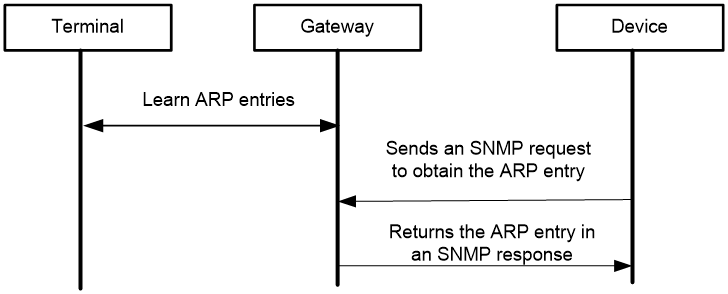

Working mechanism
Figure 1 MAC address learning through a Layer device workflow
As shown in Figure 1, MAC address learning through a Layer 3 device proceeds as follows:
1.     The gateway learns the IP-MAC binding of the terminal, and then generates an ARP entry.
2.     The device sends SNMP requests to the gateway at the specified intervals to request the ARP entry.
3.     The gateway sends a response that contains the ARP entry to the device.
4.     Upon receiving the response, the device saves the ARP entry in the memory. Then it can learn the MAC address of the terminal.

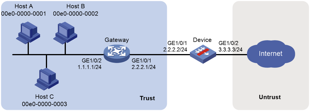

Example: Configuring MAC address learning through a Layer 3 device
As shown in Figure 2, hosts in an internal network are connected to the device through a Layer 3 gateway and the device is connected to the Internet.
·     Configure MAC address learning through a Layer 3 device to ensure that the device can learn the MAC addresses of the hosts through the gateway.
·     Configure security policies by using the learned MAC addresses to allow only Host A and Host B to access the Internet.
Figure 2 Network diagram
1.     Configure the gateway:
# Specify an IP address for each interface and configure routing features to ensure network reachability. (Details not shown.)
# Configure SNMPv2c, and create the read-only community with the plaintext form name public.
<Gateway> system-view
[Gateway] snmp-agent sys-info version v2c
[Gateway] snmp-agent community read simple public
2.     Configure the device:
a.     Assign IP addresses to interfaces:
# Assign an IP address to interface GigabitEthernet 1/0/1.
<Device> system-view
[Device-GigabitEthernet1/0/1] ip address 2.2.2.2 255.255.255.0
b.     Configure settings for routing.
This example configures static routes, and the next hop in the route to the Internet is 3.3.3.1.
[Device] ip route-static 1.1.1.0 24 2.2.2.1
[Device] ip route-static 0.0.0.0 0 3.3.3.1
c.     Add interfaces to security zones.
[Device] security-zone name trust
[Device-security-zone-Trust] import interface gigabitethernet 1/0/1
[Device-security-zone-Trust] quit
[Device] security-zone name untrust
[Device-security-zone-Untrust] import interface gigabitethernet 1/0/2
[Device-security-zone-Untrust] quit
d.     Configure a security policy.
# Configure a rule named rule1 to allow the device to access the gateway.
[Device] security-policy ip
[Device-security-policy-ip] rule name rule1
[Device-security-policy-ip-0-rule1] source-zone local
[Device-security-policy-ip-0-rule1] destination-zone trust
[Device-security-policy-ip-0-rule1] source-ip-host 2.2.2.2
[Device-security-policy-ip-0-rule1] destination-ip-host 2.2.2.1
[Device-security-policy-ip-0-rule1] action pass
[Device-security-policy-ip-0-rule1] quit
# Configure a rule named rule2 to permit traffic only from MAC object group groupmac to the Internet.
[Device-security-policy-ip] rule name rule2
[Device-security-policy-ip-1-rule2] source-zone trust
[Device-security-policy-ip-1-rule2] destination-zone untrust
[Device-security-policy-ip-1-rule2] source-mac groupmac
[Device-security-policy-ip-1-rule2] action pass
[Device-security-policy-ip-1-rule2] quit
# Activate rule matching acceleration.
[Device-security-policy-ip] accelerate enhanced enable
[Device-security-policy-ip] quit
e.     Configure MAC address learning through the gateway.
Enable ARP entry synchronization through SNMP. Configure the device to synchronize ARP entries from the gateway.
[Device] snmp-server arp-sync enable
[Device] snmp-server arp-sync target-host address 2.2.2.1 community simple public v2c
[Device] snmp-server arp-sync interval 10 timeout 4
f.     Create a MAC object group named groupmac. Add Host A's MAC address 00e0-0000-0001 and Host B's MAC address 00e0-0000-0002 to the group.
[Device] object-group mac-address groupmac
[Device-obj-grp-mac-groupmac] mac 00e0-0000-0001
[Device-obj-grp-mac-groupmac] mac 00e0-0000-0002
[Device-obj-grp-mac-groupmac] quit
1.     Verify that ARP entries have been synchronized to the device.
[Device] display snmp-server arp-sync table
IP Address       MAC Address        Aging(M)
1.1.1.1          00e0-0000-0001     1
1.1.1.2          00e0-0000-0002     1
1.1.1.3          00e0-0000-0003     1
Total:3
2.     Verify that Host A and Host B can access the external network but Host C cannot.
