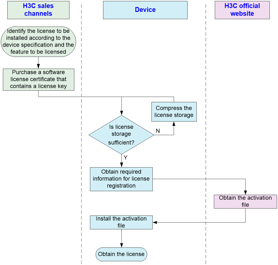

License registration and installation workflow
The procedures for installing formal licenses and trial licenses are the same, as shown in Figure 2.
This chapter only describes the operations performed on the device. For more information, see the licensing guide for the device.
Figure 2 License registration and installation workflow
Identifying the license storage
To identify the free space of the license storage, execute the following command in any view:
display license feature
From the command output, view the Total and Usage fields to examine whether the remaining license storage is sufficient for installing new licenses. If the remaining license storage is not sufficient, compress the license storage.
Compressing the license storage
The license storage stores licensing information and has a fixed size.
You can compress the license storage to delete expired license information to ensure sufficient storage space before applying for an activation file.
If no licenses have been installed on the device, you do not need to compress the license storage.
The compression operation might make the DID change. You will be unable to install the activation file obtained by using the old DID on the device. As a best practice, install all activation files registered with the old DID before performing a compression.
If you have not installed an activation file registered with the old DID, take the following actions:
·     If the license storage is sufficient, install the activation file on the device. For more information, see the license user guide.
·     If the license storage is insufficient and the activation file cannot be installed after the compression, contact H3C Support.
2.     Compress the license storage.
In standalone mode:
license compress
In IRF mode:
license compress chassis chassis-number
Obtaining required information for license registration
To obtain SN and DID information, execute the following command in any view:
In standalone mode:
display license device-id slot slot-number
In IRF mode:
display license device-id chassis chassis-number slot slot-number
Installing an activation file
CAUTION
CAUTION:
Back up an activation file before you install it. If the activation file is inadvertently deleted or becomes unavailable for some other reason, you can use the backup activation file to restore the license.
To obtain a license, install an activation file for the license on the device.
Use FTP or TFTP to upload the activation file to be installed to the device. If FTP is used to transfer the activation file, set it in binary mode.
2.     Install an activation file.
In standalone mode:
license activation-file install license-file
In IRF mode:
license activation-file install license-file chassis chassis-number
You can install a single .ak file or multiple .ak files through one operation. To install multiple .ak files, save all activation files in the same directory and specify the directory as the value of the license-file argument.
