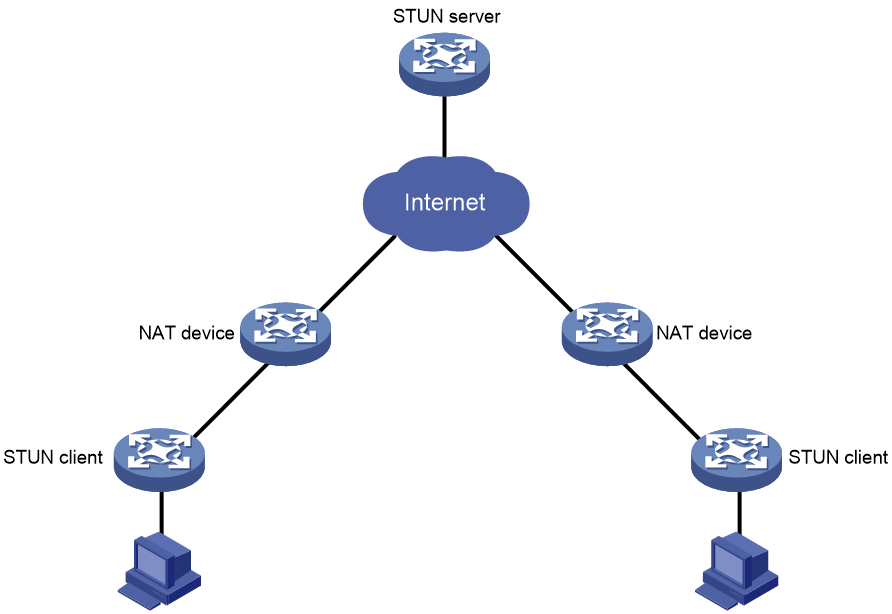

As shown in Figure 1, STUN uses a client-server model that consists of a STUN client and a STUN server.
·     STUN client—An entity that sends STUN requests and receives STUN responses.
·     STUN server—An entity that receives STUN requests and sends STUN responses. A STUN server typically resides on the public network.
The STUN server and STUN client exchange STUN packets (Binding requests and Binding responses) to detect the IP address and port number assigned by a NAT device and the NAT type.

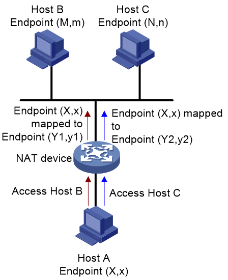

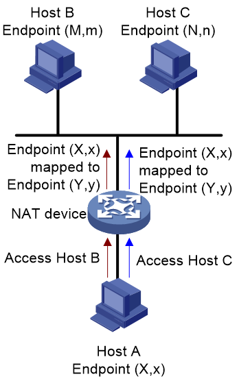

NAT mapping types
The following NAT mapping types are supported:
·     Endpoint-independent mapping (EIM)—The NAT device uses the same mapping for all packets sent from the same internal IP address and port number to any external IP address and port number. As shown in Figure 2, Endpoint (X:x) in the internal network is always mapped to Endpoint (Y:y) in the external network.
Figure 2 EIM
·     Address-dependent mapping (ADM)—The NAT device uses the same mapping for all packets sent from the same internal IP address and port number to the same external IP address, regardless of the external port number. As shown in Figure 3, Endpoint (X:x) in the internal network is mapped to Endpoint (Y1:y1) in the external network when it accesses Host B. Endpoint (X:x) in the internal network is mapped to Endpoint (Y2:y2) in the external network when it accesses Host C. Y1:y1 equals Y2:y2 as long as M equals N.
Figure 3 ADM
·     Address and port-dependent mapping (APDM)—The NAT device uses the same mapping for all packets sent from the same internal IP address and port number to the same external IP address and port number. As shown in Figure 4, Endpoint (X:x) in the internal network is mapped to Endpoint (Y1:y1) in the external network when it accesses Host B. Endpoint (X:x) in the internal network is mapped to Endpoint (Y2:y2) in the external network when it accesses Host C. Y1:y1 equals Y2:y2 if M equals N and m equals n.

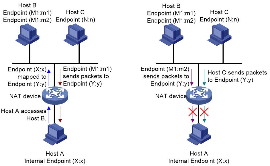

NAT filtering methods
The following NAT filtering types are supported:

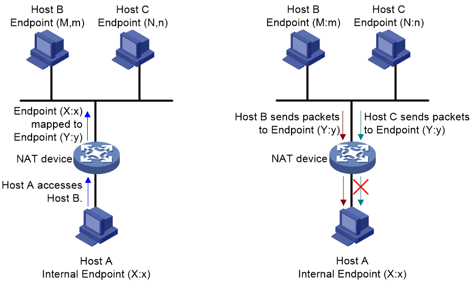

·     Endpoint-independent filtering (EIF)—As shown in Figure 5, the NAT device filters out only packets not destined to the internal IP address and port number (Endpoint (X:x), regardless of the external IP address and port source. The NAT device forwards any packets destined to X:x.
Figure 5 EIF
·     Address-dependent filtering (ADF)—As shown in Figure 6, the NAT device filters out packets not destined to the internal address X:x. Additionally, the NAT device will filter out packets from Y:y destined for the internal endpoint X:x if X:x has not sent packets to Y:any port previously (independently of the port used by Y).

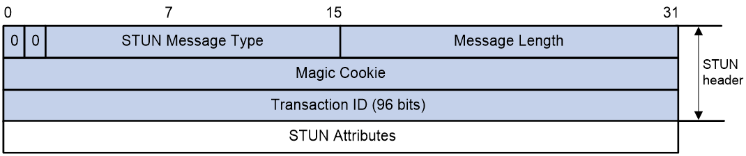

As shown in Figure 9, a STUN message starts with a 20-byte STUN header followed by zero or more STUN attributes.
Figure 9 STUN message structure
As shown in Figure 10, a STUN message starts with a 20-byte STUN header followed by zero or more STUN attributes.
Figure 10 STUN message structure

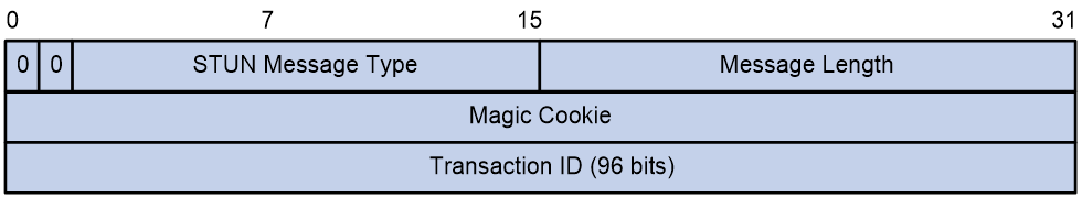

STUN header
Figure 11 shows the STUN header structure.
Figure 11 STUN header structure
A STUN header contains the following fields:
·     STUN Message Type—14-bit long and can only be Binding request or Binding response.
·     Message Length—16-bit long. The message length does not include the STUN header.
·     Magic Cookie—Contains the fixed value 0x2112A442. This field allows a server to detect if the client will understand certain attributes. In addition, it aids  in distinguishing STUN packets from packets of other protocols when STUN is multiplexed with those other protocols on the same port.
·     Transaction ID—Used to uniquely identify STUN transactions. The transaction ID is chosen by the STUN client for the request and echoed by the server in the response.

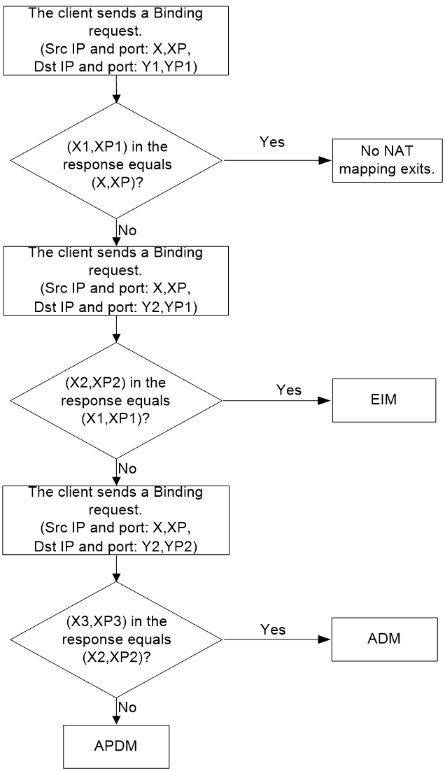

NAT mapping type detection
Suppose the IP address and port number of the STUN server is Y1:YP1, and the alternate IP address and port number of the STUN server is Y2:YP2. The IP address and port number of the STUN client is X:XP.
Figure 13 shows the process of NAT mapping type detection.
1.     The STUN client sends a Binding request with source IP address and port number Endpoint (X:XP) to Endpoint (Y1:YP1) of the STUN server. The STUN server uses Endpoint (Y1:YP1) to send a Binding response to the STUN client. The Binding response includes the mapped Endpoint (X1:XP1) and another Endpoint (Y2:YP2) of the STUN server.
2.     After receiving the Binding response, the STUN client checks whether Endpoint (X1:XP1) equals Endpoint (X:XP).
¡     If yes, the client considers that no mapping exists.
¡     If not, the client detects the mapping type as described in step 3.
3.     The STUN client uses Endpoint (X:XP) to send a Binding request to Endpoint (Y2,YP1) of the STUN server. The STUN server uses Endpoint (Y2,YP1) to send a Binding response to the STUN client. The Binding response includes the mapped Endpoint (X2:XP2) of the STUN client.
4.     After receiving the Binding response, the STUN client checks whether Endpoint (X2:XP2) equals Endpoint (X1:XP1) in step 1.
¡     If yes, the client considers that the mapping type is EIM.
¡     If not, the client detects the mapping type as described in step 5.
5.     The STUN client uses Endpoint (X:XP) to send a Binding request to Endpoint (Y2:YP2) of the STUN server. The STUN server uses Endpoint (Y2:YP2) to send a Binding response to the STUN client. The Binding response includes the mapped Endpoint (X3:XP3) of the STUN client.
6.     After receiving the Binding response, the STUN client checks whether Endpoint (X3:XP3) equals Endpoint (X2:XP2) in step 3.
¡     If yes, the client considers that the mapping type is ADM.
¡     If not, the client considers that the mapping type is APDM.
Figure 13 Process of NAT mapping type detection

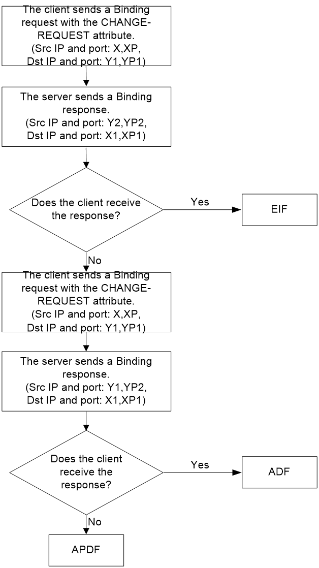

NAT filtering method detection
Figure 14 shows the process of NAT filtering method detection.
1.     The STUN client sends a Binding request with source IP address and port number Endpoint (X:XP) to Endpoint (Y1:YP1) of the STUN server. The request includes the CHANGE-REQUEST attribute, which requests that the server use a different IP address and port number when sending the response. The OTHER-ADDRESS attribute in the response indicates that the alternate IP address and port number of the STUN server is Endpoint (Y2:YP2). The STUN server uses Endpoint (Y2:YP2) to send a Binding response to the STUN client.
2.     If the client receives the Binding response, it considers that the mapping type is EIM.
3.     If the client fails to receive the Binding response, it continues to detect the mapping type as described in step 3.
4.     The client uses Endpoint (X:XP) to send a Binding request to Endpoint (Y1:YP1) of the STUN server. The request includes the CHANGE-REQUEST attribute, which requests that the server use a different IP address and port number when sending the response. The OTHER-ADDRESS attribute in the response indicates that the alternate port number of the STUN server is YP2. The STUN server uses Endpoint (Y1,YP2) to send a Binding response to the client.
5.     If the client receives the Binding response, it considers that the mapping type is ADF.
6.     If the client fails to receive the Binding response, it considers that the mapping type is APDF.
Figure 14 Process of NAT filtering method detection

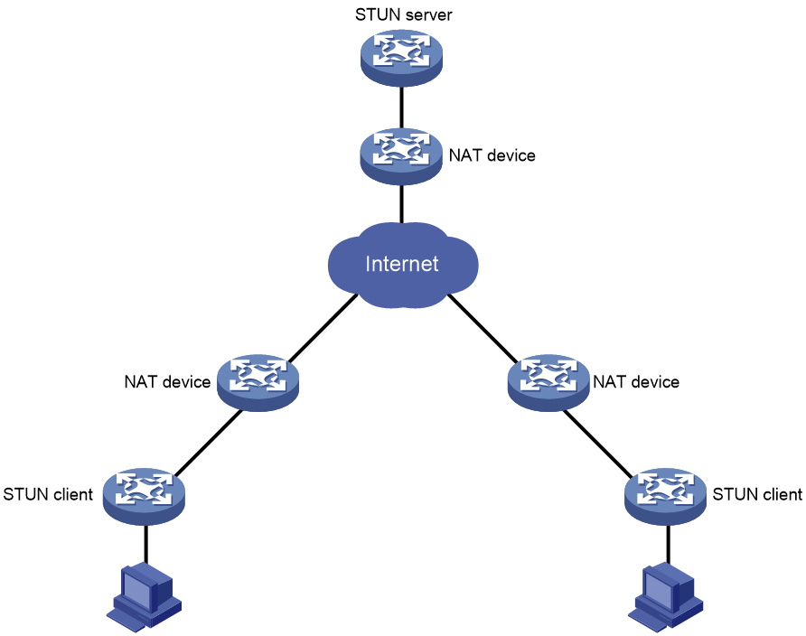

STUN server deployment in private networks
Typically, a STUN server is deployed in a public network. After receiving a Binding request from a STUN client, a STUN server sends a Binding response with the IP address in its payload as the public address of the STUN server. If a STUN server is deployed in a private network, the IP address in the Binding response is the private address of the STUN server. When receiving a subsequent Binding request, the STUN server-side NAT device will not translate the private address in the request to a public address. For STUN to work correctly in this case, perform the following tasks:
·     On the STUN server, specify the IP address and alternate IP address of the STUN server after NAT.
·     Use one-to-one NAT mapping rule on the NAT device.
In this manner, STUN clients will not sense the private address of the STUN server and uses the public address of the STUN server for communication. The STUN server will still use its public address in Binding responses.
Figure 15 STUN server deployment in a private network
