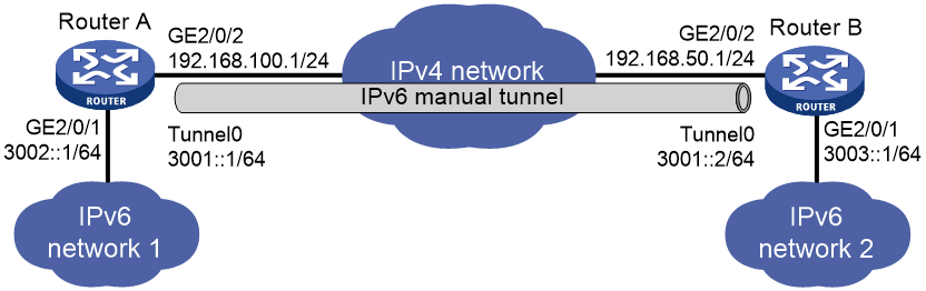

IPv6 over IPv4 manual tunneling
An IPv6 over IPv4 manual tunnel is a point-to-point link. To establish a manual tunnel, you must manually configure the source and destination addresses of the tunnel at both ends of the tunnel.
Manual tunneling provides the following solutions:
·     Connects isolated IPv6 networks over an IPv4 network.
·     Connects an IPv6 network and an IPv4/IPv6 dual-stack host over an IPv4 network.

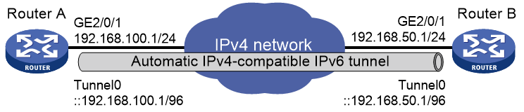

Automatic IPv4-compatible IPv6 tunneling
An automatic IPv4-compatible IPv6 tunnel is a point-to-multipoint link. The ends of an automatic IPv4-compatible IPv6 tunnel are IPv4-compatible IPv6 addresses. The address format is 0:0:0:0:0:0:a.b.c.d/96, where a.b.c.d is an IPv4 address. The destination IPv4 address of an automatic IPv4-compatible IPv6 tunnel is embedded in the destination IPv4-compatible IPv6 address. This mechanism enables the device to automatically obtain the tunnel destination address.
Automatic IPv4-compatible IPv6 tunnels have limitations because IPv4-compatible IPv6 addresses must use globally unique IPv4 addresses.

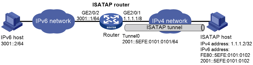

ISATAP tunneling
An ISATAP tunnel is a point-to-multipoint automatic tunnel. It provides a solution to connect an IPv6 host and an IPv6 network over an IPv4 network.
The destination address of an ISATAP tunnel is an ISATAP address. The address format is prefix:0:5EFE:abcd:efgh/64.
·     The 64-bit prefix is a valid IPv6 unicast address prefix.
·     The abcd:efgh/64 segments represent a 32-bit IPv4 address in hexadecimal notation, which identifies the tunnel destination but does not require global uniqueness.
ISATAP tunnels are mainly used for communication between IPv6 routers or between an IPv6 host and an IPv6 router over an IPv4 network.
Figure 4 Principle of ISATAP tunneling

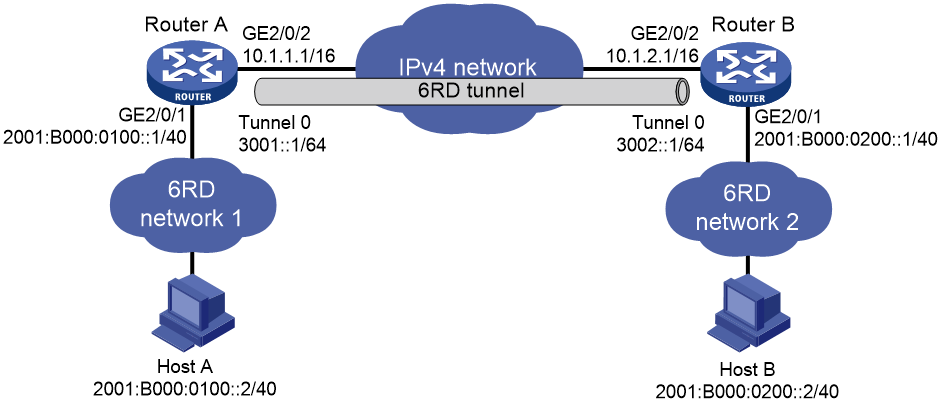

6RD tunneling
·     Ordinary 6RD tunneling
A 6RD tunnel is a point-to-multipoint automatic tunnel. It is an extension of 6to4 tunneling. The IPv6 prefix of a 6RD network is assigned by the service provider and is not limited to the prefix 2002::/16. 6RD does not require embedding all 32 bits of an IPv4 address in a 6RD address.

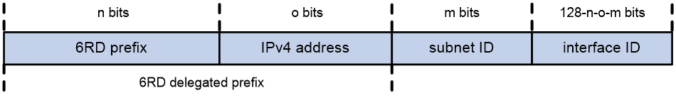

Figure 5 shows the format of 6RD address—an IPv6 address with a 6RD prefix and an embedded IPv4 address.
¡     6RD prefix—IPv6 prefix assigned by the service provider to a 6RD network.
¡     IPv4 address—All or part of the IPv4 tunnel source address in hexadecimal notation. For example, assume that the IPv4 tunnel source address is 1.2.3.4 and both the IPv4 prefix length and suffix length are specified as 8 bits. Then, the prefix of the IPv4 address 1.2.3.4 is 01, the suffix is 04, and the embedded IPv4 address is 0203.
¡     6RD delegated prefix—The 6RD prefix and the embedded IPv4 address together form a 6RD delegated prefix. It uniquely identifies a 6RD network (an IPv6 network where all hosts use 6RD addresses).
¡     Subnet ID—Identifies a subnet in the 6RD network.
¡     Interface ID—The subnet ID and the interface ID together identify a host in the 6RD network.
The device automatically identifies the tunnel destination IPv4 address according to the IPv4 address embedded in the 6RD address, the 6RD prefix, and the IPv4 prefix and suffix.
Figure 5 6RD address format

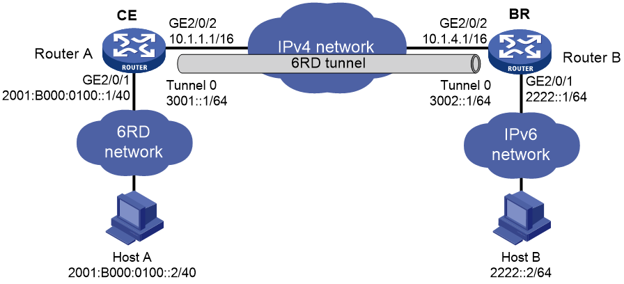

·     6RD relay
6 RD relay connects a 6RD network and an IPv6 network that uses a prefix other than a 6RD delegated prefix. A 6RD border relay (BR) router is a gateway that forwards packets from a 6RD network to an IPv6 network. The border router connected to the 6RD network is called 6RD CE.
As shown in Figure 6, for the 6RD network site 1 to communicate with the IPv6 network site 3 over a 6RD tunnel, you must configure 6RD relay. Configure a static route on the border router (Device A) in the 6RD network. The next hop address must be the 6RD address of the 6RD BR router (Device C). Device A forwards all packets destined for the IPv6 network over the 6RD tunnel, and Device C then forwards them to the IPv6 network.
Figure 6 Principle of 6RD tunneling and 6RD relay

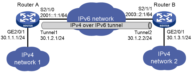

IPv4 over IPv6 tunneling
Implementation
IPv4 over IPv6 tunneling adds an IPv6 header to IPv4 packets so that the IPv4 packets can pass an IPv6 network through a tunnel to realize interworking between isolated IPv4 networks.
Figure 7 IPv4 over IPv6 tunnel
Figure 7 shows the encapsulation and de-encapsulation processes.
·     Encapsulation:
a.     Upon receiving an IPv4 packet, Device A delivers it to the IPv4 protocol stack.
b.     The IPv4 protocol stack uses the destination address of the packet to determine the egress interface. If the egress interface is the tunnel interface, the IPv4 protocol stack delivers the packet to the tunnel interface.
c.     The tunnel interface adds an IPv6 header to the original IPv4 packet and delivers the packet to the IPv6 protocol stack.
d.     The IPv6 protocol stack uses the destination IPv6 address of the packet to look up the routing table, and then sends it out.
·     De-encapsulation:
a.     Upon receiving the IPv6 packet from the attached IPv6 network, Device B delivers the packet to the IPv6 protocol stack to examine the protocol type encapsulated in the data portion of the packet.
b.     If the protocol type is IPv4, the IPv6 protocol stack delivers the packet to the tunneling module.
c.     The tunneling module removes the IPv6 header and delivers the remaining IPv4 packet to the IPv4 protocol stack.
d.     The IPv4 protocol stack forwards the IPv4 packet.

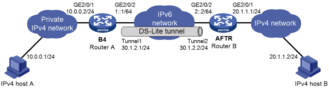

DS-Lite tunnel
Dual Stack Lite (DS-Lite) is a combination of the tunneling and NAT technologies. NAT translates the private IPv4 addresses of the IPv4 hosts before the hosts reach the IPv4 public network.
DS-Lite tunnel supports only an IPv4 host in a private network initiating communication with an IPv4 host on the Internet. It does not support an IPv4 host on the Internet initiating communication with an IPv4 host in a private network.
Figure 8 DS-Lite tunnel
As shown in Figure 8, the DS-Lite feature contains the following components:
·     Basic Bridging BroadBand (B4) element
The B4 element is typically a CPE router that connects end hosts. IPv4 packets entering the B4 router are encapsulated into IPv6 packets and sent to the AFTR. IPv6 packets from the AFTR are de-encapsulated into IPv4 packets and sent to the subscriber's network.
Hosts that can act as the B4 router are referred to as DS-Lite hosts.
·     Address Family Transition Router (AFTR)
An AFTR resides in the ISP network and terminates the tunnel from the B4 router. NAT is also implemented on the interface that is connected to the public IPv4 network.
An AFTR de-encapsulates the tunneled packet, translates the network address, and routes the packet to the destination IPv4 network. For IPv4 packets coming from the public IPv4 network, the AFTR performs reverse address translation and sends them to the B4 router by using the DS-Lite tunnel.
Figure 9 Packet forwarding process in DS-Lite
As shown in Figure 9, the packet forwarding process in DS-Lite is as follows:
1.     Upon receiving a packet from the private IPv4 network, the B4 router adds an IPv6 header to the packet and sends the IPv6 packet to the AFTR through the tunnel.
2.     The AFTR performs the following operations:
a.     Removes the IPv6 header from the tunneled packet.
b.     Assigns a tunnel ID for the B4 router.
c.     Records the mapping between the IPv6 address of the B4 router (the source IPv6 address of the packet), and the tunnel ID.
3.     After de-encapsulation, the AFTR translates the source private IPv4 address of the packet into a public IPv4 address and sends the packet to the destination IPv4 host. The AFTR also maps the NAT entries to the tunnel ID so that IPv4 networks connected to different B4 routers can use the same address space.
4.     Upon receiving the response packet from the public network, the AFTR translates the destination public IPv4 address into the private IPv4 address. The AFTR performs the following operations:

Example: Configuring an IPv6 over IPv4 manual tunnel
As shown in Figure 10, configure an IPv6 over IPv4 tunnel between Router A and Router B so the two IPv6 networks can reach each other over the IPv4 network. Because the tunnel destination IPv4 address cannot be automatically obtained from the destination IPv6 addresses, configure an IPv6 over IPv4 manual tunnel.
Figure 10 Network diagram
Make sure Router A and Router B can reach each other through IPv4.

Example: Configuring an automatic IPv4-compatible IPv6 tunnel
As shown in Figure 11, dual-stack routers Router A and Router B communicate over an IPv4 network. Configure an automatic IPv4-compatible IPv6 tunnel between the two routers to enable IPv6 communications over the IPv4 network.
Figure 11 Network diagram

Example: Configuring an ISATAP tunnel
As shown in Figure 14, configure an ISATAP tunnel between the router and the ISATAP host so the ISATAP host in the IPv4 network can access the IPv6 network.
Figure 14 Network diagram
1.     Configure the router:

Example: Configuring a 6RD tunnel
As shown in Figure 15, Host A and Host B are in different 6RD networks. Configure a 6RD tunnel between Router A and Router B so Host A and Host B can reach each other over the IPv4 network.
Figure 15 Network diagram
Analysis
To enable communication between 6RD networks, you must perform the following tasks in addition to the 6RD tunnel configuration:
·     On Router A and Router B, configure the 6RD prefix as 2001:B000::/32, the IPv4 prefix length as 16, and the IPv4 suffix length as 8.
·     Configure 6RD addresses for the routers and hosts.
¡     On Router A, the tunnel source IPv4 address is 10.1.1.1/16, the IPv4 address of GigabitEthernet 2/0/2. Calculated based on this IPv4 address, the 6RD prefix, and the IPv4 prefix and suffix lengths, the 6RD delegated prefix for 6RD network 1 is 2001:B000:100::/40. The 6RD addresses of Router A and Host A must use this prefix.
¡     On Router B, the tunnel source IPv4 address is 10.1.2.1/16, the IPv4 address of GigabitEthernet 2/0/2. Calculated based on this IPv4 address, the 6RD prefix, and the IPv4 prefix and suffix lengths, the 6RD delegated prefix for 6RD network 2 is 2001:B000:200::/40. The 6RD addresses of Router B and Host B must use this prefix.
1.     Configure Router A:
# Specify an IPv4 address for GigabitEthernet 2/0/2.
<RouterA> system-view
[RouterA] interface gigabitethernet 2/0/2
[RouterA-GigabitEthernet2/0/2] ip address 10.1.1.1 16
[RouterA-GigabitEthernet2/0/2] quit
# Specify a 6RD address for GigabitEthernet 2/0/1.
[RouterA] interface gigabitethernet 2/0/1
[RouterA-GigabitEthernet2/0/1] ipv6 address 2001:b000:0100::1/40
[RouterA-GigabitEthernet2/0/1] quit
# Create 6RD tunnel interface Tunnel 0.
[RouterA] interface tunnel 0 mode ipv6-ipv4 6rd
# Specify an IPv6 address for the tunnel interface.
[RouterA-Tunnel0] ipv6 address 3001::1/64
# Specify the source interface as GigabitEthernet 2/0/2 for the tunnel interface.
[RouterA-Tunnel0] source gigabitethernet 2/0/2
# Configure the 6RD prefix for the tunnel interface.
[RouterA-Tunnel0] tunnel 6rd prefix 2001:b000::/32
# Specify a prefix length and a suffix length for the tunnel interface.
[RouterA-Tunnel0] tunnel 6rd ipv4 prefix-len 16 suffix-len 8
[RouterA-Tunnel0] quit
# Configure a static route destined for 2001:B000::/32 through the tunnel interface.
[RouterA] ipv6 route-static 2001:b000:: 32 tunnel 0
2.     Configure Router B:
<RouterB> system-view
[RouterB] interface gigabitethernet 2/0/2
[RouterB-GigabitEthernet2/0/2] ip address 10.1.2.1 16
[RouterB-GigabitEthernet2/0/2] quit
[RouterB] interface gigabitethernet 2/0/1
[RouterB-GigabitEthernet2/0/1] ipv6 address 2001:b000:0200::1/40
[RouterB-GigabitEthernet2/0/1] quit
[RouterB] interface tunnel 0 mode ipv6-ipv4 6rd
[RouterB-Tunnel0] ipv6 address 3002::1/64
[RouterB-Tunnel0] source gigabitethernet 2/0/2
[RouterB-Tunnel0] tunnel 6rd prefix 2001:b000::/32
[RouterB-Tunnel0] tunnel 6rd ipv4 prefix-len 16 suffix-len 8
[RouterB-Tunnel0] quit
[RouterB] ipv6 route-static 2001:b000:: 32 tunnel 0
# Verify that Host A and Host B can ping each other.
D:\>ping6 -s 2001:b000:0100::2 2001:b000:0200::2
Pinging 2001:B000:0200::2
from 2001:B000:0100::2 with 32 bytes of data:
Reply from 2001:B000:0200::2: bytes=32 time=13ms
Reply from 2001:B000:0200::2: bytes=32 time=1ms
Reply from 2001:B000:0200::2: bytes=32 time<1ms
Ping statistics for 2001:B000:0200::2:
    Minimum = 0ms, Maximum = 13ms, Average = 3ms
Example: Configuring 6RD relay
As shown in Figure 16, Host A is in a 6RD network connected to Router A (a 6RD CE). Host B is in a common IPv6 network connected to Router B (a 6RD BR). Configure a 6RD tunnel between Router A and Router B to make Host A and Host B reachable to each other.
Figure 16 Network diagram
Analysis
To enable communication between the 6RD network and the IPv6 network, you must perform the following tasks in addition to the 6RD tunnel configuration:
·     Configure 6RD addresses for Router A and Host A in the 6RD network.
·     On Router A, you must configure a static route to the IPv6 network. The next hop address of the route is a 6RD address of Router B.
On Router B, the tunnel source IPv4 address is 10.1.4.1/16, the IPv4 address of GigabitEthernet 2/0/2. Calculated based on this IPv4 address, the 6RD prefix, and the IPv4 prefix and suffix lengths, the 6RD delegated prefix is 2001:B000:0400::/40. The next hop address of the static route can be any address using this prefix.
# Specify the BR address on the tunnel interface.
[RouterA-Tunnel0] tunnel 6rd br 10.1.4.1
# Configure a default route to reach the IPv6 network, which specifies the next hop as the 6RD address of Router B.
[RouterA] ipv6 route-static :: 0 2001:b000:0400::1
[RouterB-GigabitEthernet2/0/2] ip address 10.1.4.1 16
# Specify an IPv6 address for GigabitEthernet 2/0/1.
[RouterB-GigabitEthernet2/0/1] ipv6 address 2222::1/64
D:\>ping6 -s 2001:b000:0100::2 2222::2
Pinging 2001::2
Reply from 2222::2: bytes=32 time=13ms
Reply from 2222::2: bytes=32 time=1ms
Reply from 2222::2: bytes=32 time<1ms
Ping statistics for 2222::2:

Example: Configuring an IPv4 over IPv6 manual tunnel
As shown in Figure 17, configure an IPv4 over IPv6 tunnel between Router A and Router B so the two networks can reach each other over the IPv6 network.
Figure 17 Network diagram
Make sure Router A and Router B can reach each other through IPv6.
# Specify an IPv4 address for GigabitEthernet 2/0/1.
[RouterA-GigabitEthernet2/0/1] ip address 30.1.1.1 255.255.255.0
# Specify an IPv6 address for Serial 2/1/0, which is the physical interface of the tunnel.
[RouterA] interface serial 2/1/0
[RouterA-Serial2/1/0] ipv6 address 2001::1:1 64
[RouterA-Serial2/1/0] quit
# Create IPv6 tunnel interface Tunnel 1.
[RouterA] interface tunnel 1 mode ipv6
# Specify an IPv4 address for the tunnel interface.
[RouterA-Tunnel1] ip address 30.1.2.1 255.255.255.0
# Specify the IP address of Serial 2/1/0 as the source address for the tunnel interface.
[RouterA-Tunnel1] source 2001::1:1
# Specify the IP address of Serial 2/1/1 on Router B as the destination address for the tunnel interface.
[RouterA-Tunnel1] destination 2002::2:1
[RouterA-Tunnel1] quit
# Configure a static route destined for IPv4 network 2 through the tunnel interface.
[RouterA] ip route-static 30.1.3.0 255.255.255.0 tunnel 1
[RouterB-GigabitEthernet2/0/1] ip address 30.1.3.1 255.255.255.0
# Specify an IPv6 address for Serial 2/1/1, which is the physical interface of the tunnel.
[RouterB] interface serial 2/1/1
[RouterB-Serial2/1/1] ipv6 address 2002::2:1 64
[RouterB-Serial2/1/1] quit
# Create IPv6 tunnel interface Tunnel 2.
[RouterB] interface tunnel 2 mode ipv6
[RouterB-Tunnel2] ip address 30.1.2.2 255.255.255.0
# Specify the IP address of Serial 2/1/1 as the source address for the tunnel interface.
[RouterB-Tunnel2] source 2002::2:1
# Specify the IP address of Serial 2/1/0 on Router A as the destination address for the tunnel interface.
[RouterB-Tunnel2] destination 2001::1:1
[RouterB-Tunnel2] quit
# Configure a static route destined for IPv4 network 1 through the tunnel interface.
[RouterB] ip route-static 30.1.1.0 255.255.255.0 tunnel 2
# Use the display interface tunnel command to display the status of the tunnel interfaces on Router A and Router B. Verify that the tunnel interfaces are up. (Details not shown.)
# Verify that Router A and Router B can ping the IPv4 address of the peer interface GigabitEthernet 2/0/1. This example uses Router A.
[RouterA] ping -a 30.1.1.1 30.1.3.1
Ping 30.1.3.1 (30.1.3.1) from 30.1.1.1: 56 data bytes, press CTRL_C to break
56 bytes from 30.1.3.1: icmp_seq=0 ttl=255 time=3.000 ms
56 bytes from 30.1.3.1: icmp_seq=1 ttl=255 time=1.000 ms
56 bytes from 30.1.3.1: icmp_seq=2 ttl=255 time=0.000 ms
56 bytes from 30.1.3.1: icmp_seq=3 ttl=255 time=1.000 ms
56 bytes from 30.1.3.1: icmp_seq=4 ttl=255 time=1.000 ms
--- Ping statistics for 30.1.3.1 ---
round-trip min/avg/max/std-dev = 0.000/1.200/3.000/0.980 ms

Example: Configuring a DS-Lite tunnel
As shown in Figure 18, to enable hosts in the private IPv4 network to access the public IPv4 network over the IPv6 network, perform the following tasks:
·     Configure a DS-Lite tunnel between Router A and Router B.
·     Configure NAT on GigabitEthernet 2/0/1 on the AFTR.
Figure 18 Network diagram
[RouterA-GigabitEthernet2/0/1] ip address 10.0.0.2 255.255.255.0
# Specify an IPv6 address for GigabitEthernet 2/0/2, which is the physical interface of the tunnel.
[RouterA-GigabitEthernet2/0/2] ipv6 address 1::1 64
# Specify the IP address of GigabitEthernet 2/0/2 as the source address of the tunnel.
[RouterA-Tunnel1] source 1::1
# Specify the IP address of GigabitEthernet 2/0/2 on Router B as the destination address of the tunnel.
[RouterA-Tunnel1] destination 2::2
# Configure a static route to the public IPv4 network through the tunnel.
[RouterA] ip route-static 20.1.1.0 255.255.255.0 tunnel 1
[RouterB-GigabitEthernet2/0/1] ip address 20.1.1.1 24
[RouterB-GigabitEthernet2/0/2] ipv6 address 2::2 64
# Create DS-Lite tunnel interface Tunnel 2.
[RouterB] interface tunnel 2 mode ds-lite-aftr
# Configure an IPv4 address for the tunnel interface.
# Specify GigabitEthernet 2/0/2 as the source interface of the tunnel.
[RouterB-Tunnel2] source gigabitethernet 2/0/2
# Enable DS-Lite tunneling on GigabitEthernet 2/0/1.
[RouterB-GigabitEthernet2/0/1] ds-lite enable
# Enable NAT on GigabitEthernet 2/0/1 and use the IP address of GigabitEthernet 2/0/1 as the translated address.
[RouterB-GigabitEthernet2/0/1] nat outbound
3.     On host A, specify the IP address for the host as 10.0.0.1 and configure a static route to 20.1.1.0/24 with next hop 10.0.0.2. (Details not shown.)
4.     On host B, specify the IP address for the host as 20.1.1.2. (Details not shown.)
# Verify that host A can ping host B.
