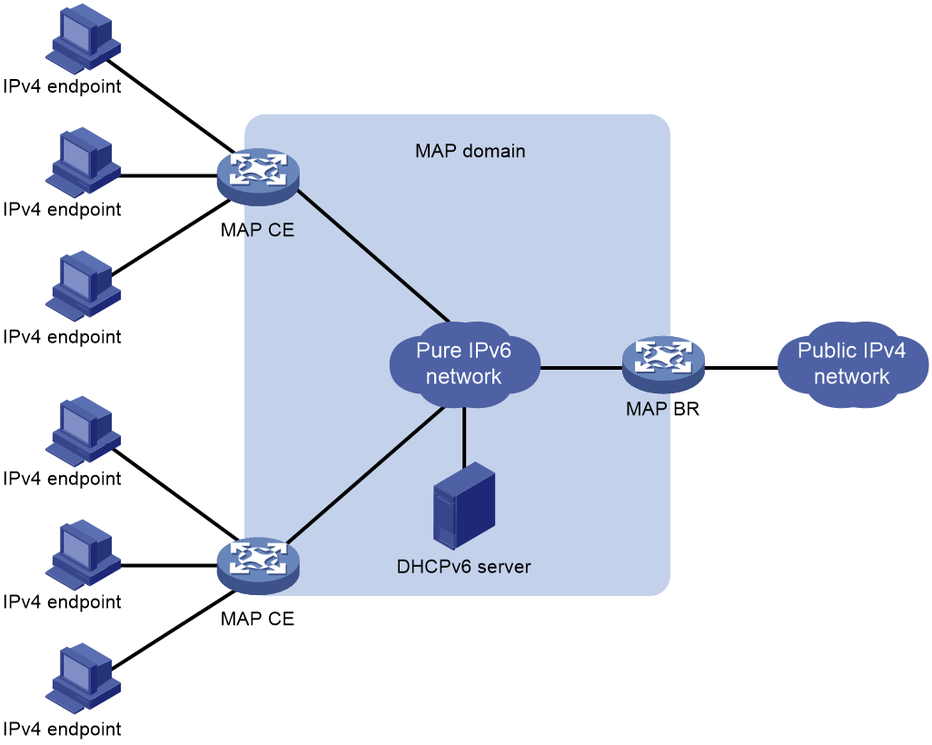

Basic architecture
As shown in Figure 1, the network deployed with MAP-E has MAP CEs and a MAP BR. MAP CEs serve as the service access points for private IPv4 users and the MAP BR acts as the edge node between the IPv4 network and the IPv6 network. The MAP CEs and MAP BR make up a MAP domain. In the same MAP domain, the MAP CEs and MAP BR share the same IPv6 prefix, IPv4 prefix, BMR, and FMR.
IMPORTANT
IMPORTANT:
·     H3C devices can only operate as MAP CEs.
·     A MAP domain can have only one MAP BR.
Figure 1 Basic architecture

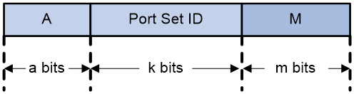

Port number mapping
Upon receiving a private IPv4 packet, the MAP CE translates the source IPv4 address and source port of the packet. Then, the tunnel module of the MAP CE encapsulates the translated IPv4 packet with an IPv6 header. To improve public IPv4 address usage, MAP uses transport layer ports to extend IPv4 addresses. As a result, a public IPv4 address on the MAP CE can be used by multiple private users.
MAP divides a 16-bit transport layer port number into the following parts:
·     A—PSID offset, which is the number of PSID offset bits. The default value is 6. The PSID offset avoids conflicts with well-known port numbers in the range of 0 to 1023.
·     PSID—The length (k) of a PSID determines the sharing ratio (R), which equals to 2k. Transport layer ports are divided into 2k sets and each set contains a group of consecutive port numbers. Each MAP CE has a unique port set.
·     M—The length (m) of this field determines the number of consecutive ports in the port set, which is 2m.
Consequently, a total of 2k port sets are obtained. A PSID uniquely identifies a port set. Each port set contains a number of ((2A)-1)×(2m) ports.
Figure 3 Transport layer port structure for MAP
For example, the PSID offset is 4, the PSID length is 10, and the length of the M field is 2. The transport layer ports are divided into 210=1024 port sets. Each port set contains ((24)-1)*(22)=60 port numbers. Table 1 shows the mappings between PSID values and port sets. The port sets in the table are segmented because the port numbers in the port sets are not consecutive.

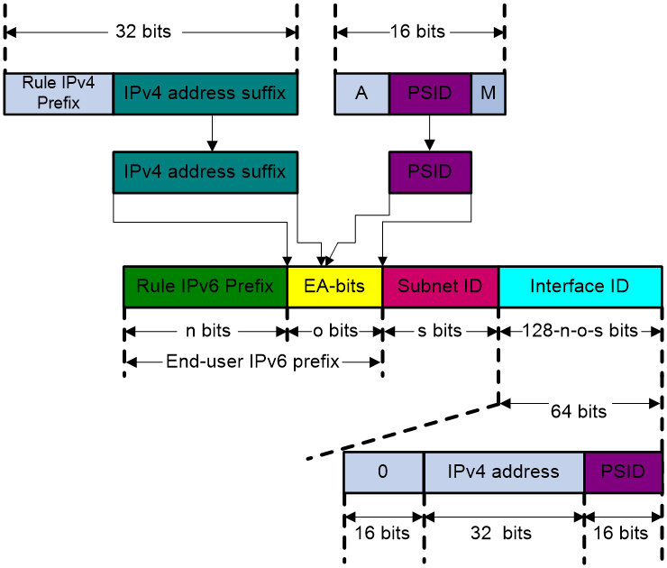

Address mapping mechanism
The MAP CE maps the translated IPv4 address and port number of the original IPv4 packet to an IPv6 address based on the mapping rule, as shown in Figure 4. The IPv6 address contains the Rule IPv6 prefix, EA, Subnet ID, and Interface ID fields. The mapping rule establishes a strong connection between the IPv4 address and port information and the IPv6 address to perform a stateless mapping. This protects the MAP BR from maintaining the mapping between the IPv6 and IPv4 addresses.
·     Rule IPv6 prefix—IPv6 prefix assigned to the MAP CE by the DHCPv6 server.
·     Subnet ID—ID of the first subnet. The value for s is 0.
·     EA—A combination of the IPv4 suffix and the value of the transport layer port's PSID.
·     Interface ID—A combination of an IPv4 address and PSID value.
¡     IPv4 address—If the DHCPv6 server assigns a shared IPv4 address or a dedicated IPv4 address to the MAP CE, the value is the assigned 32-bit IPv4 address. If the DHCPv6 server assigns a Rule IPv4 prefix to the MAP CE, the value for this field is right-padded with 0s to create a 32-bit field. For example, if the Rule IPv4 prefix is 2.1.1.0/29, the value for this field is 0x02010100 (hexadecimal).
¡     PSID—If the PSID value extracted from the EA-bits is less than 16 bits, it is left-padded with 0s to create a 16-bit field. For example, if the PSID value extracted from the EA-bits is 0xAC, the value for this field is 0x00AC. If the DHCPv6 server assigns a Rule IPv4 prefix or a dedicated IPv4 address, no PSID value can be extracted. The value for this field is 0x0000.
Figure 4 Mapping between an IPv4 address and an IPv6 address

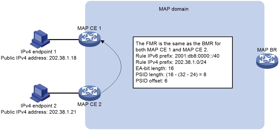

As shown in Figure 5, MAP CE 1, MAP CE 2, and MAP BR reside in the same MAP domain. MAP CE 1 and MAP CE 2 have the same BMR and the FMR is the same as the BMR.
Figure 5 Accessing MAP CE 1 from MAP CE 2 by using an FMR
When IPv4 endpoint 2 accesses IPv4 endpoint 1 by using the public IPv4 address and port number of IPv4 endpoint 1, MAP CE 2 encapsulates the original IPv4 packet sent by IPv4 endpoint 2 with an IPv6 header as follows:

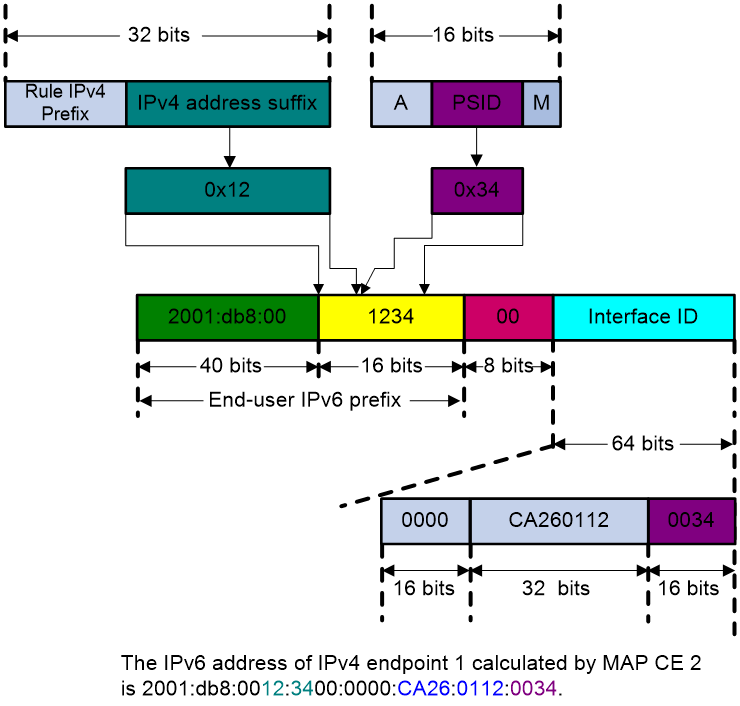

1.     MAP CE 2 calculates the IPv6 address of IPv4 endpoint 2 based on the translated public source IPv4 address and source port number information of IPv4 endpoint 2 and the BMR.
2.     MAP CE 2 calculates the IPv6 address of IPv4 endpoint 1 based on the public IPv4 address and port number information of IPv4 endpoint 1 and the FMR.
Figure 6 shows the calculation process.
Figure 6 Calculating the IPv6 address of IPv4 endpoint 1

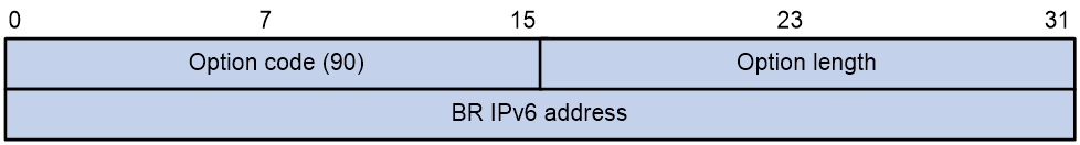

·     Option 90
Option 90, also known as BR Option, is required for Option 94. Figure 9 shows the format of Option 90.
Figure 9 Format of Option 90
¡     Option code—Option number, which is 90.
¡     Option length—Length of the option, which is 16 bytes.
¡     BR IPv6 address—IPv6 address of the BR.

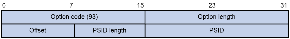

·     Option 93
Option 93, also known as Port Parameters Option, is required for Option 89. Figure 10 shows the format of Option 93.
Figure 10 Format of Option 93
¡     PSID Offset—Offset bits of the PSID.
¡     PSID Len—Length of the PSID.
¡     PSID—PSID value.

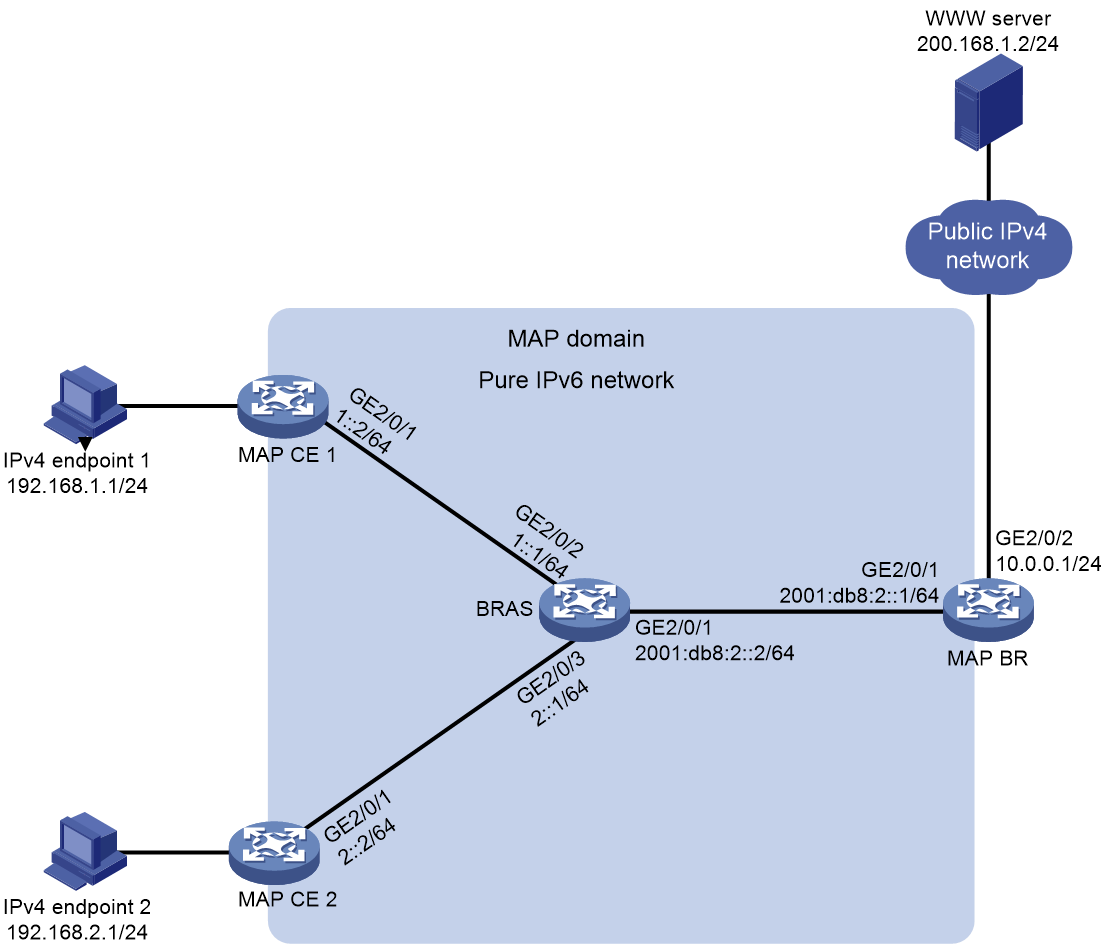

Example: Configuring basic MAP-E
As shown in Figure 11, the MAP CEs connect to the MAP BR through the IPv6 access network, and the MAP BR connects to both the public IPv4 network and the IPv6 access network. The BRAS device, working as a DHCPv6 server, issues the BR IPv6 address and MAP rule to the MAP CEs. Each IPv4 endpoint connects to a MAP CE that performs packet encapsulation and accesses the public IPv4 network resources on subnet 10.0.0.1/24 through the MAP domain or the other IPv4 endpoint in the MAP domain.
The MAP-E information issued by the BRAS device is as follows:
·     In the BMR, the Rule IPv6 Prefix is 2001:DB8:1:64BE::/64, the Rule IPv4 Prefix is 192.0.0.0/24, and the EA length is 16.
·     The BR IPv6 address is 2001:DB8:CAFE::1.
Figure 11 Network diagram
On the BRAS device, configure the settings related to issuing MAP-E information. On the MAP BR, configure the BMR.
