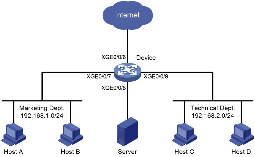

Example: Configuring local port mirroring
As shown in Figure 2, configure local port mirroring in source port mode to enable the server to monitor the bidirectional traffic of the two departments.
Figure 2 Network diagram
# Create local mirroring group 1.
<Device> system-view
[Device] mirroring-group 1 local
# Configure Ten-GigabitEthernet 0/0/6 and Ten-GigabitEthernet 0/0/7 as source ports for local mirroring group 1.
[Device] mirroring-group 1 mirroring-port ten-gigabitethernet 0/0/6 ten-gigabitethernet 0/0/7 both
# Configure Ten-GigabitEthernet 0/0/8 as the monitor port for local mirroring group 1.
[Device] mirroring-group 1 monitor-port ten-gigabitethernet 0/0/8
# Disable the spanning tree feature on the monitor port (Ten-GigabitEthernet 0/0/8).
[Device] interface ten-gigabitethernet 0/0/8
[Device-Ten-GigabitEthernet0/0/8] undo stp enable
[Device-Ten-GigabitEthernet0/0/8] quit
# Verify the mirroring group configuration.
[Device] display mirroring-group all
Mirroring group 1:
    Type: Local
    Status: Active
    Mirroring port: Ten-GigabitEthernet0/0/6  Both
                    Ten-GigabitEthernet0/0/7  Both
    Monitor port: Ten-GigabitEthernet0/0/8

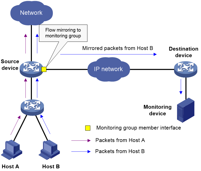

Flow mirroring ERSPAN
About flow mirroring ERSPAN
You can implement ERSPAN through flow-mirroring traffic to interfaces.
ERSPAN encapsulation formats include ERSPANv2 and ERSPANv3.
·     ERSPANv2—Encapsulates mirrored packets in GRE packets with protocol number 0x88BE.
·     ERSPANv3—Encapsulates mirrored packets in GRE packets with protocol number 0x22EB.
Compared with ERSPANv2, ERSPANv3 introduces a bigger, more flexible composite header to meet the requirements in the network monitoring scenarios (for example, network management, intrusion protection, and performance & latency analysis), which are becoming more complicated and diversified. In these scenarios, all parameters of the original mirrored packets must be known, including those parameters that do not exist in the original mirrored packets.
Flow mirroring ERSPAN can be implemented in loopback mode, encapsulation parameter mode, or monitoring group mode.
Operating mechanisms
Flow mirroring ERSPAN can be implemented in the following modes:
·     Loopback mode.
·     Encapsulation parameter mode.
·     Monitoring group mode.

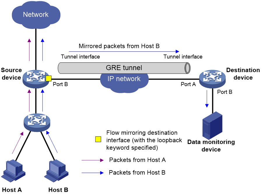

Loopback mode
As shown in Figure 3, configure flow mirroring ERSPAN in loopback mode as follows:
1.     On the source device, apply a QoS policy to the source interface as follows:
a.     Configure a traffic class to match packets.
b.     Configure a traffic behavior to mirror packets to Port B and specify the loopback keyword.
c.     Create a QoS policy, and associate the traffic class with the traffic behavior.
d.     Apply the QoS policy to the source interface.
2.     On the source device, apply a QoS policy to Port B as follows:
b.     Configure a traffic behavior to redirect packets to a tunnel interface.
d.     Apply the QoS policy to Port B.
3.     The destination device receives mirrored packets on the tunnel interface and decapsulates the packets. Then, the destination device forwards the packets based on the destination IP address of the original packets.
Make sure the destination device has the route and ARP entry to the destination IP address.
Figure 3 Flow mirroring ERSPAN in loopback mode

As shown in Figure 4, flow mirroring ERSPAN in encapsulation parameter mode works as follows:
4.     The source device copies a matching packet.
5.     The source device encapsulates the packet with the specified ERSPAN encapsulation parameters.
6.     The source device forwards the packet in either of the following methods:
¡     Forwards the mirrored packets out of the specified outgoing interface.
¡     Looks up a route for the encapsulated mirrored packet based on the source IP address and destination IP address of the encapsulated packet.
7.     The encapsulated packet is routed to the monitoring device.
8.     The monitoring device decapsulates the packet and analyzes the packet contents.
The packet sent to the monitoring device through flow mirroring in this mode is encapsulated. In this mode, make sure the monitoring device supports decapsulating packets.
Figure 4 Flow mirroring ERSPAN in encapsulation parameter mode
As shown in Figure 5, flow mirroring ERSPAN in monitoring group mode works as follows:
1.     On the source device, configure a monitoring group, add member interfaces to the monitoring group, and configure the encapsulation parameters for the member interfaces.
2.     On the source device, apply a QoS policy as follows:
b.     Configure a traffic behavior to mirror traffic to the monitoring group.
c.     Create a QoS policy, and associate the traffic class with the traffic behavior in the QoS policy.
d.     Apply the QoS policy.
3.     The source device copies a matching packet and mirrors the packet to the monitoring group. The member interfaces of the monitoring group encapsulate the packet with the specified encapsulation parameters.
4.     The source device forwards the packet in either of the following methods:
¡     Forwards the mirrored packet out of the specified outgoing interface.
5.     The encapsulated packet is routed to the monitoring device.
6.     The monitoring device decapsulates the packet and analyzes the packet contents.
Figure 5 Flow mirroring ERSPAN in monitoring group mode

Flow mirroring configuration examples
Example: Configuring flow mirroring
As shown in Figure 6, configure flow mirroring so that the server can monitor the following traffic:
·     All traffic that the Technical Department sends to access the Internet.
·     IP traffic that the Technical Department sends to the Marketing Department during working hours (8:00 to 18:00) on weekdays.
Figure 6 Network diagram
# Create working hour range work, in which working hours are from 8:00 to 18:00 on weekdays.
<DeviceA> system-view
[DeviceA] time-range work 8:00 to 18:00 working-day
# Create IPv4 advanced ACL 3000 to allow packets from the Technical Department to access the Internet and the Marketing Department during working hours.
[DeviceA] acl advanced 3000
[DeviceA-acl-ipv4-adv-3000] rule permit tcp source 192.168.2.0 0.0.0.255 destination-port eq www
[DeviceA-acl-ipv4-adv-3000] rule permit ip source 192.168.2.0 0.0.0.255 destination 192.168.1.0 0.0.0.255 time-range work
[DeviceA-acl-ipv4-adv-3000] quit
# Create traffic class tech_c, and configure the match criterion as ACL 3000.
[DeviceA] traffic classifier tech_c
[DeviceA-classifier-tech_c] if-match acl 3000
[DeviceA-classifier-tech_c] quit
# Create traffic behavior tech_b, configure the action of mirroring traffic to Ten-GigabitEthernet 0/0/8.
[DeviceA] traffic behavior tech_b
[DeviceA-behavior-tech_b] mirror-to interface ten-gigabitethernet 0/0/8
[DeviceA-behavior-tech_b] quit
# Create QoS policy tech_p, and associate traffic class tech_c with traffic behavior tech_b in the QoS policy.
[DeviceA] qos policy tech_p
[DeviceA-qospolicy-tech_p] classifier tech_c behavior tech_b
[DeviceA-qospolicy-tech_p] quit
# Apply QoS policy tech_p to the incoming packets of Ten-GigabitEthernet 0/0/9.
[DeviceA] interface ten-gigabitethernet 0/0/9
[DeviceA-Ten-GigabitEthernet0/0/9] qos apply policy tech_p inbound
[DeviceA-Ten-GigabitEthernet0/0/9] quit
# Verify that the server can monitor the following traffic:
·     All traffic sent by the Technical Department to access the Internet.
·     IP traffic that the Technical Department sends to the Marketing Department during working hours on weekdays.
(Details not shown.)
