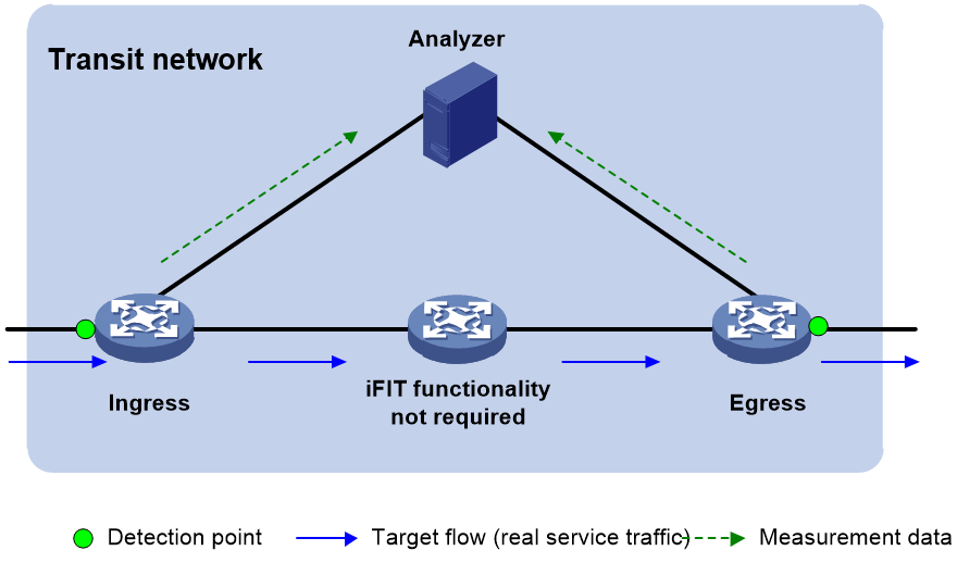

End-to-end measurement
To measure the packet loss and packet delay on the entire network, use end-to-end measurement. As shown in Figure 1, iFIT measures whether packet loss or packet delay occurs between the ingress node (where the target flow enters the IP network) and the egress node (where the flow leaves the network).
Figure 1 End-to-end measurement

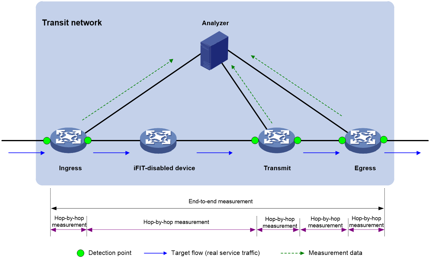

Hop-by-hop measurement
To accurately locate the packet loss and packet delay of each network node, use hop-by-hop measurement. To locate the faulty node, you can divide an end-to-end network into smaller measurement spans. As shown in Figure 2, iFIT measures whether the packet loss and packet delay occurs between the ingress node and egress node, ingress node and transmit node, transmit node and egress node.
Figure 2 Hop-by-hop measurement

·     The ingress node refers to the node that the flow enters the transit network. It filters the target flow, adds iFIT headers to the packets of the flow, collects packet statistics and reports packet statistics to the analyzer.
·     A transmit node identifies the target flow by the iFIT header and reports the measurement statistics to the analyzer according to the measurement mode in the iFIT header.
·     The egress node identifies the target flow by the iFIT header, reports the measurement statistics to the analyzer, and removes the iFIT header from the packet.
·     The analyzer collects the statistics reported by the ingress node, transmit nodes, and egress node for data summarization and calculation.

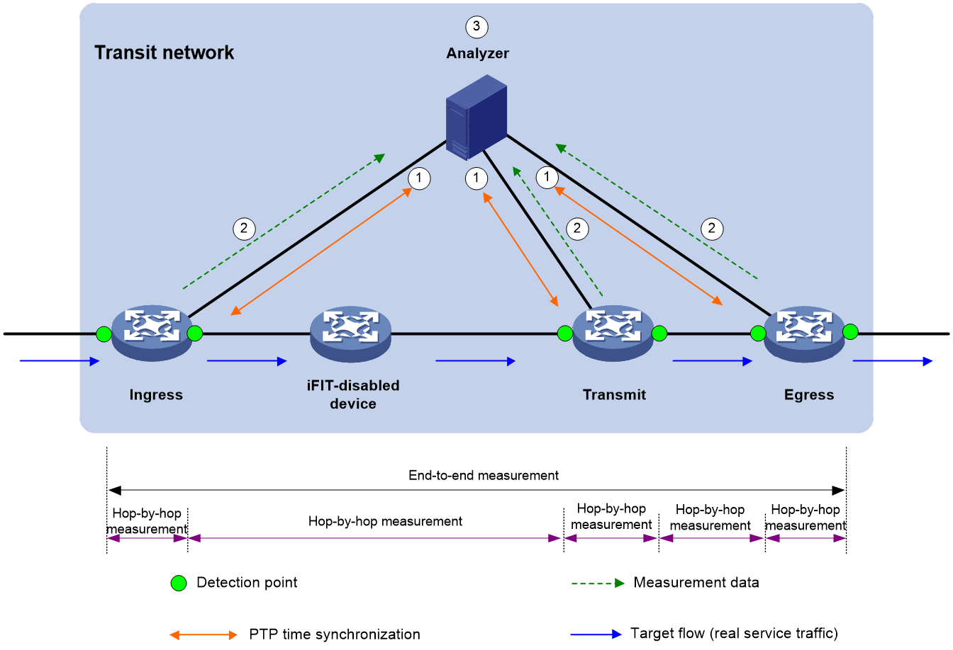

Working mechanism
The following illustrates the working mechanism of hop-by-hop measurement. No transmit nodes exist in end-to-end measurement but end-to-end measurement works similarly as hop-by-hop measurement.
As shown in Figure 3, the flow passes through four devices. Three devices are enabled with iFIT. The iFIT measurement works as follows:
1.     The analyzer synchronizes the time with all iFIT-enabled devices through the NTP protocol.
2.     The iFIT-enabled devices takes the following actions:
a.     The ingress node parses the packets to identify the target flow. It encapsulates iFIT headers to the packets, counts the number of packets, and reports the packet quantity and timestamp to the analyzer through gRPC periodically.
The ingress node is the interface bound to the target flow.
b.     A transmit node counts the number of packets containing iFIT headers and reports the packet quantity and timestamp to the analyzer through gRPC periodically.
When the target flow passes through an iFIT-enabled device, the interfaces where the target flow enters the iFIT-enabled device and leaves the iFIT-enabled device are transmit nodes.
c.     The egress node parses the packets to identify the target flow. It counts the number of packets containing iFIT headers, reports the packet quantity and timestamp to the analyzer through gRPC periodically, removes iFIT headers from the packets and forwards the packets.
When the target flow leaves the transit network, the interface where the target flow leaves the iFIT-enabled device is the egress point.
3.     The analyzer calculates the packet delay for the target flow of the same period and same instance.
Figure 3 Network diagram

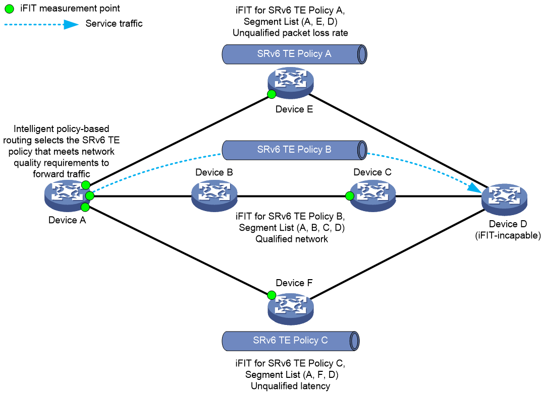

iFIT can collaborate with an SRv6 TE policy to measure the end-to-end quality of the SRv6 tunnel of the SRv6 TE policy. The measurement result can be used for intelligent route selection of the SRv6 TE policy module

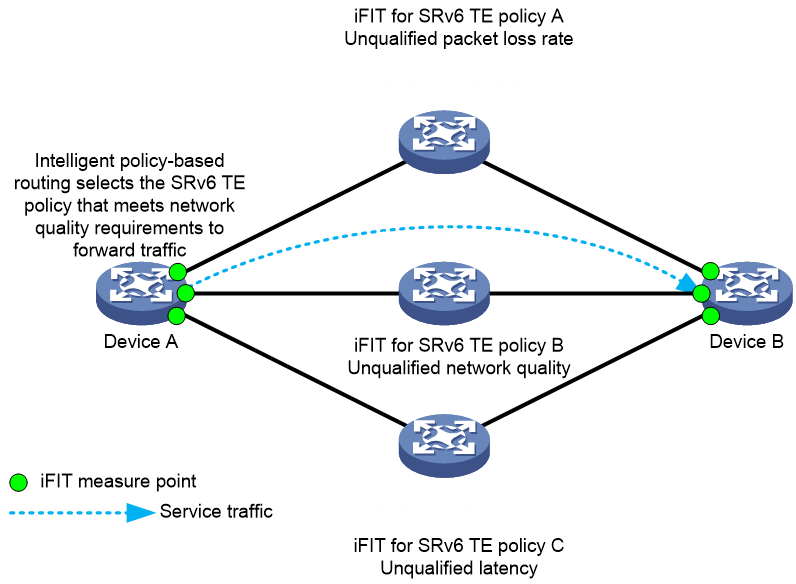

Specifying H3C devices the ingress node and egress node of an SRv6 TE policy
When both the ingress and egress nodes of an SRv6 TE policy are H3C devices, configure end-to-end iFIT measurement as a best practice for the SRv6 TE policy. In this case, the egress node of an SRv6 TE policy returns the iFIT measurement result to the ingress node for calculating the network quality of the SRv6 TE policy. Even if the transmit nodes where the target flow passes through have iFIT enabled and detect iFIT messages, these transmit nodes will not return the iFIT measurement results to the ingress node of the SRv6 TE policy. This reduces the complexity of device processing.
Figure 4 shows a typical application scenario for end-to-end tunnel-level iFIT measurement:
1.     Enable iFIT on the ingress node and egress node of an SRv6 TE policy.
2.     The ingress node and egress node will measure the transmitted packet count, delay, and jitter of the SRv6 tunnel periodically based on the iFIT operating mechanism.
3.     The egress node returns the iFIT measurement result to the ingress node.
4.     The ingress node collects and calculates the packet loss rate, delay, and jitter for each SRv6 TE policy path and provides the measurement results to the SRv6 TE policy module on the same node.
5.     The SRv6 TE policy module on the ingress node will select the optimal forwarding path for the service traffic intelligently based on the iFIT measurement results.
Figure 4 iFIT support for end-to-end SRv6 TE policy intelligent route selection
For more information about the SRv6 TE policies and BFD for the SRv6 TE policies, see SRv6 TE policies configuration in Segment Routing Configuration Guide.

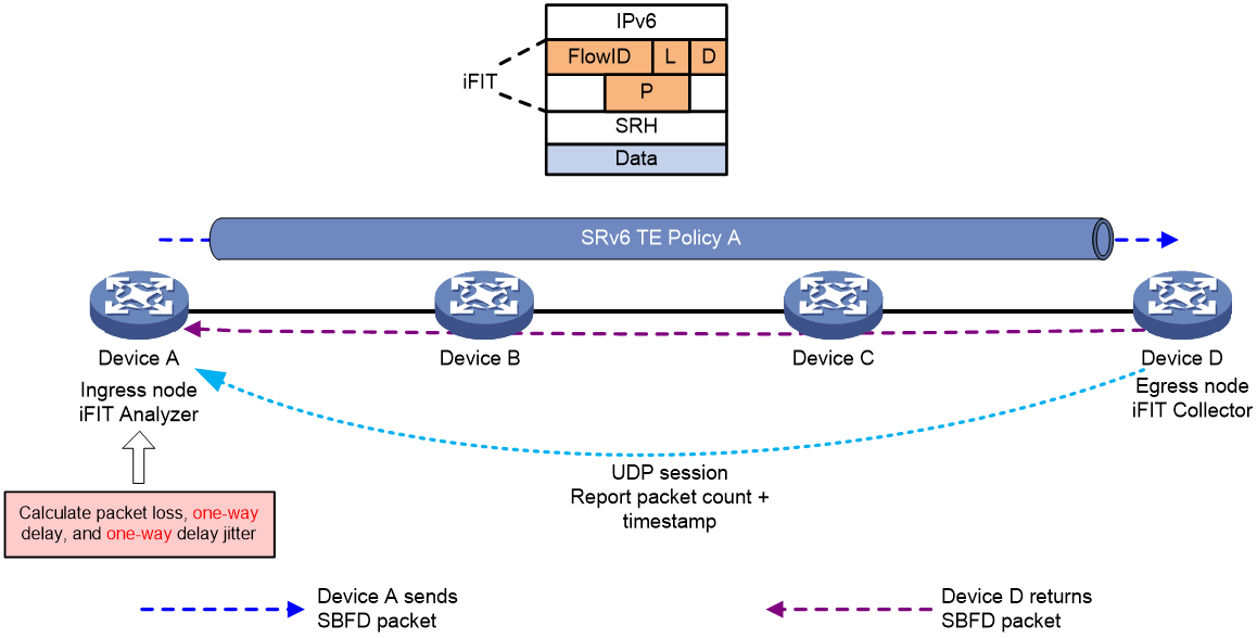

iFIT architecture
In application-level iFIT measurement, iFIT reports measurement results to a collector via Telemetry, which then performs aggregation and calculations. For intelligent router selection of the SRv6 TE policy module, iFIT reports measurement results from both the ingress and egress nodes of the SRv6 TE policies to the ingress node, where the results are aggregated and calculated. The iFIT tunnel-level iFIT measurement architecture mainly includes three components: target flow, Collector, and Analyzer.
Target flow
iFIT reuses BFD sessions of the SRv6 TE policy and use them as the target flow to encapsulate iFIT headers to the matched BFD packets for iFIT measurement. This provides the following benefits:
·     Use BFD to detect SRv6 TE policy connectivity, providing millisecond-level fault detection speed and enabling fast fault switchover.
·     iFIT reuses BFD packets as the target flow for link iFIT measurement, simplifying network configuration and software complexity.
An SRv6 TE policy supports both seamless BFD (SBFD) and BFD in echo packet mode for iFIT measurement in different application scenarios, as shown in Table 1.

Collector
Collector is deployed on the egress node of the SRv6 TE policy.
The egress node that operates in Collector mode sends the local iFIT measurement results for SRv6 paths to the ingress node (Analyzer) of the SRv6 TE policy via UDP packets.
Analyzer
Analyzer is deployed on the ingress node of the SRv6 TE policy.
A node performs the following tasks when operating in Analyzer mode:
·     Forwards the local iFIT measurement results to Analyzer on the same node.
·     Analyzer aggregates and calculates the iFIT measurement results received from both the ingress and egress nodes, deriving metrics such as packet loss, delay, and jitter for the SRv6 tunnels.

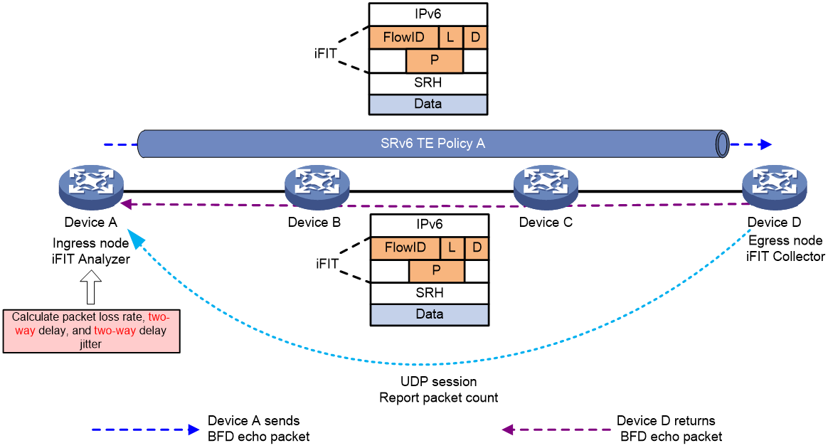

As shown in Figure 6, iFIT based on SBFD operates as follows:
1.     Synchronize time between the ingress and egress nodes.
2.     Use iFIT for the SRv6 TE policy on the ingress node and issue measurement parameters to iFIT, such as the segment list ID of the SRv6 tunnel, iFIT measurement period, whether to measure packet loss, whether to measure one-way or two-way delay, packet loss rate criteria, delay criteria, and jitter criteria.
3.     The ingress node automatically creates an iFIT instance and assigns a FlowID to it.
4.     The BFD service module on the ingress node generates SBFD packets for the SRv6 tunnel, adds SRv6 encapsulation to these packets with segment list ID of the SRv6 tunnel encapsulated. Then, the BFD service module notifies the iFIT service module to initiate iFIT measurement.
5.     The iFIT instance on the ingress node matches the segment list ID in SBFD packets by the segment list ID in the SRv6 TE policy:
¡     For the matched SBFD packets, iFIT performs packet loss and delay measurements and sends the results to the local Analyzer module. iFIT considers SBFD packets as service packets, and packet loss and delay measurements based on SBFD are the same as the application-level iFIT measurement of iFIT.
¡     For the unmatched SBFD packets, iFIT does not perform a measurement.
6.     The egress node parses the iFIT headers in the packets and performs iFIT packet loss and delay measurements.
7.     Collector (egress node) establishes a UDP session with the ingress node based on the source address of the received packets and sends the counted packet statistics and packet timestamps to the ingress node over the UDP session, according to the iFIT measurement period defined in the SRv6 TE policy.
8.     Analyzer (ingress node) calculates the packet loss rate by comparing the number of SBFD packets received on the ingress and egress nodes and computes one-way delay and one-way jitter based on the timestamp when an SBFD packet was sent from the ingress node and timestamp when the same packet was received on the egress node. If the calculated results exceed the packet loss rate, delay, or jitter thresholds defined in the SRv6 TE policy, Analyzer reports the exceeding metrics to the local SRv6 TE policy module on the same node. iFIT will then immediately notify the SRv6 TE policy to initiate a link switch. These results will be used for intelligent route selection through the SRv6 TE policy.
Figure 6 iFIT measurement based on SBFD

4.     The BFD service module on the ingress node generates BFD echo packets for the SRv6 tunnel, adds SRv6 encapsulation to these packets with segment list ID of the SRv6 tunnel encapsulated. Then, the BFD service module notifies the iFIT service module to initiate iFIT measurement.
5.     The iFIT instance on the ingress node matches the segment list ID in BFD echo packets by the segment list ID in the SRv6 TE policy:
¡     For the matched BFD echo packets, iFIT performs packet loss and delay measurements and sends the results to the local Analyzer module. iFIT considers BFD echo packets as service packets, and packet loss and delay measurements based on BFD in echo packet mode are the same as the application-level iFIT measurement of iFIT.
¡     For the unmatched BFD echo packets, iFIT does not perform a measurement.
7.     Collector (egress node) establishes a UDP session with the ingress node based on the source address of the received packets and sends the counted packet statistics to the ingress node over the UDP session, according to the iFIT measurement period defined in the SRv6 TE policy.
8.     The egress node forwards the received BFD echo packets back to the ingress node along the original path.
9.     The ingress node performs iFIT measurement on the returned BFD echo packets and sends the measurement results to the local Analyzer service module.
10.     Analyzer (ingress node) calculates the packet loss rate by comparing the number of BFD echo packets received on the ingress and egress nodes and computes two-way delay and two-way jitter based on the timestamp when a BFD echo packet was sent from the ingress node and timestamp when the same packet was received on the egress node. If the calculated results exceed the packet loss rate, delay, or jitter thresholds defined in the SRv6 TE policy, Analyzer reports the exceeding metrics to the local SRv6 TE policy module on the same node. iFIT will then immediately notify the SRv6 TE policy to initiate a link switch. These results will be used for intelligent route selection through the SRv6 TE policy.
Figure 7 iFIT measurement based on BFD in echo packet mode
Configuring application-level iFIT measurement
Application-level iFIT measurement measures the metrics such as the packet loss rate and delay when service traffic passes through the transmission network. The measurement result can be used to assess the network transmission quality for the service traffic.
An iFIT instance monitors only one flow. If you configure flows multiple times for an iFIT instance, the most recent configuration takes effect.
For the flows to be monitored by different instances, the flow attributes must not be identical and cannot conflict to avoid inaccurate measurement result.
As a best practice, configure iFIT first on the transmit nodes and the egress node and then the ingress node. Thus, the measurement results of the previous measurement periods will not affected if iFIT measurement starts on the ingress node but not on the transmit nodes and the egress node.
Modifying the iFIT instance or restarting the ingress node will cause flow ID change, which might cause inaccurate measurement data or no data in several measurement periods.
SRv6 includes SRv6 TE and SRv6 BE networks. The iFIT configuration varies by network type as follows:
·     In an SRv6 TE network, configure iFIT on nodes in a SID list. If a transmit node is not in a SID list, iFIT measurement cannot be performed even after you configure iFIT on the transmit node.
·     In an SRv6 BE network, if you specify hop-by-hop measurement as the measurement mode, iFIT generates iFIT data only on the ingress and egress nodes during SRv6 forwarding. The transmit nodes only forward IPv6 packets and do not participate in SRv6 processing, so no iFIT data is generated on the transmit nodes.
Before configuring iFIT, make sure the analyzer and iFIT-enabled devices are time synchronized through NTP. For more information about NTP, see "Configuring NTP."
To enable the iFIT-enabled devices to report the measurement results to the analyzer, configure gRPC on the analyzer and iFIT-enabled devices. For more information about gRPC, see gRPC configuration in Telemetry Configuration Guide.

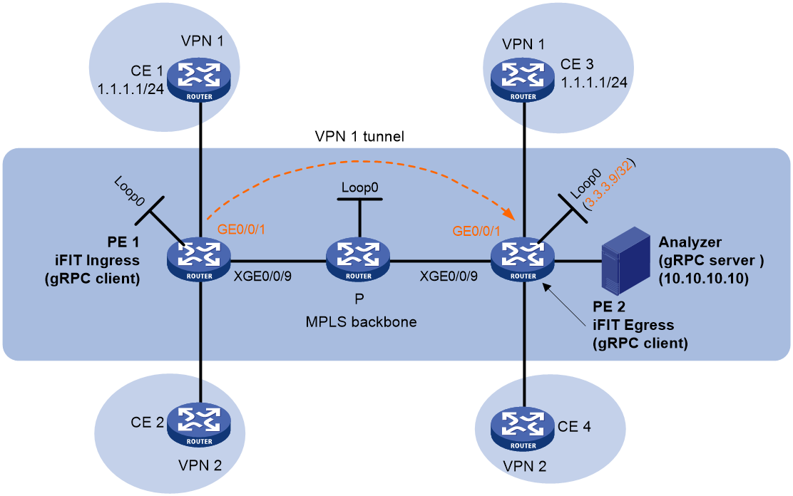

Example: Configuring iFIT in an EVPN L3VPN network
As shown in Figure 8:
·     Configure IPv4 EVPN L3VPN for different sites of a VPN instance to communicate with each other.
·     Configure the CE and the PE of each site to use EBGP to exchange VPN routes.
·     Configure the PEs to communicate through OSPF and to exchange BGP EVPN routes through MP-IBGP.
·     Configure iFIT to monitor the occurrence of packet loss and packet delay value when the flow passes through the VPN 1 tunnel.
Figure 8 Network diagram
1.     Configure EVPN L3VPN. (Details not shown.)
For information about configuring EVPN L3VPN, see EVPN L3VPN configuration in EVPN Configuration Guide.
2.     Configure NTP on PE 1 and PE 2 for clock synchronization. (Details not shown.)
For information about configuring NTP, see "Configuring NTP."

1.     View iFIT statistics on PE 1.
[PE1] display ifit statistic device-id 1 flow-id 3
Period ID     Direction   PktCount        Timestamp(sec, nsec)  Interface
163059918     Ingress     4124            1630599180, 1889782   XGE0/0/6
163059919     Ingress     4124            1630599190, 1901494   XGE0/0/6
163059920     Ingress     4124            1630599200, 1912118   XGE0/0/6
2.     View iFIT statistics on PE 2.
[PE2] display ifit statistic device-id 1 flow-id 3
163059918     Egress      4124            1630599180, 1948185   XGE0/0/6
163059919     Egress      4124            1630599190, 1959405   XGE0/0/6
163059920     Egress      4120            1630599200, 1968503   XGE0/0/6
3.     Packet loss occurs in period 163059920 by viewing iFIT statistics on the analyzer.

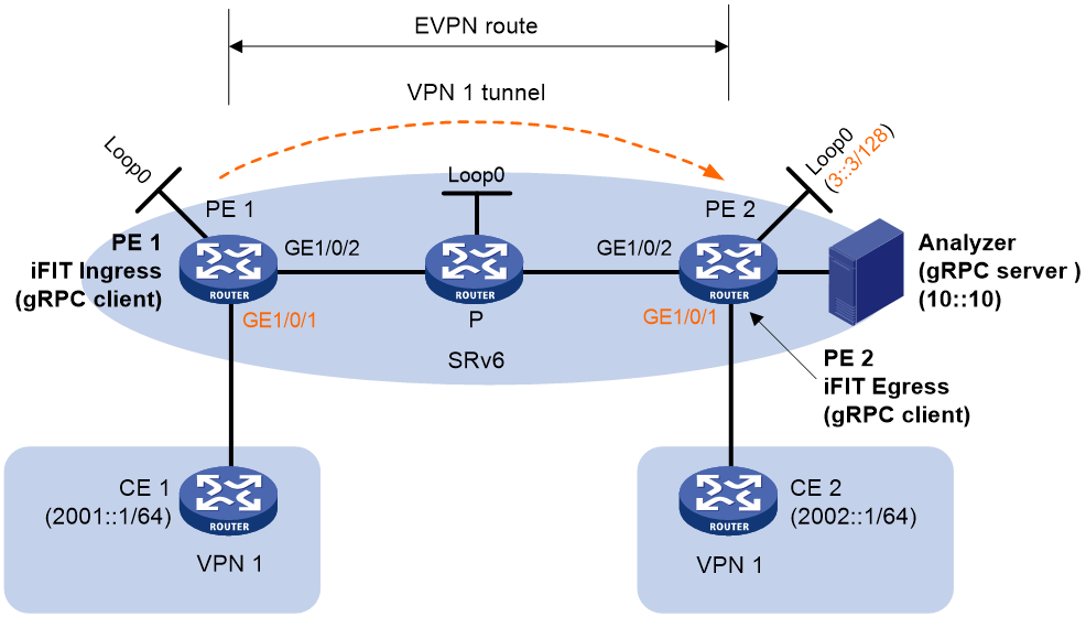

Example: Configuring iFIT in an IPv4 L3VPN over SRv6 network
As shown in Figure 9, the backbone network is an IPv6 network, and VPN 1 is an IPv4 network. Deploy MPLS L3VPN over SRv6 between PE 1 and PE 2 and use an SRv6 tunnel to transmit VPNv4 traffic between the PEs.
·     Configure EBGP to exchange VPN routing information between the CEs and PEs.
·     Configure IPv6 IS-IS on the PEs in the same AS to realize IPv6 network connectivity.
·     Configure MP-IBGP to exchange VPNv4 routing information between the PEs.
Figure 9 Network diagram

Example: Configuring iFIT in an IPv6 EVPN L3VPN over SRv6 network
As shown in Figure 10, the backbone network is an IPv6 network. Deploy EVPN L3VPN over SRv6 in SRv6-BE mode between PE 1 and PE 2 and use an SRv6 tunnel to transmit EVPN traffic between the PEs.
·     Configure MP-IBGP to exchange EVPN routing information between the PEs.
Figure 10 Network diagram
1.     Configure IPv6 EVPN L3VPN over SRv6. (Details not shown.)
For information about configuring IPv6 EVPN L3VPN over SRv6, see EVPN L3VPN over SRv6 configuration in Segment Routing Configuration Guide.
1.     Configure gRPC:
# Enable the gRPC service.
<PE1> system-view
[PE1] grpc enable
# Create a sensor group named test, and add sensor path ifit/flowstatistics/flowstatistic.
[PE1] telemetry
[PE1-telemetry] sensor-group test
[PE1-telemetry-sensor-group-test] sensor path ifit/flowstatistics/flowstatistic depth 2
[PE1-telemetry-sensor-group-test] quit
# Create a destination group named collector1. Specify a collector that uses IPv6 address 10::10 and port number 50050.
[PE1-telemetry] destination-group collector1
[PE1-telemetry-destination-group-collector1] ipv6-address 10::10 port 50050
[PE1-telemetry-destination-group-collector1] quit
# Configure a subscription named A to bind sensor group test with destination group collector1. Set the sampling interval to 5 seconds.
[PE1-telemetry] subscription A
[PE1-telemetry-subscription-A] sensor-group test sample-interval 5
[PE1-telemetry-subscription-A] destination-group collector1
[PE1-telemetry-subscription-A] quit
[PE1-telemetry] quit
2.     Configure iFIT:
# Enable the iFIT functionality.
[PE1] ifit enable
[PE1-ifit] device-id 1
# Configure instance a to monitor the unidirectional flow passing through the VPN 1 tunnel.
[PE1-ifit] instance a
[PE1-ifit-instance-a] flow unidirection source-ipv6 2001::1 64 destination-ipv6 2002::1 64 vpn-instance vpn1
# Bind interface Ten-GigabitEthernet0/0/6 to instance a.
[PE1-ifit-instance-a] bind interface ten-gigabitethernet 0/0/6
# Specify 10 seconds as the measurement period.
[PE1-ifit-instance-a] period 10
# Enable iFIT measurement.
[PE1-ifit-instance-a] measure enable
[PE1-ifit-instance-a] quit
[PE1-ifit] quit
3.     Configure PE 2:
# Configure gRPC.
Use the same procedure to configure gRPC on PE 2 as you configure gRPC on PE 1.
<PE2> system-view
[PE2] ifit enable
[PE1-ifit-instance-a] display ifit statistic device-id 1 flow-id 2
[PE2] display ifit statistic device-id 1 flow-id 2
Configuring tunnel-level iFIT measurement
For information about configuring SRv6 TE policies, see SRv6 TE policies configuration in Segment Routing Configuration Guide.
Before configuring iFIT, make sure the ingress node and egress node are time synchronized through PTP. For more information about PTP, see PTP configuration in Network Management and Monitoring Configuration Guide.
Configuring the ingress node
2.     Enable iFIT and enter iFIT view.
ifit enable
By default, iFIT is disabled.
3.     Configure the device to act as iFIT Analyzer and enter iFIT Analyzer view.
work-mode analyzer
By default, the device does not act as iFIT Analyzer.
4.     Configure iFIT to collaborate with SRv6 TE policies.
service-type srv6-segment-list
By default, the collaboration between iFIT and SRv6 TE policies is disabled.
Configuring the egress node
ifit enable
3.     Configure the device to act as iFIT Collector and enter iFIT Collector view.
work-mode collector
By default, the device does not act as iFIT Collector.
