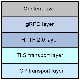

Figure 1 shows the gRPC protocol stack.
Figure 1 gRPC protocol stack
Table 1 describes the gRPC protocol stack layers from the bottom up.
Table 1 gRPC protocol stack layers
Layer
Description
TCP transport layer
Provides connection-oriented reliable data links.
TLS transport layer
(Optional.) Provides channel encryption and mutual certificate authentication.
HTTP 2.0 layer
The transport protocol for gRPC. HTTP 2.0 provides enhanced features such as header field compression, multiplexing requests on a single connection, and flow control.
gRPC layer
Defines the interaction format for RPC calls. Public proto definition files such as the grpc_dialout.proto file define the public RPC methods.
Content layer
Carries encoded service data. This layer supports the following encoding formats:
·     Google Protocol Buffer (GPB)—A highly efficient binary encoding format. This format uses proto definition files to describe the structure of data to be serialized. GPB is more efficient in data transmission than protocols such as JavaScript Object Notation.
·     JavaScript Object Notation (JSON)—A lightweight data exchange format. It uses a text format that is language neutral to store and represent data, which is easy to read and compile.
If service data is in JSON format, you can use the public proto files to decode the data without having to use the proto file specific to the service module.
