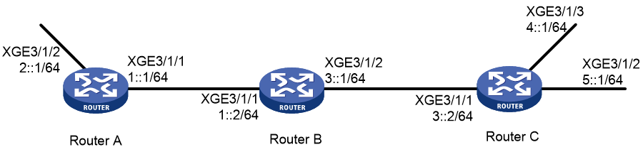

Configuring RIPng FRR
About RIPng FRR
A link or router failure on a path can cause packet loss and even routing loop until RIPng completes routing convergence based on the new network topology. FRR enables fast rerouting to minimize the impact of link or node failures.
Figure 1 Network diagram for RIPng FRR

Example: Configuring basic RIPng
As shown in Figure 2, Router A, Router B, and Router C learn IPv6 routing information through RIPng. Configure route filtering on Router B to accept all received routes except the route 2::/64 and to advertise only the route 4::/64.
Figure 2 Network diagram

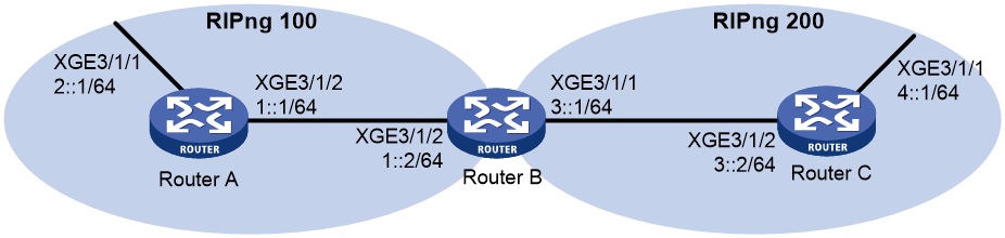

Example: Configuring RIPng route redistribution
As shown in Figure 3, Router B communicates with Router A through RIPng 100 and with Router C through RIPng 200.
Configure route redistribution on Router B, so the two RIPng processes can redistribute routes from each other.
Figure 3 Network diagram

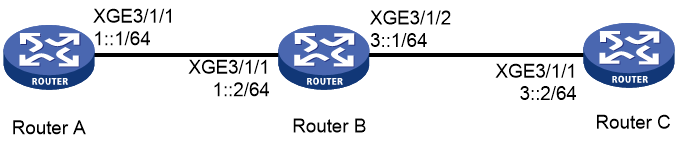

Example: Configuring RIPng GR
As shown in Figure 4, Router A, Router B, and Router C learn IPv6 routing information through RIPng.
Configure Router A as the GR restarter. Configure Router B and Router C as the GR helpers to synchronize their routing tables with Router A by using GR.
Figure 4 Network diagram

Example: Configuring RIPng FRR
As shown in Figure 5, Router A, Router B, and Router C run RIPng. Configure RIPng FRR so that when Link A becomes unidirectional, traffic can be switched to Link B immediately.
Figure 5 Network diagram
Device
Interface
IP address
Router A
Ten-GigabitEthernet 3/1/1
1::1/64
Router A
Ten-GigabitEthernet 3/1/2
2::1/64
Router A
Loopback 0
10::1/128
Router B
3::1/64
Router B
2::2/64
Router B
Loopback 0
20::1/128
Router C
1::2/64
Router C
3::2/64
1.     Configure IPv6 addresses for the interfaces on the routers. (Details not shown.)
2.     Configure RIPng on the routers to make sure Router A, Router B, and Router C can communicate with each other at the network layer. (Details not shown.)
3.     Configure RIPng FRR:
# Configure Router A.
<RouterA> system-view
[RouterA] ipv6 prefix-list abc index 10 permit 20::1 128
[RouterA] route-policy frr permit node 10
[RouterA-route-policy-frr-10] if-match ipv6 address prefix-list abc
[RouterA-route-policy-frr-10] apply ipv6 fast-reroute backup-interface ten-gigabitethernet 3/1/1 backup-nexthop 1::2
[RouterA-route-policy-frr-10] quit
[RouterA] ripng 1
[RouterA-ripng-1] fast-reroute route-policy frr
[RouterA-ripng-1] quit
# Configure Router B.
<RouterB> system-view
[RouterB] ipv6 prefix-list abc index 10 permit 10::1 128
[RouterB] route-policy frr permit node 10
[RouterB-route-policy-frr-10] if-match ipv6 address prefix-list abc
[RouterB-route-policy-frr-10] apply ipv6 fast-reroute backup-interface ten-gigabitethernet 3/1/1 backup-nexthop 3::2
[RouterB-route-policy-frr-10] quit
[RouterB] ripng 1
[RouterB-ripng-1] fast-reroute route-policy frr
[RouterB-ripng-1] quit
# Display the route 20::1/128 on Router A to view the backup next hop information.
[RouterA] display ipv6 routing-table 20::1 128 verbose
Summary count : 1

Example: Using an IPsec profile to protect RIPng
As shown in Figure 6, configure RIPng on the routers, and configure IPsec profiles on the routers to authenticate and encrypt protocol packets.
Figure 6 Network diagram
1.     Configure IPv6 addresses for the interfaces. (Details not shown.)
2.     Configure basic RIPng settings:
