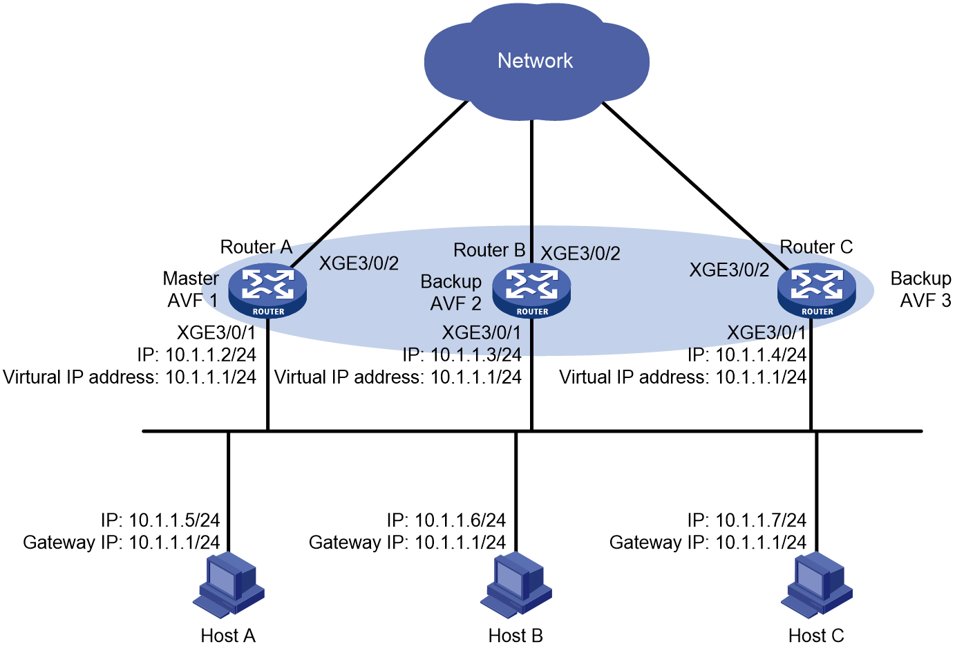

VF backup
The VFs corresponding to a virtual MAC address on different routers in the VRRP group back up one another.
Figure 8 VF information
Figure 8 shows the VF table on each router in the VRRP group and how the VFs back up one another. The master, Router A, assigns virtual MAC addresses 000f-e2ff-0011, 000f-e2ff-0012, and 000f-e2ff-0013 to itself, Router B, and Router C, respectively. Each router creates VF 1, VF 2, and VF 3 for virtual MAC addresses 000f-e2ff-0011, 000f-e2ff-0012, and 000f-e2ff-0013, respectively. The VFs for the same virtual MAC address on different routers back up one another. For example, the VF 1 instances on Router A, Router B, and Router C back up one another.
·     The VF 1 instance on Router A (the VF 1 owner) has priority 255. It acts as the AVF to forward packets sent to virtual MAC address 000f-e2ff-0011.
·     The VF 1 instances on Router B and Router C have a priority of 255/(1 + 1), or 127. Because their priorities are lower than the priority of the VF 1 instance on Router A, they act as LVFs. These LVFs listen to the state of the VF 1 instance on Router A.
·     When the VF 1 instance on Router A fails, the VF 1 instances on Router B and Router C elect the one with higher priority as the new AVF. This AVF forwards packets destined for virtual MAC address 000f-e2ff-0011. If the two LVFs' priorities are the same, the LVF with a greater device MAC address becomes the new AVF.
A VF always operates in preemptive mode. When an LVF finds its priority value higher than the one advertised by the AVF, the LVF declares itself as the AVF.

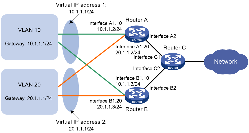

Specifying an IPv4 VRRP control VLAN
As shown in Figure 9, ambiguous VLAN termination is configured for VLAN 10 and VLAN 20 on the Layer 3 Ethernet subinterfaces on routers. To allow the master to regularly send VRRP advertisements in multicast to the backups, enable the VLAN termination-enabled subinterfaces to transmit broadcast packets and multicast packets. Then, the master can send VRRP advertisements within all VLANs whose VLAN packets are configured to be terminated by the subinterfaces. If ambiguous VLAN termination is configured on the Layer 3 Ethernet subinterfaces for a large range of VLANs, the VRRP advertisements might overload the subinterfaces. This adversely affects the performance of the routers.
To resolve this problem, you can disable the VLAN termination-enabled subinterfaces from transmitting broadcast packets and multicast packets and configure a VRRP control VLAN. The master sends VRRP advertisements only within the control VLAN.
Figure 9 VRRP control VLAN
Specify VRRP control VLANs according to the VLAN termination type.
·     For ambiguous Dot1q termination, specify one control VLAN by the outermost layer of VLAN tag.
·     For ambiguous QinQ termination, specify two control VLANs by the outermost two layers of VLAN tags.
For more information about VLAN termination, see Layer 2—LAN Switching Configuration Guide.
·     When VRRP is operating in load balancing mode, you cannot specify the VRRP control VLAN.
·     As a best practice, configure the arp send-gratuitous-arp command on the routers in a VRRP group after you specify a VRRP control VLAN. This command enables the routers to periodically send gratuitous ARP packets. The devices in the VLAN terminated ambiguously can then update MAC address entries after a master switchover. For more information about the arp send-gratuitous-arp command, see Layer 3—IP Services Command Reference.

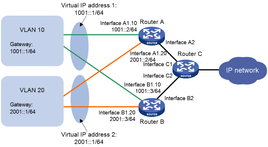

Specifying an IPv6 VRRP control VLAN
As shown in Figure 11, ambiguous VLAN termination is configured for VLAN 10 and VLAN 20 on the Layer 3 Ethernet subinterfaces on routers. To allow the master to regularly send IPv6 VRRP advertisements in multicast to the backups, enable the VLAN termination-enabled subinterfaces to transmit broadcast packets and multicast packets. Then, the master can send IPv6 VRRP advertisements within all VLANs whose VLAN packets are configured to be terminated by the subinterfaces. If ambiguous VLAN termination is configured on the Layer 3 Ethernet subinterfaces for a large range of VLANs, the IPv6 VRRP advertisements might overload the subinterfaces. This adversely affects the performance of the routers.
To resolve this problem, you can disable the VLAN termination-enabled subinterfaces from transmitting broadcast packets and multicast packets and configure an IPv6 VRRP control VLAN. The master sends IPv6 VRRP advertisements only within the control VLAN.
Figure 11 IPv6 VRRP control VLAN
Specify IPv6 VRRP control VLANs according to the VLAN termination type.
When IPv6 VRRP is operating in load balancing mode, you cannot specify the IPv6 VRRP control VLAN.
2.     Enter Layer 3 Ethernet subinterface view or Layer 3 aggregate subinterface view.
3.     Specify IPv6 VRRP control VLANs.
¡     Specify an IPv6 VRRP control VLAN for the ambiguous Dot1q termination-enabled subinterface.
vrrp ipv6 dot1q vid vlan-id
¡     Specify IPv6 VRRP control VLANs for the ambiguous QinQ termination-enabled subinterface.
vrrp ipv6 dot1q vid vlan-id secondary-dot1q secondary-vlan-id
By default, no IPv6 VRRP control VLAN is specified. The master sends IPv6 VRRP advertisements within all VLANs whose VLAN packets are configured to be terminated by the subinterface.

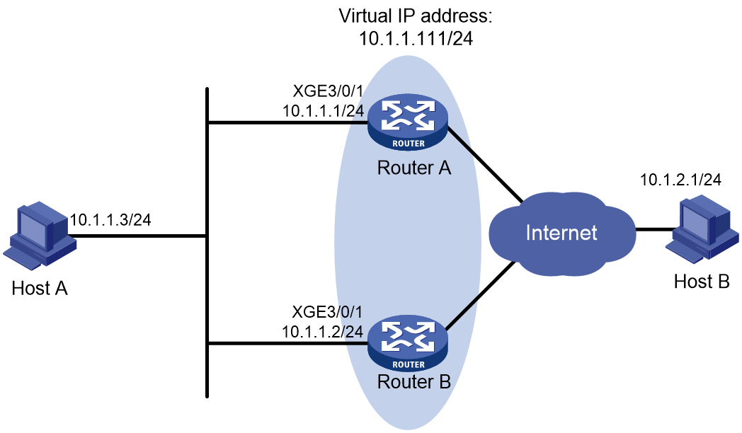

IPv4 VRRP configuration examples
Example: Configuring a single VRRP group
As shown in Figure 13, Router A and Router B form a VRRP group. They use the virtual IP address 10.1.1.111/24 to provide gateway service for the subnet where Host A resides.
Router A operates as the master to forward packets from Host A to Host B. When Router A fails, Router B takes over to forward packets for Host A.
Configure Router A to operate in preempt mode so Router A can forward traffic as long as Router A operates correctly. Set the preemption delay to 90000 centiseconds (15 minutes) to avoid frequent status change.
Figure 13 Network diagram

Example: Configuring multiple VRRP groups
As shown in Figure 14, Router A and Router B form two VRRP groups to implement load sharing and mutual backup. VRRP group 1 uses the virtual IP address 10.1.1.111/24 to provide gateway service for some hosts on the subnet 10.1.1.0/24. VRRP group 2 uses the virtual IP address 10.1.1.112/24 to provide gateway service for the other hosts on the subnet.
Figure 14 Network diagram
For load sharing between the VRRP groups, configure the default gateways 10.1.1.111 and 10.1.1.112 for the hosts on the subnet 10.1.1.0/24.

The output shows the following information:
·     Router A is operating as the master in VRRP group 1 to forward Internet traffic for hosts that use the default gateway 10.1.1.111/24.
·     Router B is operating as the master in VRRP group 2 to forward Internet traffic for hosts that use the default gateway 10.1.1.112/24.
Example: Configuring VRRP load balancing
As shown in Figure 15, Router A, Router B, and Router C form a load-balanced VRRP group. They use the virtual IP address 10.1.1.1/24 to provide gateway service for subnet 10.1.1.0/24.
Configure VFs on Router A, Router B, and Router C to monitor their respective Ten-GigabitEthernet 3/0/2. When the interface on any one of them fails, the weights of the VFs on the problematic router decrease so another AVF can take over.
Figure 15 Network diagram
1.     Configure Router A:
# Configure VRRP to operate in load balancing mode.
<RouterA> system-view
[RouterA] vrrp mode load-balance
# Create VRRP group 1, and set its virtual IP address to 10.1.1.1.
[RouterA] interface ten-gigabitethernet 3/0/1
[RouterA-Ten-GigabitEthernet3/0/1] ip address 10.1.1.2 24
[RouterA-Ten-GigabitEthernet3/0/1] vrrp vrid 1 virtual-ip 10.1.1.1
# Assign Router A the highest priority in VRRP group 1, so Router A can become the master.
[RouterA-Ten-GigabitEthernet3/0/1] vrrp vrid 1 priority 120
# Configure Router A to operate in preemptive mode, so it can become the master whenever it operates correctly. Set the preemption delay to 5000 centiseconds to avoid frequent status switchover.
[RouterA-Ten-GigabitEthernet3/0/1] vrrp vrid 1 preempt-mode delay 5000
[RouterA-Ten-GigabitEthernet3/0/1] quit
# Create track entry 1 to monitor the upstream link status of Ten-GigabitEthernet 3/0/2. When the upstream link fails, the track entry transits to Negative.
[RouterA] track 1 interface ten-gigabitethernet 3/0/2
# Configure the VFs in VRRP group 1 to monitor track entry 1, and decrease their weights by 250 when the track entry transits to Negative.
[RouterA-Ten-GigabitEthernet3/0/1] vrrp vrid 1 track 1 weight reduced 250
2.     Configure Router B:
<RouterB> system-view
[RouterB] vrrp mode load-balance
[RouterB] interface ten-gigabitethernet 3/0/1
[RouterB-Ten-GigabitEthernet3/0/1] ip address 10.1.1.3 24
[RouterB-Ten-GigabitEthernet3/0/1] vrrp vrid 1 virtual-ip 10.1.1.1
# Assign Router B a higher priority than Router C in VRRP group 1, so Router B can become the master when Router A fails.
[RouterB-Ten-GigabitEthernet3/0/1] vrrp vrid 1 priority 110
# Configure Router B to operate in preemptive mode without setting a preemption delay.
[RouterB-Ten-GigabitEthernet3/0/1] vrrp vrid 1 preempt-mode
[RouterB-Ten-GigabitEthernet3/0/1] quit
[RouterB] track 1 interface ten-gigabitethernet 3/0/2
[RouterB-Ten-GigabitEthernet3/0/1] vrrp vrid 1 track 1 weight reduced 250
3.     Configure Router C:
<RouterC> system-view
[RouterC] vrrp mode load-balance
# Create VRRP group 1, and set its virtual IP address as 10.1.1.1.
[RouterC] interface ten-gigabitethernet 3/0/1
[RouterC-Ten-GigabitEthernet3/0/1] ip address 10.1.1.4 24
[RouterC-Ten-GigabitEthernet3/0/1] vrrp vrid 1 virtual-ip 10.1.1.1
# Configure Router C to operate in preemptive mode without setting a preemption delay.
[RouterC-Ten-GigabitEthernet3/0/1] vrrp vrid 1 preempt-mode
[RouterC-Ten-GigabitEthernet3/0/1] quit
[RouterC] track 1 interface ten-gigabitethernet 3/0/2
[RouterC-Ten-GigabitEthernet3/0/1] vrrp vrid 1 track 1 weight reduced 250
# Verify that Host A can ping the external network. (Details not shown.)
# Display detailed information about VRRP group 1 on Router A.
[RouterA-Ten-GigabitEthernet3/0/1] display vrrp verbose
IPv4 virtual router information:
 Running mode      : Load balance
 Enhanced sending of gratuitous ARP packets : Disabled
 Total number of virtual routers : 1
   Interface Ten-GigabitEthernet3/0/1
     VRID             : 1                    Adver timer  : 100 centiseconds
     Admin status     : Up                   State        : Master
     Config pri       : 120                  Running pri  : 120
     Preempt mode     : Yes                  Delay time   : 5000 centiseconds
     Auth type        : None
     Version          : 3
     Virtual IP       : 10.1.1.1
     Member IP list   : 10.1.1.2 (Local, Master)
                        10.1.1.3 (Backup)
                        10.1.1.4 (Backup)
     First connection : 2023/05/09 22:46:01.244
     Last status change : 2023/05/09 22:46:01.244
   Forwarder information: 3 Forwarders 1 Active
     Config weight  : 255
     Running weight : 255
    Forwarder 01
     State          : Active
     Virtual MAC    : 000f-e2ff-0011 (Owner)
     Owner ID       : 0000-5e01-1101
     Priority       : 255
     Active         : local
    Forwarder 02
     State          : Listening
     Virtual MAC    : 000f-e2ff-0012 (Learnt)
     Owner ID       : 0000-5e01-1103
     Priority       : 127
     Active         : 10.1.1.3
    Forwarder 03
     State          : Listening
     Virtual MAC    : 000f-e2ff-0013 (Learnt)
     Owner ID       : 0000-5e01-1105
     Priority       : 127
     Active         : 10.1.1.4
   Forwarder weight track information:
     Track object   : 1          State : Positive   Weight reduced : 250
# Display detailed information about VRRP group 1 on Router B.
[RouterB-Ten-GigabitEthernet3/0/1] display vrrp verbose
     Admin status     : Up                   State        : Backup
     Config pri       : 110                  Running pri  : 110
     Become master    : 426ms milliseconds left
     Auth type        : None
     Version          : 3
     Member IP list   : 10.1.1.3 (Local, Backup)
                        10.1.1.2 (Master)
                        10.1.1.4 (Backup)
     Config weight  : 255
    Forwarder 01
     State          : Listening
     Virtual MAC    : 000f-e2ff-0011 (Learnt)
     Priority       : 127
     Active         : 10.1.1.2
    Forwarder 02
     State          : Active
     Virtual MAC    : 000f-e2ff-0012 (Owner)
     Priority       : 255
     Active         : local
    Forwarder 03
     State          : Listening
     Priority       : 127
     Active         : 10.1.1.4
# Display detailed information about VRRP group 1 on Router C.
[RouterC-Ten-GigabitEthernet3/0/1] display vrrp verbose
     Config pri       : 100                  Running pri  : 100 centiseconds
     Become master    : 417 milliseconds left
     Auth type        : None
     Version          : 3
     Member IP list   : 10.1.1.4 (Local, Backup)
                        10.1.1.2 (Master)
                        10.1.1.3 (Backup)
     Config weight  : 255
    Forwarder 01
     State          : Listening
     Priority       : 127
     Active         : 10.1.1.2
    Forwarder 02
     State          : Listening
     Priority       : 127
     Active         : 10.1.1.3
    Forwarder 03
     State          : Active
     Virtual MAC    : 000f-e2ff-0013 (Owner)
     Priority       : 255
     Active         : local
The output shows that Router A is the master in VRRP group 1, and each of the three routers has one AVF and two LVFs.
     Auth type        : None
     Version          : 3
                        10.1.1.2 (Master)
                        10.1.1.3 (Backup)
   Forwarder information: 2 Forwarders 1 Active
     Config weight  : 255
    Forwarder 02
     State          : Listening
     Priority       : 127
     Active         : 10.1.1.3
    Forwarder 03
     State          : Active
     Priority       : 255
     Active         : local
The output shows that when the timeout timer expires, the VF for virtual MAC address 000f-e2ff-0011 is removed. The VF no longer forwards the packets destined for the MAC address.
# When Router A fails, display detailed information about VRRP group 1 on Router B.
     Auth type        : None
     Version          : 3
     Member IP list   : 10.1.1.3 (Local, Master)
                        10.1.1.4 (Backup)
     Config weight  : 255
    Forwarder 02
     State          : Active
     Priority       : 255
     Active         : local
    Forwarder 03
     State          : Listening
     Priority       : 127
     Active         : 10.1.1.4
·     When Router A fails, Router B becomes the master because it has a higher priority than Router C.
·     The VF for virtual MAC address 000f-e2ff-0011 is removed.
IPv6 VRRP configuration examples
As shown in Figure 16, Router A and Router B form a VRRP group. They use the virtual IP addresses 1::10/64 and FE80::10 to provide gateway service for the subnet where Host A resides.
Host A learns 1::10/64 as its default gateway from RA messages sent by the routers.
Figure 16 Network diagram
# Specify an IPv6 address for Router A.
[RouterA-Ten-GigabitEthernet3/0/1] ipv6 address fe80::1 link-local
[RouterA-Ten-GigabitEthernet3/0/1] ipv6 address 1::1 64
# Create VRRP group 1, and set its virtual IPv6 addresses to FE80::10 and 1::10.
[RouterA-Ten-GigabitEthernet3/0/1] vrrp ipv6 vrid 1 virtual-ip fe80::10 link-local
[RouterA-Ten-GigabitEthernet3/0/1] vrrp ipv6 vrid 1 virtual-ip 1::10
# Assign Router A a higher priority than Router B in VRRP group 1, so Router A can become the master.
[RouterA-Ten-GigabitEthernet3/0/1] vrrp ipv6 vrid 1 priority 110
[RouterA-Ten-GigabitEthernet3/0/1] vrrp ipv6 vrid 1 preempt-mode delay 5000
# Enable Router A to send RA messages, so Host A can learn the default gateway address.
[RouterA-Ten-GigabitEthernet3/0/1] undo ipv6 nd ra halt
# Specify an IPv6 address for Router B.
[RouterB-Ten-GigabitEthernet3/0/1] ipv6 address fe80::2 link-local
[RouterB-Ten-GigabitEthernet3/0/1] ipv6 address 1::2 64
[RouterB-Ten-GigabitEthernet3/0/1] vrrp ipv6 vrid 1 virtual-ip fe80::10 link-local
[RouterB-Ten-GigabitEthernet3/0/1] vrrp ipv6 vrid 1 virtual-ip 1::10
[RouterB-Ten-GigabitEthernet3/0/1] vrrp ipv6 vrid 1 preempt-mode
# Enable Router B to send RA messages, so Host A can learn the default gateway address.
[RouterB-Ten-GigabitEthernet3/0/1] undo ipv6 nd ra halt
# Ping Host B from Host A. (Details not shown.)
[RouterA-Ten-GigabitEthernet3/0/1] display vrrp ipv6 verbose
IPv6 virtual router information:
 Running mode      : Standard
 Enhanced sending of gratuitous ND packets: Disabled
     Auth type        : None
     Virtual IP       : FE80::10
                        1::10
     Virtual MAC      : 0000-5e00-0201
     Master IP        : FE80::1
     First connection : 2023/05/09 22:46:02.270
     Last status change : 2023/05/09 22:46:02.270
[RouterB-Ten-GigabitEthernet3/0/1] display vrrp ipv6 verbose
     Become master    : 411 milliseconds left
     Auth type        : None
                        1::10
     Master IP        : FE80::1
The output shows that Router A is operating as the master in VRRP group 1 to forward packets from Host A to Host B.
# Disconnect the link between Host A and Router A, and verify that Host A can still ping Host B. (Details not shown.)
     Auth type        : None
                        1::10
     Master IP        : FE80::2
The output shows that when Router A fails, Router B takes over to forward packets from Host A to Host B.
# Recover the link between Host A and Router A, and display detailed information about VRRP group 1 on Router A.
     Auth type        : None
                        1::10
     Master IP        : FE80::1
The output shows that after Router A resumes normal operation, it becomes the master to forward packets from Host A to Host B.
As shown in Figure 18, Router A, Router B, and Router C form a load balanced VRRP group and use the virtual IPv6 addresses FE80::10 and 1::10 to provide gateway service for the subnet 1::/64.
Hosts on subnet 1::/64 learn 1::10 as their default gateway from RA messages sent by the routers.
Configure VFs on Router A, Router B, or Router C to monitor their respective Ten-GigabitEthernet 3/0/2. When the interface on any of them fails, the weights of the VFs on the problematic router decrease so another AVF can take over.
Figure 18 Network diagram
