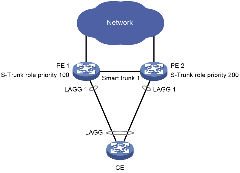

S-Trunk network model
As shown in Figure 2, each member device in the S-Trunk system is assigned the primary or secondary role based on its S-Trunk role priority. When both devices are operating correctly, only the primary S-Trunk member device forwards traffic. When the primary S-Trunk member device fails, the secondary S-Trunk member device takes over to forward all traffic.
A smart trunk contains two CE-facing aggregate interfaces as its member interfaces. S-Trunk also defines the primary and secondary roles for the member interfaces in a smart trunk. For the same smart trunk, typically the role of a smart trunk member interface is the same as the role of the S-Trunk member device that hosts that interface.

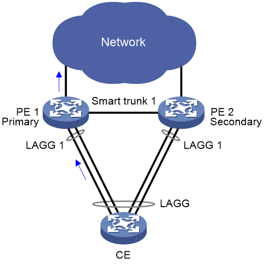

Typical traffic forwarding process
When both S-Trunk member devices are operating correctly, the smart trunk member interface on the primary member device forwards traffic. As shown in Figure 4, interface LAGG 1 on primary member device PE 1 is forwarding the traffic of CE 1. Interface LAGG 1 on PE 2 is the secondary member interface and is placed in down state.

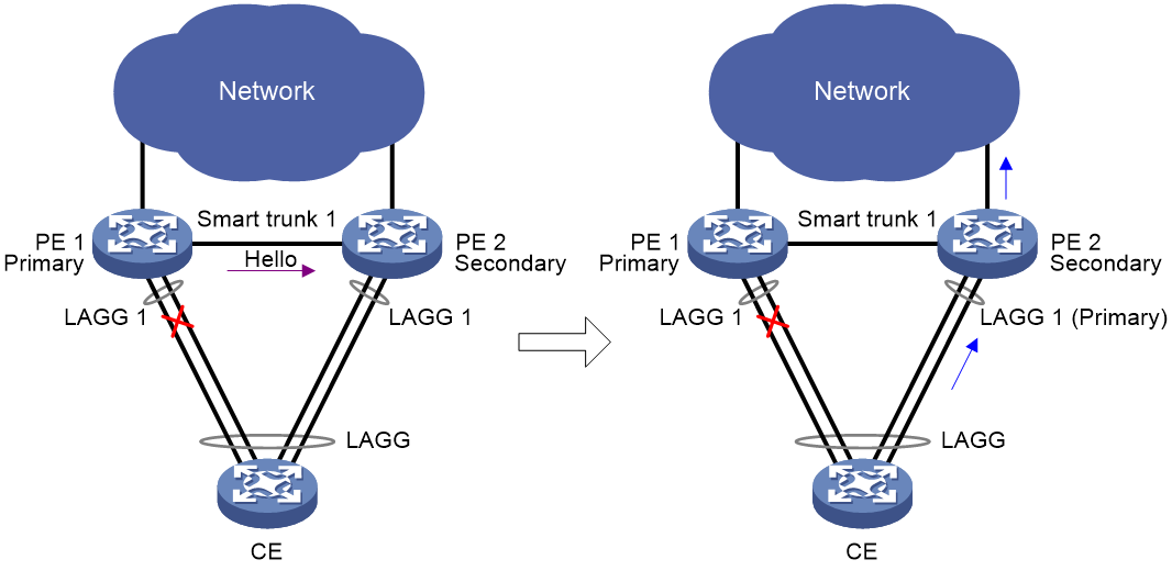

Primary member interface failure handling mechanism
When the primary member interface in a smart trunk fails, the smart trunk forwards traffic through the other member interface.
As shown in Figure 5, when the link between the CE and PE 1 fails, PE 1 notifies PE 2 of the failure of LAGG 1 through S-Trunk hello packets. After receiving the S-Trunk hello packets, PE 2 assigns the primary role to its LAGG 1 and brings the interface up to forward the traffic of the CE.

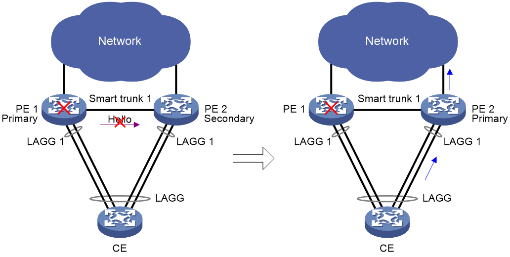

Primary member device failure handling mechanism
When the primary member device fails, the secondary member device takes over the primary role to forward all traffic.
As shown in Figure 6, if PE 1 fails, PE 2 cannot receive S-Trunk hello packets and determines that PE 1 is down upon expiration of the S-Trunk protocol packet timeout. Then, PE 2 becomes the primary member device and brings up LAGG 1 to forward the traffic of the CE.

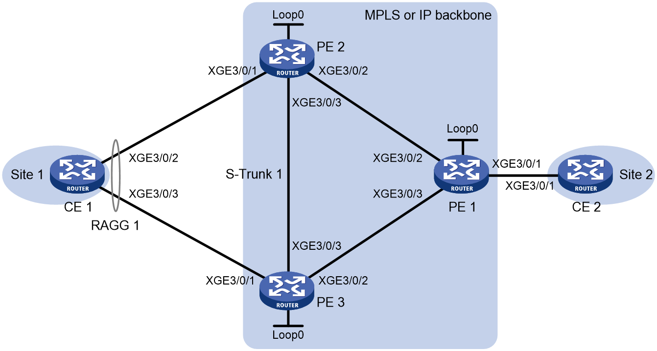

Example: Configuring S-Trunk in an MPLS L2VPN network
As shown in Figure 8:
·     Configure MPLS L2VPN for CE 1 and CE 2 to communicate. CE 1 is dual-homed to PE 2 and PE 3.
·     Configure S-Trunk on PE 2 and PE 3 to establish a multichassis aggregate link with CE 1. Configure PE 2 and PE 3 as the primary and secondary devices, respectively.
Figure 8 Network diagram
Table 1 IP address assignment
Device
Interface
IP address
Device
Interface

# Verify that Ten-GigabitEthernet 3/0/2 is a Selected aggregation member port on CE 1.
[CE1] display link-aggregation verbose route-aggregation 1
Loadsharing Type: Shar -- Loadsharing, NonS -- Non-Loadsharing
Port Status: S -- Selected, U -- Unselected, I -- Individual
Port: A -- Auto
Flags:  A -- LACP_Activity, B -- LACP_Timeout, C -- Aggregation,
        G -- Defaulted, H -- Expired
Aggregate Interface: Route-Aggregation1
Aggregation Mode: Dynamic
System ID: 0x8000, 90e7-10f9-5000
Local:
  Port                Status   Priority Index    Oper-Key               Flag
  XGE3/0/2            S        32768    1        1                      {ACDEF}
  XGE3/0/3            U        32768    2        1                      {ACD}
Remote:
  Actor               Priority Index    Oper-Key SystemID               Flag
  XGE3/0/2            32768    16385    24577    0xa   , 0001-0001-0001 {ACDEF}
  XGE3/0/3            32768    32769    24577    0xa   , 0001-0001-0001 {AC}
# Verify that PE 2 and PE 3 are the primary and secondary S-Trunk member devices, respectively.
[PE2] display s-trunk verbose 1
                            Trunk-wide info and statistics
S-Trunk ID: 1
Revert: Enabled                       Revert-delay(s): 120
Local bridge MAC: 00fc-3423-d800      Peer bridge MAC: 84d9-3125-7800
Local priority: 32768                 Peer priority: 32768
DevRole (Trigger): Primary (PRIORITY)
DestIP: 10.1.3.2
SrcIP: 10.1.3.1
Local hello interval(100ms): 100      Local hello timeout(100ms): 2000
InStrunkPDUs: 16571                   OutStrunkPDUs: 16603
InDrops: 0                            OutDrops: 36
Peer hello interval(100ms): 100       Peer hello timeout(100ms): 2000
Sequence number check: Disabled
BFD-Session: bfd1
VPN instance: -
Description: -
                            Trunk member info
Local    LinkState   ConfigRole    OperRole (Trigger)            Peer
RAGG1    UP          auto          Primary (PEER_MEMBER_DOWN)    RAGG1
[PE3] display s-trunk verbose 1
S-Trunk ID: 1
Local bridge MAC: 84d9-3125-7800      Peer bridge MAC: 00fc-3423-d800
DevRole (Trigger): Secondary (PRIORITY)
DestIP: 10.1.3.1
SrcIP: 10.1.3.2
InStrunkPDUs: 16580                   OutStrunkPDUs: 16621
InDrops: 0                            OutDrops: 37
BFD-Session: bfd1
VPN instance: -
Description: -
                            Trunk member info
RAGG1    DOWN        auto          Secondary (PEER_MEMBER_UP)    RAGG1
