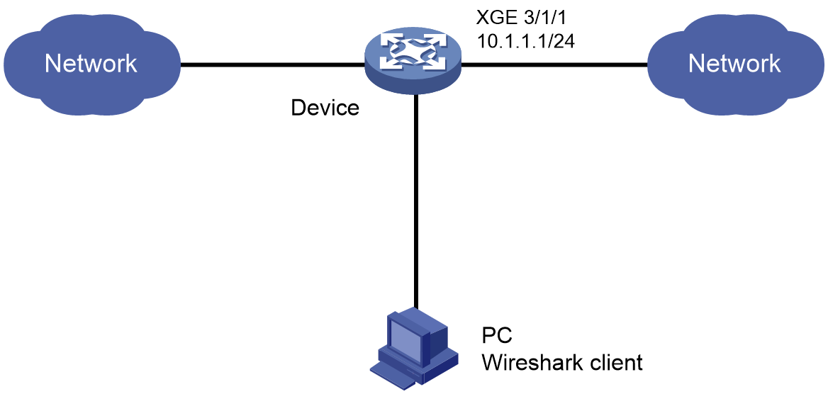

Example: Configuring remote packet capture
As shown in Figure 1, capture incoming packets on Layer 3 interface Ten-GigabitEthernet 3/1/1 and use Wireshark to display the captured packets.
Figure 1 Network diagram
1.     Configure the device:
# Configure remote incoming packet capture on Ten-GigabitEthernet 3/1/1. Set the RPCAP service port number to 2014.
<Device> packet-capture remote interface ten-gigabitethernet 3/1/1 port 2014
2.     Configure Wireshark:
a.     Start Wireshark on the PC and select Capture > Options.
b.     Select Remote from the Interface list.
c.     Enter the IP address of the device 10.1.1.1 and the RPCAP service port number 2014. Make sure there are routes available between the IP address and the PC.
d.     Click OK and then click Start.
The captured packets are displayed on the Wireshark.
Options and option placement available with Wireshark might differ depending on its version.
