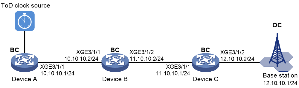

Figure 1 shows the positions of these basic clock nodes in a PTP domain.
Figure 1 Clock nodes and PTP ports in a PTP domain (IEEE 1588 version 2)
In addition to these basic types of clock nodes, PTP introduces hybrid clock nodes. For example, a TC+OC has multiple PTP ports in a PTP domain. One port is the OC type, and the others are the TC type.
A TC+OC forwards PTP messages through TC-type ports and performs delay corrections. In addition, it synchronizes time through its OC-type port. TC+OCs include these types: E2ETC+OC and P2PTC+OC.

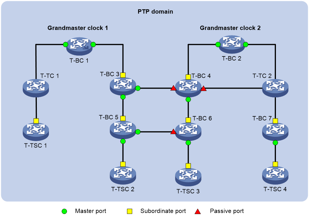

Figure 2 Clock nodes and PTP ports in a PTP domain (ITU-T G.8275.1)

Configuring clock priorities
Configuring a priority for a clock (IEEE 1588 version 2)
Priorities for clocks are used to elect the GM. The smaller the priority value, the higher the priority.
2.     Configure the priority for a clock .
ptp priority clock-source { local | tod0 | tod1 } { priority1 priority1 | priority2 priority2 }
When the PTP profile is IEEE 1588 version 2, the priority 1 and priority 2 default values are both 128.
Configuring a priority for a clock (ITU-T G.8275.1 and ITU-T G.8275.2)
Under the ITU-T G.8275.1 or ITU-T G.8275.2 PTP profile, you can configure priorities for the local clock node and the peer clock node.
Priorities for clocks affect the GM election. The smaller the priority value, the higher the priority. For more information about GM election, see "Grandmaster clock selection and master-member/subordinate relationship establishment."
This task is available only under the ITU-T G.8275.1 and ITU-T G.8275.2 PTP profiles.
Configuring priorities for the local clock node
2.     Configure the priority for a clock.
ptp priority clock-source { local | tod0 | tod1 } { priority2 priority2 | local-priority local-priority }
By default, the priority 2 value is 128 for T-BC, T-TC, and T-BC-P clock nodes and 255 for T-TSC and T-TSC-P clock nodes. The local priority value is 128.
Configuring a priority for the peer clock node
An announce message does not carry the local priority of the clock node. Each PTP interface on a clock node has a local priority. You can use the ptp local-priority command to configure a local priority for a PTP interface. This priority will be used as the local priority of the peer node in BMC selection and is one of the factors that determine whether the peer node can be elected as the GM.
To configure a priority for the peer clock node:
Enter Layer 2 Ethernet interface view, Layer 3 Ethernet interface view, or FlexE physical interface view.
2.     Configure a priority for the peer clock node.
ptp local-priority local-priority
By default, the clock priority of the peer clock node is 128.

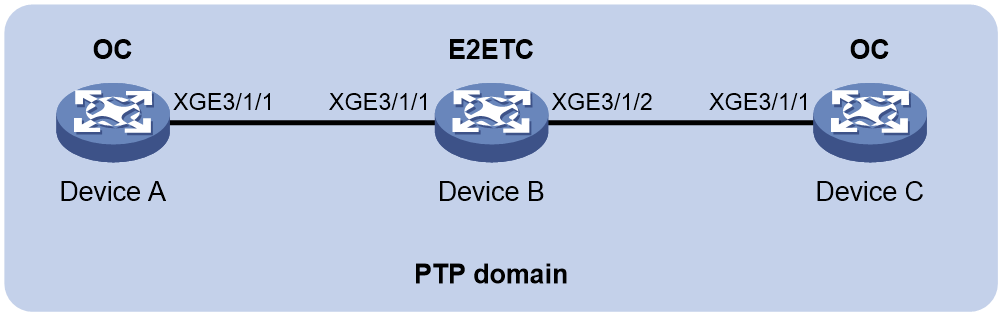

Example: Configuring PTP (IEEE 1588 version 2, IEEE 802.3/Ethernet transport, multicast transmission)
As shown in Figure 6, configure PTP (IEEE 1588 version 2, IEEE 802.3/Ethernet transport, multicast transmission) to enable time synchronization between Device A and Device C.
·     Specify the IEEE 1588 version 2 PTP profile and multicast IEEE 802.3/Ethernet transport of PTP messages for Device A, Device B, and Device C.
·     Assign Device A, Device B, and Device C to the same PTP domain. Specify the OC clock node type for Device A and Device C, and E2ETC clock node type for Device B. All clock nodes elect a GM through BMC in the PTP domain.
·     Use the default Request_Response delay measurement mechanism on Device A and Device C.
Figure 6 Network diagram
1.     Configure Device A:
# Specify the IEEE 1588 version 2 PTP profile.
<DeviceA> system-view
[DeviceA] ptp profile 1588v2
# Specify the OC clock node type.
[DeviceA] ptp mode oc
# Specify PTP for obtaining the time on the default MDC.
[DeviceA] clock protocol ptp mdc 1
# Enable PTP on Ten-GigabitEthernet 3/1/1.
[DeviceA] interface ten-gigabitethernet 3/1/1
[DeviceA-Ten-GigabitEthernet3/1/1] ptp enable
[DeviceA-Ten-GigabitEthernet3/1/1] quit
2.     Configure Device B:
<DeviceB> system-view
[DeviceB] ptp profile 1588v2
# Specify the E2ETC clock node type.
[DeviceB] ptp mode e2etc
[DeviceB] clock protocol ptp mdc 1
[DeviceB] interface ten-gigabitethernet 3/1/1
[DeviceB-Ten-GigabitEthernet3/1/1] ptp enable
[DeviceB-Ten-GigabitEthernet3/1/1] quit
# Enable PTP on Ten-GigabitEthernet 3/1/2.
[DeviceB] interface ten-gigabitethernet 3/1/2
[DeviceB-Ten-GigabitEthernet3/1/2] ptp enable
[DeviceB-Ten-GigabitEthernet3/1/2] quit
3.     Configure Device C:
<DeviceC> system-view
[DeviceC] ptp profile 1588v2
[DeviceC] ptp mode oc
[DeviceC] clock protocol ptp mdc 1
[DeviceC] interface ten-gigabitethernet 3/1/1
[DeviceC-Ten-GigabitEthernet3/1/1] ptp enable
[DeviceC-Ten-GigabitEthernet3/1/1] quit
When the network is stable, perform the following tasks:
·     Use the display ptp clock command to display PTP clock information.
·     Use the display ptp interface brief command to display brief PTP running information for all PTP interfaces.
# Display PTP clock information on Device A.
[DeviceA] display ptp clock
PTP profile         : IEEE 1588 Version 2
PTP mode            : OC
Slave only          : No
Sync uncertain      : Disabled
Clock state         : Disabled
Lock status         : Unlocked
Clock ID            : 000FE2-FFFE-FF0000
Clock type          : Local
Clock domain        : 0
Number of PTP ports : 1
Priority1     : 128
Priority2     : 128
Clock quality :
 Class                 : 248
 Accuracy              : 254
 Offset (log variance) : 65535
Offset from master : 0 (ns)
Mean path delay    : 0 (ns)
Steps removed      : 0
Local clock time   : Sun Jan 15 20:57:29 2019
Clock source info:
 Clock   Pri1 Pri2 Accuracy Class TimeSrc Direction In-Status Offset(log variance)
 Local   128  128  254      248   160     N/A       N/A       65535
 ToD0    128  128  32       6     32      In        Inactive  65535
 ToD1    128  128  32       6     32      N/A       Inactive  65535
# Display brief PTP running information for all PTP interfaces on Device A.
[DeviceA] display ptp interface brief
Name         State         Delay mechanism  Clock step  Asymmetry correction
XGE3/1/1     Master        E2E              Two         0
# Display PTP clock information on Device B.
[DeviceB] display ptp clock
PTP mode            : E2ETC
Slave only          : No
Clock ID            : 000FE2-FFFE-FF0001
Clock type          : Local
Clock domain        : 0
Number of PTP ports : 2
Priority1     : 128
Priority2     : 128
Clock quality :
 Class                 : 248
 Accuracy              : 254
Offset from master : N/A
Mean path delay    : N/A
Steps removed      : N/A
Clock source info:
# Display brief PTP running information for all PTP interfaces on Device B.
[DeviceB] display ptp interface brief
XGE3/1/1     N/A           E2E              Two         0
XGE3/1/2     N/A           E2E              Two         0
The output shows that Device A is elected as the GM, and Ten-GigabitEthernet3/1/1 on Device A is the master port.

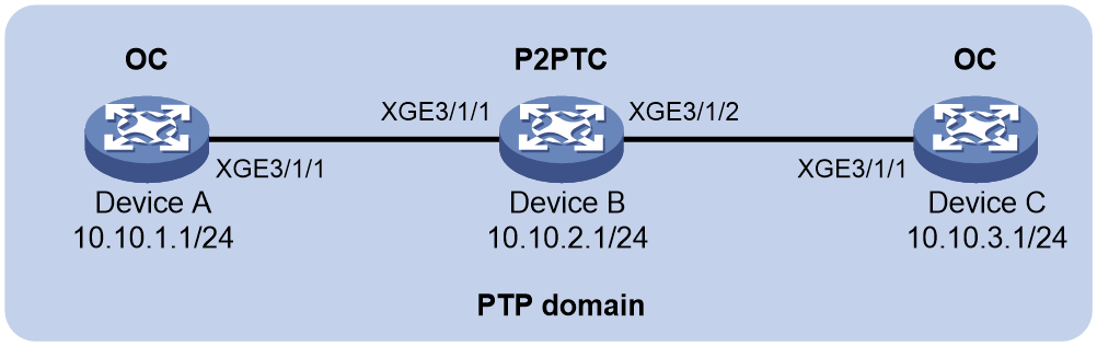

Example: Configuring PTP (IEEE 1588 version 2, IPv4 UDP transport, multicast transmission)
As shown In Figure 7, configure PTP (IEEE 1588 version 2, IPv4 UDP transport, multicast transmission) to enable time synchronization between the devices.
·     Specify the IEEE 1588 version 2 PTP profile and multicast IPv4 UDP transport of PTP messages for Device A, Device B, and Device C.
·     Assign Device A, Device B, and Device C to the same PTP domain. Specify the OC clock node type for Device A and Device C, and P2PTC clock node type for Device B. All clock nodes elect a GM through BMC in the PTP domain.
·     Specify the peer delay measurement mechanism (p2p) for Device A and Device C.
Figure 7 Network diagram
# Configure the source IP address for multicast PTP messages transmitted over IPv4 UDP.
[DeviceA] ptp source 10.10.1.1
# On Ten-GigabitEthernet 3/1/1, specify the IPv4 UDP transport protocol for PTP messages and the peer delay measurement mechanism, and enable PTP.
[DeviceA-Ten-GigabitEthernet3/1/1] ptp transport-protocol udp
[DeviceA-Ten-GigabitEthernet3/1/1] ptp delay-mechanism p2p
# Specify the P2PTC clock node type.
[DeviceB] ptp mode p2ptc
[DeviceB] ptp source 10.10.2.1
# On Ten-GigabitEthernet 3/1/1, specify the IPv4 UDP transport protocol for PTP messages and enable PTP.
[DeviceB-Ten-GigabitEthernet3/1/1] ptp transport-protocol udp
# On Ten-GigabitEthernet 3/1/2, specify the IPv4 UDP transport protocol for PTP messages and enable PTP.
[DeviceB-Ten-GigabitEthernet3/1/2] ptp transport-protocol udp
[DeviceC] ptp source 10.10.3.1
[DeviceC-Ten-GigabitEthernet3/1/1] ptp transport-protocol udp
[DeviceC-Ten-GigabitEthernet3/1/1] ptp delay-mechanism p2p
When the network is stable, perform the following tasks on Device A and Device B.
PTP mode            : OC
Slave only          : No
Clock type          : Local
Clock domain        : 0
Priority1     : 128
Priority2     : 128
Clock quality :
 Class                 : 248
 Accuracy              : 254
Steps removed      : 0
Clock source info:
XGE3/1/1     Master        P2P              Two         0
PTP mode            : P2PTC
Slave only          : No
Clock type          : Local
Clock domain        : 0
Priority1     : 128
Priority2     : 128
Clock quality :
 Class                 : 248
 Accuracy              : 254
Steps removed      : N/A
Clock source info:
XGE3/1/1     N/A           P2P              Two         0

Example: Configuring PTP (IEEE 1588 version 2, IPv4 UDP transport, unicast transmission)
As shown in Figure 8, configure PTP (IEEE 1588 version 2, IPv4 UDP transport, unicast transmission) to enable Device A, Device B, Device C, and the base station to synchronize the time with the ToD clock source.
·     Specify the IEEE 1588 version 2 PTP profile and unicast IPv4 UDP transport of PTP messages for Device A, Device B, and Device C.
·     Assign Device A, Device B, Device C, and the base station to PTP domain 0. Specify the BC clock node type for Device A, Device B, and Device C.
·     Connect Device A to the ToD clock source and Device C to the base station.
·     Use the default Request_Response delay measurement mechanism on all clock nodes in the PTP domain.
Figure 8 Network diagram
1.     Assign IP addresses to the interfaces, and make sure the devices can reach each other, as shown in Figure 8. (Details not shown.)
2.     Configure Device A:
# Specify the BC clock node type.
[DeviceA] ptp mode bc
# Configure the device to receive ToD clock signals and set the delay time correction value to 1000 nanoseconds.
[DeviceA] ptp tod0 input delay 1000
# Set priority 1 to 0 for the ToD 0 clock.
[DeviceA] ptp priority clock-source tod0 priority1 0
# On Ten-GigabitEthernet 3/1/1, configure the destination IP address for unicast PTP messages transmitted over IPv4 UDP, and enable PTP.
[DeviceA-Ten-GigabitEthernet3/1/1] ptp unicast-destination 10.10.10.2
3.     Configure Device B:
[DeviceB] ptp mode bc
[DeviceB-Ten-GigabitEthernet3/1/1] ptp unicast-destination 10.10.10.1
# On Ten-GigabitEthernet 3/1/2, configure the destination IP address for unicast PTP messages transmitted over IPv4 UDP, and enable PTP.
[DeviceB-Ten-GigabitEthernet3/1/2] ptp unicast-destination 11.10.10.1
4.     Configure Device C:
[DeviceC] ptp mode bc
# Configure ToD 1to output ToD clock signals and set the transmit delay time correction value to 100 nanoseconds.
[DeviceC] ptp tod1output delay 100
[DeviceC-Ten-GigabitEthernet3/1/1] ptp unicast-destination 11.10.10.2
# On Ten-GigabitEthernet3/1/2, specify IPv4 UDP transport of PTP messages, configure the destination IP address for unicast PTP messages, and enable PTP.
[DeviceC] interface ten-gigabitethernet 3/1/2
[DeviceC-Ten-GigabitEthernet3/1/2] ptp transport-protocol udp
[DeviceC-Ten-GigabitEthernet3/1/2] ptp unicast-destination 12.10.10.1
[DeviceC-Ten-GigabitEthernet3/1/2] ptp enable
[DeviceC-Ten-GigabitEthernet3/1/2] quit
5.     Configure the base station.
# Specify PTP domain 0.
# Specify IPv4 UDP transport of PTP messages.
# Set the destination IP address of unicast PTP messages to 12.10.10.2.
# Specify the Request_Response delay measurement mechanism.
For more information, see the configuration guide for the base station.

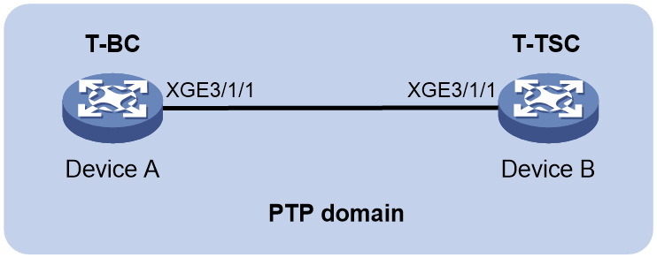

Example: Configuring PTP (ITU-T G.8275.1, IEEE 802.3/Ethernet transport, multicast transmission)
As shown in Figure 9, configure PTP (ITU-T G.8275.1, IEEE 802.3/Ethernet transport, multicast transmission) to enable Device A to synchronize Device B.
·     Specify the ITU-T G.8275.1 PTP profile for Device A and Device B.
·     Assign Device A and Device B to the same PTP domain. Specify the T-BC clock node type for Device A and T-TSC clock node type for Device B.
·     Use the default Request_Response delay measurement mechanism on Device A and Device B.
Figure 9 Network diagram
IMPORTANT
IMPORTANT:
The ITU-T G.8275.1 PTP profile transports PTP messages over IEEE 802.3/Ethernet rather than IPv4 UDP and in multicast rather than unicast mode.
# Specify the ITU-T G.8275.1 PTP profile.
[DeviceA] ptp profile g8275.1
# Specify the T-BC clock node type.
[DeviceA] ptp mode t-bc
[DeviceB] ptp profile g8275.1
# Specify the T-TSC clock node type.
[DeviceB] ptp mode t-tsc

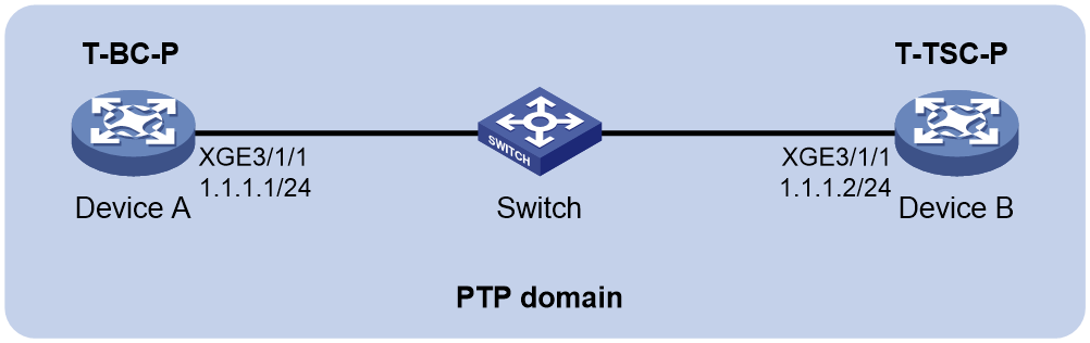

Example: Configuring PTP (ITU-T G.8275.2, IPv4 UDP encapsulation, unicast transmission)
As shown in Figure 10, Device A and Device B are in a PTP domain. The switch is a Layer 2 switch that does not support PTP. Configure PTP (ITU-TG.8275.2, IPv4 UDP encapsulation, unicast transmission) to enable Device B to synchronize to Device A.
·     Specify the ITU-TG.8275.2 PTP profile for Device A and Device B.
Figure 10 Network diagram
Configure IP addresses and routing protocols for the devices. Make sure the devices are reachable to each other.
IMPORTANT
IMPORTANT:
The ITU-T G.8275.2 PTP profile transports PTP messages over IPv4 UDP rather than IEEE 802.3/Ethernet and in unicast rather than multicast mode.
# Specify the ITU-T G.8275.2 PTP profile.
[DeviceA] ptp profile g8275.2
# Specify the T-BC-P clock node type.
[DeviceA] ptp mode t-bc-p
# Enable PTP and configure PTP parameters on Ten-GigabitEthernet 3/1/1.
[DeviceA-Ten-GigabitEthernet3/1/1] ptp unicast-destination 1.1.1.2
[DeviceA-Ten-GigabitEthernet3/1/1] ptp unicast-negotiate grant-port
[DeviceA-Ten-GigabitEthernet3/1/1] ptp notslave disable
[DeviceB] ptp profile g8275.2
# Specify the T-TSC-P clock node type.
[DeviceB] ptp mode t-tsc-p
[DeviceB-Ten-GigabitEthernet3/1/1] ptp unicast-destination 1.1.1.1
[DeviceB-Ten-GigabitEthernet3/1/1] ptp unicast-negotiate request-port
·     Use the display ptp interface brief command to display brief PTP running information for all interfaces.
PTP profile         : ITU-T G.8275.2
PTP mode            : T-BC-P
Slave only          : No
Clock ID            : 140570-FFFE-930100
Clock type          : Local
Clock domain        : 44
Priority1      : 128
Priority2      : 128
Clock quality :
 Class                 : 248
 Accuracy              : 254
Steps removed       : 0
Local clock time    : Sat May 9 10:38:42 2020
Clock source info:
 Clock   LP   Pri2 Accuracy Class TimeSrc Direction In-Status Offset(log variance)
 ToD0    128  128  32       6     32      N/A       Inactive  65535
# Display brief PTP running information on Device A.
PTP mode            : T-TSC-P
Slave only          : No
Clock ID            : 147405-FFFE-E30200
Clock type          : Local
Clock domain        : 44
Priority1      : 128
Priority2      : 255
Clock quality :
 Class                 : 255
 Accuracy              : 254
Offset from master  : 50 (ns)
Mean path delay     : 2169 (ns)
Steps removed       : 1
Local clock time    : Sat May 9 10:40:04 2020
Clock source info:
 Local   128  255  254      255   160     N/A       N/A       65535
 ToD0    128  255  254      255   32      N/A       Inactive  65535
 ToD1    128  255  254      255   32      N/A       Inactive  65535
# Display brief PTP running information on Device B.
GE1/0/2      Slave         E2E              Two         0
The output shows that Device A has been elected as the GM, and Ten-GigabitEthernet 3/1/1 on Device A is the master port.
