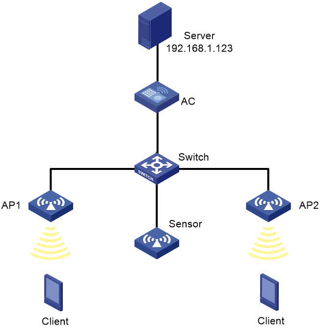

As shown in Figure 1, a WLAN probe system contains the following devices:
·     Sensors—APs enabled with WLAN probe. They scan the channels, collect wireless device information, and report the information to the server.
·     AC—Manages sensors and reports information received from sensors to the server.
·     Server—Analyzes the information received from sensors and the AC.
Figure 1 WLAN probe system

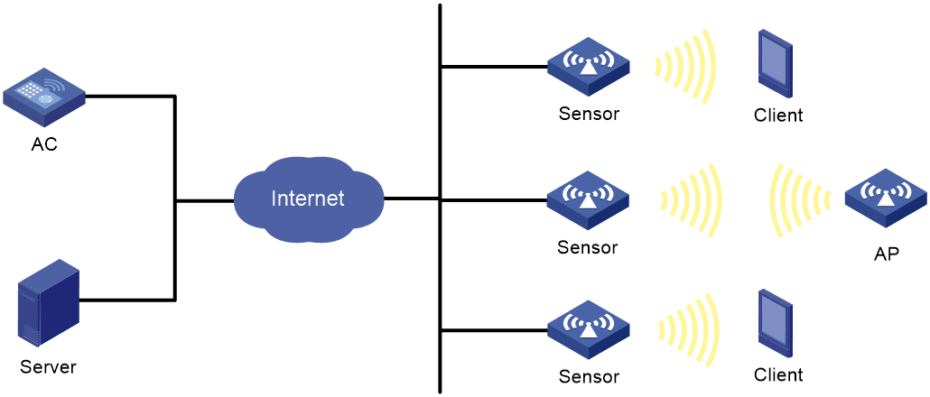

As shown in Figure 2, AP 1 and AP 2 provide wireless services for clients through SSID abc.
Enable WLAN probe on the sensor, and configure the AC to report the received wireless device information to the server.
Figure 2 Network diagram

# Create AP Sensor, and enable WLAN probe for the AP.
<AC> system-view
[AC] wlan ap Sensor model WA6320
[AC-wlan-ap-Sensor] serial-id 219801A28N819CE0002T
[AC-wlan-ap-Sensor] radio 1
[AC-wlan-ap-Sensor-radio-1] radio enable
[AC-wlan-ap-Sensor-radio-1] client-proximity-sensor enable
[AC-wlan-ap-Sensor-radio-1] quit
[AC-wlan-ap-Sensor] radio 2
[AC-wlan-ap-Sensor-radio-2] radio enable
[AC-wlan-ap-Sensor-radio-2] client-proximity-sensor enable
[AC-wlan-ap-Sensor] quit
# Configure the sensor to report wireless device information to the AC.
[AC] client-proximity-sensor report-ac enable
# Configure the AC to report wireless device information to the UDP server with IP address 192.168.1.123 and port number 1234, and set the report interval to 20 seconds.
[AC] client-proximity-sensor udp-server 192.168.1.123 port 1234 interval 20
# Display wireless device information detected by the sensor.
[AC] display client-proximity-sensor device
Total 3 detected devices
MAC address    Type      Duration    Sensors Channel Status
0021-632F-E9E5 Client    00h 10m 46s 1       11      Active
0021-6330-148B Client    00h 10m 46s 1       6       Active
0212-34B8-A8E0 Client    00h 10m 46s 1       1       Active
# On the management console of the server, view the wireless device information received from the AC. (Details not shown.)
