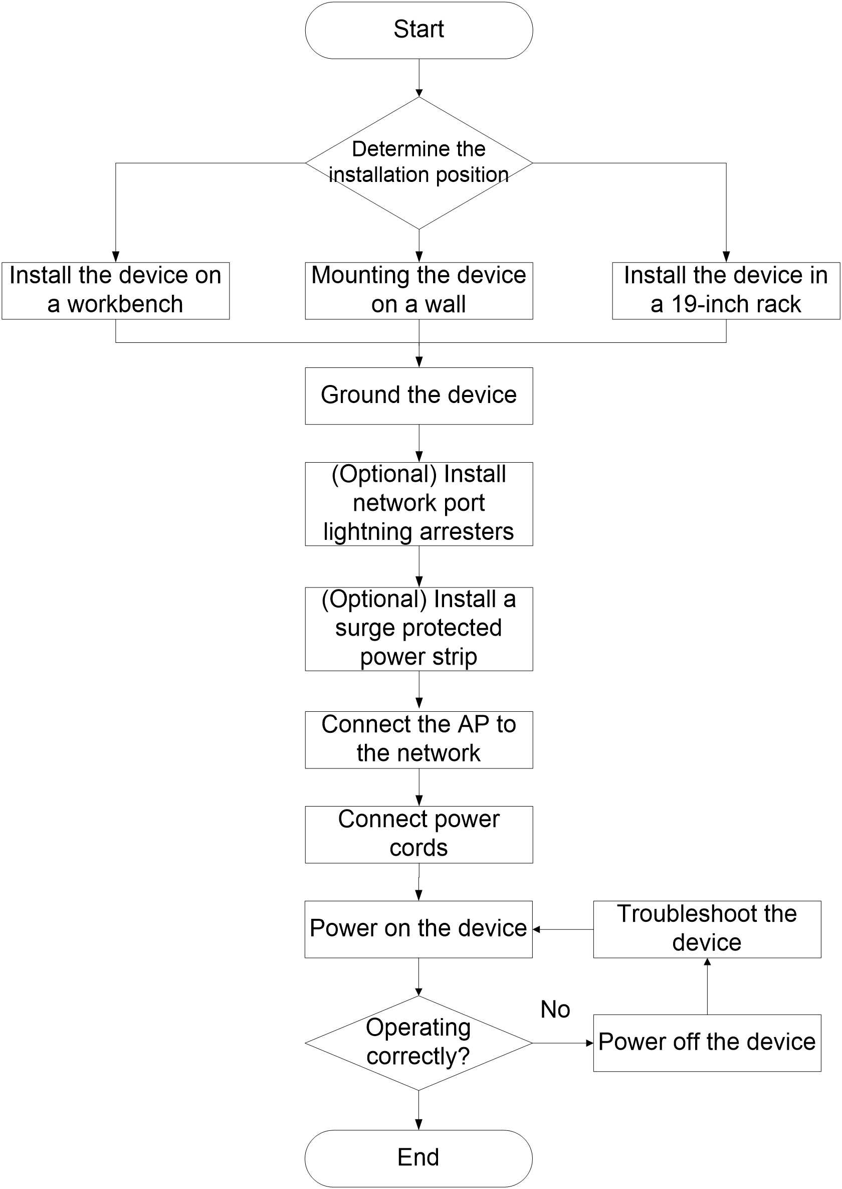

Installation flowchart
Figure2-1 Installation flowchart

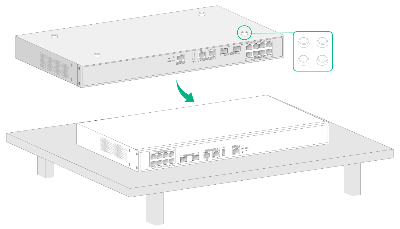

To mount the device on a workbench:
1.     Place the device upside down. Clean the recessed areas on the chassis bottom.
2.     Attach the four rubber feet to the recessed areas on the chassis bottom.
3.     Place the device on the workbench with the upside up. Make sure the four rubber feet stand firmly on the workbench.
Figure2-2 Mounting the device on a workbench

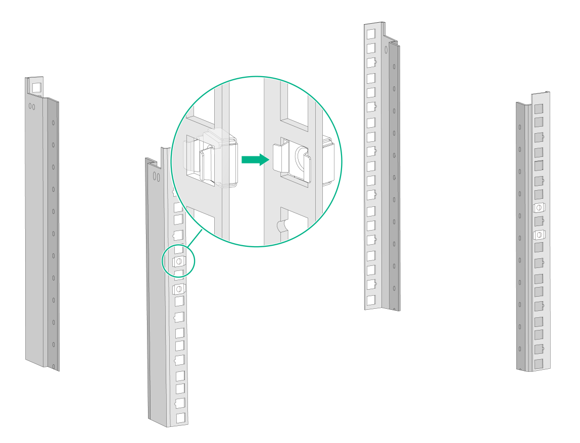

2.     Attach cage nuts to the front rack posts:
a.     Use a mounting bracket to mark cage nut installation positions on the two front rack posts.
b.     Install cage nuts into the marked square holes on the front rack posts.
Figure2-3 Installing cage nuts

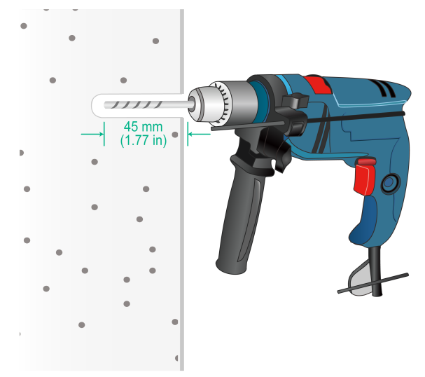

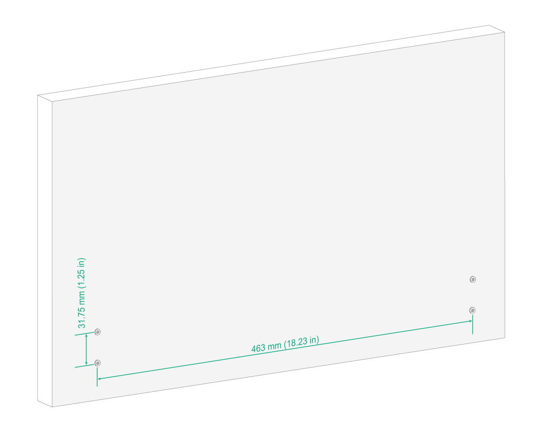

1.     Drill four 8 mm (0.32 in) diameter holes at spacing shown in Figure2-6 in the wall.
Figure2-6 Installation hole spacing
Figure2-7 Drilling installation holes

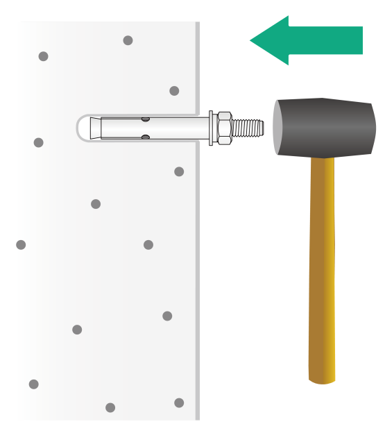

2.     Hammer a wall anchor into each hole until the flat washer is flush with the wall and then remove the nut, spring washer, and flash washer from the anchor bolt in sequence.
Figure2-8 Hammering the wall anchor into the wall

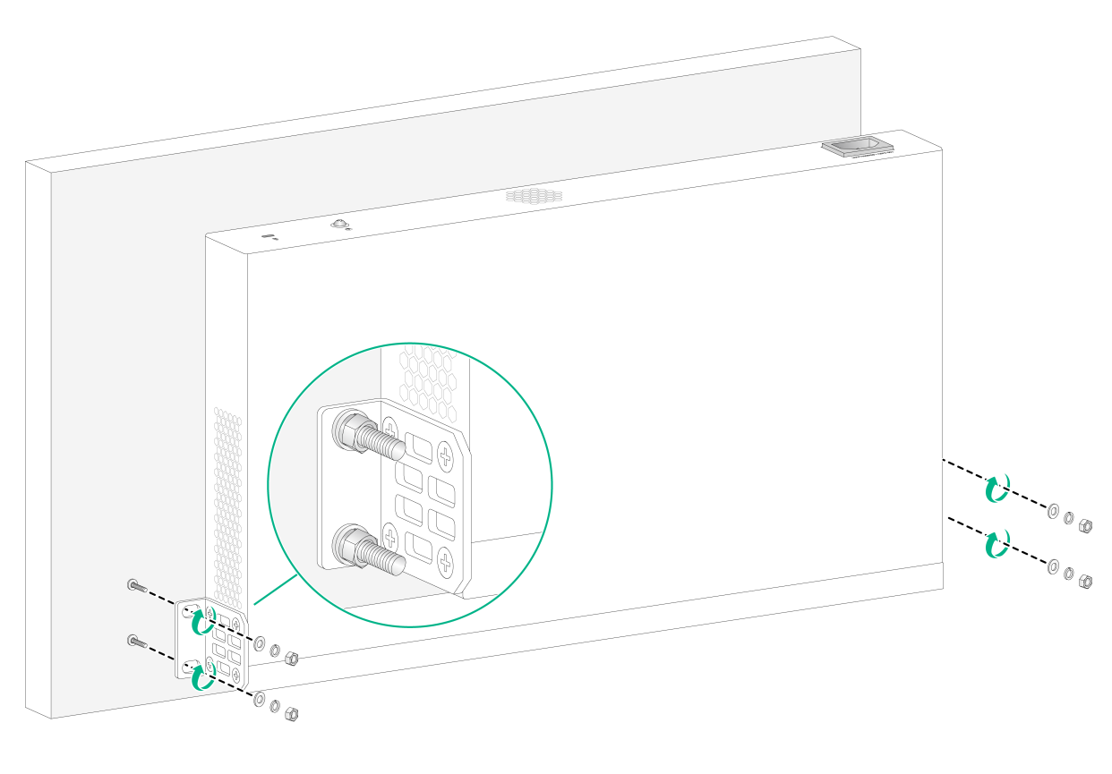

3.     Mount the device on the wall anchors by using the mounting brackets attached to the device and then install the flat washer, spring washer, and nut in sequence and then fasten the nut on the wall anchors.
Figure2-9 Mounting the device on the wall

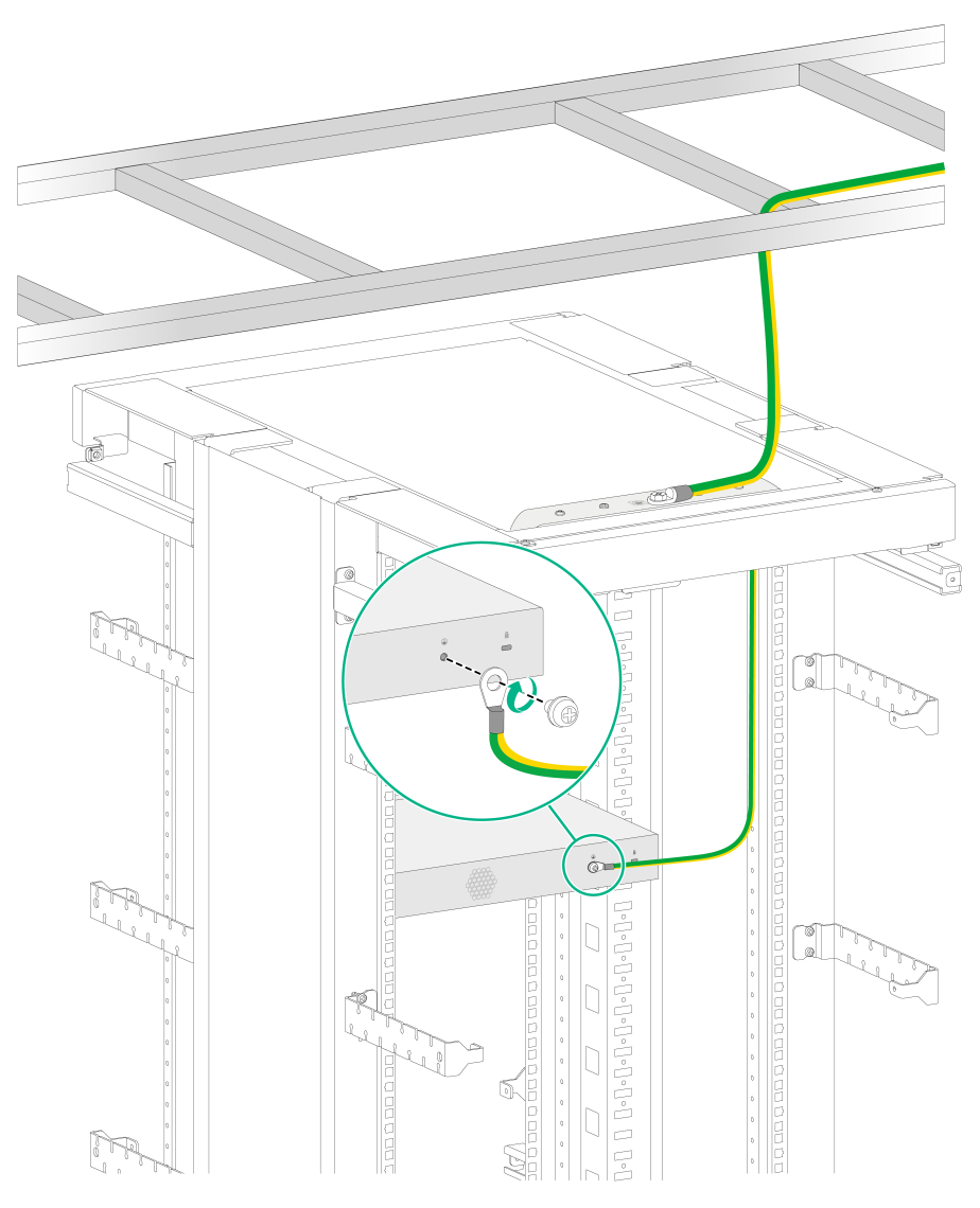

Grounding the device
WARNING
WARNING!
·     Correctly connecting the grounding cable is crucial to lightning protection and EMI protection. Before installing or using the device, connect the grounding cable for it correctly.
·     Connect the grounding cable to the grounding system in the equipment room. Do not connect it to a fire main or lightning rod.
To ground the device:
1.     Use a Phillips screwdriver to remove the grounding screw from the chassis rear panel.
2.     Use the grounding screw to attach a ring terminal of the grounding cable to the chassis.

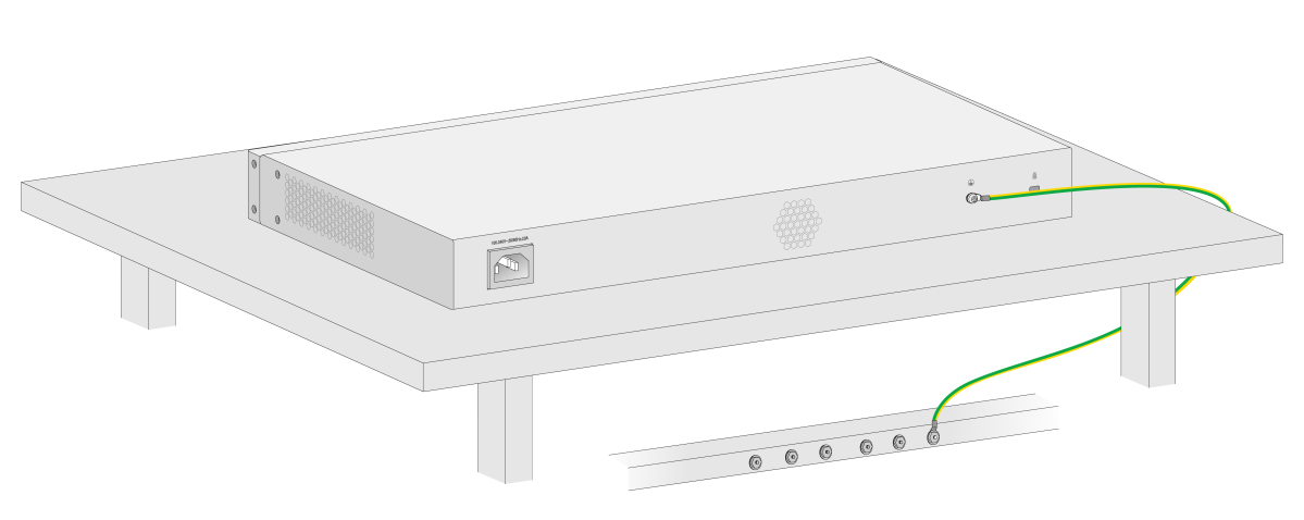

3.     Use one of the following methods to connect the other end of the grounding cable:
¡     Grounding the device by using a grounding strip
If a grounding strip is available, you can connect the other end of the grounding cable to the grounding strip. Make sure the grounding strip is grounded reliably.
Figure2-10 Grounding the device with a grounding strip
¡     Grounding the device through the rack
If the device is installed in a rack, you can connect the other end of the grounding cable to the grounding point on the rack. Make sure the rack is grounded reliably.
Figure2-11 Grounding the device through the rack

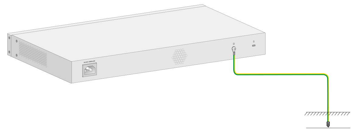

¡     Grounding the device with a grounding conductor buried in the earth
If earth is available at the installation site, you can ground the device with a grounding conductor buried in the earth.
Hammer a 0.5 m (1.64 ft) or longer angle iron or steel tube into the earth to serve as a grounding conductor. Weld the yellow-green grounding cable to the angel iron or steel tube and treat the joint for corrosion protection.
Figure2-12 Grounding the device by burying the grounding conductor into the earth

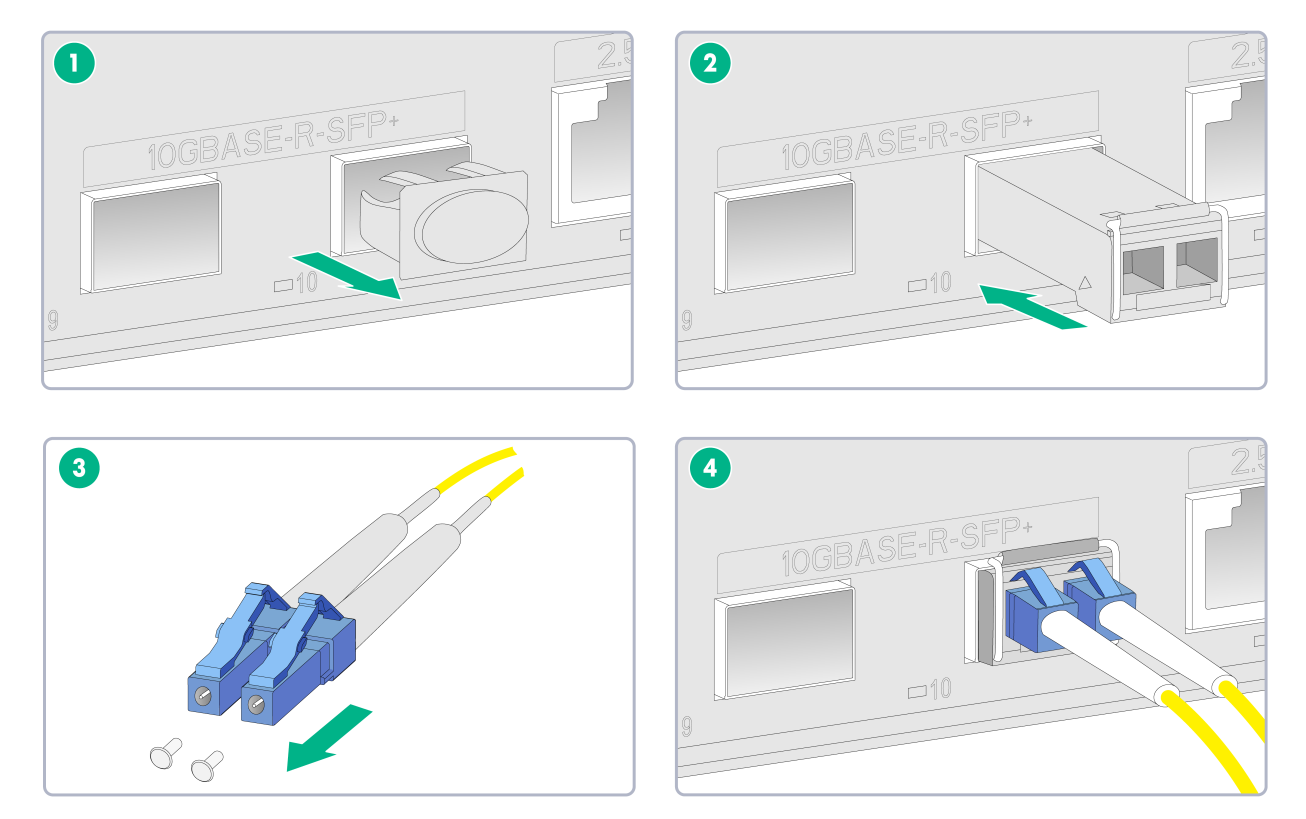

To connect an optical fiber for a fiber port:
1.     Remove the dust plug from the fiber port.
2.     Pivot the bail latch of the transceiver module up so that it catches a knob on the top of the transceiver module.
3.     Holding both sides of the transceiver module, insert the transceiver module slowly into the port.
4.     Identify the Rx and Tx ports on the transceiver module and remove the dust caps from the optical fiber connectors. Use the optical fiber to connect the Rx port and Tx port on the transceiver module to the Tx port and Rx port on the peer end, respectively.
5.     Examine the port LEDs:
¡     If the LED is on, a fiber link has been set up.
¡     If the LED is off, the link has not been set up. The reason might be wrong connection of the Tx and Rx ends. Swap the fiber connectors in the Tx and Rx ports at one end of the fiber.
Figure2-14 Connecting an optical fiber

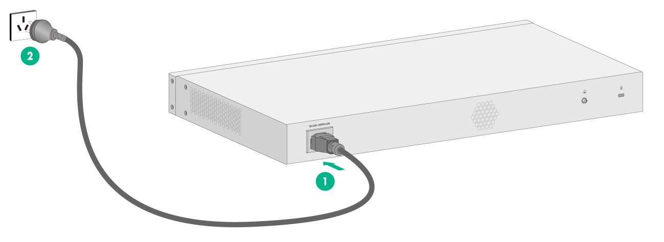

To connect the power cord:
1.     Connect one end of the AC power cord to the AC-input power receptacle on the device.
2.     Connect the other end of the AC power cord to the AC power source.
Figure2-15 Connecting the power cord
